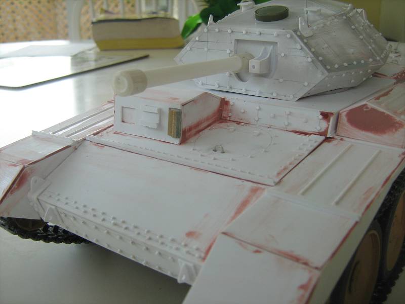

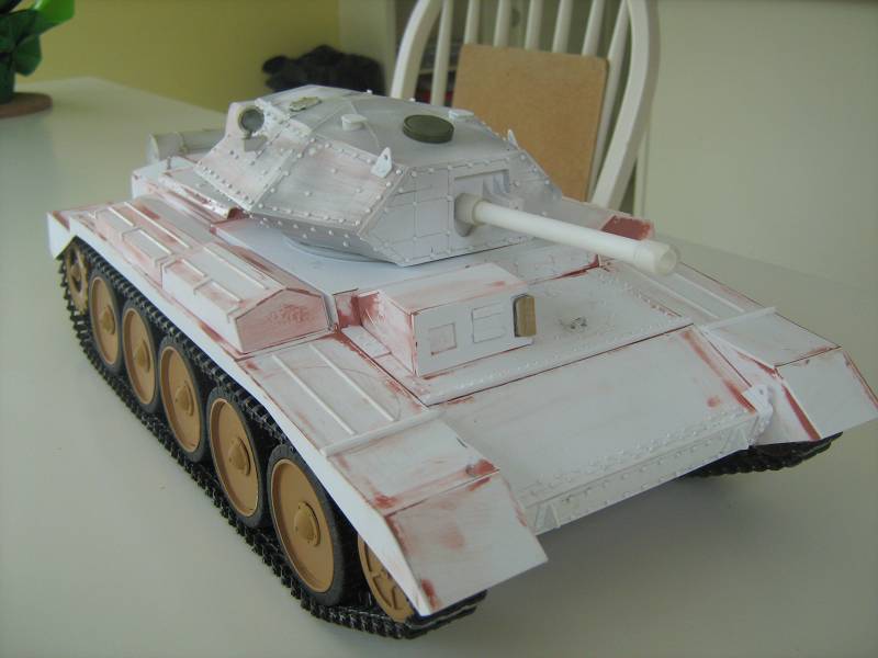

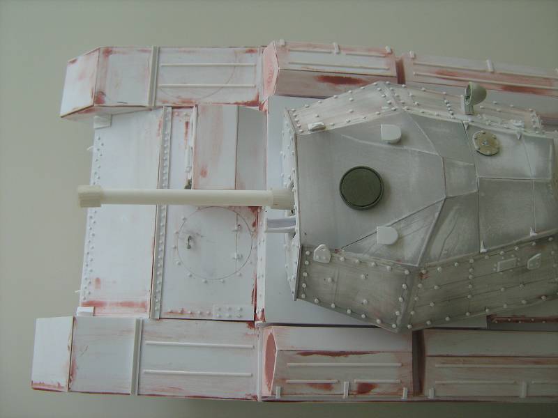

Hi all. Here's a Crusader update.
It's going slowly, but I an soooooo close to paint, I can feel it. I have done all the rivets on the hull and turret, and I have all the stowage boxes on. As well, Ihave etched the panel lines on the rear decking, added the pull handles, and attached the gas tank on the back(this was a total cheat - I used one from the WSN T34.... too short, but I'll see if it feels more in scale when it's painted and weathers. If so, I'll build a new one.
The only things missing now are the lights and they're protective frames, and the air filters and hoses on the rear. Another week or so, and that should all be on. Oh I've got to add the snout of theBesa Machine Gun next to the canon.
I'm getting really excited about painting this tank. Not many of these careening around the 1/16 scale battlefields. Hopefully, someone will kit it out one day (I think Tamiya would make a killing on a full option Cru, but it'll never happen, sadly.)
So... let me know what you all think. Thanks for looking.

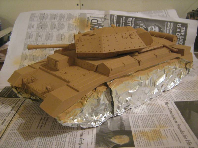

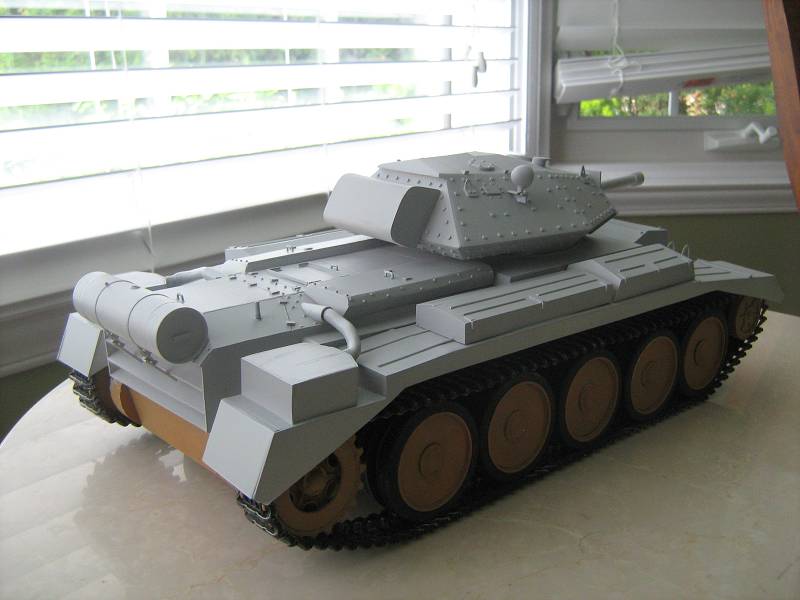

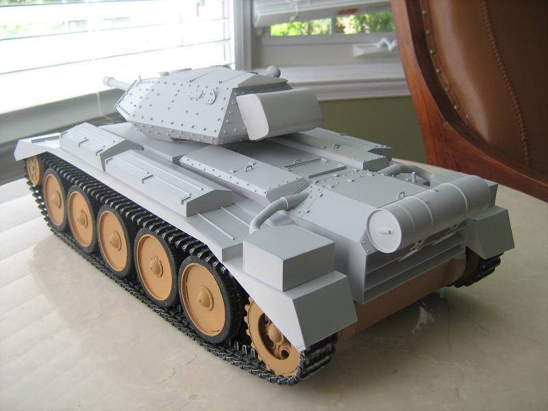

Hi everyone,
Well, the build is complete, and I've got the Crusader primed and ready for paint. Took about about 6 months longer than I had thought!
Since the last update, I have finished the rivetting, added the lights and lightguards, enlarged the fuel tank and built the air filter boxes and hoses... there's still a little detail to the those that I might add on.
I know a lot of guys prime with a rust-coloured primer, but I used Tamiya fine primer spray (it's a lot like Mr. Surfacer) and it covers beautifully, and really evens out the surface... it covers up a LOT of little mistakes and flaws.
I'm going to let this sit for a week to cure up nice and hard, and then it's onto the desert paint scheme... please let me know what you all think.
Shep

inspiring!!!!

Absolutely Top notch, you have used your skills to come up with a one off that everone will drool over. It looks fantastic</p>

Thanks for the kind words, guys. It's been a long process - this is my first build in this scale - but seeing it all come together with the paint today made it all worthwhile.
On to paint the desert camo next weekend!

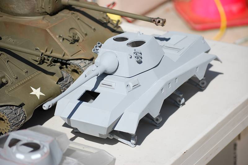

ORIGINAL: YHR
Great job to get something you don't see every day. I am sure you have inspired some HL or Tamiya design guy, and now we will see this mass produced. I would have picked this over a KV-1

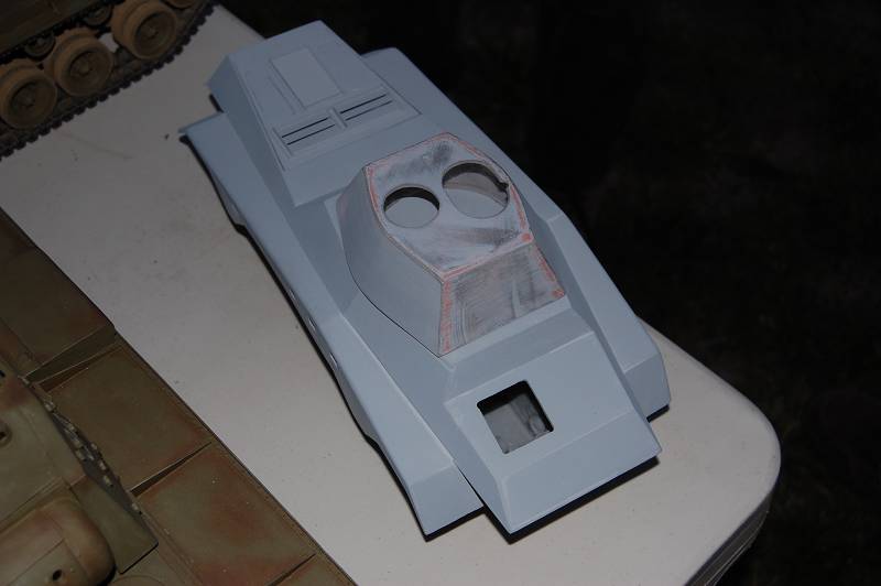

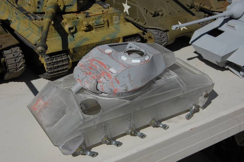

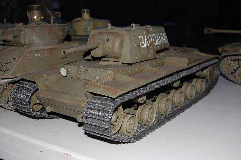

There is a simple law in modeling, If you scratchbuild it it will come..... Ihave many examples from my various clubs. It has happened to me three times in 1/35 scale. I've included a few pictures of Ron Bair's work from socal. Almost every vehicle he has scratchbuilt became am RCkit soon after. He's working on a Chafee now!

BTW... that Chaffee and that Puma are NICE!!!

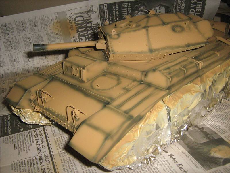

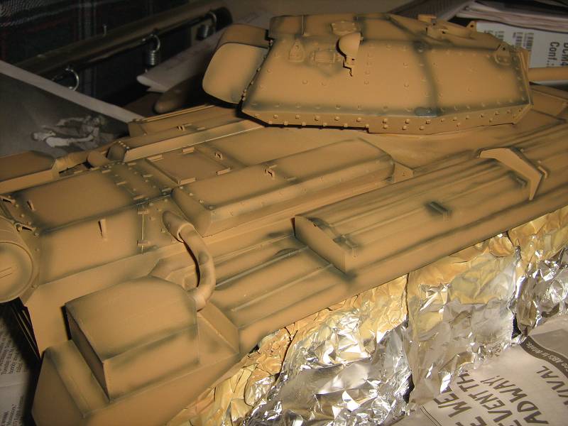

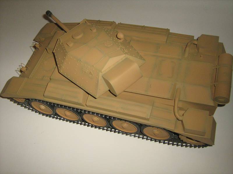

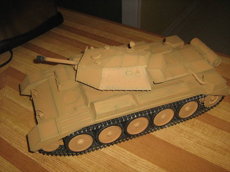

Well, I'm finally into the paint!
Here's the progress on the painting. In the first shot, I've masked the wheels and tracks with foil (easier than masking tape) and laid down the base coat of Tamiya desert yellow.
In the next two shots, I've airbrushed a thin line of dark gray into the corners, edges and panel lines.
In the next few shots, you can see where I then misted some more desert sand over the gray, to blend in the gray shadow lines. It's a great way to simulate oil deposits, build-up a wear. It shows okay in the pics, but it looks ridiculously cool in person.
So.... so far, so good. As you can see, I haven't done the wheels yet. Next steps after that are a dark wash, a drybrush of a lighter sand, and then some chips with a graphite pencil. Also need to add the number codes and tactical symbols.
I was going to freehand a dark brown disruptive camoflage pattern, but I just love the all-over sand of British desert vehicles.
Let me know what you think!
Shep

i could not be more impressed!.. excellent!!!!
Old 06-13-2009 | 05:31 AM
  #49
Joined: Apr 2008
Posts: 224
Received 15 Likes on 10 Posts
From: NewportGwent, UNITED KINGDOM
Default RE: Crusader 3 Build
Fantastic scratchbuild and a great paint job. Wish I had half your skills
Alan
Old 06-13-2009 | 06:09 AM
  #50
BarkingSquirrel's Avatar
Joined: Apr 2008
Posts: 155
From: OdessaFlorida
Thats absolutely jaw dropping work. I could never do anything of such a high caliber as that.
