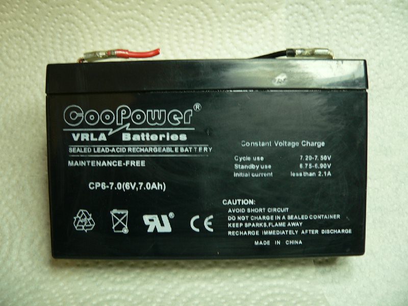

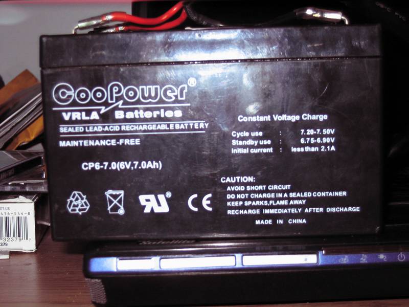

In Canada we have a store called Princess Auto. Basically a surplus store, with their own brand of tools and auto parts thrown in. I found a 6.75- 7 volt 7000mAh sealed lead acid battery for $7.00. It looks like the batteries they use for emergency lighting in hallways of buildings. I installed this in my Heng Long Tiger. Well I am happy to say with the 3:1 gears, and the slightly lower output voltage, I had a tank cruising around in the grass and light snow at scale speeds. Never had one issue with the running gear and the added weight of the battery had this tank plowing through the grass and snow for over an hour. I gave up trying to run the battery dead.
Has anybody had any experience with these batteries in tanks.? I bought two of them, and I am pretty pleased with them so far. I don't think they like to be run dead, but with run times of over an hour, I doubt they ever will be. After and hour it is time to try another tank!!!!
Also I have to mention the 3:1 gear reduction. This really is a must have. The increase in torque is something you really need to experience to appreciate. No stalling, no jerking around, just a steady pull that gives the tank the right feel, as it climbs and plows through stuff.
I used old Cox slot car gears(sidewinder gear and a pinion gear mated together) and added the extra gear on my standard Heng Long gear boxes to give me the 3:1 ratio. Someone on this forum did a thread on the concept, and I used that as a guide when I fashioned my own.
Regardless, the battery and the do it yourself gears are just a couple of examples of how to enjoy this hobby, without spending a bundle.(Not that there is anything wrong with that!!!!!!
) IF you want to stretch your hobby dollar, always keep lookout at these surplus type stores. I also picked up 4 Mabachi 6-12v can motors for $0.99 a piece. They are a little shorter then the stock motors but they work well in 1/16 scale tanks.( I have them installed in my Panther conversion) This is next on the list for the gear ratio mod.
Happy tanking

I think you have picked a winner there. Those batteries are designed to provide continuous output for 90 minutes since it is used for emergency lighting.
I would say for your application you may get up to 3 hours before needing a recharge!
Can you show a pic of the battery?
Yes, please show a picture or give the part number. I live in Winnipeg- proud to be the home of Princess Auto! I actually have a PA about a 1/4 mile from my house, and they know me well. I'd like to see abut one ofthose batteries for my Sherman and maybe for my Tiger as well.

You sure they aren't gelcells YHR? Personally, I'd never put lead-acids in my tanks. A gel-cell, yea, NiCd, NiMh, or Li-Ion, sure... but never a lead acid. Why? Acid leakage. If it leaks, that acid will ruin your styrene casing. I put 3 layers of nitro-proof epoxy in my 52" boat before I dared run the lead acid motorcycle batteries in her, because I knew if they leaked, they'd ruin the wood. Luckily, I never had a leak, and used the batteries til they wouldn't take a charge any more. an acid leak is as bad as the non-styrene-safe lube on the Pershing tires warning we had a while back (it made the bearing sockets crumble)
I have a local store called Total Battery where I can get custom packs built, zap-assembled for a buck a cell, covering included (double the thickness of standard NiCd cell packs) and I supply the connectors. I had 'em build packs from old laptop batteries I had recovered (they were dumpster bait) and the four 10-cell packs went with my Graupner Portofino. Running her on a pair while the other pair charged, she went like a bat outa h*ll with her strudder outdrives.
JMHO.

These are sealed Lead Acid batteries. They are all sealed up and I think you would have to drop one and crack the case to have a problem. Your objection is noted, and if I have a problem I can't say I haven't been warned!!!!!!

Sealed Lead Acid batterie... (6 V, cycleuse 7.2 - 7.4 V, 4000 mAh).
Works fine with TK Rx14 and above!

With a 400mah charger wouldn't a 7000mah battery take nearly 20hours to charge?

Well sure, but it will probably will run a tank for 4 hours.
Do you need a special charger for this kind of battery? Or will my MRC 977 work?
For the leads, did you just solder the wires to the batteries terminals (looks like it has metal tabs as the terminals)?
Last question
: how much does one of these weigh?
Last question

Well, you generally don't want to fast-charge a lead-acid battery. Its a great way to get acid sprayed all over the place. But there are new chargers that can do it, if you call 3-4 hours 'fast'.
I googled 'lead acid charge rates' and first hit was this one, on charging [link=http://www.powerstream.com/SLA.htm]Charging Sealed Lead Acid Batteries[/link]http://www.powerstream.com/SLA.htm by PowerStream Batteries.
Judging from the picture, the unit is designed to use the spade lug connectors... gonna use them or solder a set to the spades, YHR?
