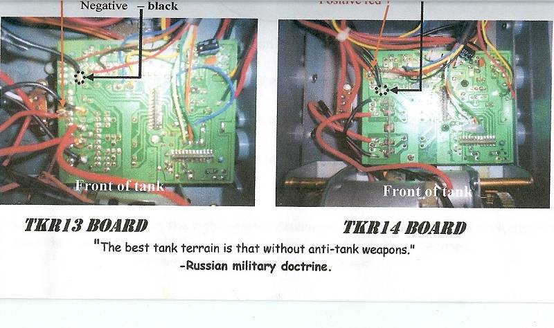

Can anyone tell me what the brown wire in the wiring harness is for? I'm trying to install my Creeping Death Tiger turret and their photo is too small to accurately gauge where the wire connects on the board. It appears that the recoil unit positive wire connects at the point the brown wire is connected to, but it would seem to make more sense to connect next to that where the power feeds from the switch. Their instructions do caution that it should not be connected directly to the battery...
Here's their photo. What do you think?

I just received an answer from CreepingDeath about the wiring. Hope this helps you. I think the photo in their instructions is incorrect.
follow yout tanks red(positive) power lead from the battery to the switch. then from the switch to the circuit board. right where the positive wire connects on the board is where you want to solder your red recoil wire.

I've just about got the Tiger turret wired, and only have the first step to complete. The photo in the diagram is a bit small and hard to see. Is the recoil positive red wire soldered to the board at the same location the small brown wire on the board is going to, or next to that where the main board power feeds from the switch?
Thanks!
Wibbly, instead of trying to email them direct, try the "Contact Us" page on their web site. http://creepingdeathrc.netfirms.com/...bdd99c863be1fc
