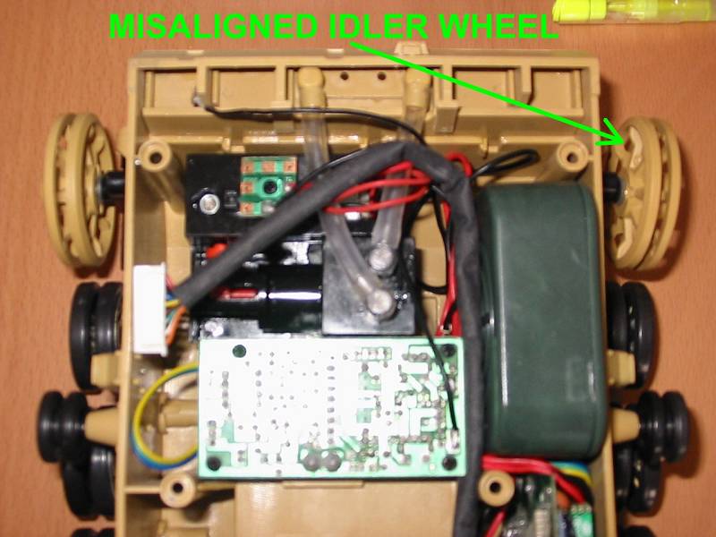

Wow, My first tank - a Panzer III has arrived. Looks good, feels hefty in the hands.
Upon opening up, I noticed that quality not as high as I expected:
+ Left idler wheel is misaligned

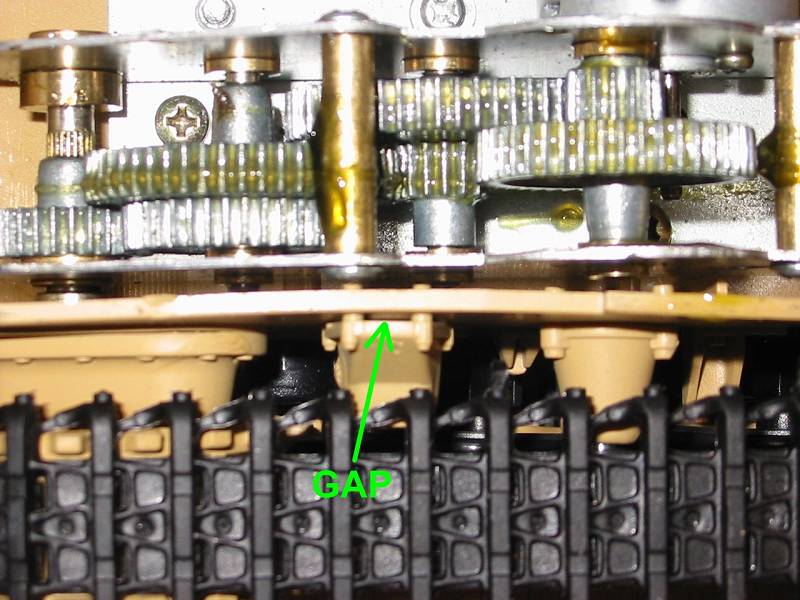

+ L front suspension bracket was not fully inserted into holes on the hull

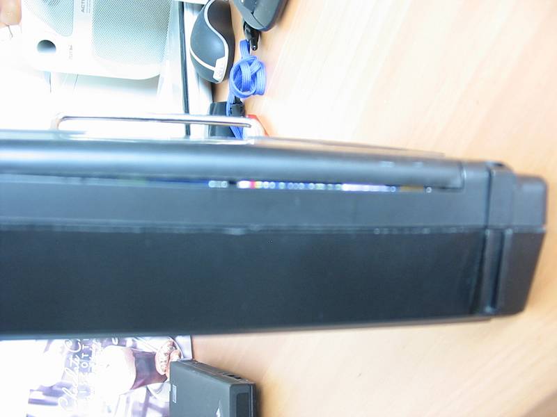

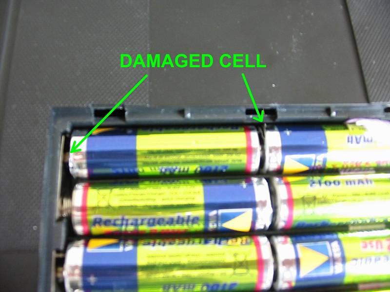

+ Remote controll looks very cheap, battery compartment is tooo tight - I use varta low-discharge NiMh 2100 mAh and they barely fit even though they're not very fat, 2 cells were damaged when I tried to push them in place. The battery cover could not close entirely.

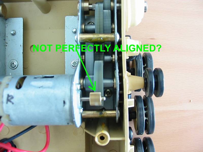

- The teeth of the gear on motor axle (both sides) do not perfectly align with the first gear, does that matter? if it does how do I adjust them?

Are you familiar with Chinese quality if not welcome to quality control Heng Long style there all the same, The gear box needs to be squared up were the motor bolts on to solve gear meshing probs, You can remove and realign problem parts the glue used is average at best, Never bothered with braking in gear boxes or motors myself.
