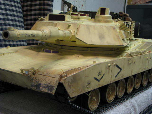

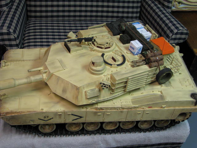

Well, I finally got a few minutes to "play" with the Abrams again today. Made and installed the crew step on both front sides. Filled the grenade launchers with some "protection" stuff, and fashioned a tie-down strap out of some brown tape. Also fabricated some boxes of bottled water from a file sent to me by Gorehound (thanks my friend). Even managed to make a case of Pepsi. Still working on the MRE boxes, but I think I've got that now. Found a brand of box matches that the boxes seem just about right for MRE boxes. Should look OK. I'm still trying to decide about attempting to use the new Elmod stuff in this thing, but it uses a 12 volt system and I'm not sure their stuff will survive and that's an expensive experiment, but we'll see. This thing runs well, even in the cold, and the "beefed up" suspension seems to handle just about anything I can throw at it. I sure wish 21st Century Toys would re-release this thing (with just a couple of improvements). Take care one and all, stay safe !!!

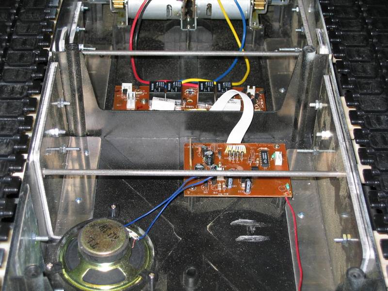

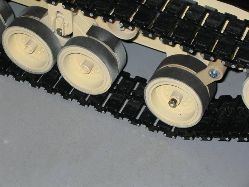

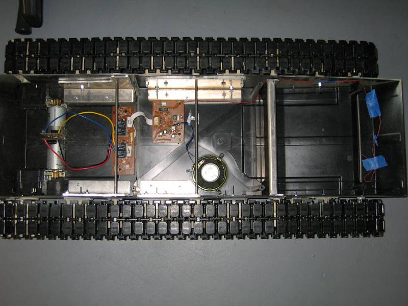

Hey Jmcnulty - Merry Christmas fellow tanker !!! I put in different springs. Not quite as strong as the originals. I put slightly softer ones in, so I guess I actually "unbeefed" up the suspension ?!?!?!?! I also drilled out all of the wheels and inserted nylon bushings in all of them. This protects the suspension AND the lower hull by strengthening all of them. I also inserted metal supports on inside of the lower hull. Next, I inserted 3/16 in steel piano wire as axles on all but one (and that's coming soon) of the wheel assemblies. This is truly critical for the front idler wheels (the ones on top, up front, nearly totally hidden by the side armor). Again BIGMIG's posts on this are what convinced me that this had to be done to keep from breaking the really flimsy wheels. Lastly, I wrapped each and every road wheel in a soft type of foam rubber that I cut from 8 1/2 X 11 sheets. Not only does this strengthen the thin plastic a great deal, it adds that realistic look to the wheels, as without this on them, they look weak and fragile. I'll post a copule of shots to this so you'll see what I mean.
The .50 cal I ordered from Kenny Kong. It's actually from his 1:8 scale series of accessories, but the difference between the two scales is really negligible. I'm going to order one of his tank crewman next. The .50 cal mount I made from some plastic and some 1/8 in piano wire. I just bent the wire until I got the general shape where it would fit and then did some final adjustments with the pliers and Vise Grips. Super glued it to the gun. The gun moves up and down and that's it, but its more for show than anything. Do a search for 1:9 scale Abrams or for BIGMIG and look for his posts. That's what I used for most of my changes. I'd be glad to help in any other way I can if you want to try some of his stuff out - it works.

Did you add those metal plates or are they already in there? Would some pieces of all thread work to stiffen the hull?

I added the metal plates. They're 1/8 inch aluminum. A local sheet metal shop did them using some scrap they had. The guy only charged me for a few minutes labor since he was really interested in how it was going to be used. I found it simpler to just take the lower hull and show him. I drilled a small hole through the hull and metal where I was going to put the screws in. GREATLY aided in hull strength. I read in another post about using wire or thread, but I never tried it. Like I said, between the metal axles and these metal pieces, this hull is extremely solid now. If you only have a little time, and don't want to do the whole thing, I'd suggest the metal axle for the idler wheel. Even that will make a big difference.

One of bigmig's threads said use 5/16 wire for the fron axel on the Abrams. 3/16 sound more like it. How did you remove the 1st road wheel after that? Sounds very complicated?

I got it at Michael's, kinda like Ben Franklin, a craft/toy/hobby/framing store. It comes in 8 1/2 X 11 sheets just like normal computer printer paper. Itr's about 1/16" thick and comes in several colors, naturally I used clack to simulate the black rubber on the Abrams' wheels. The wheels on my Abrams are 3/4" wide so I simply marked off every 3/4s of an inch and cut with a paper cutter. These are long, but when I got to the point where the overlap started, I simply cut it off. Works like a charm to stengthen the wheels themselves by cushioning them, and gives the look I want too. I just looked and there is no name on the pieces I have, but I need to go to Michael's anyway tomorrow so I'll see if I can find you a name. Each sheet is about a dollar.
