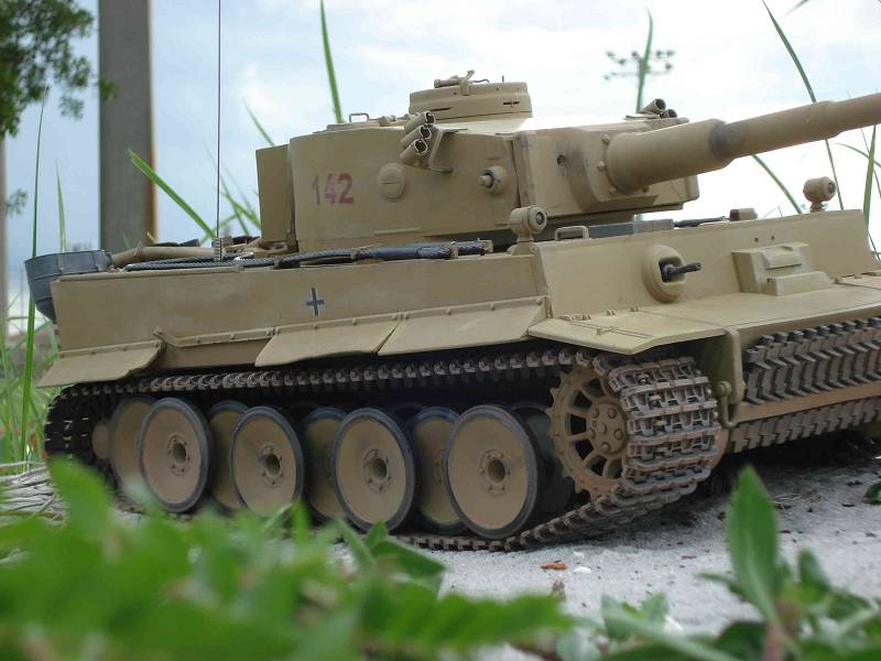

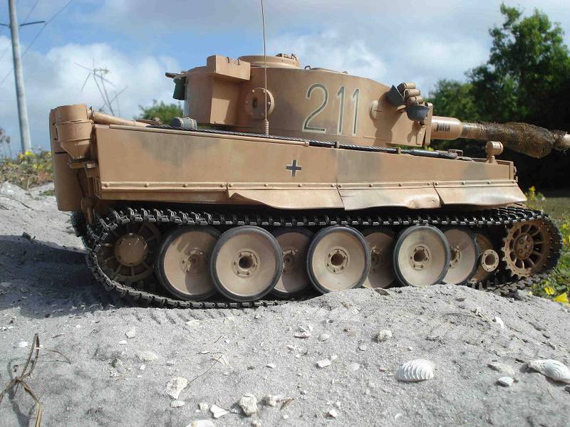

First I thinned them out by sanding them down. Then I heated them up with a soldering iron, never touching, just as close as I could get and when it started to bend, used pliers or an object to replicate damage. Take it slow. If you remove them from the tank it's easier to thin and heat with a hair dryer instead then glue them back on.
The 142 Tiger didn't get the guards thinned, just heated and bent. Be patient and take your time. Also consider what realistic damage would look like, you can see some examples that seem pretty far fetched in the gallery.
Ohh, the fenders on my Tigers are the earliest 2 piece design so if you replicate missing fenders on tanks other then the 501 tanks that went to Tunisia, there would be nothing left but the mount for the screws on the hull side, little squares.
