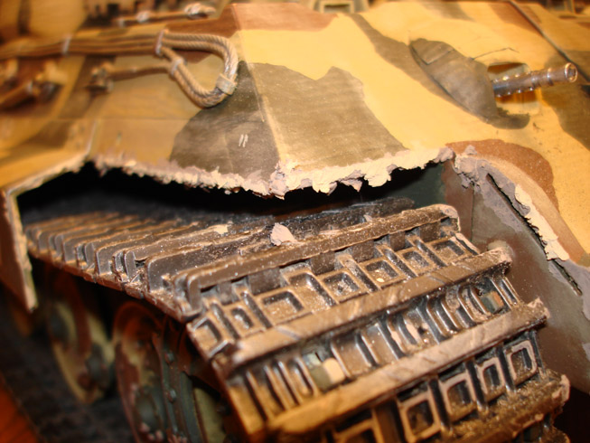

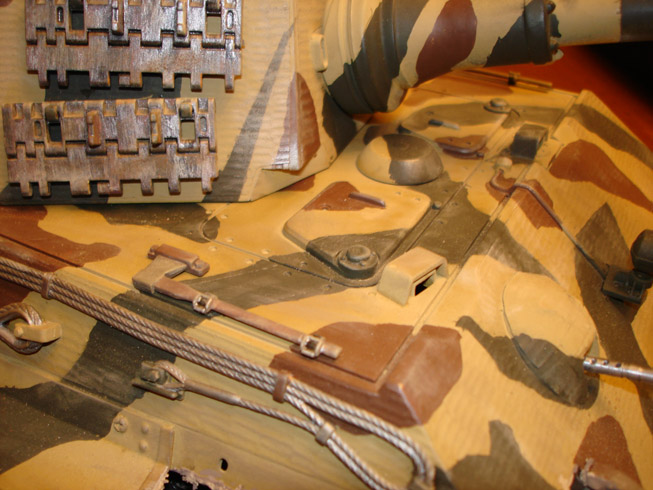

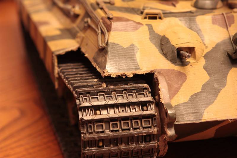

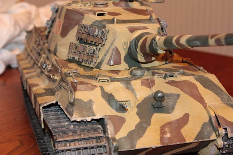

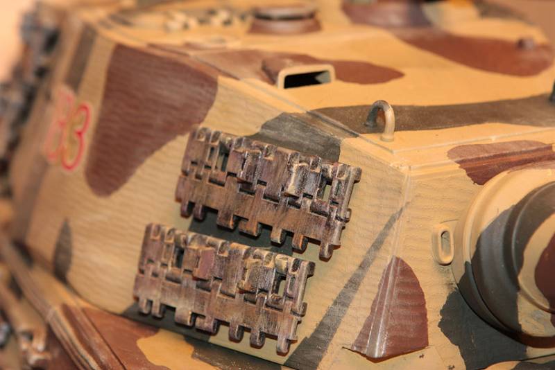

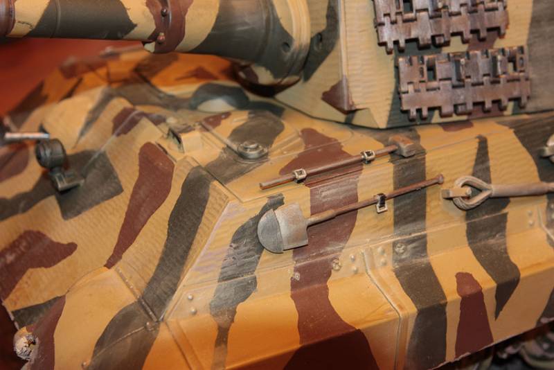

hi here are some of my new photos after weathering my KT with the tamiya weathering kits.....i used all 3 kits (apart from the snow)
what do you think?
what do you think?
Very Nice. I really like the damage detail above the right track. Keep up the good work [sm=shades_smile.gif][sm=thumbup.gif]

Well, I'm going to be honest. Its not meant to be mean but hopefully help you in making a good start even better. While I'm new to 1/16 RC Tanks, I'm not new to R/C or scale model armor. I've built many 1/35 scale tanks which included heavy modifications.
The weathering job is so-so....
Your dry-brushed areas looks too random. Unnaturally so. Not sure if aren't taking enough paint off or you aren't overlapping the drybushing enough or doing enough area. But it looks drybrushed. I think you need to take more paint off your brush and make it more even and consistent across the tank. You can clearly see the direction you were drybrushing. You shouldn't be able to see this.
Its also too heavy in some of "high wear" areas like corners where you'd expect to see faded paint or metal. It should be less....
I would also suggest you try an overall wash that will blend and soften your camo a bit. Then use a slightly darker color sepia-ish to highlight all the small details and sit in the zimmerit. Then drybrush the "high" areas. There are some good reference material from this tank thread that shows some really good techniques for weathering.

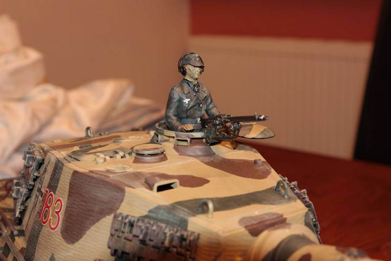

I suggest also either painting on your numbers or making sure the surface you are applying the decals to has a satin finish or a finish that the decal will adhere to without silvering. After that you can weather more.
I commend you on your attempt at adding some "mud" but this brings awhole different and complex technique. Its a huge task to make it look convincing and not just randomly applied. Although I can't see your roadwheels, They would have some mud on them as well as various place on the tank that would normally get splashed when running in those type of conditions....
I do think your spare tank treads are nicely done. I like the rust......
Again, I'm not flaming, but giving you my honest and hopefully helpful opinion...

no problem Alpha, this is the sort of feedback i need, but don't forget this is my first attempt at anything like this. I do agree i should have painted the decals on and i have just removed them, i will practice trying to paint them on. As for the overall finish, how would you suggest i go about applying a wash to dampen down the camo? i have just wiped over the tank with a damp sponge which has removed 'high lights' as you call them. I was wondering if the mud was a on the light side? i have ordered some Dullcote to spray over the tank, would i be better applying this before attempting to weather it? i have put a little mud on the wheels, i am saving for a set of metal tracks, i will probably put some mud on them, even run it outside in some mud!!

1. On the tracks dry brush the keels, the area where the road wheels ride on the inside of the tracks, and the cross bars with a bit of flat aluminum
2. Use a number 2 or an HB soft lead pencil and rub it on all the corners and protrusions that might normally be rubbed by wear and tear.. usually on the edges of the fenders, around the periscope edges, cupola edges, you get the idea.
3. Run the same pencil around all the cracks between the hatches and openings in the hull. This is all pretty harmless since you can rub it all off if you don't like it. You can also use the pencil to imitate paint scratches.
4. Make a wash of a sand or mud color and slop it around behind the road wheels and on the tracks.
5. The lesson that finally got pounded into my head is that paint fades from the top down so if you are going to lighten paint pretend you are the light source (sun) and just lighten anything exposed from that source. if the light can't get to it, then the factory color should be darker unless worn off by use.
6. Tale your time and just have fun doing it.

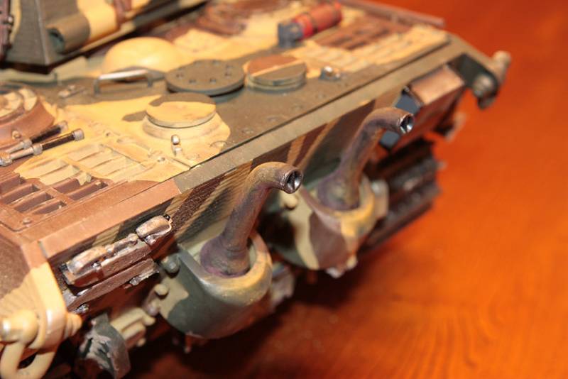

7. More rust on the exhaust pipes.

thanks Ken, how do i make a wash???? is it something i spray on? i was wondering how would you make the paint fade? the only way i can think of is wait till summer and leave the KT in the greenhouse.....LOL.....but is there a way to do it?

a wash is just a highly diluted mix of paint and solvent. I use water based paints so alcohol works well with these. a typical was might be one part paint to 10-15 parts alcohol. I just brush of spray it on the tank from top side then let it dry. I recommend investing in a couple of modelers books for lots of different techniques. We also had a string running on painting sites a few days ago. http://www.rcuniverse.com/forum/m_8303414/tm.htm.
Faded paint is usuall what ever color you are using diluted with white, sand or light yellows. They can be other mixes but these are common. Try a mix of 1 part base color to 10 parts light color (white, yellow, etc) make your self a test patch on a pice of cardboard or ol tank parts. put on your base color let it dry then put on the faded paint. JUst some in the center of your test pices so you will see the differences when it dries. let it dry and see if you like it. If not put on another coat to darken it, same procedure.
Weathering can take several days and should only be done in small stages until you get the feel for it.
1. Take your time
2. Have fun
3. Do not get discouraged f you don't like the results, just start again or make small mods.

I buy several small bottles of testors paint thinner/solvent and add drops of paint to each, making a black wash, brown wash, dust wash, mud wash etc, etc, then I label them. Keep the posts comming, Im learning some stuff.
