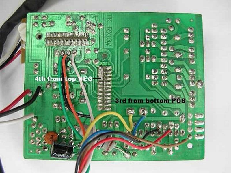

RCCommand is still going to be your best bet. Bill even has the SU convertion kit for it. The WSN T34 is a great little tank once modded to HL. the only thing is you lose the flash and redoil. can anyone figure out out to get those functions back. Will going to a Tx18 board do the trick?

I am going to do a post on that next week, but you do not loose flash or recoil! If you have the RX-14 board you connect the flash to the flash point on the back of the board by the sound card, and you connect the recoil to the cannon shot motor power and if you want to synchronize them you install the micro switch in the left stick up lever wiring it to the back of the K button and you get all the functions! I am going to use the DBCRC2 so I do not need to do that the flash will come form the DBCRC2 board and I wire the recoil up the shot wiring on the Heng Long 8 pin connector and you have all the functions!

Hey blitz could you send me some pics and or a diagram on how to get the flash and recoil back. all i did was the basic HL conversion. I was not aware you could do this with the 14 board. I dont want to misslead anyone. I really like the T-34 it would be cool to get the full functions back.
Panther G
Here are the spots that you have to solder too, ( RX-13 or 14 is the same spot ), unfortunately you need to have the hand and eyes of a doctor,, but it works great! I have went as low as 68 ohm resistor inline with the positive side of the LED you choose and all works well!

Are those the location for the recoil or the flash. i'm getting confused, which of course is nothing new. i usually am.
