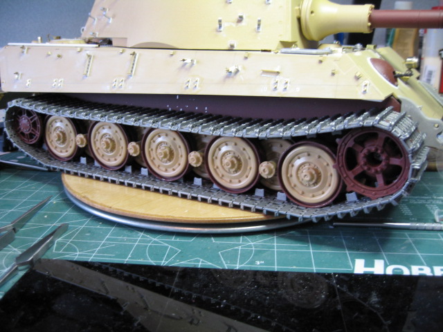

NO NO NO on BYA, the guy should not be in business, I have parts that I ordered over a year ago and he does not repond.
ETO (Impact Tracks) is your best set to go with. Bob is the man.
Gary
