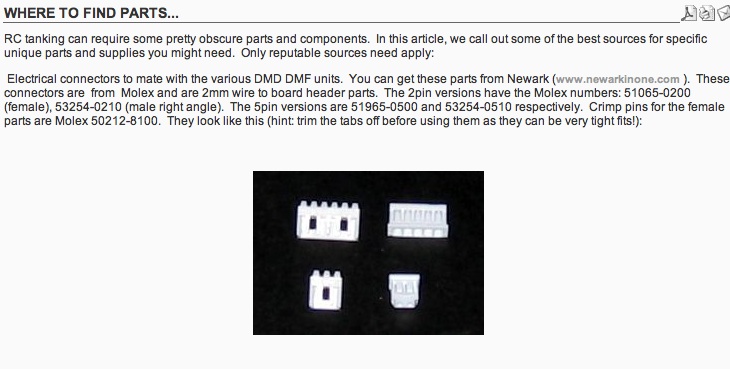

Is this what you are looking for?

I was looking for specific part descriptions if possible. I had heard some of the connectors are no longer produced. Tamiya's electronics manufacturer must have a bundle somewhere...
Molex make many connectors... does anyone know which one is the tamiay component?
I'm going to send some hi-res shots to JST, JAE and ask if there is something compatible...

Looks like KSOC supplied the part numbers to the Tamiya components as well. Why not just go with the info he supplied you.

My apologies, I didn't spot the attachment..
