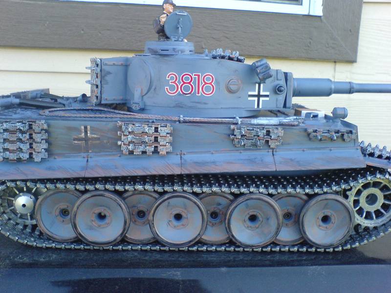

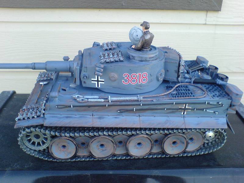

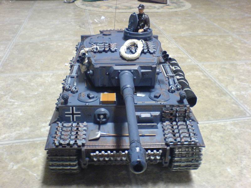

heres my tank..

Thats one tough looking tank Chin, and you got plenty of spare track, to help beef up the armor! Now lets see some video of that beast!
