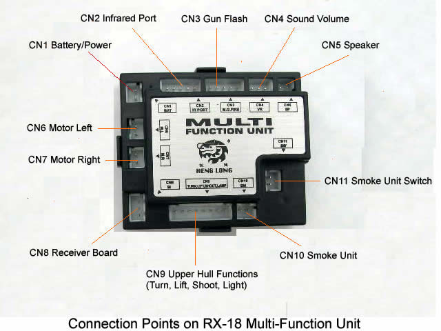

Fitting an RX 18 board into a WSN t34, got everything sorted except the muzzle flash, where do the red and black wire on the LED fit onto the board.

If you have the flash unit then you plug it in the flash plug top second from left CN3 Gun Flash

All i have is the 2 wires which pins on the CN3 do I need to plug it to[&o]

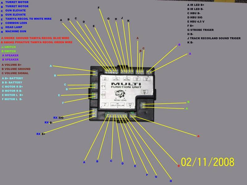

Try looking at this F= B+ , G= Strobe Trigger , H= B- , J= Track Recoil and Sound Trigger , K= B- on that connector .

Sorry have electronic skills of a brick which wires go where ? 1 to strob trigger? the other?
Old 04-10-2009 | 01:13 PM
Joined: May 2008
Posts: 2,327
Received 147 Likes on 115 Posts
From: jackson, MI
Default RE: t34 with RX18
id try red to B+ and black to Strobe Trigger but dont hold me on that ive not hooked up the rx-18 yet and my stug has the hole harness connector and on my T-34 i put in the DBCRC2 it has a two wire hook up for flash red/black wires match up to T-34 . on the connector its red/black/blue on the left of the connector it go's to flash . Bill at rc command would know better .
