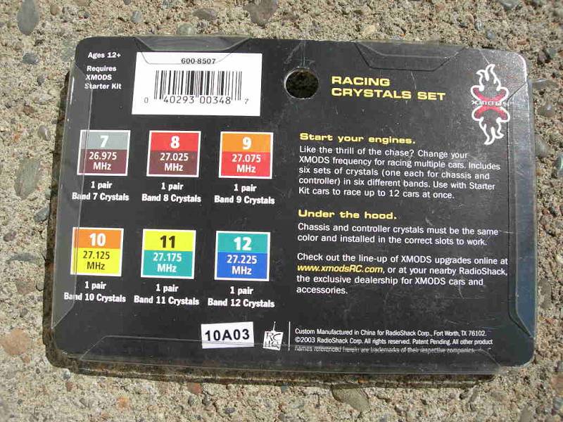

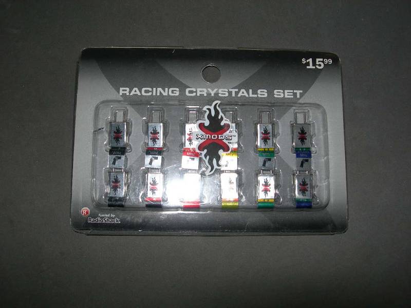

If you go to Radio Shack, you can get a 6 pack of tx/rx for x-mods. Cost is $16 or so and contain 6 of the freq's shown above in the Sport Crystals list.

Do you have a part number Nomobux? I searched the site but came up empty.

Only number is the barcode 40293 00348. Front only says Racing Crystal Set. Here's a couple of bad pics. I think that 10A03 on the back side may be a QC tag ??

Used 600-8507 as it looks like Radio Shack number and gave me the owner's manual on Radio Shack's website. The part number is 60-8507, thanks!

I'd be cautious with these. I tried some 27 Mhz FM crystals for Xmods and none of them worked. It matters what type of crystal you have I found out. F type is what you want. The same frequency in an S type crystal will not work.

You mean FM and AM, Dan? Never heard of F and S types.

No in FM crystals there are S and F type crystals. My first order with Sport crystals I received the same FM frequencies in an "S" type crystal and they did not work. I had to send them back and get them replaced with the "F" type. I guess the crystals can have a different impedence, and this counts. As I mentioned I bought these Xmod crystals and none of them worked, much like the "S" crystals made by Sport crystal did not work.
You must get the "F" type. F stands for Futaba I think.

Well guys, my curiosity was peaked. Went out and tried them ... NO GO. I had gotten these originally for a car. I am not up on electronics at all. I thot freq was freq. Sorry fellas.I shall now go out and bore site my main gun on my forehead !!!

Learned something new today, had no idea! Guess I got lucky when I bought the Red Hawks and tested them out. Thanks for trying Nomobux, you've saved others from making this error and that's what the forums are about, sharing information.

Ya, join the club, been there, done that.
That is the beauty of these forums. Learn and share to either help some, or prevent others from making the same mistakes. For the record I have tried the Sport Crystal 27 Mhz FM, "F" type crystals and they all work.
