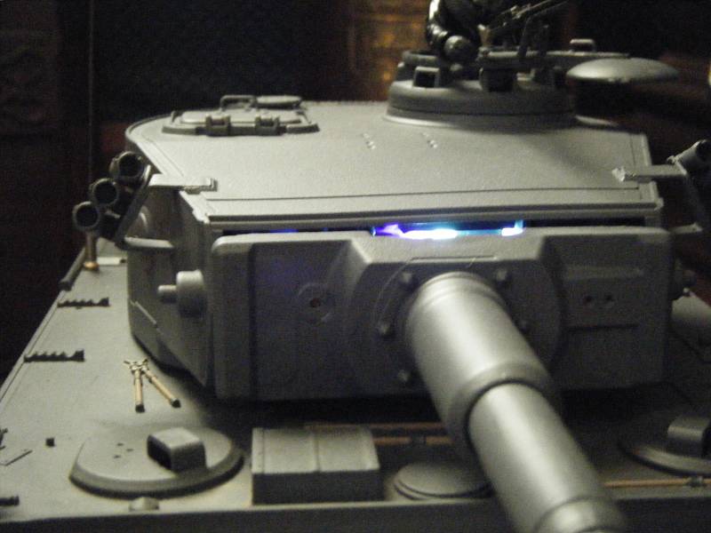

After taking my Tiger all apart and fixing the mantlet and installing a pen laser, the laser stopped working. Would anyone have a link for Ebay or whatever of a replacement laser pointer? The pointer I installed used 3 button cell batteries and I forgot to solder the resistor back in for the red LED warning light and I guess I burned the laser out.....

This is what I used. HL has around 2.4v going to the mantlet machine gun LED so you can just swap them out and no need to replace batteries like you do with your pointer. Neat effect... just like Creeping Death uses in their tanks/turrets. Just cut the wires to the machine gun LED and solder this in its place. This is a 3v laser diode, but the 2.4v operates it fine. Also, this way it isn't on all the time and won't run down batteries. Just press the "G" button on the HL radio and it pulses with machine gun sound. Easy mod, and you can't beat the price! $3.99 and free shipping! I've ordered from these guys twice and never had a problem with them

Thanks Ern! I just wired it to the LED, so that when I would fire a pellet it would come on at the same time. Worked very well for one shot,then stopped working.

Personal preference I guess. I removed the airsoft warning light and just filled in the hole for a couple reasons. Although not important to some, "historical accuracy" I guess is the term. There wasn't anything there on the real Tigers. Mainly though because you will only get the laser to light a couple seconds prior to the shot firing if you use the warning light wiring. I like being able to use the turret machine gun/laser to aim. You can fire/light up the laser as much as you want. You do have a point that it is closer to the barrel, but these guns aren't really that accurate and it would be just about impossible to align the shot with the laser anyway. I just aim a bit to the right and blast away. I guess you coud put the laser where the warning LED is and still wire it to the machine gun wiring... I just didn't want two holes there. The machine gun light also works with the barrel - it's just a bot farther to the right.
If you haven't seen the Creeping Death video, watch it and you will see how mine looks from the front of the tank, and there is also a shot of the laser scanning across some furnitire or something while they are traversing the turret. Neat effect!
http://www.youtube.com/watch?v=9N3OZrhbeZc
Here's a pic of my Creeping Death turret. The one that I installed is under construction now but it is in the same location.

Thanks Ern, Much Appreciated! I have seen the creeping death video before and it's very cool. I may just take your suggestion on the laser placement as the guns are not that accurate as you said..... and it would look better too. I spent the time to fix the mantlet last week, so might as well keep going. I also want to change the gearing to 3:1 and put metal tracks, wheels and the chassis insert that Bill has at RC Command. I just have to do it as I have time and oh ya money too.
