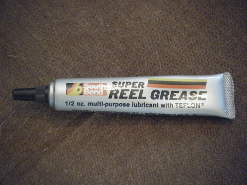

Here's what I've been using lately. It contains Teflon, works to -65 degrees F, and because it is for fishing reels it is impervious to fresh and salt water. It can be found just about anywhere you can buy fishing tackle. I think I got this at a Walmart or Meijer store for a couple bucks.

Will the reel grease work on both plastic and metal gears?
Sorry, just saw the question... It doesn't say specifically that it is safe for plastic, but does say that it contains no petroleum products so I assume it would be OK.
