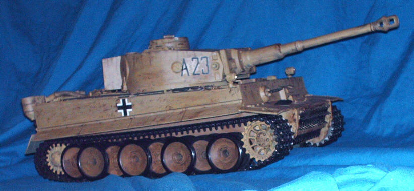

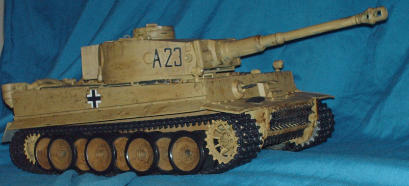

Hey Guys,
Here is one I had 1 1/2 days to do for a customer. Almost done! Did not want me to mod the gun or much of anything else except paint it. Should finish up in the morning. Would have been no time to take pictures then so here is the unfinished still wet and not yet blended and matted, or dull coated.
Don
Don

Hey Don,
Thanks for tossin' up the pics of this Tiger project. I'm getting ready to paint my first tank which is also an HL Tiger in panzer gray, so this thread was very timely. Can you tell us what mix was used in the wash you applied? Did you do anything additional to the tracks?(I would have loved to have seen some photos of the completed tank.) Thanks!
Cheers, Bob

Well the base coat is 1943 Acryl Dunkengleb (I love saying that that word) Then it gets a coat of future floor polish and allowed to dry over night.
Next I mix Windsor Newton Oil paint #35 Raw Umber with thinner to make a filter (Extremely thin wash) This is used in the air brush. Then a bit darker wash of lamp black and the Raw Umber.
The the chips are done with raw umber as are the scratches.
Hope this helps!
Don

Brother Bob,
Me I like a very dirty weathered look. Not so much for when you are looking at in person but when it is photographed. I had the chance to work on the models for a motion picture that many people might have seen and when I looked at the models they were an absolute filthy mess. But when the film rolls that grime and dirt made them look great.
I always start with a filter of dark brown. Now here is what to do if you go with a solid panzer gray. Once you base coat is applied mix some flesh color into the panzer gray. Just enough to change the hue slightly. Then turn the air brush way down and shoot to model on the high areas. This will give a somewhat worn look and give the eye something interesting to do. Then go in with a filter. Blot at it in random areas. Now lock it down with a matte coat or a dull coat. Then a heavier wash on the lines and areas around bolts, nuts..etc. Now a bit of soot in the exhaust area. Some dirt on the engine covers. Then a light wash. Then dry brush to bring out the details. Now a final dull coat.
Hope this helps!
Don

Yes Sir,
Take your fleshed out Panzer Gray...I mean a very small color change, that might not be noticed until it dries. Then you go in with the Filter First. The Filter is meant to blend and soften. Once you are happy with that. Take your darker wash and go to town. Now here is antoher little trick. Beforeyou place the wash..lets' say in a line. Touch the area with a brush loaded with clean thinner. You will see a much better capillary flow into the desired area. BIG THING to remember! Subtle.....is the key. (I have a problem with this area.)
Then take your base color add a tiny bit of white. Use a 000 brush and make some scratches, and chips. Then do the same with a dark brown, maybe even a few with the primer color of the real tank. Now when you are happy with that, make some grime of black and brown and heavily thinned. Then just touch an area say at the top of the hull. With a cotton swab pull the paint down to make rain streaks. Also use this where water would pool up and run down the tank.
Now how did your tank fuel? Chances are it was not a clean affair. Really dirty these areas up, but not the caps. Trust me you keep those clean to prevent dirt from getting into your fuel.
Don
