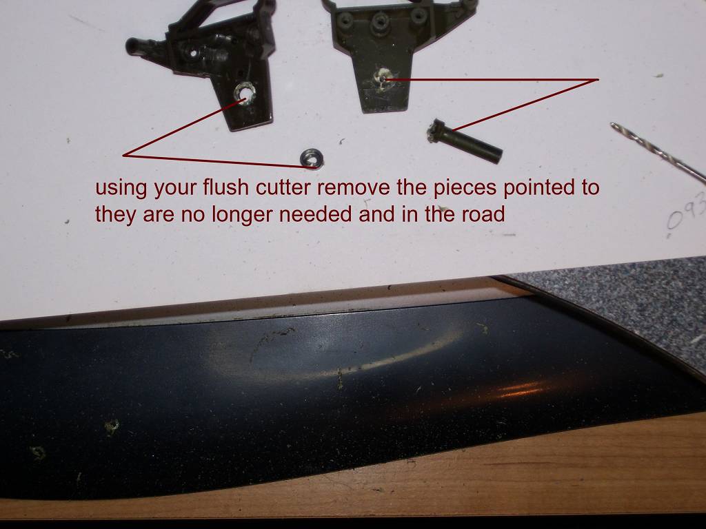

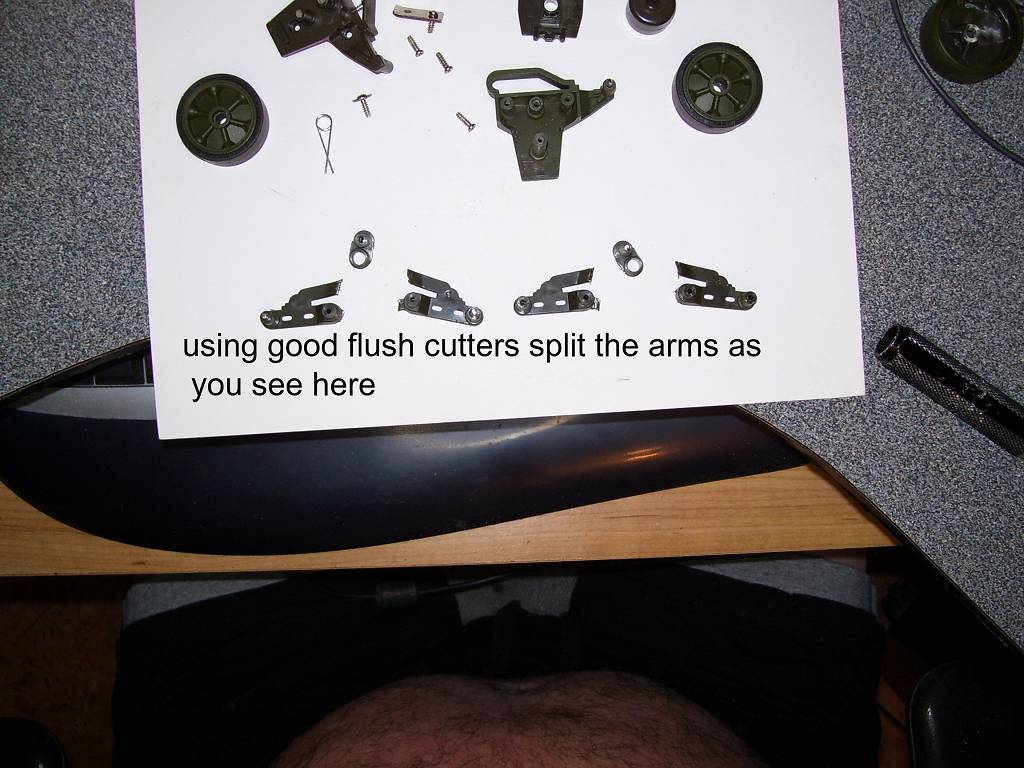

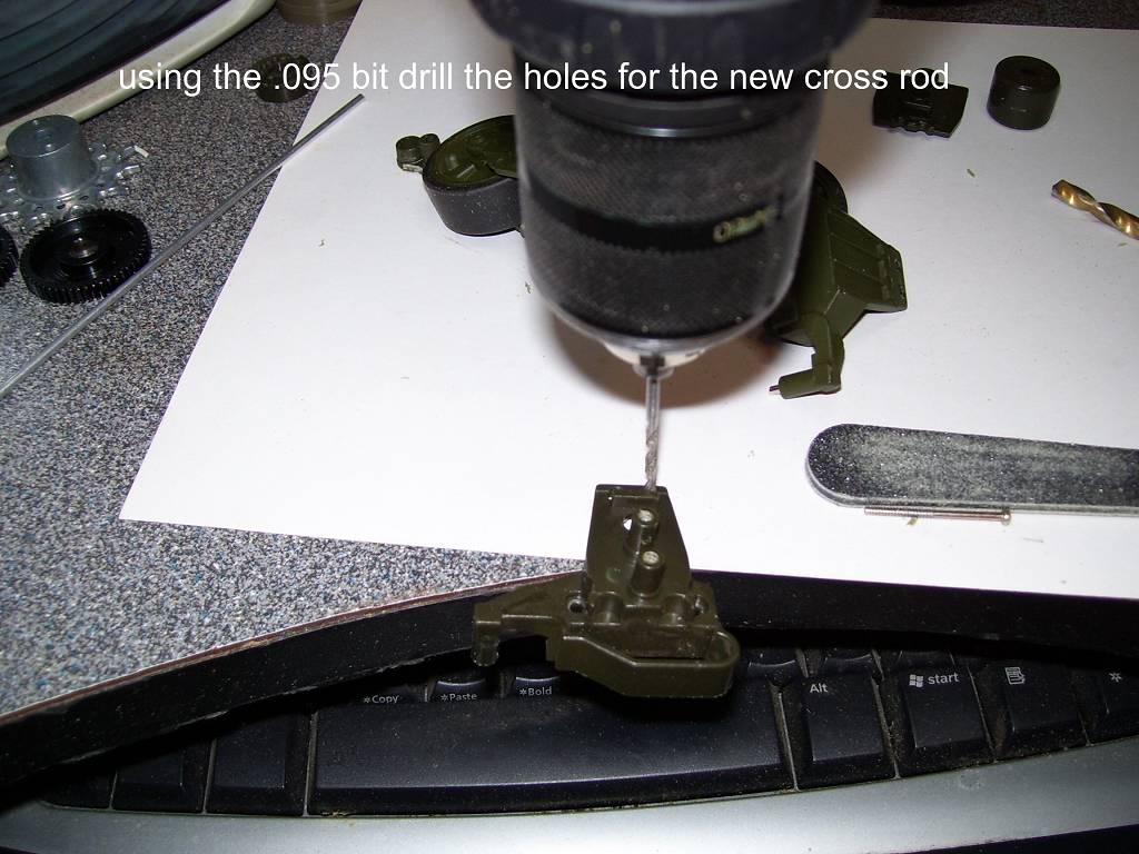

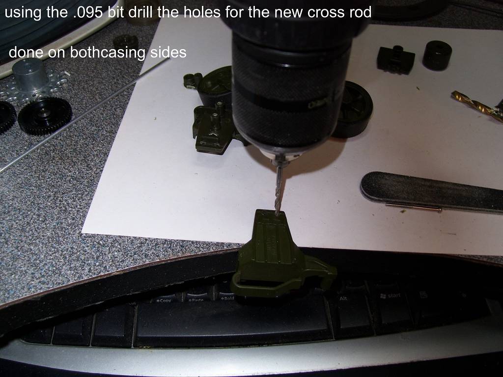

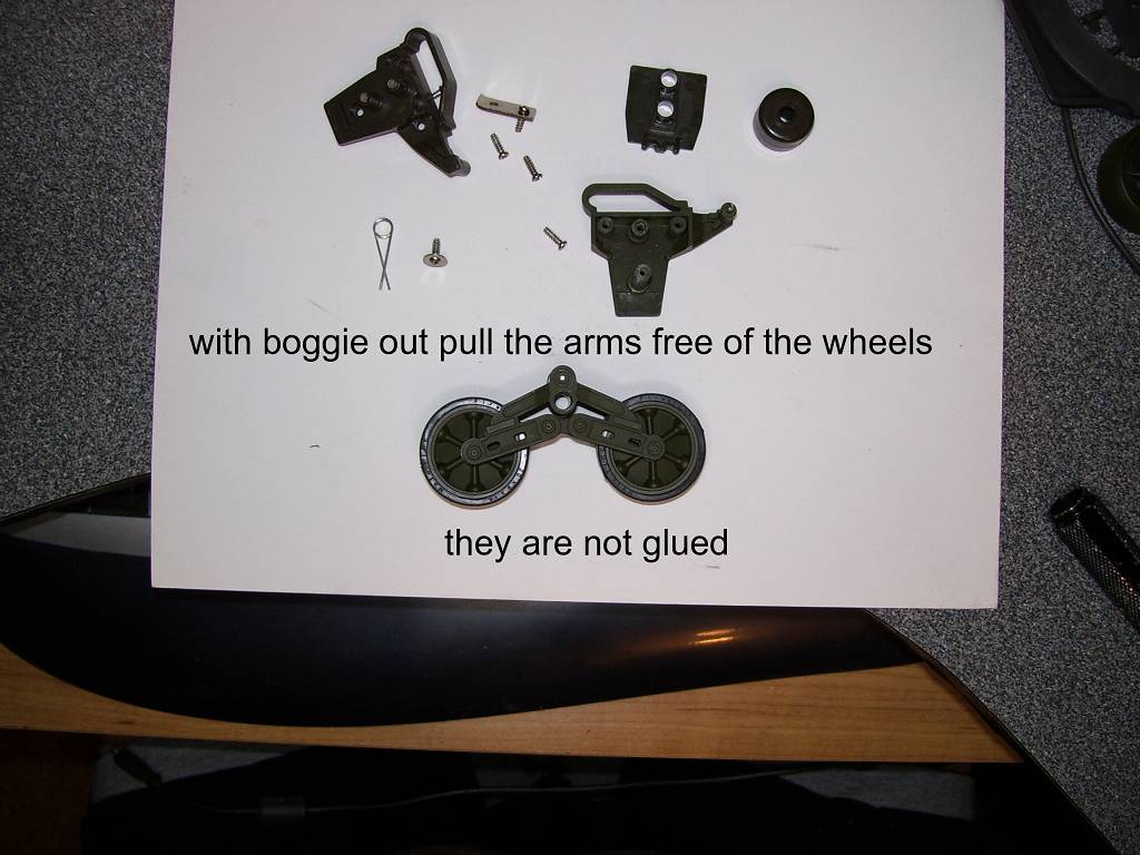

and darkith yes I assembled some DBU's for bill but that was all i did nothing more than that
part 1
ID:	1306249   Click image for larger version
ID:	1306250   Click image for larger version
ID:	1306251   Click image for larger version
ID:	1306252   Click image for larger version
ID:	1306253   Click image for larger version
ID:	1306254   Click image for larger version
ID:	1306255   Click image for larger version
ID:	1306257   Click image for larger version
ID:	1306258   Click image for larger version
ID:	1306259   Click image for larger version

re uploading pics in order

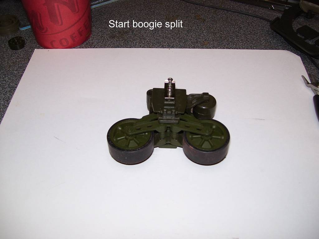

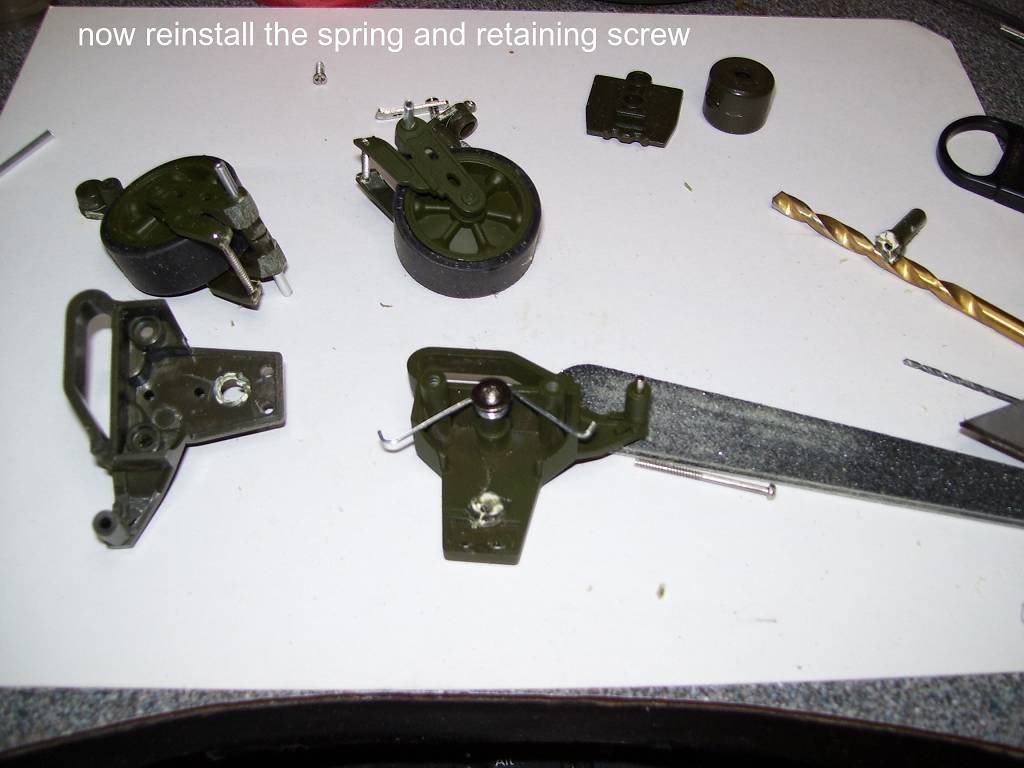

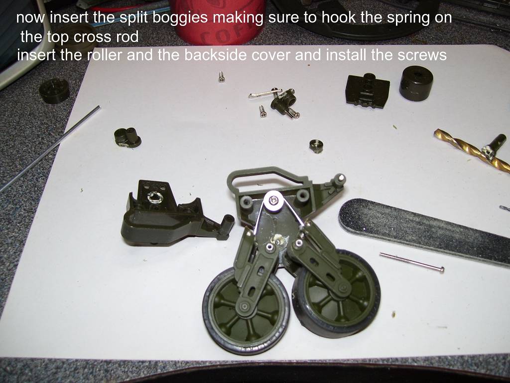

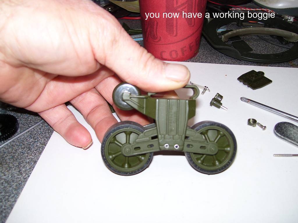

part 2 http://www.youtube.com/watch?v=nLKD7_kU56Y
ID:	1306271   Click image for larger version
ID:	1306272   Click image for larger version
ID:	1306273   Click image for larger version
ID:	1306274   Click image for larger version
ID:	1306275   Click image for larger version
ID:	1306276   Click image for larger version
ID:	1306277   Click image for larger version
ID:	1306279   Click image for larger version
ID:	1306280   Click image for larger version
Old 11-01-2009 | 05:24 PM
bubbajoexx's Avatar
Joined: Jul 2008
Posts: 803
From: toronto, ON, CANADA
Default RE: splitting the bogie

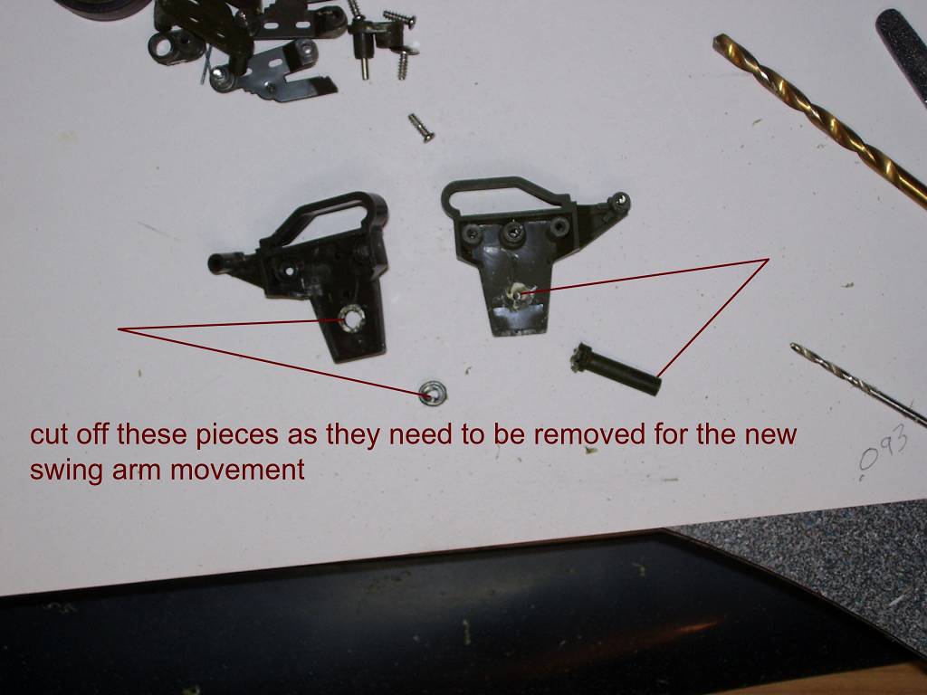

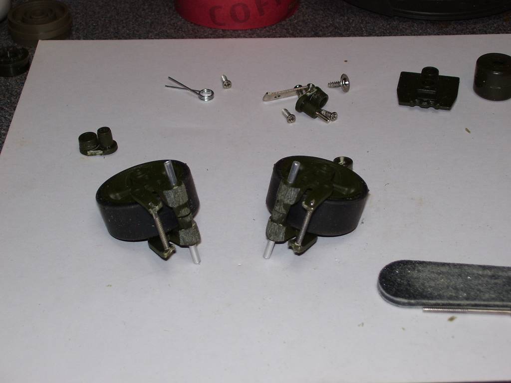

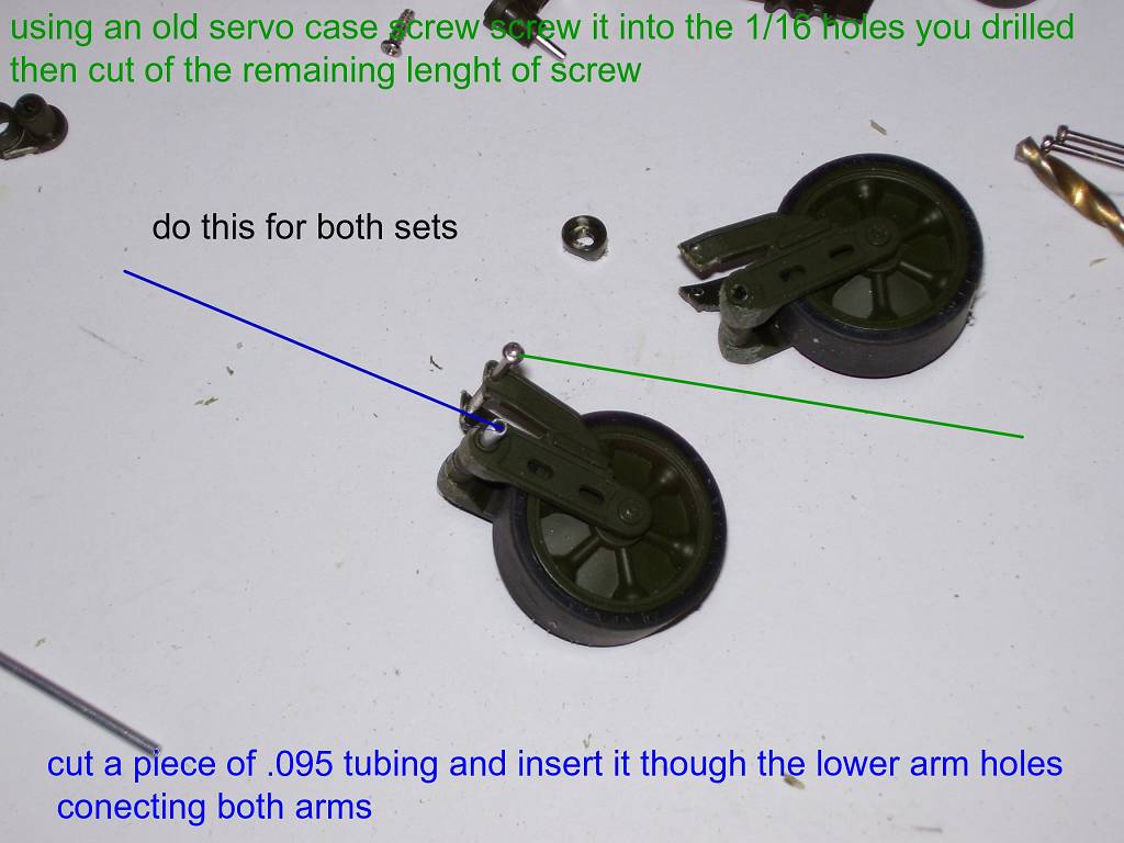

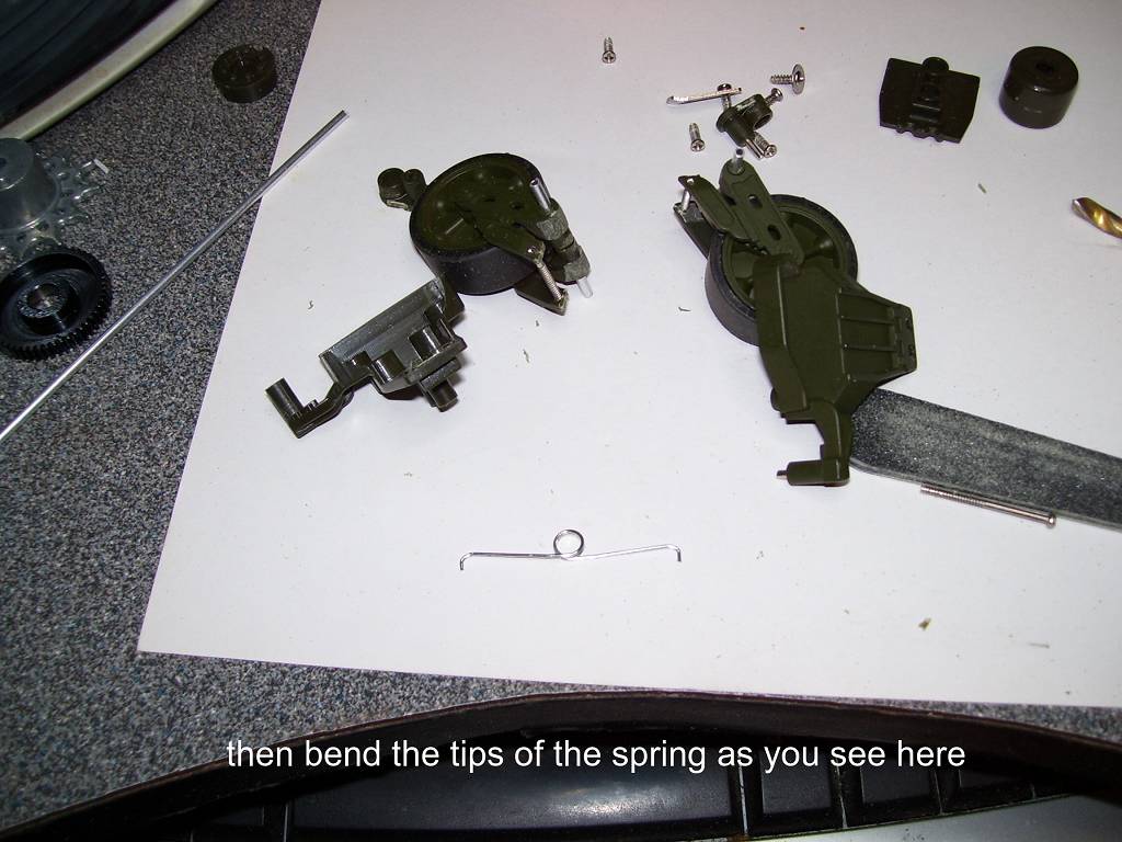

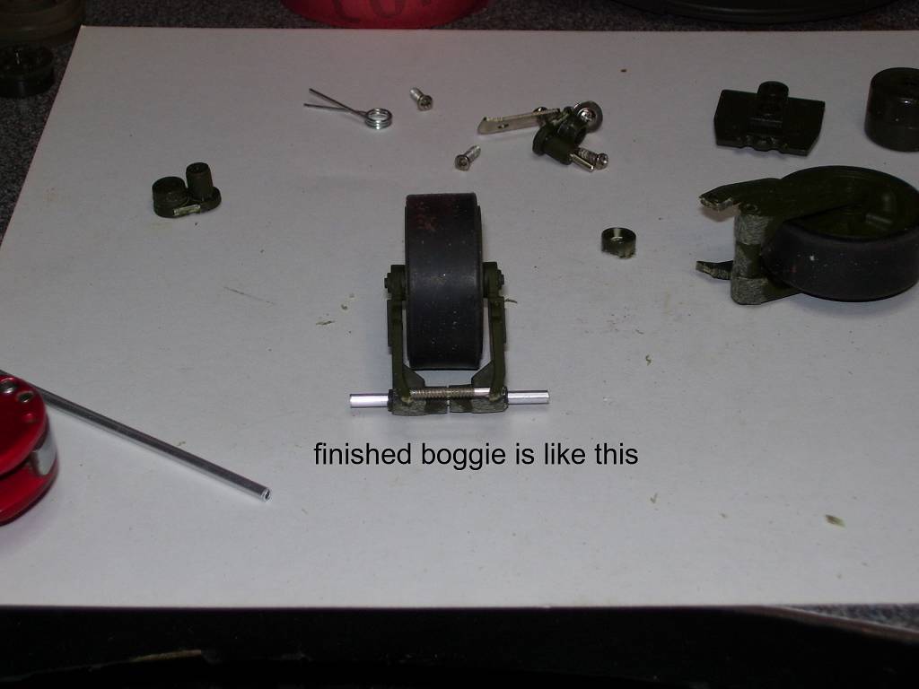

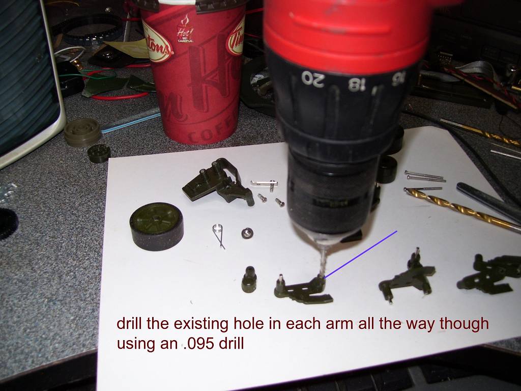

instructions are imprinted on each pic
ORIGINAL: pattoncommander
splitting the bogie????? what are you trying to accomplish?[sm=confused.gif]
independant movement of each road wheel

Great work Bubbajoe! My concern is if the spring has enough tension to support the tank. Looking forward to your video after re-assembly.
spring works great i have the boggies on a tamiya hull and I have wieghted it down with all of the internals including the heavy gearboxes and battery it holds the tank up great

yes but the plastic is light and flexable so trying to do it to scale was out of the question
if it was metal it would be no problem to make it work like the original
