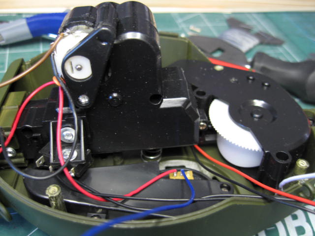

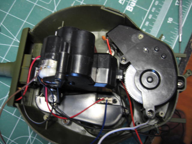

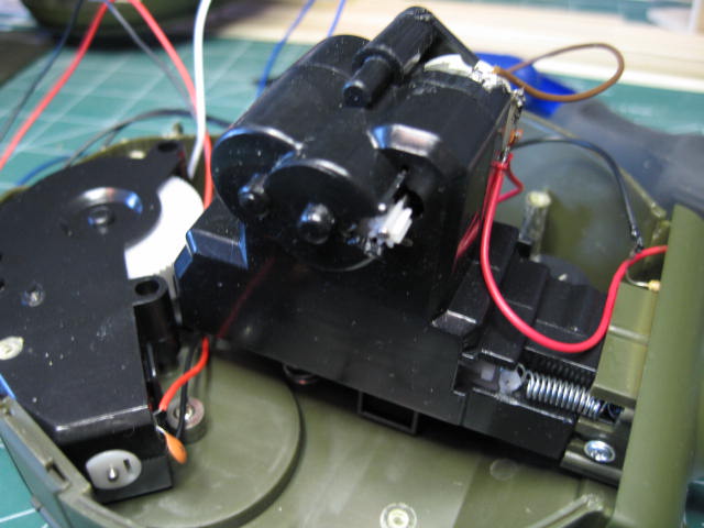

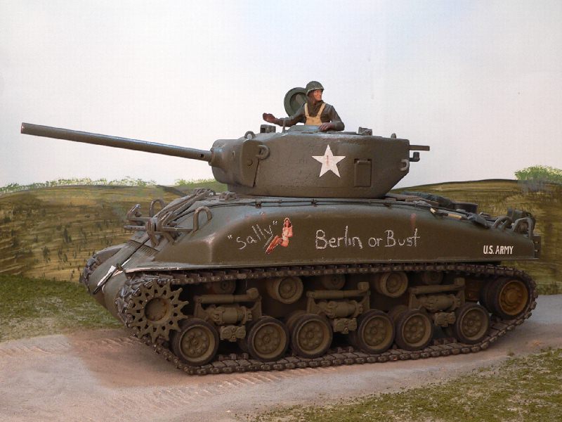

Hi All,
I need some help. I took apart my mato Sherman to do the turret lowering mod that YHR did. As I took the lower and upper turret apart. some wires came loose ( lousy soldering job). I have all the wires back in place except for the airsoft gun wires ( two black and a blue and a brown wire. I tried what I thought would be the logical hook up and as soon as I turned the tank on, I had smoke from the board. What I really need is a pic of the wirering inside the turret so I can replace the wires correctly and hope I haven't permenatly fried the board. All Help will be appreciated.

YHR,
I have all other functions, just no airsoft gun? Still would like a pic of the inside turret to see where all the wires go. I may have fried the airsoft function already, just don't know until I find out how to wire it correctly. Your turret mod does make a world of difference. Even if I don't get airsoft back, still glad I made the mod. Thanks.

I slid a brass tube over the airsoft bbl to return the length to normal and give it a slightly bigger diameter. It looks OK. I'll grab a picture and post it. First picture shows just the airsoft tube, and the second one shows a brass tube fitted over the bbl

All,
First of all, I agree with Snowtank. My Sherm was working perfectly. It wasn't until I took it apart to make some mods the I ran into the wiring problem.
Hdbeast, thanks so much for the pics. with your help as well as help from YHR, I know have my airsoft back working. I was amazed, even after the smoke from wrong connections. As soon as I had the wires connected properly and turned it on, She shot. That should say a little bit about the robustness of the electronics. I was over joyed when everything still worked, but now I still have my airsoft. Thanks guys. And now I'm after the cat. Just kidding.
