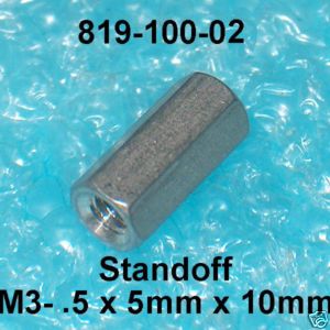

This will help alot, thanks. But I dont quite know what you mean by (small brass hexagonal standoffs used in desktop pc applications). could you find a picture of one?

Also if you search fleabay for standoffs you get a good idea, they typically are used to attach cables to computers so they dont come out, like desktops to monitors

Only possible problem I see with the standoffs you've found is the height. 10 mm is about 0.400". Thats probably too tall and would have to be cut anyway. I'll try to take some photos of my install tonight and post
