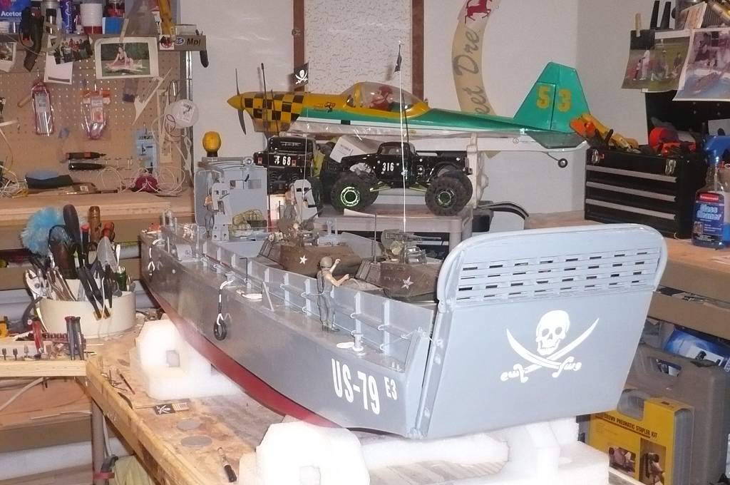

this is what i am going to us them for ,and the tigers waiting on the shore line going to make a movie in the spring with my freinds here the vidio and pictures , good luck, thanks rye
http://www.youtube.com/watch?v=m87ls-CLQUY
