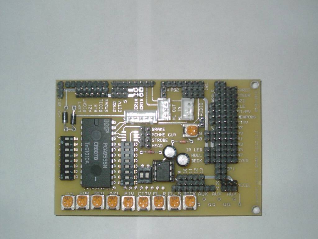

Got the first prototype board built up. Im getting excited.
ID:	1433127   Click image for larger version

I'm also working on a sound module similar to the creepingdeath unit but using a very cheap design. sub $20.

This design will have engine sounds (not the best in the world but no worse than HL i wouldnt say) digitally created on board and all the gun and track sounds etc. will be on the same external SD card board that bills battle unit uses now. Neutral engine revving is actually harder than it seems it would be to do. Its dificult to get it to sound correct revving the unit up quickly, but I have enlisted a friend of mine to help me develop on an STM8S-Discovery board. I told him if he helped me get up to speed on the Cosmic C compiler id help him tune the software on his quadcopter. so we will see.

Is anyone else who has an arduino mega that is interested in working on software? I have a few more blank boards im going to populate and give away for anyone who is interested in helping with code development. The sections that need developed are the battle system code, the code to connect to the sound modules, and some I2C stuff. Let me know and I will clean up the documentation I have now and get those boards populated.
