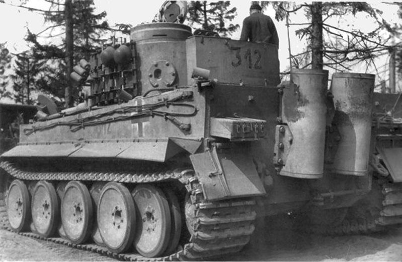

The idea behind this comes from people studying many Tigers after the war some insist that these pitting marks are from the factory these claims are usually made by people who understand very little about engineering and what they are looking at firstly things like the mantle and various engine vents would be cast and of cause have a cast finish so would be rough, German armour plates where of rolled steel what this means is the steel would be heated to almost white or over 1000 degree would then be pulled through a pair of large rollers and would reduce the thickness of the steel this would be done several times till the steel reached the desired thickness so any marks would have come from the rollers and would be consistent all along the plate however modellers have been studying tanks that have sat outside for 60 years with little protection or paint and it would be fair to say that they have rusted considerably over the years this will have caused most of the pitting that is being recreated the other thing is multiple layers of paint some has come away with rust leaving a sharp edge then repainted several times again this has been recreated so what is being modelled is a restored tank, probably the only tank to have been looked after to any extent is the Bovington Tiger if you look closely this Tiger has far less surface imperfections than any other tank but is overlooked or ignored so if you insist on this type of treatment then do it sparingly, as for the “Modellers Guide to the Tiger Tank” talented as the author is there are a few mistakes in the book the biggest is his version of Wittmann’s Tiger he depicts this as a mid Tiger when it was actually a late Tiger one only has to study the picture to verify this fact.

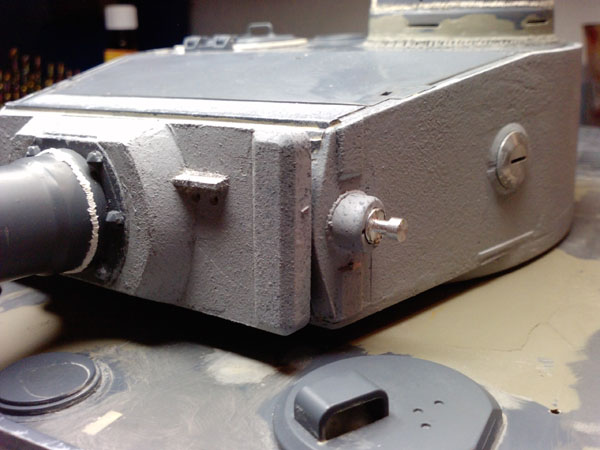

Don I like the Mr. Surfacer 500, I see a lot of the german builders finishing theirs with it. As for the parts your talking about, you could try it and just sand it down if it doesn't look right. The Tamiya KT turret is rolled steel if I am not mistaken and it has the same texture your talking about. That texture came from the Tamiya factory. My JagdTiger has Mr. Surfacer on it, but barely noticeable 3 feet away.

I would probably leave the cuppola and barrel smooth.

Anything cast will have a rougher surface texture. Anything machined (even if it was originally cast), stamped, or rolled/drawn will be smoother, like sheet steel, of course when new, not after years of neglect.
In essence, you need to know what was cast and what was not. If engine grates were cast and not machined afterwards, they would be textured as such.
From the picture of 131(?) shown here http://the.shadock.free.fr/Surviving_Tigers.pdf it would appear that almost all the vertical surfaces were NOT cast, short of the mantlet. (at least at the time of its manufacture)

jwilliams3 the picture of your turret looks a though all was cast this is in fact not true, yes the turret was cast but at the scale you are modelling it wouldn’t appear as you have done it would be smoother, as for the main turret dayeager535, is correct that all the main panels where of rolled armour this includes the turret which was initially rolled flat then bent into the horse shoe shape so would have a completely different texture than the cast mantle things like the pistol port, main gun ETC where machined or a mixture of cast and machineing

Rivotcounter has raised many valid points,but we can see the Tiger built from start to finish in pictures.And the texture of the rolled components would be smooth as the term hot rolled steel (HR) or cold rolled steel(CR) But most rolled steel is smooth and that is the texture that new TIGERS would have,Also the debate on the texture of the cast components depends on how much machining was required to complete these components.Thankfully the pictures of the factory have survived,and their are many detailed pictures of the whole assembly line,each section.I would like to ask one question about one Tiger component that seems to always have a texture but is built useing cast hub and machined parts,the drive sprockets.Here's a link to the factory pictures. http://www.alanhamby.com/history.shtml

Sax, as you say the sprocket hubs where cast obviously the runs for the sprockets would be machined as would the inside this would be mainly for clearance of final drive cover, the centre would also be machined the rest would be left in a raw cast finish save for the pour plug marks.
All Tigers had there turrets made at Krupp the horse shoe shape was stamped from one large flat sheet the right side protruded more than the left to give the asymmetrical shape, there where no modifications to the turret other than the 40mm turret roof and internal details, the initial Tigers a small number had no escape hatch and twin pistol ports
