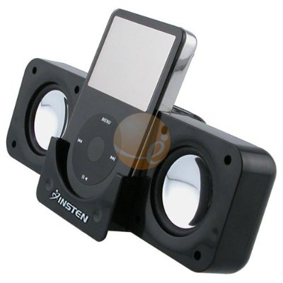

Well, I purchased the Radioshack speaker/amplifier that I inquired. Only got it because it was on clearance at my local RS. So,.......
Pass.
It's horribly loud with distortion cranked up.
I'll keep it anyway, cause I'm a gadget nut. But, it appears that the built in speaker cannot handle what the internal amplifier can put out. So, I wonder if I gut the internal speaker and replace it with a slightly bigger one that is 4 to 8ohm rated rather than the 16ohm speaker in this device. Then use this device in conjunction to the HL board.
I'm not electronically inclined, so I'm not sure if it's worth the while or will work at all.

I also ordered this today, coming from HK..... http://cgi.ebay.com/Mini-Stereo-Port...item27af006f70
it's gonnna be atleast 2 weeks for it's arrival, but I think this has the best potential and will likely be able to fit both speakers in the tank due to it's size. It's a whole lot more powerful than this RS amplifier with a superb frequency rating and at 4 watts total, (2 watts per speaker).....with a signal rating of 90db! This sucker better be as louds as the specs claim!
If it does need help to add a little more umph in the bass, then I'll modify the housing to suit a better enclosure, but we'll see.
But, at less than10 bucks...can't really complain too much.

I finally got around to testing the Radio Shack speaker amp. I spliced a female 3.5m jackand connected it to therx18 boardto make this easier on me. I will say the result of the RS speaker amp threw me off a bit. It was atleast 2 times louder than the standard HL speaker. But really lacked in bass. The RS amp could barely be at full blast before painful distortion kicked in. But overall, an improvement over the standard HL.
Since I spliced the female jack into the rx18, it let me try a few other portable speakers. The results were not so good, although they are bass heavy and clean sounding on the intended devices, they really lacked volume using the HL board.
I suspect this is because they were portable STEREO speakers rather than mono. But, not cutting up my portable bose and sony speakers for this.
