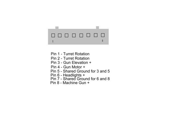

Try this Don,
Matorro is different but using the same signals it should work the same! So you would use Pin # 2 , 3 & 5
The Blitz

Thanks Blitz,
Here is what I have. It is a 10 pin connector. Strange, but here is how they have it
Pin 1 - Red To the Headlight
Pin 2 - Black Common of headlight and hull MG
Pin 3- Blue Turret Rotation
Pin 4- Yellow Turret Rotation
Pin 5- Brown Elevation
Pin 6- Green Elevation
Pin 7- White ?
Pin 8- Orange To Hull MG
Pin 9/10 Blank
What do you make of that? Never seen one wired like this before.
Don
