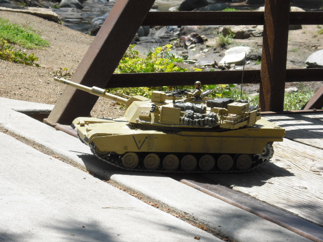

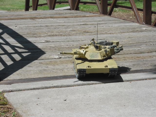

Another Abrams upgrade!

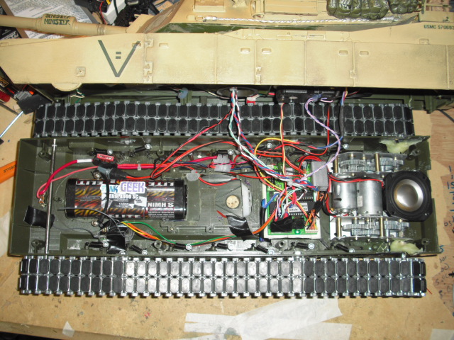

This one is all HE Abrams top & bottom hull, using the HE suspension. Kenny Kong Abrams metal
tracks & drive sprockets! Some suspension changes that needed to be made, I fabricated some spacers
that are needed for the drive wheels to keep the track from sliding side to side. (Gregg on the forum is
working on a spacer set for this problem and will be much better then my solution) I used the Panzer III
metal track rollers for the top rollers! I had to buy some screws from Home Depot and turn them
into the longer axles. This gave me the reach I needed so they would work correctly as top track guides. The Gearbox is
the Heng long Jagdpanther/PantherG gearbox, with standard HL engines. I had to make some custom
sleeves to go over the axles and lock them down to the side of the hull for strength.
The Electronics are EL MOD with the Abrams sounds custom installed. This set up uses 2 small TangBan speakers, the one in the hull is a little more bass and there is one in the turret, that is full range.
Below are some pics and video of the tank in action, not very fast, but it has power!
