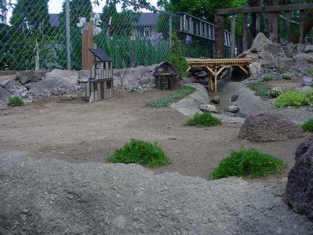

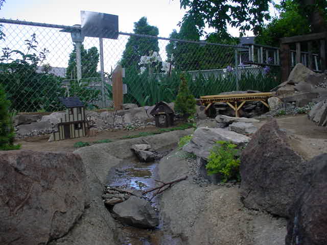

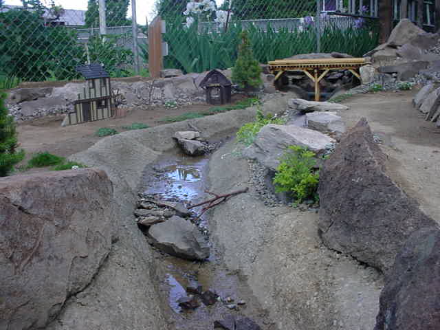

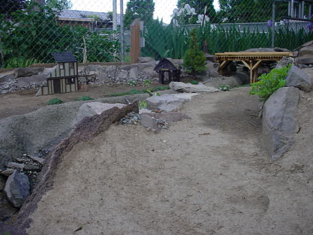

As for Myself, No real progress this week. Still waiting on parts for the Hummel and need to order parts for my PZIII F, Kinda like another Metal lower. I liked the last one so much I now will need one for all my PZIII Variants.
I did get a little done on the outside area though. Built A Shallow waterfall and am working on placement of a few buildings before I add a lot more Wreckage. Here are a few shots.
