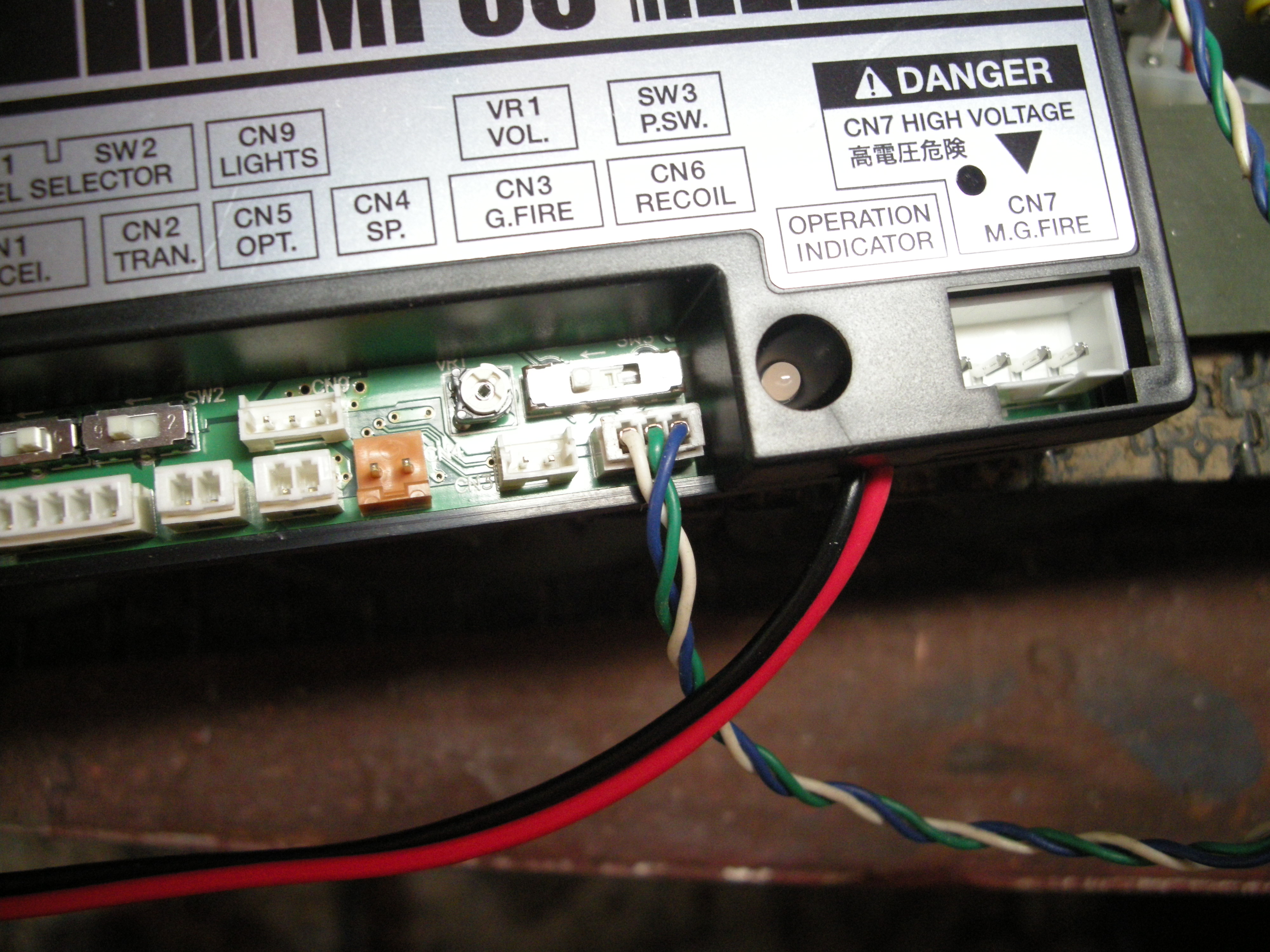

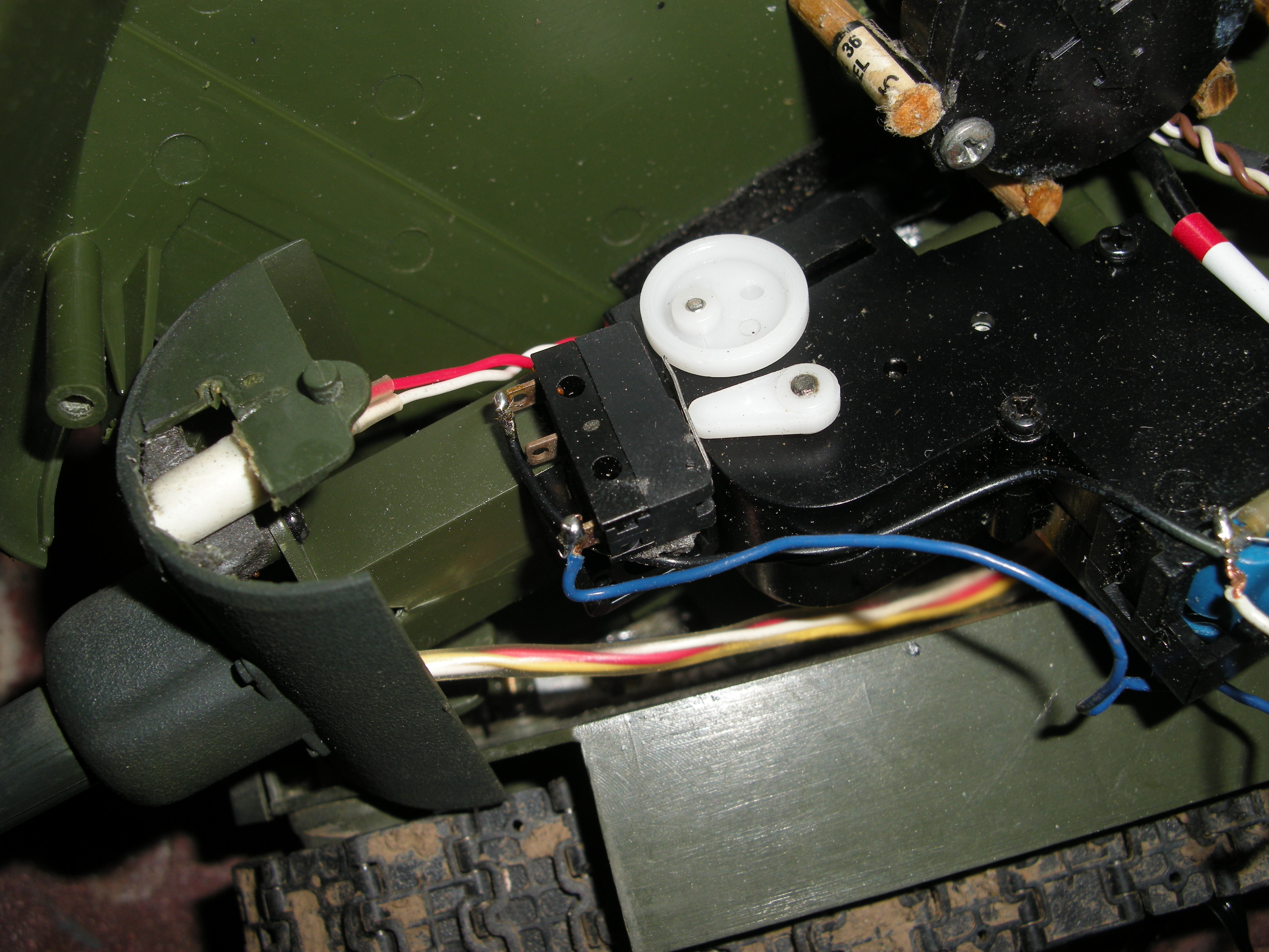

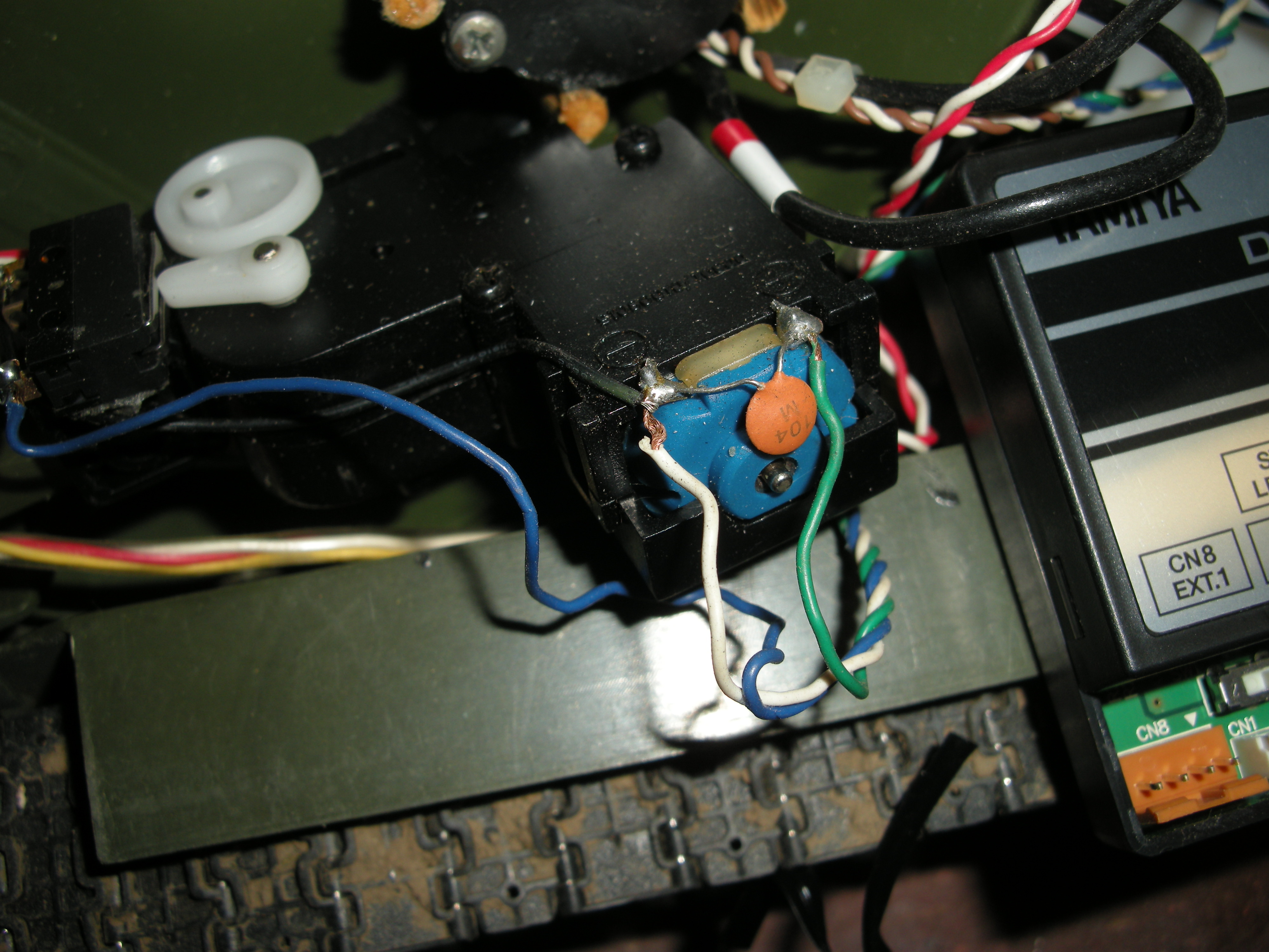

Well guys i did it again. i went FO with one of my new T-34/85's. Everything is going great. just need too know if anyone knows how too hook up the WSN recoil and flash trigger too the 3 wire Tamiya plug. The T-34 has what looks like 4 wires too perform this function but the Tamiya system only needs 3. Anybody try this before? Help a brother out. LOL Oh, I'm using the Tamiya KV-1 electronics package the TO-6 and MF 08 i believe the numbers are. thanks again.

here ya go

So it looks like i have to provide my own micro switch and configure it too work off of the cam instead of the contact switch that is stock on the WSN gun. Is this correct klank? It also looks like a black wire acting as a common is that what it is and where does it go. Good pics though, lots of help thanks.

you have got it ,and your welcome

Thanks again, those pics really helped. I have a spare Tamiya early Tiger recoil unit I can grab the micro switch from AND the 3 wire plug from it so I should be good too go.
