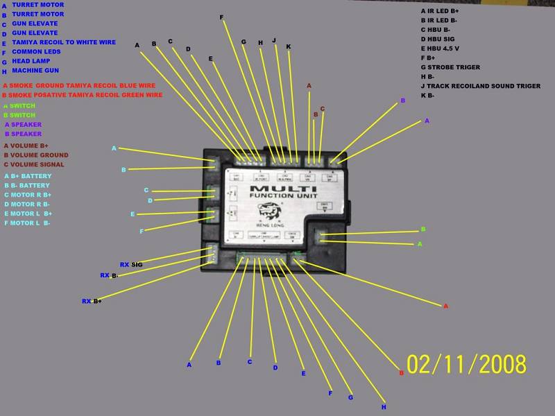

Just remembered,
This might be what you are looking for.
Hope it helps!
Don

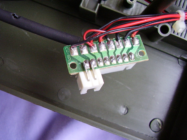

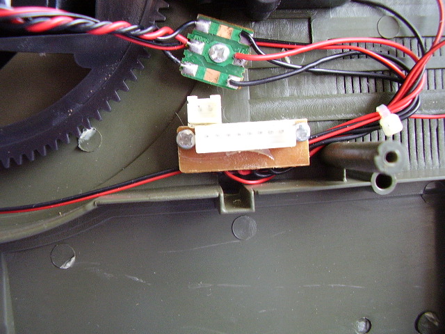

Is it a pershing if so the rear lights plug in on the upper hull
regards Jack.
ID:	1449938   Click image for larger version

Does this work for the bulldog too?
Old 06-09-2010 | 03:06 AM
afv
Joined: Sep 2007
Posts: 76
From: st helens, UNITED KINGDOM
Default RE: Rx-18 help
Yes, the pictures i posted are of a bulldog.
