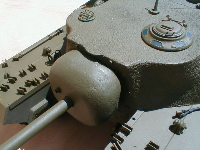

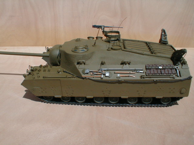

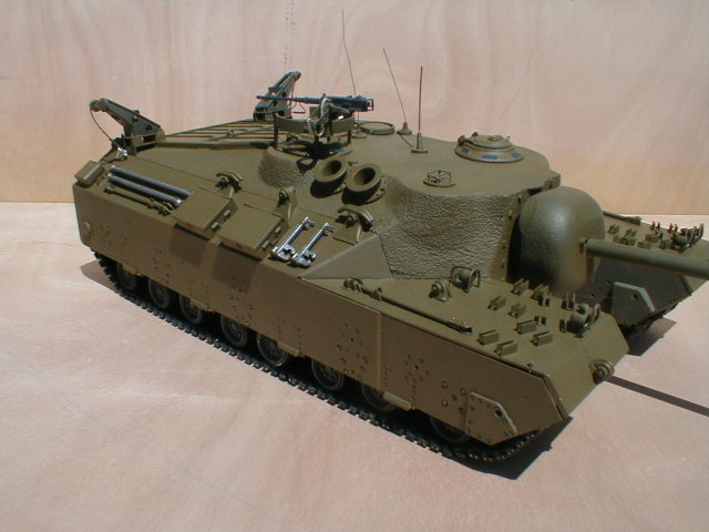

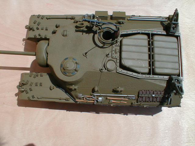

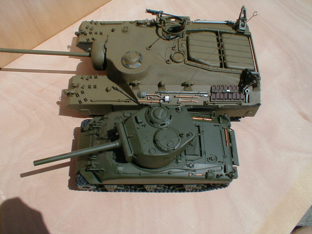

Hide your Maus, your Elefant, your E100, and your Teeny Tiny KingTiger!
I am coming for you in my Hun Hunter, my Bosch Beater, my Kraut Kicker, or whatever this wuz gonna be if it had been operational before WWII ended. I know it was designed as an assault gun, not a tank hunter, but it is my model and I can pretend it is anything I want it to be. As soon as I finish building the wings and pontoons, it will fly and float as well. Golly, now that I think about it, didn't the the Russians already develope one of those in 1936?
A T28/T95 Super Heavy Tank was the last thing I ever imagined that I would ever scratchbuild....... Uhhhh..... I mean......assemble from assorted materials suitable for building model tanks.
Now I know why I never imagined I would build it. It was a pain. Originally, it was going to be R/C, but that idea died an early death. It's a good thing you can't see the suspension, unless you really like Mickey Mouse rigs. Thank goodness for anti panzerfaust sand skirts! The track is from the HL Pershing. It took three sets of Pershing track and sprockets from Phil at RC Tank Wars to put shoes on this beast. The muzzle brake and .50 cal MG are "borrowed" kit items, but the rest is made from "basic stuff", or made from molds of kit parts. I worked on this model every day since Father's Day. As usual, it's the detail work that tried my patience and made me an alcoholic.
For the rest of today, I'm gonna enjoy thinking that this is "the only 1/16 scale T28 model" in the world. Tomorrow, I'll betcha 50 guys will post photos of theirs! And then Heng Long and Tamiya will announce the release of their battle ready example for only $150. Well, maybe not Tamiya.
I would be interested in your opinion of the texturing. I tried to duplicate how the main center hull looks, which was a casting on the real life 1:1 tank. I tried a new process (to me) and can't decide if it's sorta ok, or kinda crappy. Either way, I think I know how to do it better next time. I spray painted the parts to be textured with automotive primer paint. Then I quickly poured a container of table salt all over it. After it dried I brushed it off, and sprayed it with primer again. Later it got the OD paint job. The primer dried too quickly....... I expected the salt to dissolve and flatten out more than it did. I goofed on that........oh well. The gun mantle turned out better, I sanded the salt lightly before final painting. My tank may not look perfect, but I'll bet it tastes great!
At this point, I don't whether to turn this thing into a skate board or a mailbox.
The one encouraging thing about doing this model is.......maybe a Churchill would be a piece of cake by comparison.
Hmmmmm, I think I feel another brain cramp coming on.

The T28 started to be an R/C model, but it would have faced the same problems as the real one. Where could it operate? All of the battle sites that Kellys Heroes has, have roads, bridges and tunnels that would be too small to navigate. Also, driving all four tracks was a problem. Just driving the inside tracks could cause getting "high sided", similar to getting "high centered". And, I also got lazy.

I cheated on the suspension parts. Since the suspension doesn't show, I only made resin copies of the outside road wheels from the Tamiya Sherman. The parts that you can't see are made from wooden dowels and plastic and brass rod. Each pair of road wheels pivots on a rocker axle, but that's it. If that tank didn't have those skirts, it wouldn't have been built.

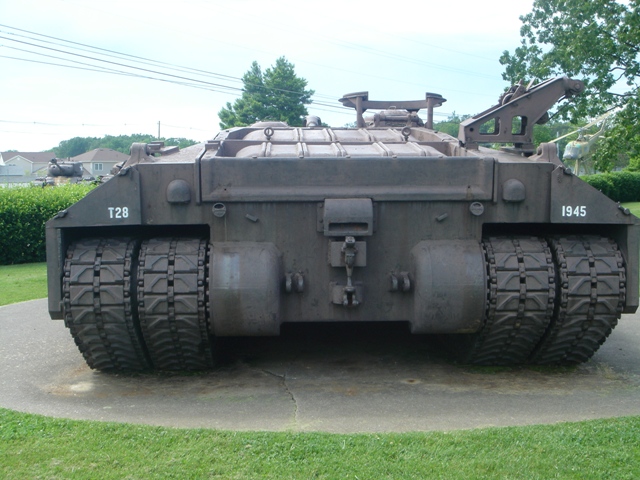

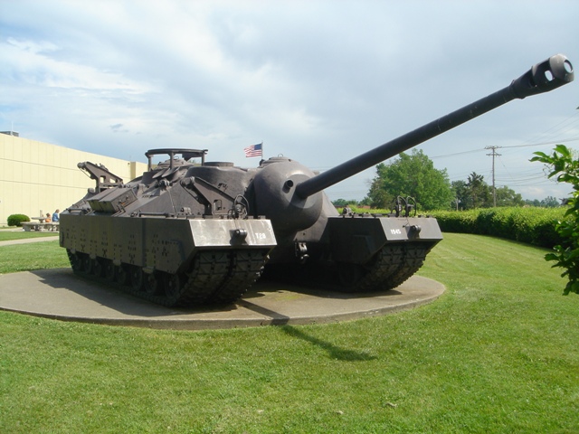

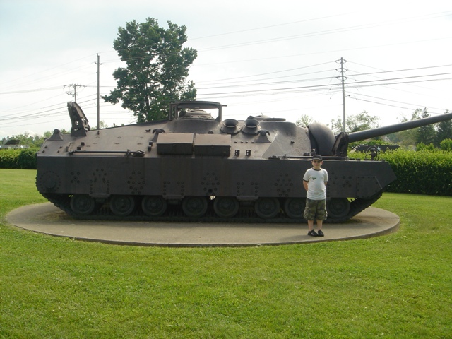

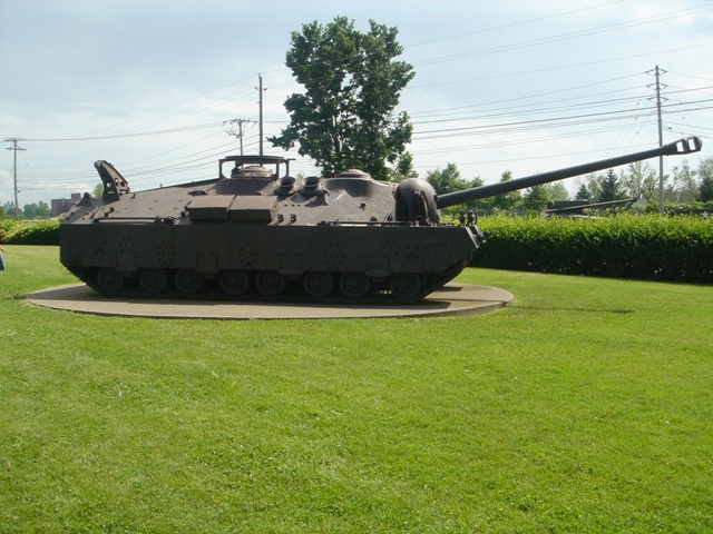

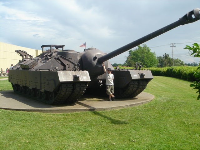

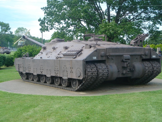

Awesome ~ great job! thanks for posting... Here's the one that was at the Patton Museum

Am I mistaken or is that four sets of Easy 8 bogey wheels peeking out from under the skirts? And was the outer set of tracks just idlers, as per the not symetrical alignment of the rear drive sprockets? Or is the not symetrical alignment in the rear drive an effort to stop some of the harmonic resonating of the tracks?

The bogey wheels are resin copies made from the Tamiya Sherman. I made a latex mold of one and cast them with resin. All of the inside road wheels are wooden dowels cut to fit (and painted black). Every source of info that I could find indicated the outside tracks were freewheeling idlers just to reduce ground pressure, and were not driven with a spline (or something) connecting to the inside track sprocket. The photo of the rear end of the T28 at the Patton museum shows that, but it's not easy to see unless you have a good photo. I was going to align them with a long pin that went through both sets of tracks on each side, but I ignored that when I decided not to R/C it for now.
