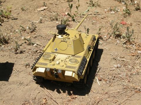

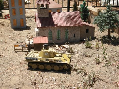

After so much outstanding work that has been shown this week i humbly present my Panther F, Heng Long with Tamiya FO, Mato 3:1 gearboxes but not much other great stuff

I'm diggin it! Love the buildings too!! You planning on weathering it or just gonna let nature take over?

i used a mild wash then finished with dull coat. weather and combat should do the rest.

Very nice. I like the tank and the backround!

Looks great. How has the Mato gearbox been?

When i used metal track it would not work well. primarily wanted to skip gears in reverse due to case flexing. I switched back to stock track ad it works perfectly. I had similar problems with my elefant. a lesson learned here being that the long shafts used on a heavy tank are a recipe for failure due to case flexure. the short shafts on a Pnzr III or IV have a better chance for success.

the background is part of a battle layout planned for the Aug. 22nd meeting of Kelly's Heroes.

Looks great and the building look good too.

Nice Panther F in a nice setting excellent work all round.
