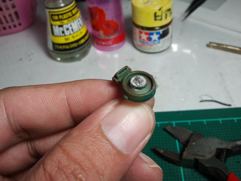

taksinsugo 09-11-2013 03:44 AM
Modify HL LEOPARD2A6 !
21 Attachment(s)

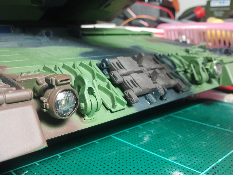

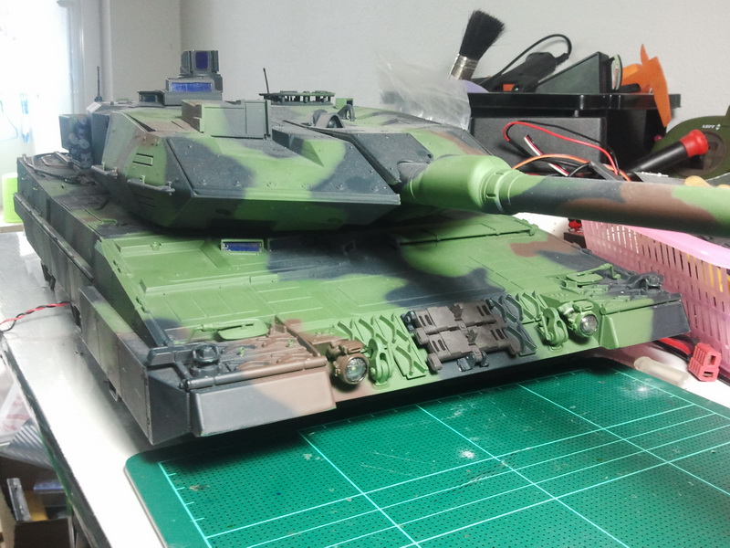

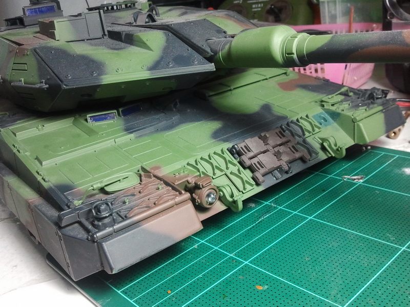

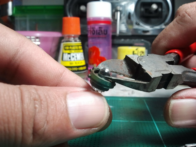

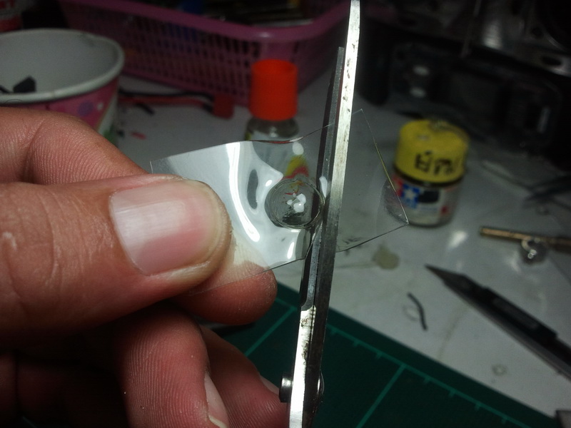

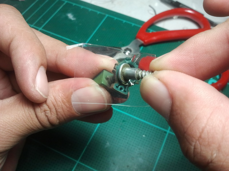

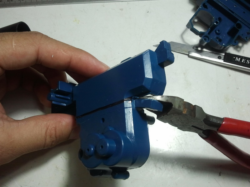

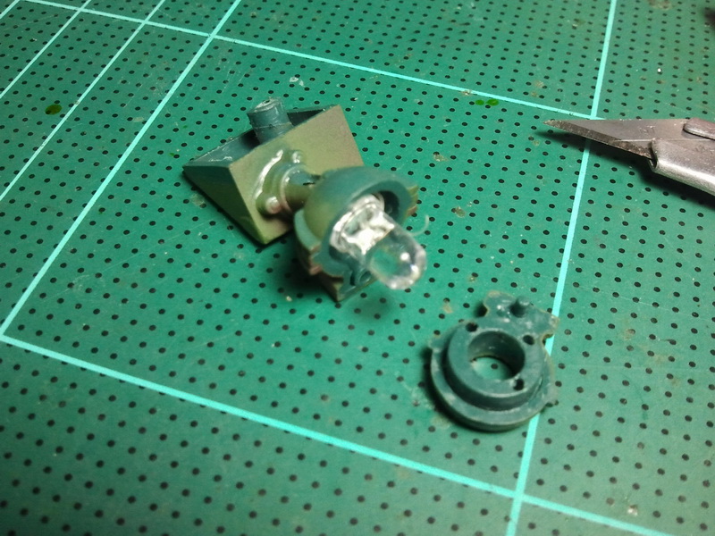

Hello Tank commander.today i am modify head light HL Leopard2a6 , it easy and to share for everyone . Let do it...
This is original from HL.
http://www.rcuniverse.com/forum/atta...mentid=1919128http://www.rcuniverse.com/forum/atta...mentid=1919129
disassemble cover head light.
http://www.rcuniverse.com/forum/atta...mentid=1919130http://www.rcuniverse.com/forum/atta...mentid=1919131

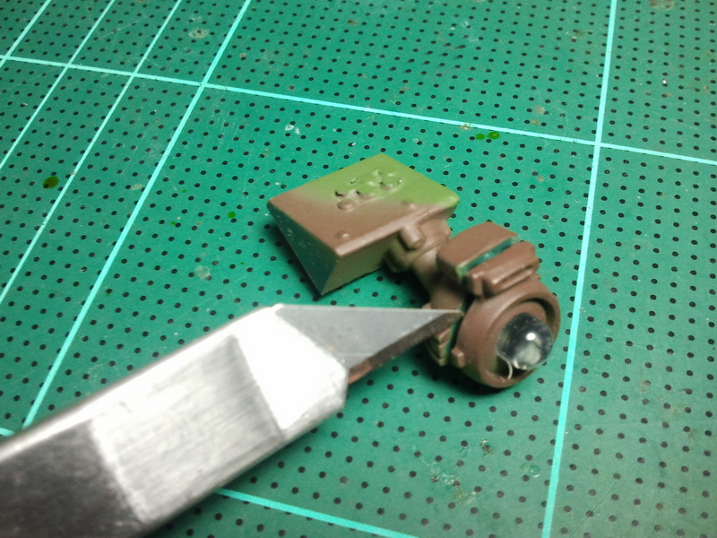

use cutter to break cover headlight.
http://www.rcuniverse.com/forum/atta...mentid=1919132http://www.rcuniverse.com/forum/atta...mentid=1919133
Cut it out! ;)
http://www.rcuniverse.com/forum/atta...mentid=1919134http://www.rcuniverse.com/forum/atta...mentid=1919135

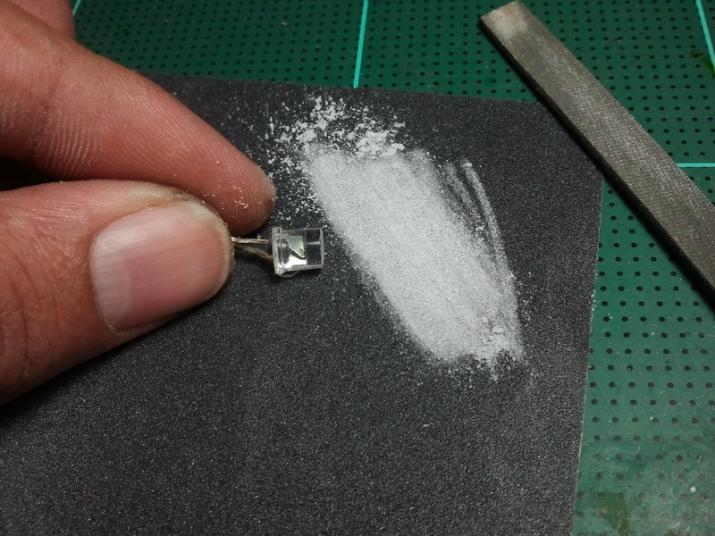

Polished with sand paper to smooth.
http://www.rcuniverse.com/forum/atta...mentid=1919136

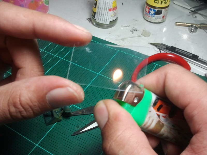

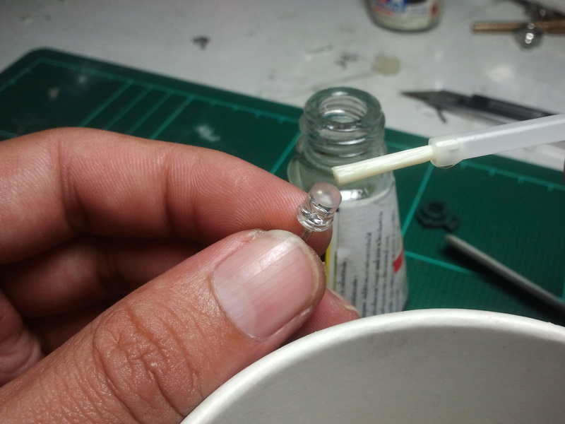

Use the cement liquid for Makes clear.
http://www.rcuniverse.com/forum/atta...mentid=1919137http://www.rcuniverse.com/forum/atta...mentid=1919138http://www.rcuniverse.com/forum/atta...mentid=1919139

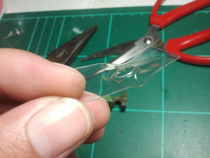

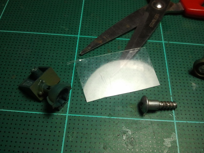

Using plastic sheet and nut for make cover head light.
http://www.rcuniverse.com/forum/atta...mentid=1919140
Glen fire soft
http://www.rcuniverse.com/forum/atta...mentid=1919142
Press nut to cover light
http://www.rcuniverse.com/forum/atta...mentid=1919143http://www.rcuniverse.com/forum/atta...mentid=1919144
Cut the cover light
http://www.rcuniverse.com/forum/atta...mentid=1919146

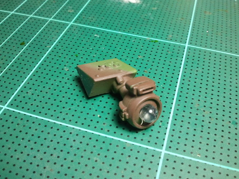

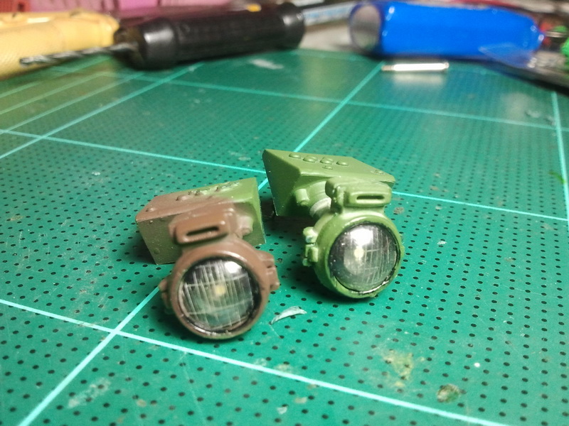

Draw a pattern on the cover.
http://www.rcuniverse.com/forum/atta...mentid=1919147
and finish
http://www.rcuniverse.com/forum/atta...mentid=1919148http://www.rcuniverse.com/forum/atta...mentid=1919149http://www.rcuniverse.com/forum/atta...mentid=1919150
YHR 09-11-2013 05:30 AM
Nice tutorial. Easy to follow with all the good pictures you took
borealis 09-11-2013 10:22 PM
Well explained, and a very good result, thank you.
This can also be applied to all other HL tanks.
taksinsugo 09-11-2013 10:28 PM
Thank you for comment. Yes! it can apply to other HL Tank.

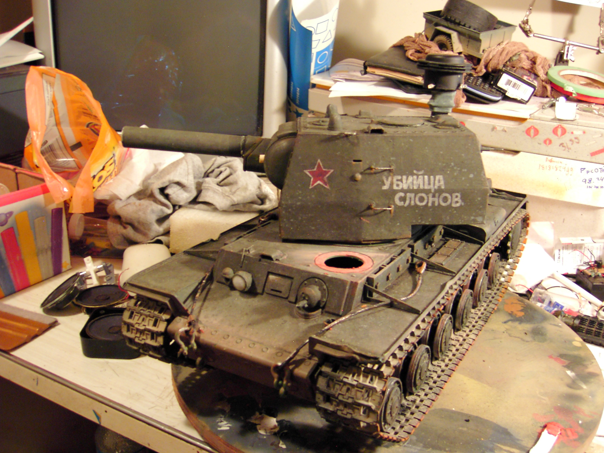

Airbrushler 09-11-2013 11:18 PM
1 Attachment(s)
http://www.rcuniverse.com/forum/atta...mentid=1919446yes on the other HL tanks i got the idea off of B.A.D.A.S.S. Force and his KV-1 project
on page 6 http://www.rcuniverse.com/forum/rc-t...ng-kv-1-a.html

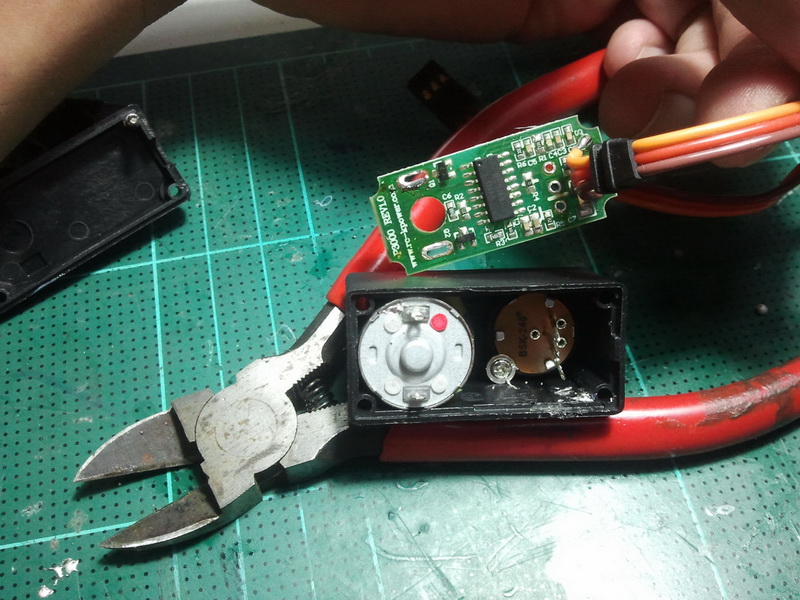

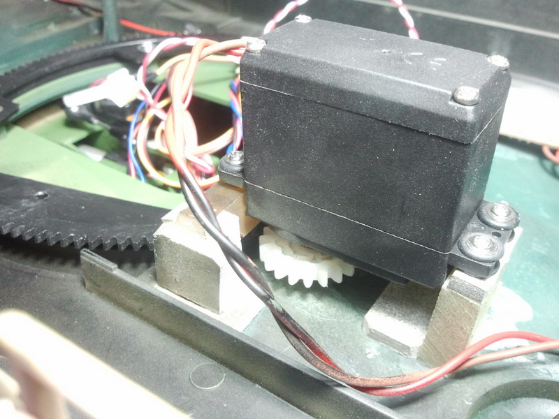

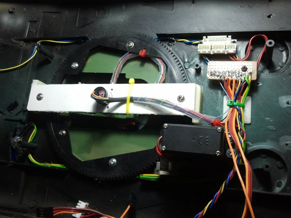

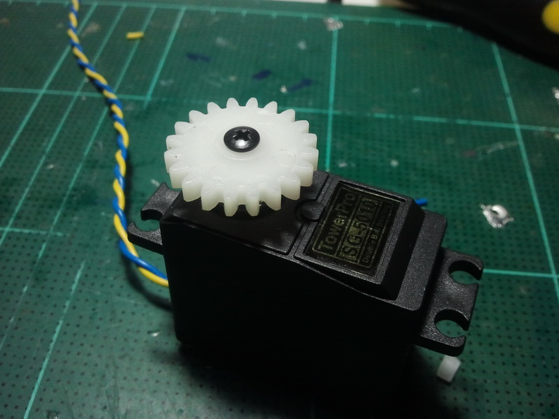

taksinsugo 11-13-2013 09:00 AM

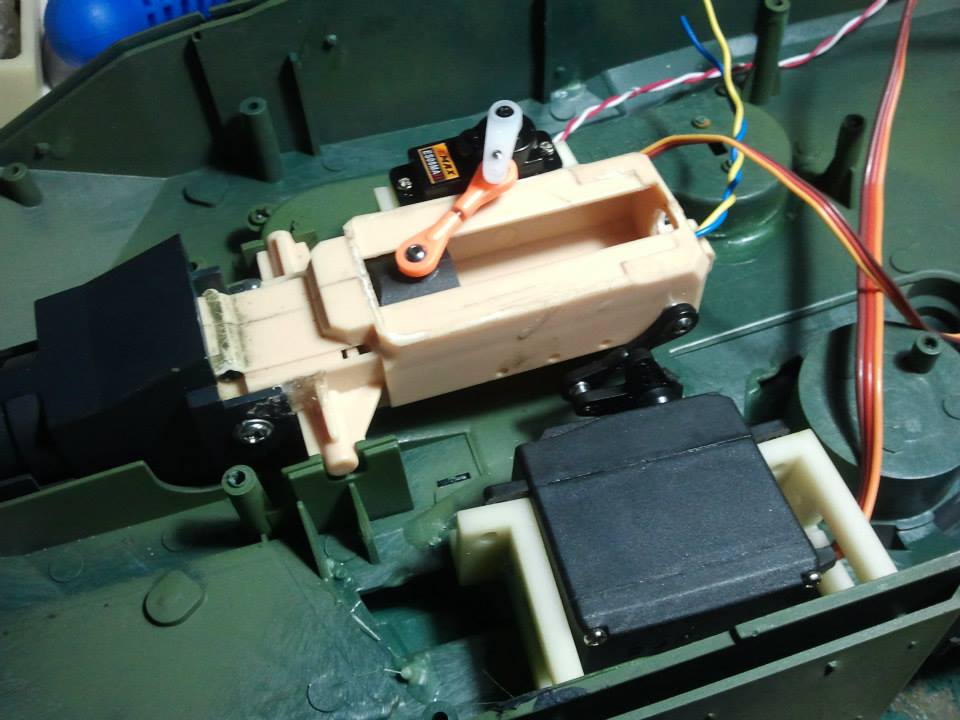

20 Attachment(s)

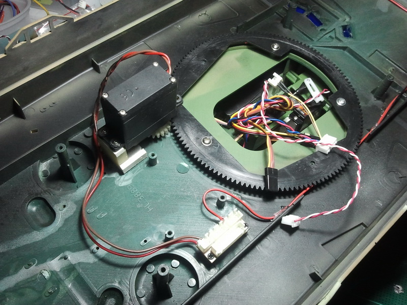

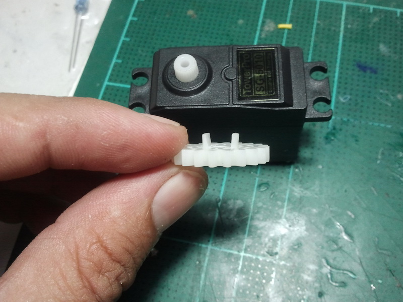

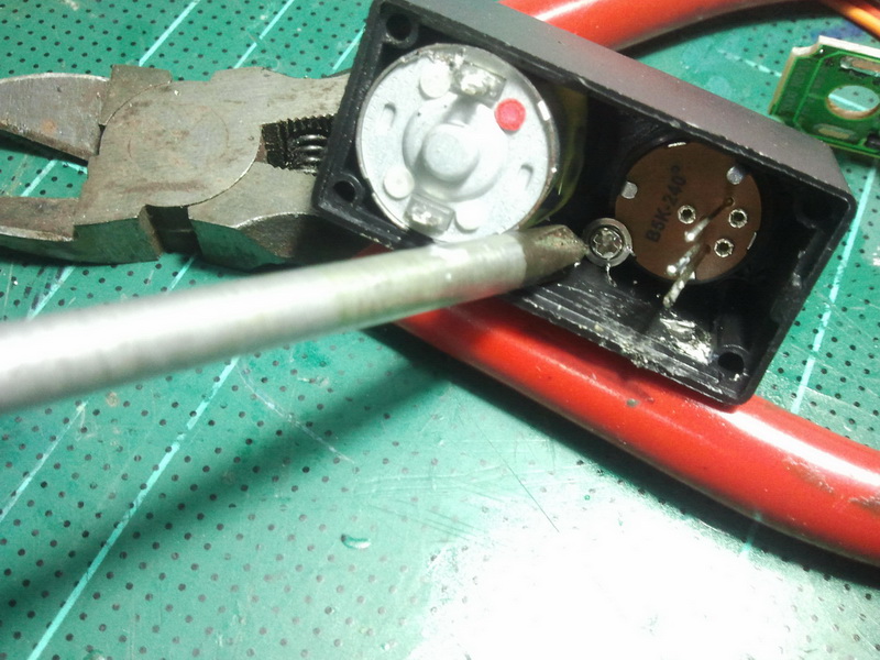

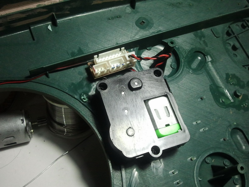

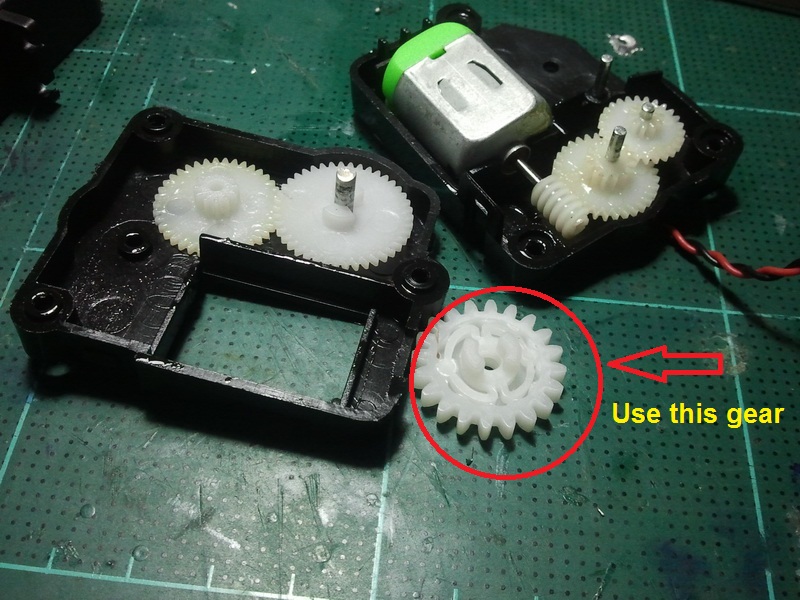

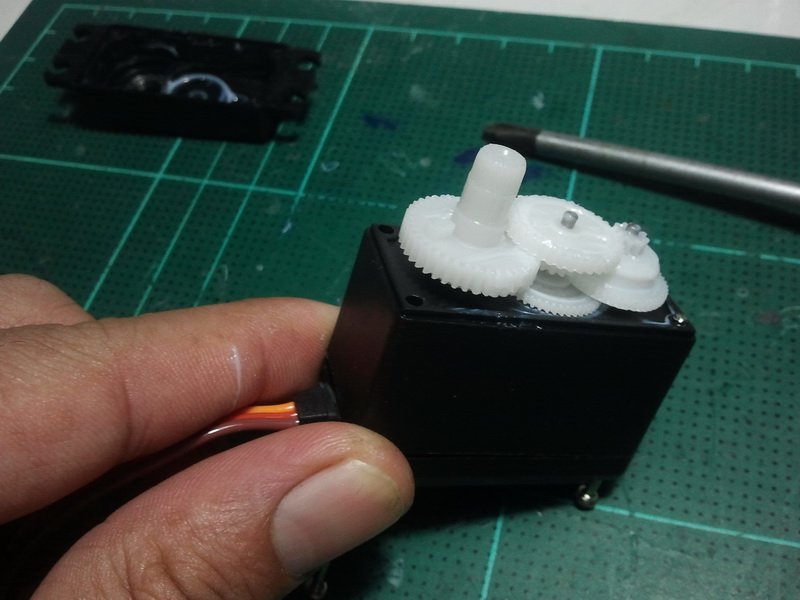

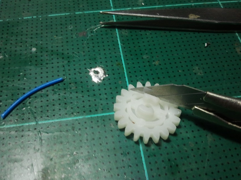

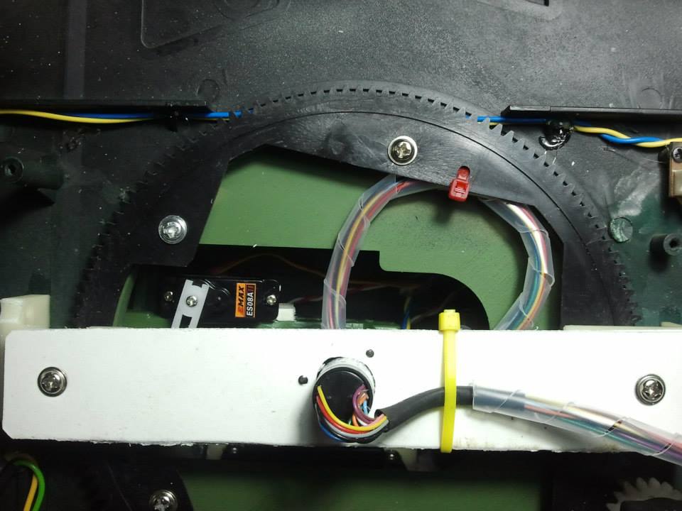

Modified Turret rotation with servo standard !!
It 's speed up
Open cover servo.
http://www.rcuniverse.com/forum/atta...mentid=1938920http://www.rcuniverse.com/forum/atta...mentid=1938921
http://www.rcuniverse.com/forum/atta...mentid=1938923
Cut stopper
http://www.rcuniverse.com/forum/atta...mentid=1938924http://www.rcuniverse.com/forum/atta...mentid=1938925
Solder it out.
http://www.rcuniverse.com/forum/atta...mentid=1938926http://www.rcuniverse.com/forum/atta...mentid=1938927http://www.rcuniverse.com/forum/atta...mentid=1938928
Remove VR center servo
http://www.rcuniverse.com/forum/atta...mentid=1938929http://www.rcuniverse.com/forum/atta...mentid=1938930
Follow the picture.
http://www.rcuniverse.com/forum/atta...mentid=1938931http://www.rcuniverse.com/forum/atta...mentid=1938932
Disassembly stock rotation gear.
http://www.rcuniverse.com/forum/atta...mentid=1938933http://www.rcuniverse.com/forum/atta...mentid=1938935
slot center gear for servo shaft
http://www.rcuniverse.com/forum/atta...mentid=1938937http://www.rcuniverse.com/forum/atta...mentid=1938938
install gear and lock on servo
http://www.rcuniverse.com/forum/atta...mentid=1938939
Below on picture and Finnish
http://www.rcuniverse.com/forum/atta...mentid=1938940http://www.rcuniverse.com/forum/atta...mentid=1938941
B.A.D.A.S.S.Force 11-13-2013 10:21 AM
Nice mods you are doing on your Leo so far, with great pictures & explained steps to go along with them! :)
As Airbrushler pointed out, I had done a headlight mod to my HL KV-1 earlier back in March this year, & at first I followed a very similar order of steps in making mine as you have, but after making them several times, I would now have one small suggestion to alter the steps for anyone converting their Heng Long lights, which differs from how you currently show finishing your lens.
Rather than wait to make the line patterns on the lens after I had already heated the plastic, pressed the shape, & made the lens curved, I found it was easier to score those lines on the plastic with my razor knife, using a ruler or straight edge, while the plastic is original & still flat, before it's heated & pressed into a curved shape. Doing the steps in that order you can more easily make very straight lines that are evenly spaced, & get an even cleaner production look to the lens. I also pressed the lens so that the scored lines were on the inside of the lens too, this way the lines can be seen but not felt on the outside of the lens. :cool:
~ Craig ~

taksinsugo 11-13-2013 08:00 PM
Thank you very mach. B.A.D.A.S.S..Force. That a good idea. i am to try it .

Despotes 11-29-2013 05:51 AM
taksinsugo
After your turret servo mod, is the turret rotation any quieter?

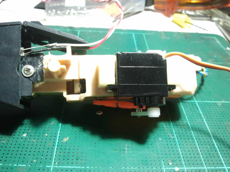

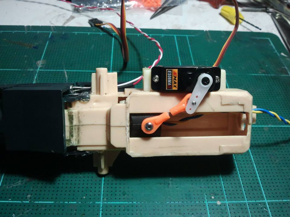

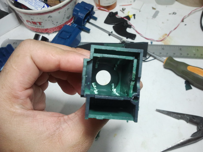

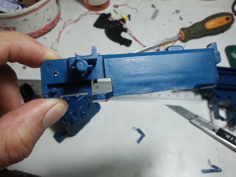

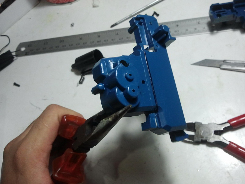

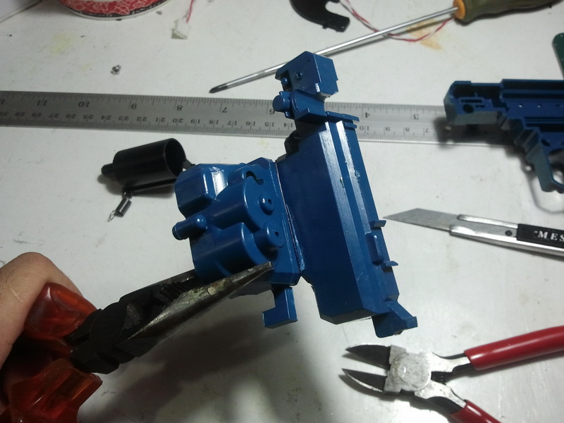

taksinsugo 06-07-2014 08:20 PM
42 Attachment(s)

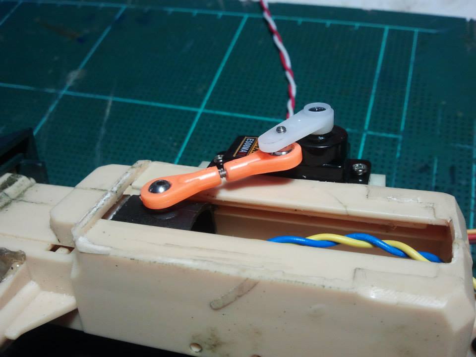

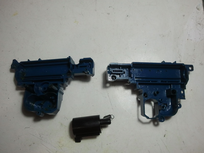

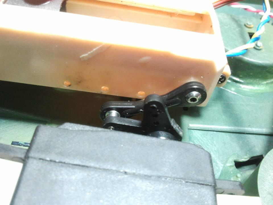

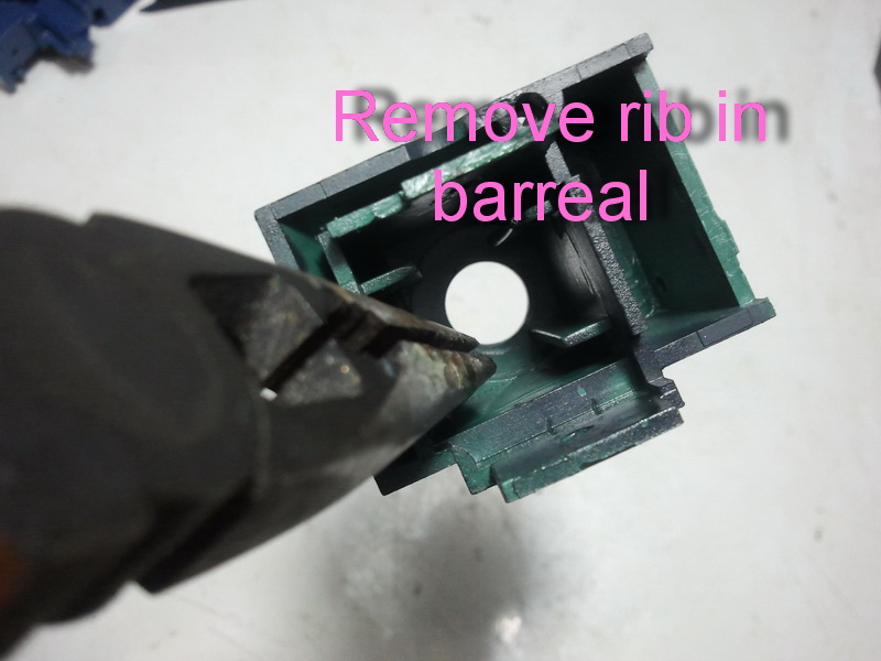

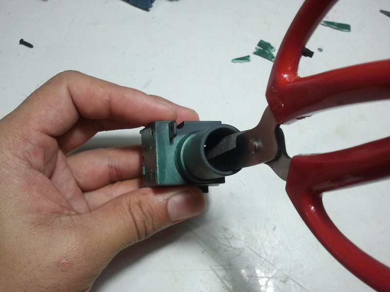

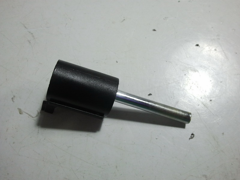

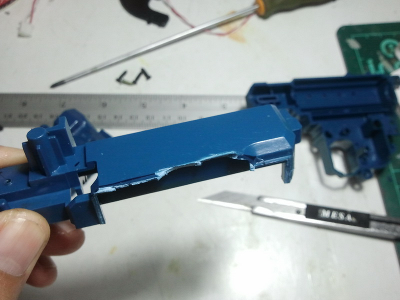

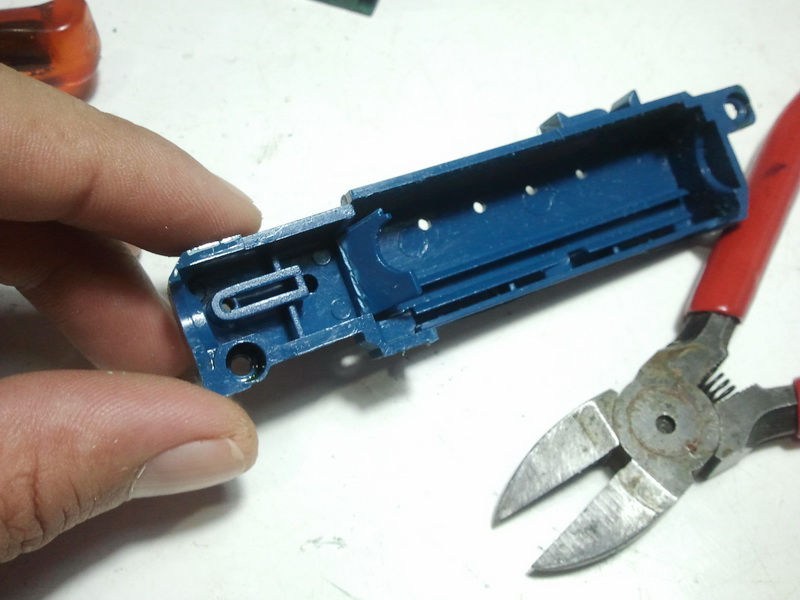

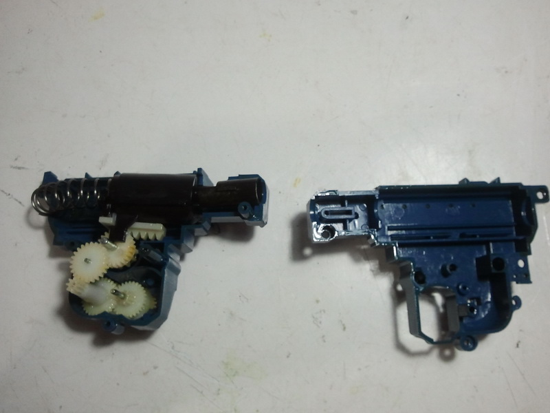

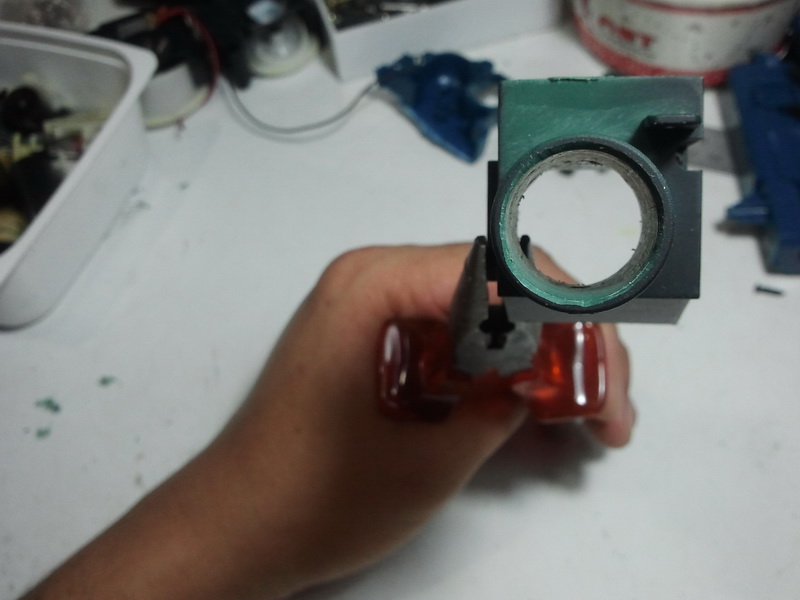

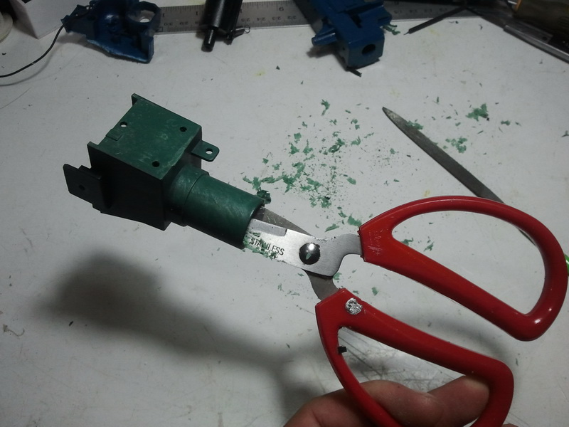

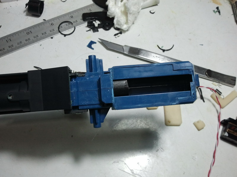

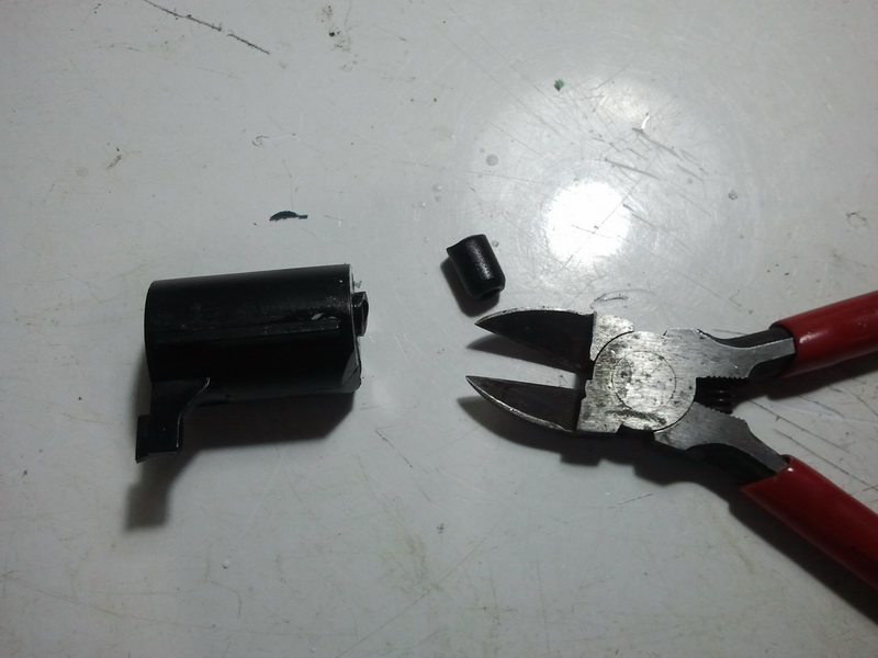

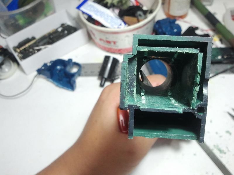

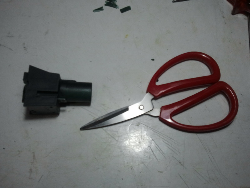

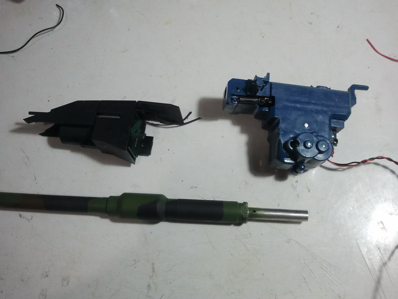

Hello commander!! this manual for modified gun recoil servo for Leopad2A6. It easy to work Let do it!
User the stock BB gun unit from Tank.
http://www.rcuniverse.com/forum/atta...mentid=2002191
disassembled BB Gun unit follow this
http://www.rcuniverse.com/forum/atta...mentid=2002266http://www.rcuniverse.com/forum/atta...mentid=2002267http://www.rcuniverse.com/forum/atta...mentid=2002268http://www.rcuniverse.com/forum/atta...mentid=2002269
Cut it.
http://www.rcuniverse.com/forum/atta...mentid=2002270http://www.rcuniverse.com/forum/atta...mentid=2002271http://www.rcuniverse.com/forum/atta...mentid=2002272http://www.rcuniverse.com/forum/atta...mentid=2002273
http://www.rcuniverse.com/forum/atta...mentid=2002274http://www.rcuniverse.com/forum/atta...mentid=2002275http://www.rcuniverse.com/forum/atta...mentid=2002276http://www.rcuniverse.com/forum/atta...mentid=2002280
Disassemble barrel and cut all rib to smooth.
http://www.rcuniverse.com/forum/atta...mentid=2002281http://www.rcuniverse.com/forum/atta...mentid=2002282http://www.rcuniverse.com/forum/atta...mentid=2002283
Use scissors to make a hole so big and smooth.
http://www.rcuniverse.com/forum/atta...mentid=2002284http://www.rcuniverse.com/forum/atta...mentid=2002285http://www.rcuniverse.com/forum/atta...mentid=2002286http://www.rcuniverse.com/forum/atta...mentid=2002287http://www.rcuniverse.com/forum/atta...mentid=2002288http://www.rcuniverse.com/forum/atta...mentid=2002289

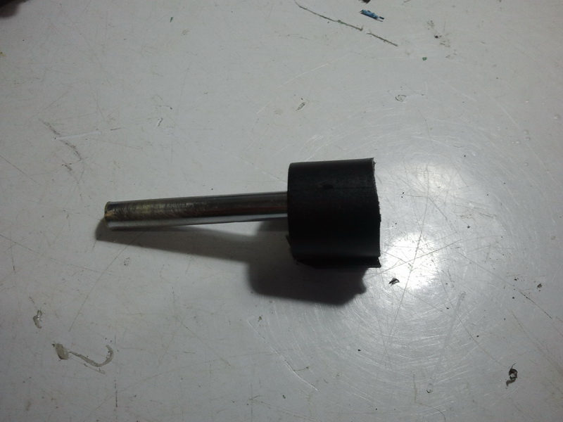

Inserted into the barrel and make sure it does not jam.

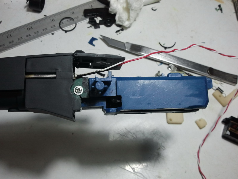

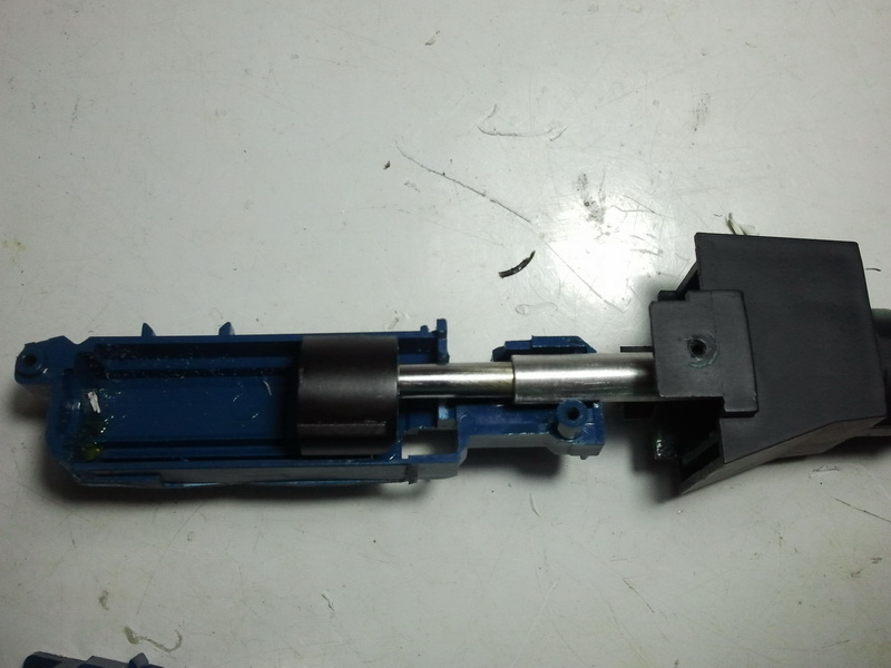

http://www.rcuniverse.com/forum/atta...mentid=2002290http://www.rcuniverse.com/forum/atta...mentid=2002291

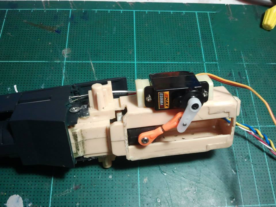

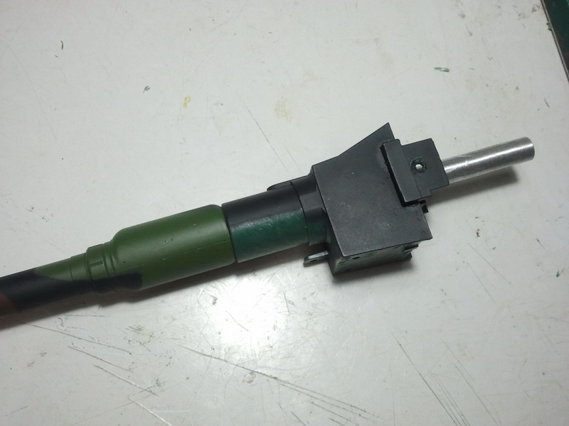

Use Antenna from henglong cut about 60mm.
http://www.rcuniverse.com/forum/atta...mentid=2002292http://www.rcuniverse.com/forum/atta...mentid=2002293
Use cylinder air gun from HL cut it and dill hole for antenna
http://www.rcuniverse.com/forum/atta...mentid=2002294http://www.rcuniverse.com/forum/atta...mentid=2002295http://www.rcuniverse.com/forum/atta...mentid=2002296
Assemble the gun and then glued a stroke.
http://www.rcuniverse.com/forum/atta...mentid=2002297http://www.rcuniverse.com/forum/atta...mentid=2002298http://www.rcuniverse.com/forum/atta...mentid=2002299

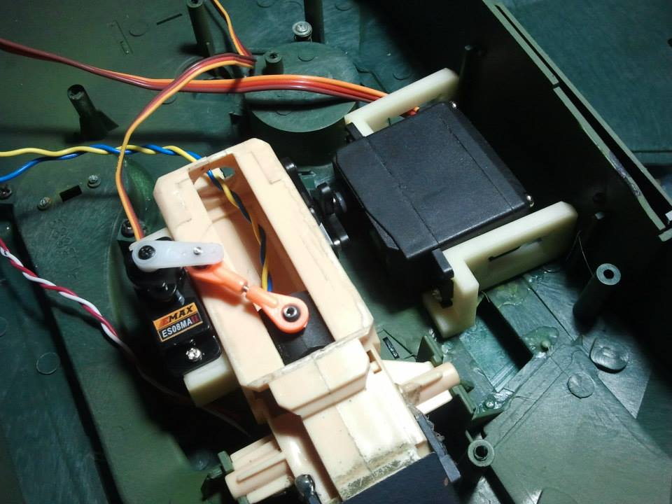

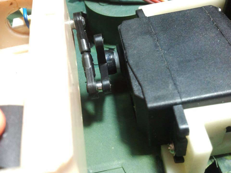

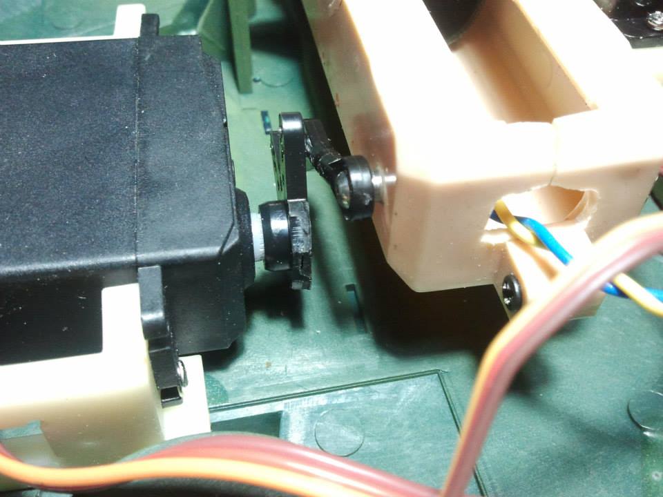

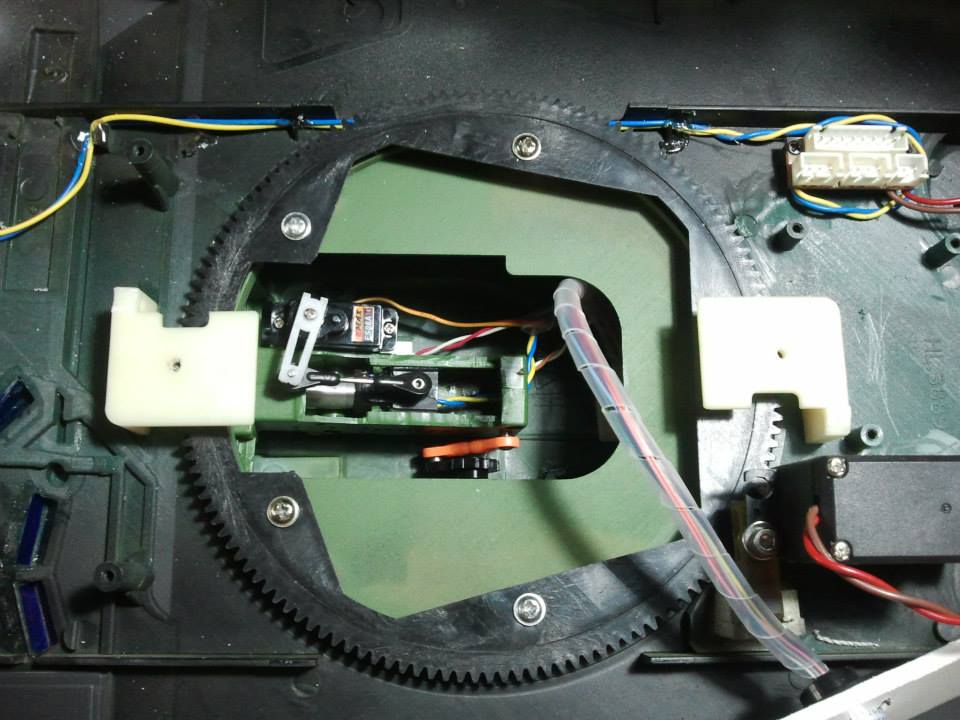

Install support servo ball link and link rod for helicopter follow the picture and finish.
http://www.rcuniverse.com/forum/atta...mentid=2002300http://www.rcuniverse.com/forum/atta...mentid=2002301http://www.rcuniverse.com/forum/atta...mentid=2002302http://www.rcuniverse.com/forum/atta...mentid=2002303http://www.rcuniverse.com/forum/atta...mentid=2002304http://www.rcuniverse.com/forum/atta...mentid=2002305
This example gun servo elevator it Up and down to -5-+15 degree
http://www.rcuniverse.com/forum/atta...mentid=2002306http://www.rcuniverse.com/forum/atta...mentid=2002307http://www.rcuniverse.com/forum/atta...mentid=2002308http://www.rcuniverse.com/forum/atta...mentid=2002309http://www.rcuniverse.com/forum/atta...mentid=2002310
Video
http://www.youtube.com/watch?v=3_yJDsopzF8

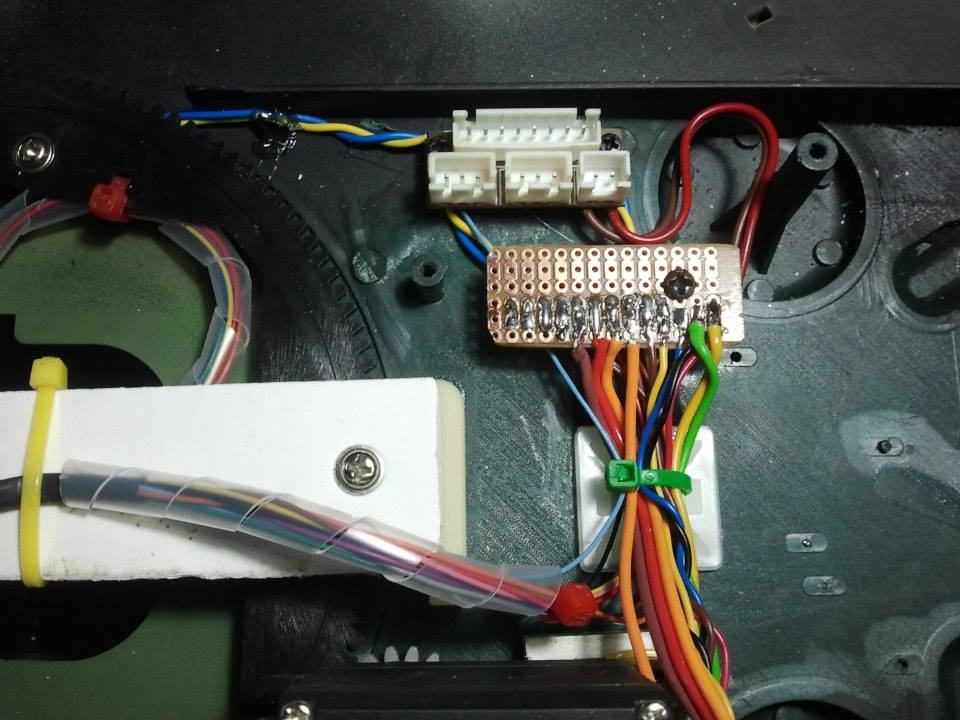

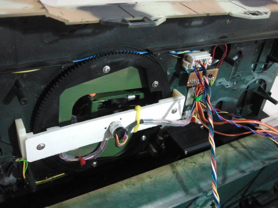

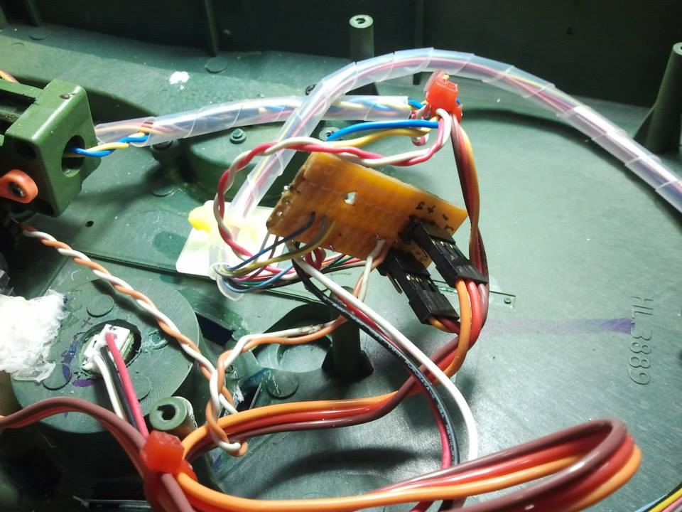

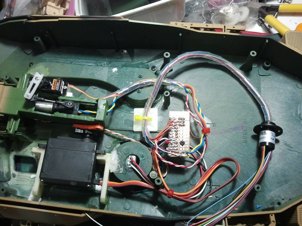

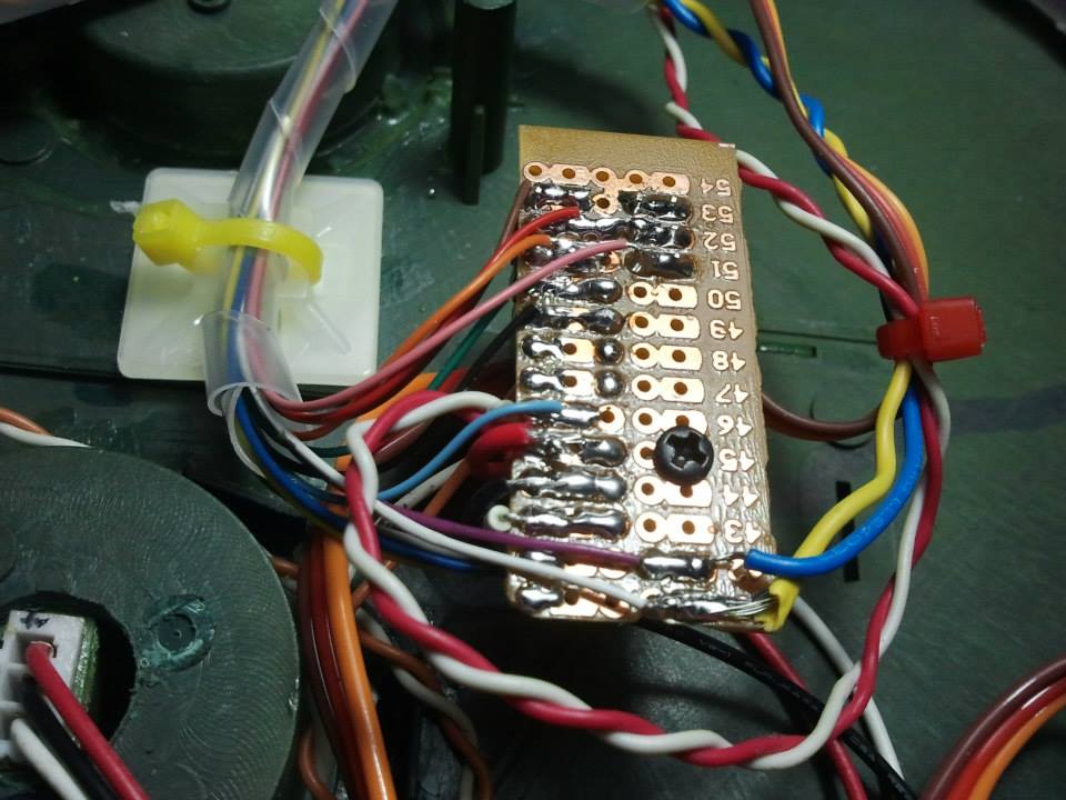

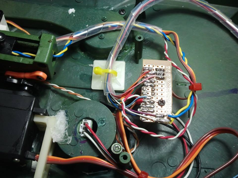

taksinsugo 06-07-2014 08:36 PM
10 Attachment(s)

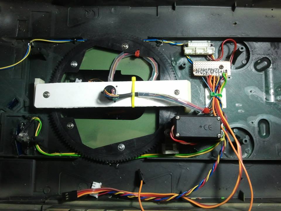

EX wiring Slip ring for Leopard 2A6
http://www.rcuniverse.com/forum/atta...mentid=2002337http://www.rcuniverse.com/forum/atta...mentid=2002338http://www.rcuniverse.com/forum/atta...mentid=2002339http://www.rcuniverse.com/forum/atta...mentid=2002340http://www.rcuniverse.com/forum/atta...mentid=2002341http://www.rcuniverse.com/forum/atta...mentid=2002342http://www.rcuniverse.com/forum/atta...mentid=2002343http://www.rcuniverse.com/forum/atta...mentid=2002344http://www.rcuniverse.com/forum/atta...mentid=2002345http://www.rcuniverse.com/forum/atta...mentid=2002346
sollie 06-07-2014 11:23 PM
Great video and 'how to' on modify. Hard to tell it from a tamiya now
Jannicke 06-08-2014 07:08 AM
Hi there Taksinsugo.
A question about your turret servo modification. It looks like you have wired the new turret servo to the same connections on the hull where the wires for the old turret motor connected, is that correct?
Thanks for your help, Jan
taksinsugo 06-08-2014 07:23 AM
Hello jannicke
Yes! it is, you can connected direct from old motor from HL.
Thanks for comment.
Jannicke 06-08-2014 08:07 AM
Great! I will give it a try. Great information you have here by the way. Thanks again :)
