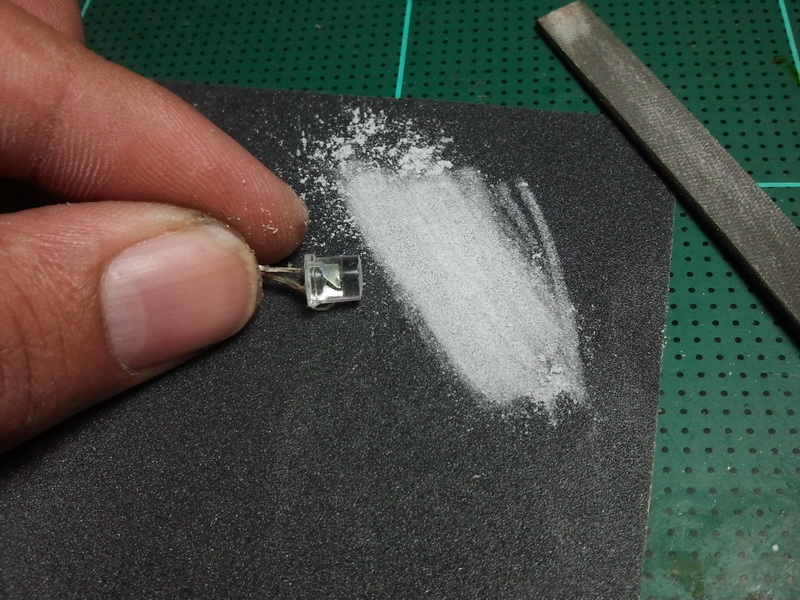

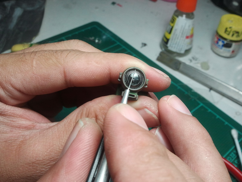

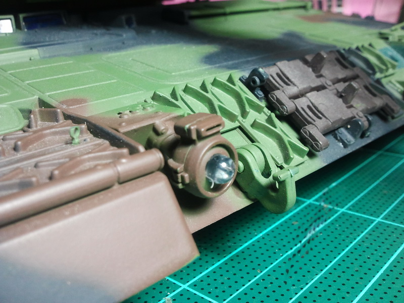

Hello Tank commander.today i am modify head light HL Leopard2a6 , it easy and to share for everyone . Let do it...
This is original from HL.
disassemble cover head light.
use cutter to break cover headlight.
Cut it out!
Polished with sand paper to smooth.
Use the cement liquid for Makes clear.
Using plastic sheet and nut for make cover head light.
Glen fire soft
Press nut to cover light
Cut the cover light
Draw a pattern on the cover.
and finish

Nice tutorial. Easy to follow with all the good pictures you took

Well explained, and a very good result, thank you.
This can also be applied to all other HL tanks.

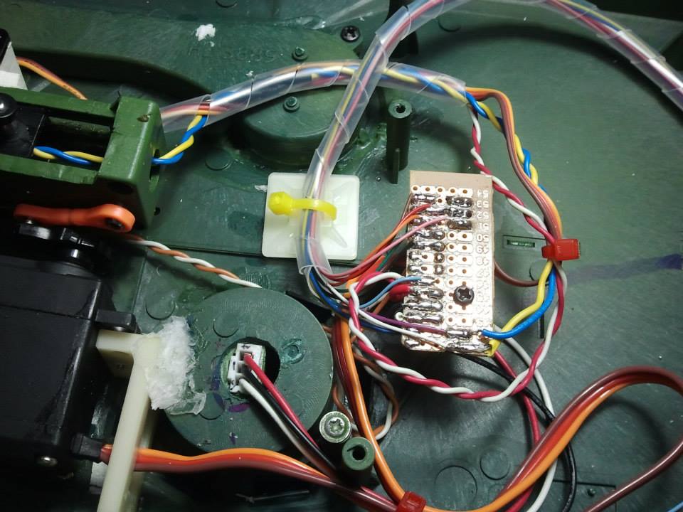

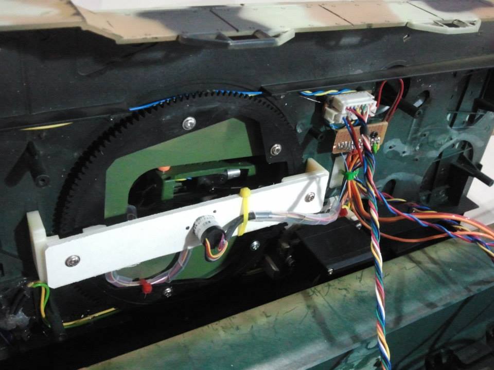

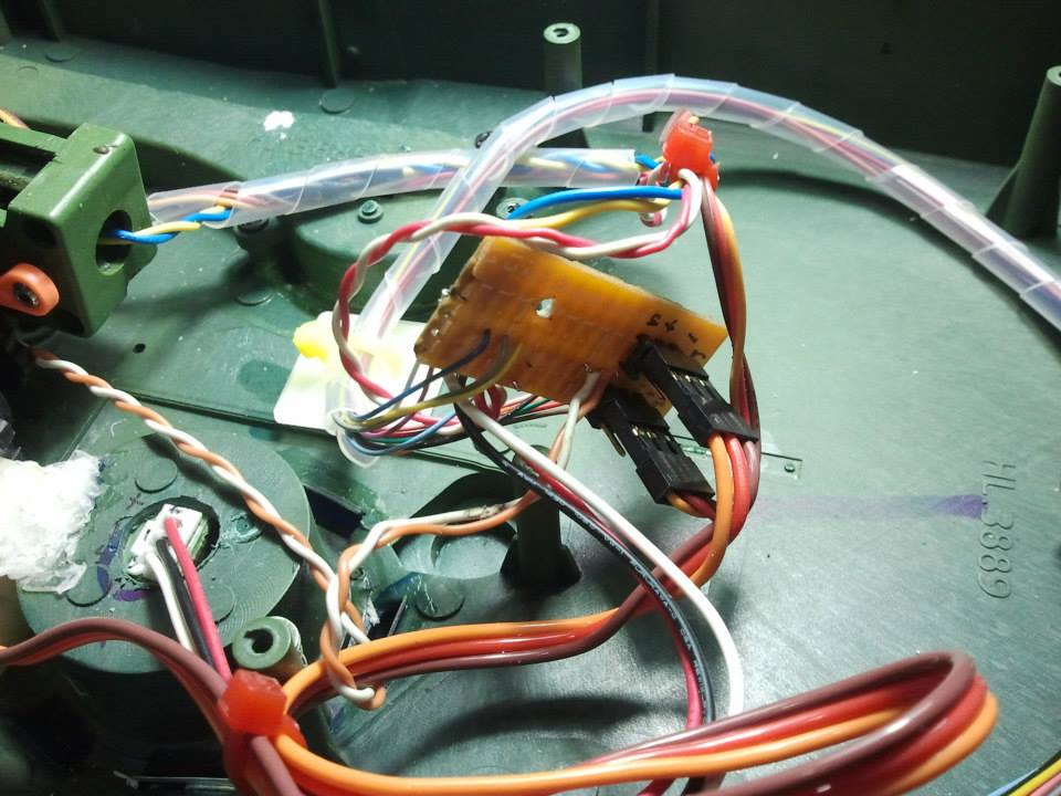

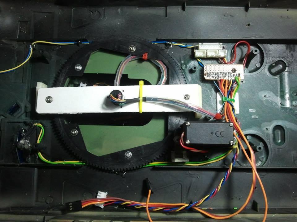

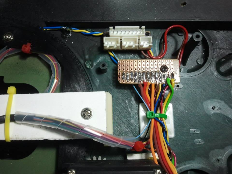

Modified Turret rotation with servo standard !!
It 's speed up
Open cover servo.
Cut stopper
Solder it out.
Remove VR center servo
Follow the picture.
Disassembly stock rotation gear.
slot center gear for servo shaft
install gear and lock on servo
Below on picture and Finnish

After your turret servo mod, is the turret rotation any quieter?

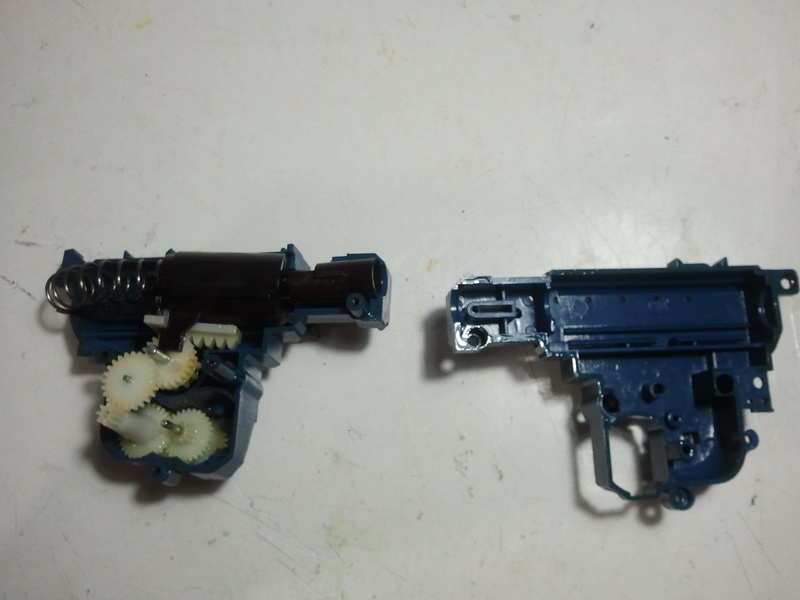

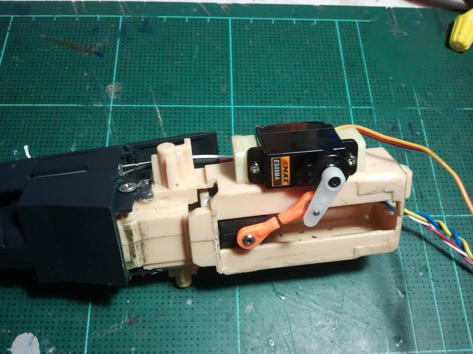

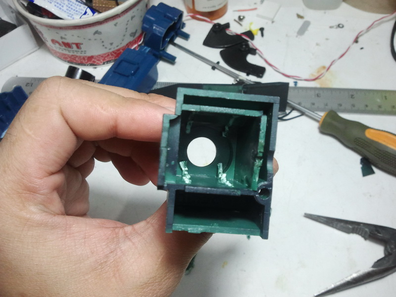

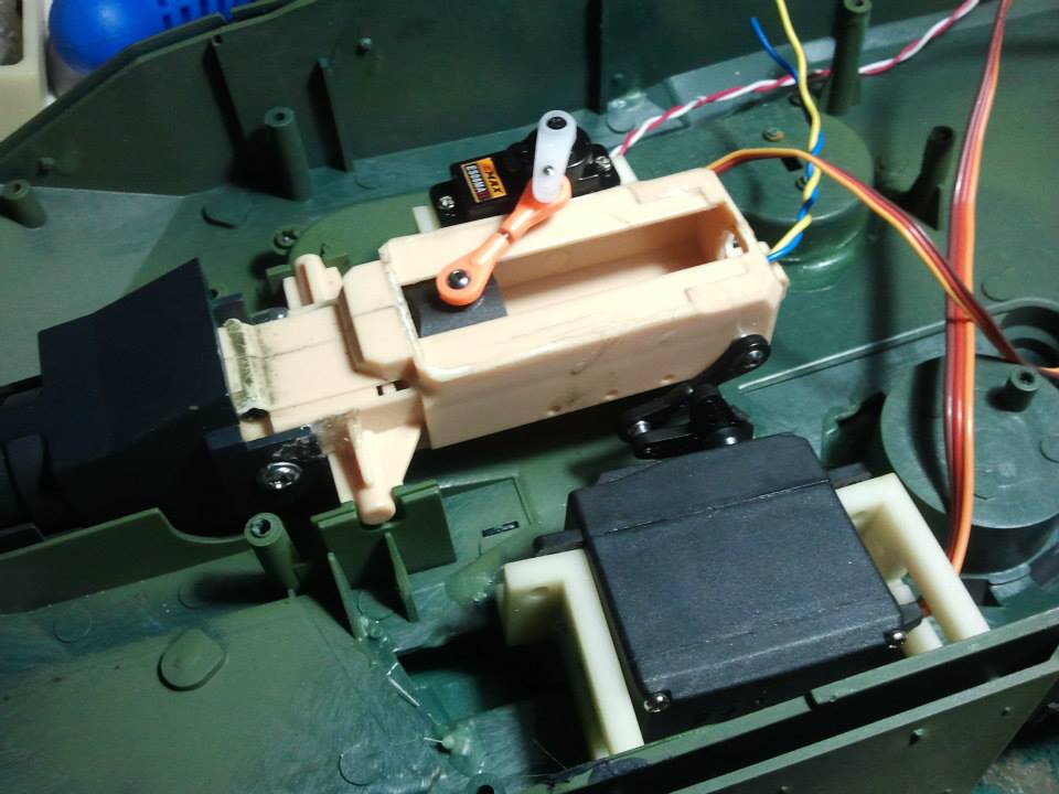

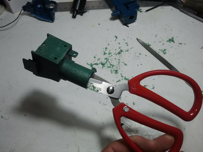

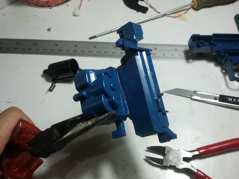

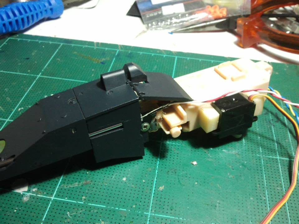

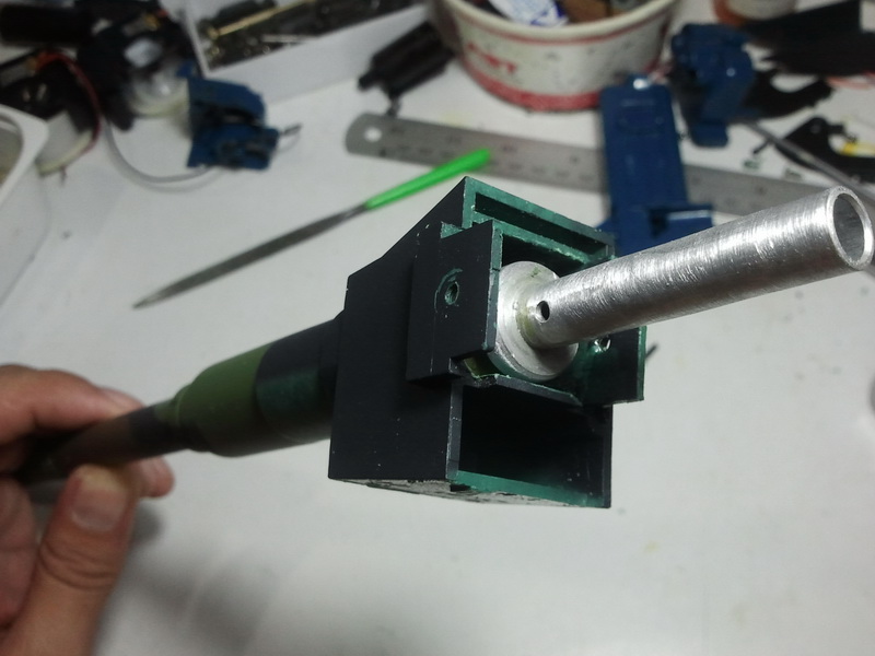

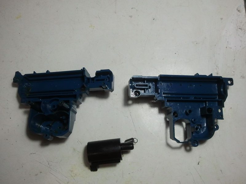

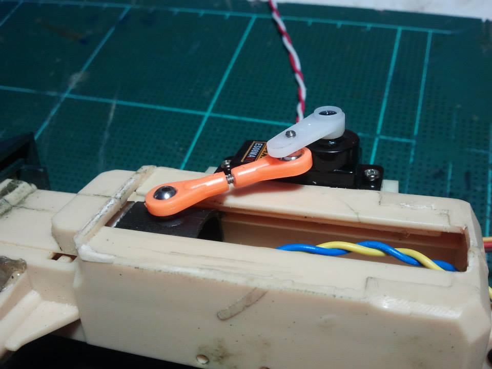

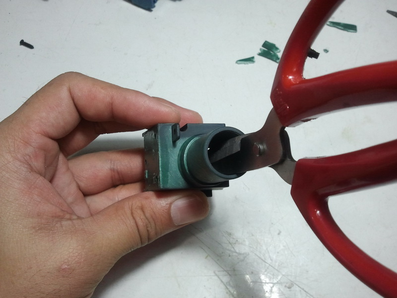

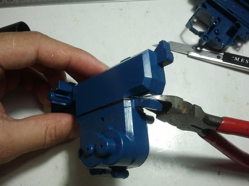

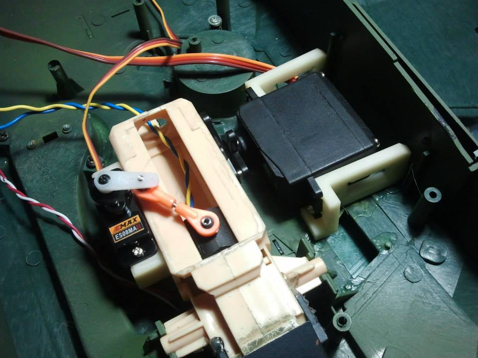

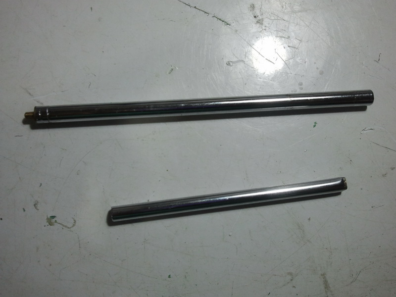

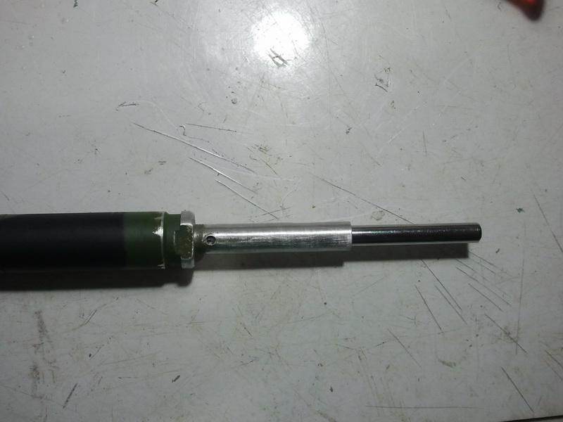

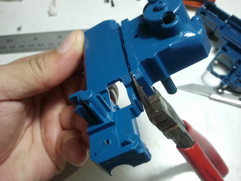

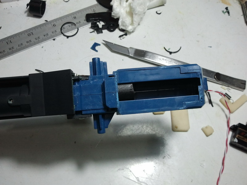

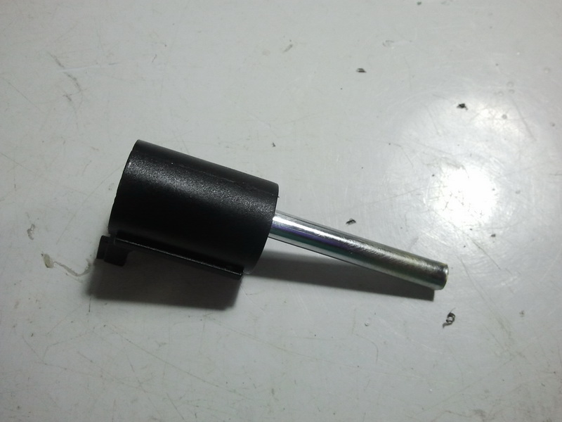

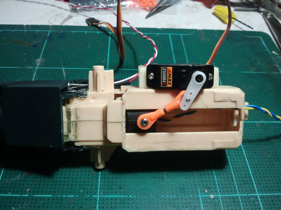

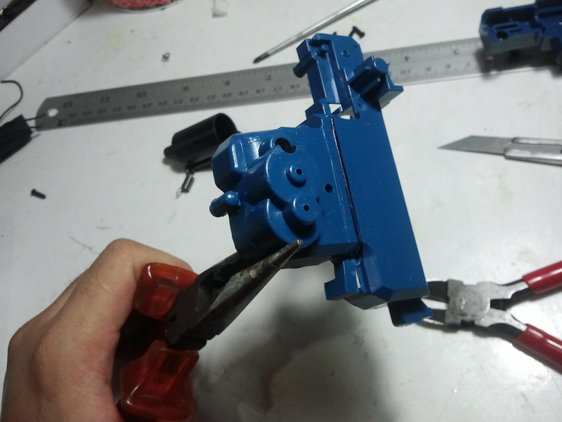

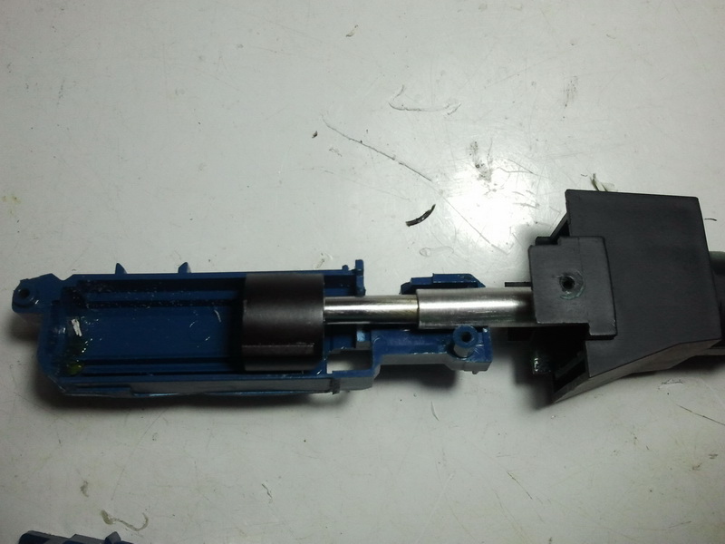

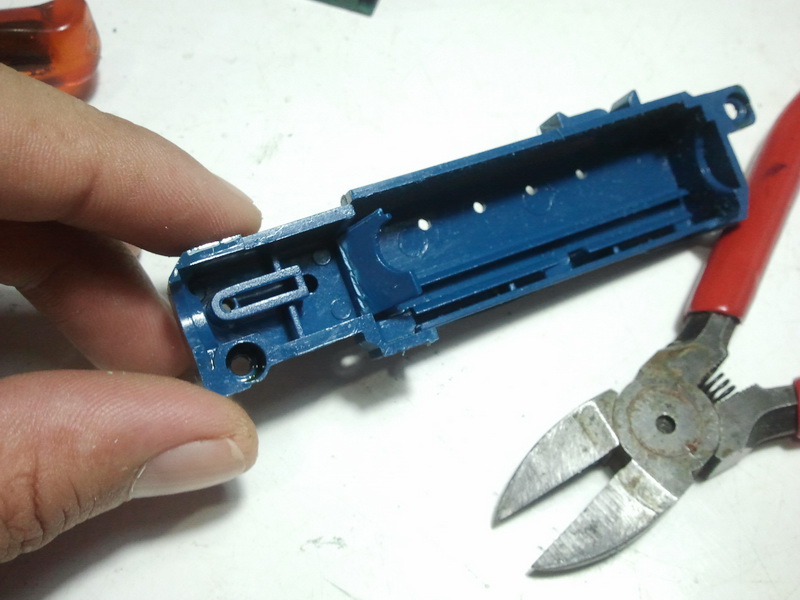

Hello commander!! this manual for modified gun recoil servo for Leopad2A6. It easy to work Let do it!
User the stock BB gun unit from Tank.
disassembled BB Gun unit follow this
Cut it.
Disassemble barrel and cut all rib to smooth.
Use scissors to make a hole so big and smooth.
Inserted into the barrel and make sure it does not jam.
Use Antenna from henglong cut about 60mm.
Use cylinder air gun from HL cut it and dill hole for antenna
Assemble the gun and then glued a stroke.
Install support servo ball link and link rod for helicopter follow the picture and finish.
This example gun servo elevator it Up and down to -5-+15 degree
Video

EX wiring Slip ring for Leopard 2A6
ID:	2002337   Click image for larger version

Great video and 'how to' on modify. Hard to tell it from a tamiya now

Hi there Taksinsugo.
A question about your turret servo modification. It looks like you have wired the new turret servo to the same connections on the hull where the wires for the old turret motor connected, is that correct?
Thanks for your help, Jan
Old 06-08-2014 | 07:23 AM
Joined: Sep 2012
Posts: 21
From: Samutprakarn, THAILAND
Hello jannicke
Yes! it is, you can connected direct from old motor from HL.
Thanks for comment.

Great! I will give it a try. Great information you have here by the way. Thanks again

My apology for bumping an old thread, but I have a question about your gearbox. I have seen your videos on youtube and I'm very impress at your Leopard 2 and ZTZ99 speed and little to no noise from the gearbox. Can you take a picture of what you did to your gearbox?
Did you remove two gears, so what are left are just the pinion, one gear, and a drive shaft? I have a pair of Promaxx 480 motors and I'm wondering how you get enough toque to run the tank after removing two gears.
