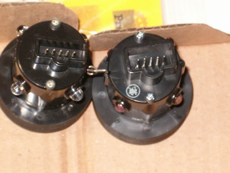

I have been waiting since last year for more Tamiya Battle Units. I talk to Karen & Tasha at least once a week. Not only does Tamiya not have a delivery date or shipping date....it seem that they have not been manufactured yet. The last time this happened it was a 6+ month drought. The only TBUs available are all in private hands. I have a few tucked away for myself and a few that I am selling for a buddy of mine who is getting married. I saw two sell on EBay last month for $200. WOW! http://www.ebay.com/itm/121296424732...84.m1436.l2649 But if it is the last thing you need to finish off your tank..... what are you going to do? I've seen them sell for up to $250 on other sites.
I have been selling partial units w/o the apple like a RC airplane "Flight pack" but for IR battle tanks. The Impact battle unit is a good substitute but be prepared to wait at least a month for the part. As Gregg mentioned they are NOT interchangeable with Tamiya battle units. Ever since the Malaysian airline went MIA international shipping has slowed to a crawl. The timing couldn't be worse with spring now here and all the tank events coming up. The recently released hand made apple does work. I got it from Carl in NY who makes them for Immortal. Carl does great work A+. It lacks fins and hence is very vulnerable to IR shots. It also lacks a base connecotor (it relies only the wire pins to attach). The black "base" is heat shrink tube and this results in a very loose apple. FYI... for those not very familiar with TBUs...when the apple is not secure it wobbles loose and if any connections are lost the IR emitter will no longer fire. It is a common occurence at Danville in a rough tank battle. That is why the Tamiya apple has that little wire latch...it locks in the apple firmly in place. Yet again the Tamiya quality comes shines thru. Even Impact lacks the safely latch. FYI Impact apples DO NOT fit Clark bases. You need a genuine Tamiya apple.http://www.rcuniverse.com/forum/atta...mentid=1991494
If you can wait or afford it, I strongly recommend you get the genuine Tamiya Battle Unit now. If you can't ...get the Impact but be prepared to wait 4 to 5 weeks. If you want an inexpensive substitute try Carl's. http://www.ebay.com/itm/1-16-RC-Tank...item35d4b03236 It is not very robust and the top comes apart very easily, but the price is great. http://www.rcuniverse.com/forum/atta...mentid=1991495Be gentle and DO NOT ROLL THE TANK. It cannot take it and will break. Don't bring it to Danville or you will be dead in short order. Without any fins and 4 sensors it is IR sensitive compared to the TBU. The Impact can do the TFA mod, but Carls cannot. Each has a place in IR tanking.
PLEASE BEWARE of any retailer that says they have them. They just may be trying to rip you off. See my GEX Hobby AKA Tamiya-AU post. AVOID GEX!

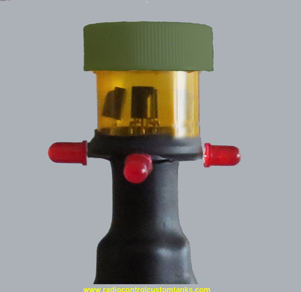

I sell a base unit that can be used with Tamiya's Battle unit. These are built to work with the DBC3 or Clark boards, a person would have to install the Tamiya 5 pin jst so it could be plugged into the MFU.
The units Immortal hobby sells and the ones Bob mentioned above do work fine, but I have suspected they don't have 45 degree defenses so are more easily lit up.
So this is something that needs confirmation as Bob's comments are contradictory to Curtis's with respect to the 45 degree defense of "Carl's battle unit.,

YHR I think you may have misunderstood me. ( ...from YHR " So this is something that needs confirmation as Bob's comments are contradictory to Curtis's with respect to the 45 degree defense of " Carl's battle unit." )
The lack of fins removes any slope defense (horizontal tilt angle). I don't recall saying anything about 45 degree defense or lack there of.
I have Carl's sensor and it is good. The apple works well and I would endorse it.
BEWARE of loose apples guys. Once the apple it is out of the IR circuit the IR emitter will no longer fire rendering your tank useless. This has been a issue with DBU Apples for years. Keep them tight in the mounts.

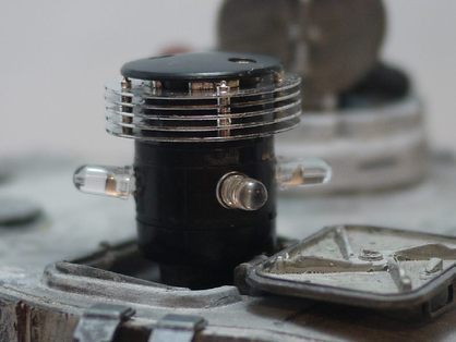

1 Attachment(s)
I agree..this is one instance when I'd pay the price and go Tamiya. Not realizing the shortage, I sold my last Tamiya apple with my last tank(Sherman)...DAM, would have hung onto it If I had known! :mad:
http://www.rcuniverse.com/forum/atta...mentid=1991942
p.s. wish somebody with the ability could design something like an apple that is very low profile and doesn't look so ridiculous sticking out the top of the tank..
