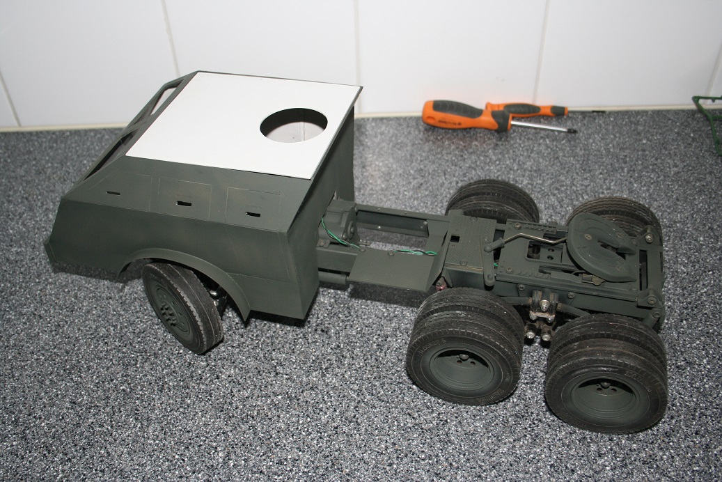

Hi Everyone,I have had a Tamiya Globeliner 1/14 truck now for quiet a few years and have now finally found a use for it........... ;D ;D ;D ;D
This will be the first of its kind in an Australian tank club......
The kit is on its way from Germany and I have started stripping down the truck, the first pic is what the new cab will look like once I get it and build it..
Cheers Kenm Germany...
Cheers Ken

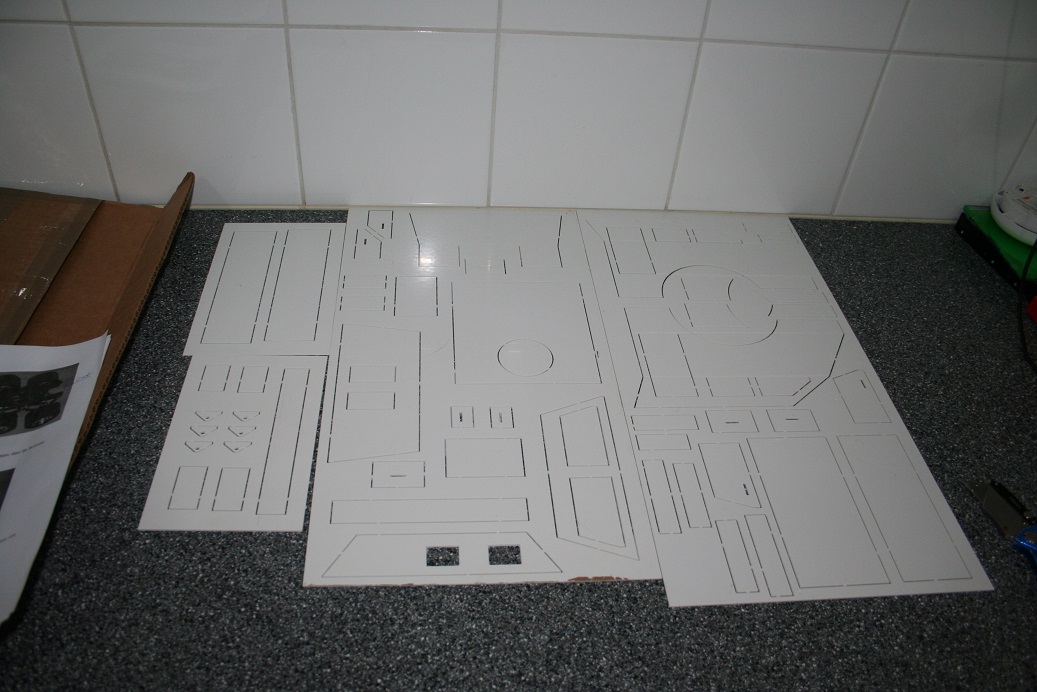

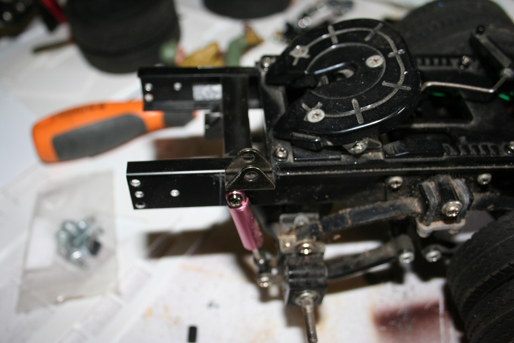

Reaper332 05-30-2014 02:12 AM
6 Attachment(s)
Hi Everyone,
The kit turned up today and I have started the build..... Its going together quiet well....;)
Here are some pics of it so far...
Cheers Ken

ROLLIN ARMOUR 05-30-2014 03:35 AM
Very Cool. I am watching. I am getting the coin together to pull the trigger on a Tamiya globeliner. Then the M26 cab kit. U said there will be a kit for the trailer? With all the WW 2 tanks Tamiya has produced, This would have been a good kit to mass produce. They could of up scaled their 1/35th Dragon Wagon for the cab and trailer parts and used the globeliner and possibly one of their trailer kits.
Reaper332 05-30-2014 03:41 AM
Hey mate yeah I believe the trailer is 3 - 4 weeks away...
Still have too move the whole front axle back 23mm yet and chop the rear frame rails off but that's tomorrows job...:D It would be nice if Tamiya produced them along with several other items...lol
Cheers Ken

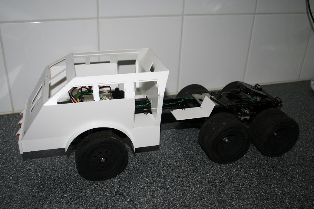

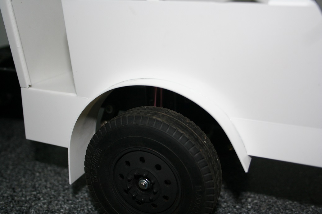

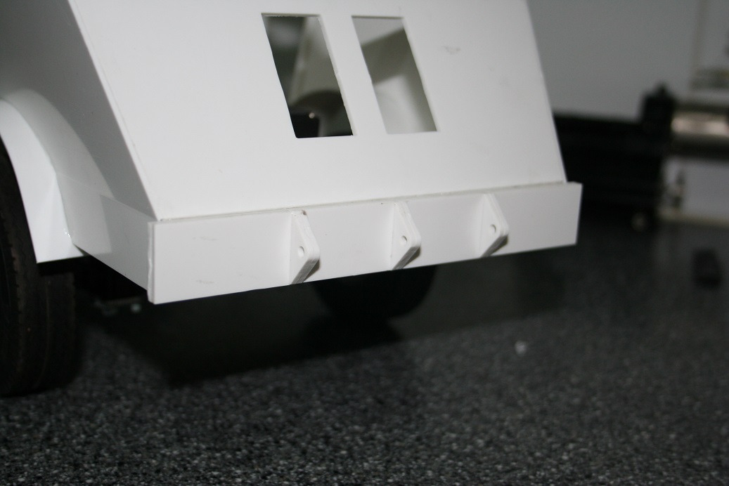

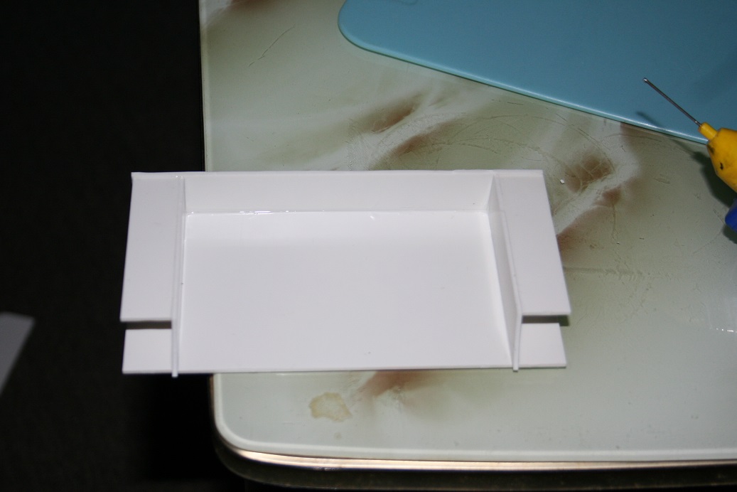

Reaper332 05-30-2014 02:57 PM
4 Attachment(s)
Hey Everyone just another small update... Front bar is on as is the fenders (which need to be trimmed back yet ) and the top of the rear wall of the cab.
Next on the list is to cut the rear frame down and move the front axle back 23mm after that is the armoured window covers.
Cheers Ken

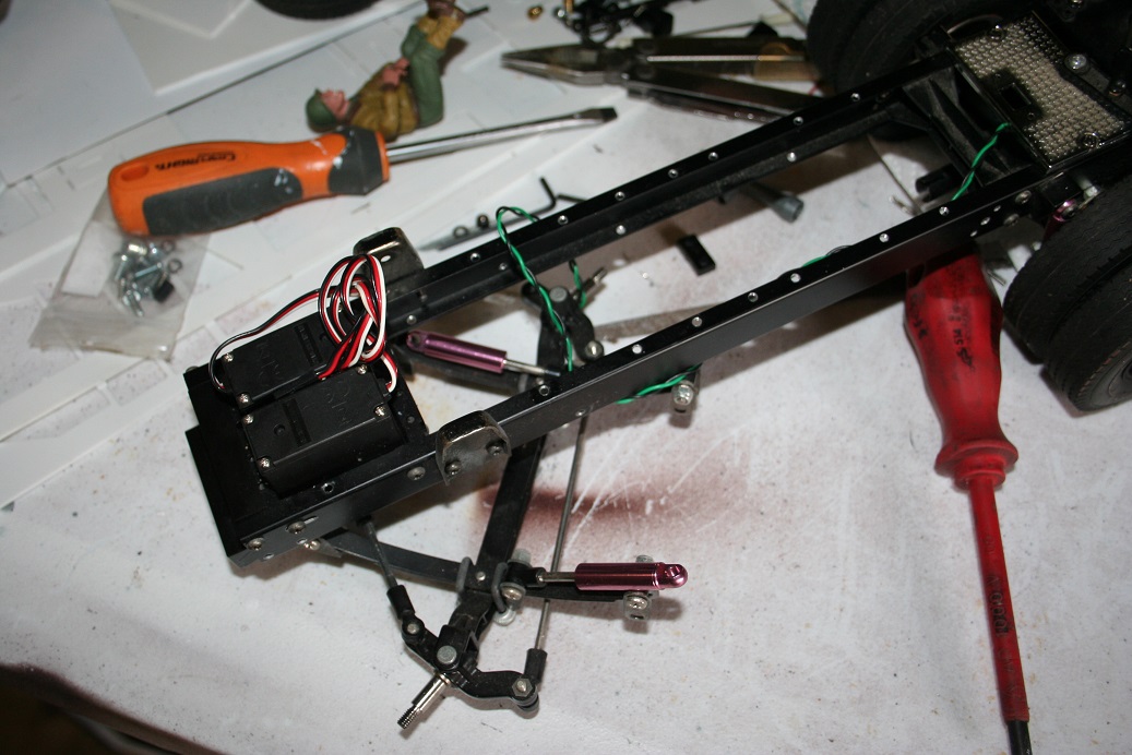

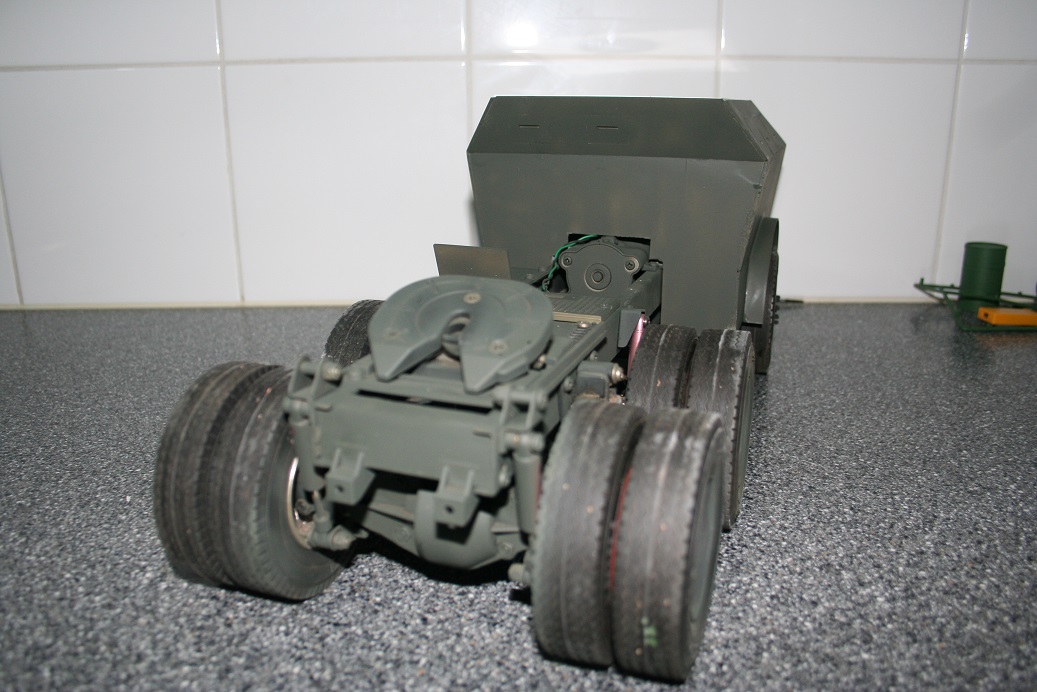

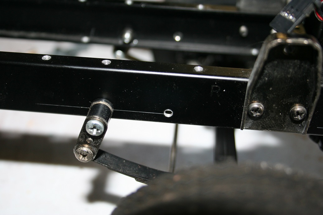

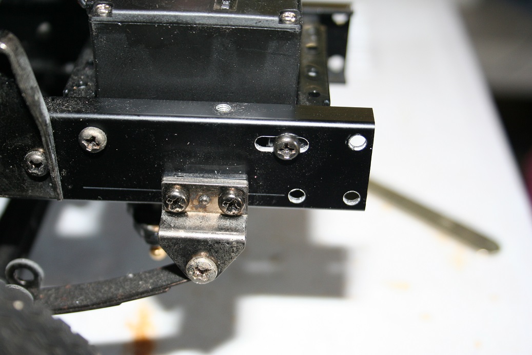

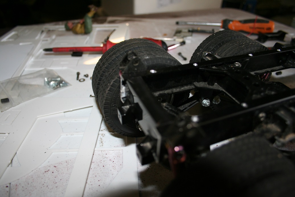

Reaper332 06-01-2014 01:05 AM
6 Attachment(s)
Ok guys spent the day moving the front axle back and cutting down the rear frame rails. I am also looking at how I can fit the MF unit into the cab cause its gotta have sound.... lol! Oh and I also move the fifth wheel further back on the chassis
Cheers Ken

ROLLIN ARMOUR 06-01-2014 01:39 PM
LOOKING GOOD! Question, How did U know to move the axle back 23mm? Is there instructions?
Reaper332 06-01-2014 08:32 PM
Yeah mate they are instructions, just photo copied pages and its in german but you get the general idea....;)

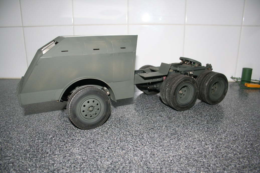

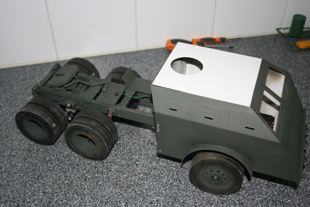

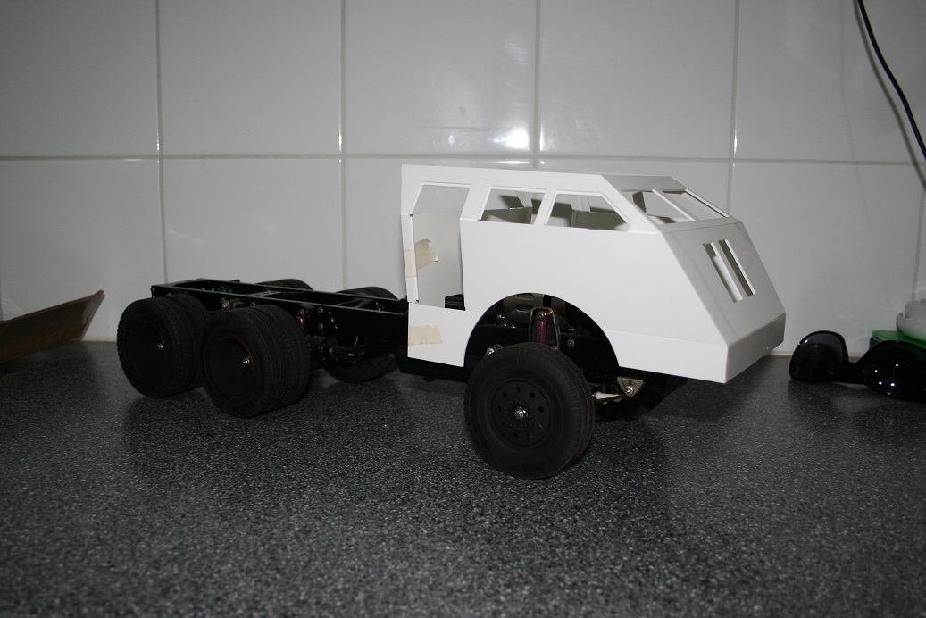

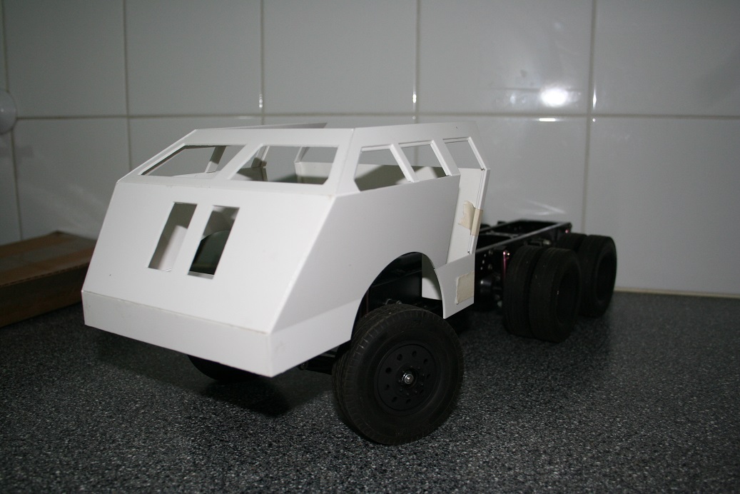

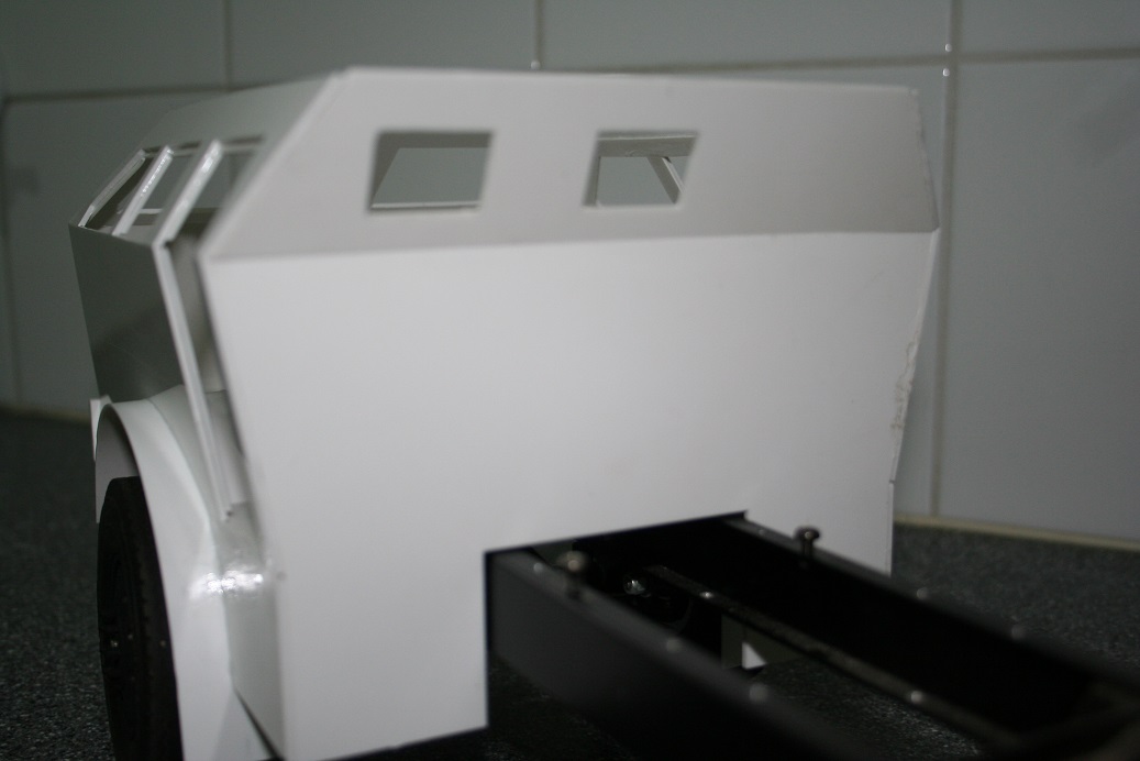

Reaper332 06-15-2014 11:30 PM
6 Attachment(s)
Hey mate yeah getting there slowly....lol I have a heap of stuff to do for my club at the moment as we are getting ready to do a display at a show...:D
But I managed to do a little bit to it today, I put a coat of paint on mainly to see any defects..... here it is.
Cheers Ken

ROLLIN ARMOUR 06-16-2014 04:39 AM
Looking really good. Are you going to do anything for the interior or just have the window hatches down?
Reaper332 06-16-2014 10:02 PM
Hey mate no the side windows will stay shut as I have the Truck MF unit to go in along with the speaker and such so only the front windows will be hinged to mainly allow the removal of 2 screws inside which hold the cab on and the roof will be removable to allow for access to the MF unit and battery and the other pair of screws holding the cab on... so you would only see wiring inside so there's no real need to have the windows open......;)
Cheers Ken
