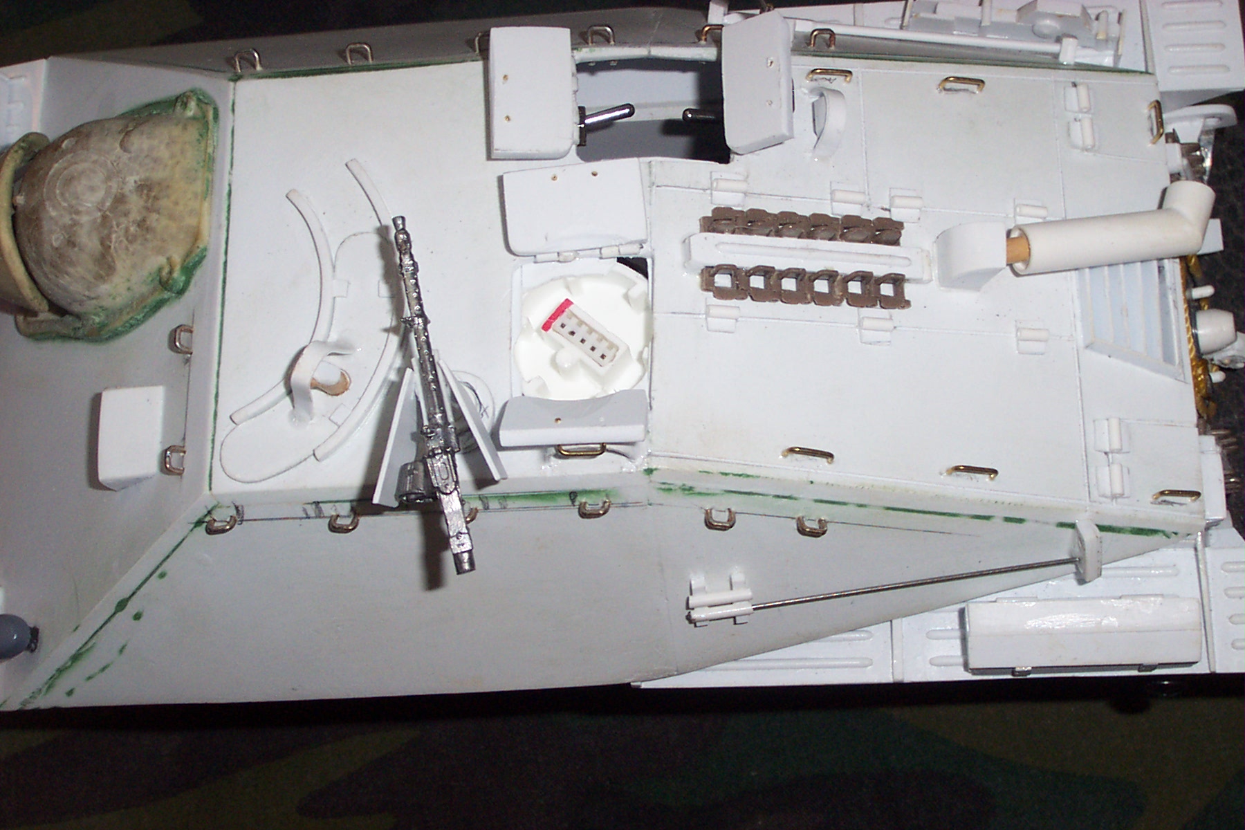

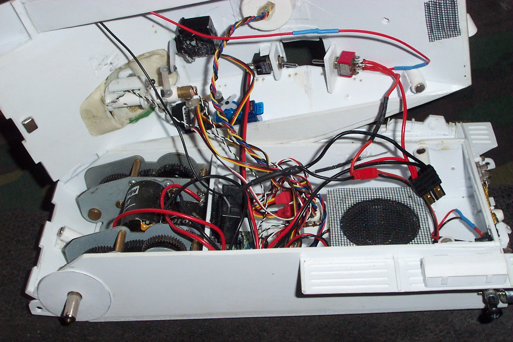

7 Attachment(s)

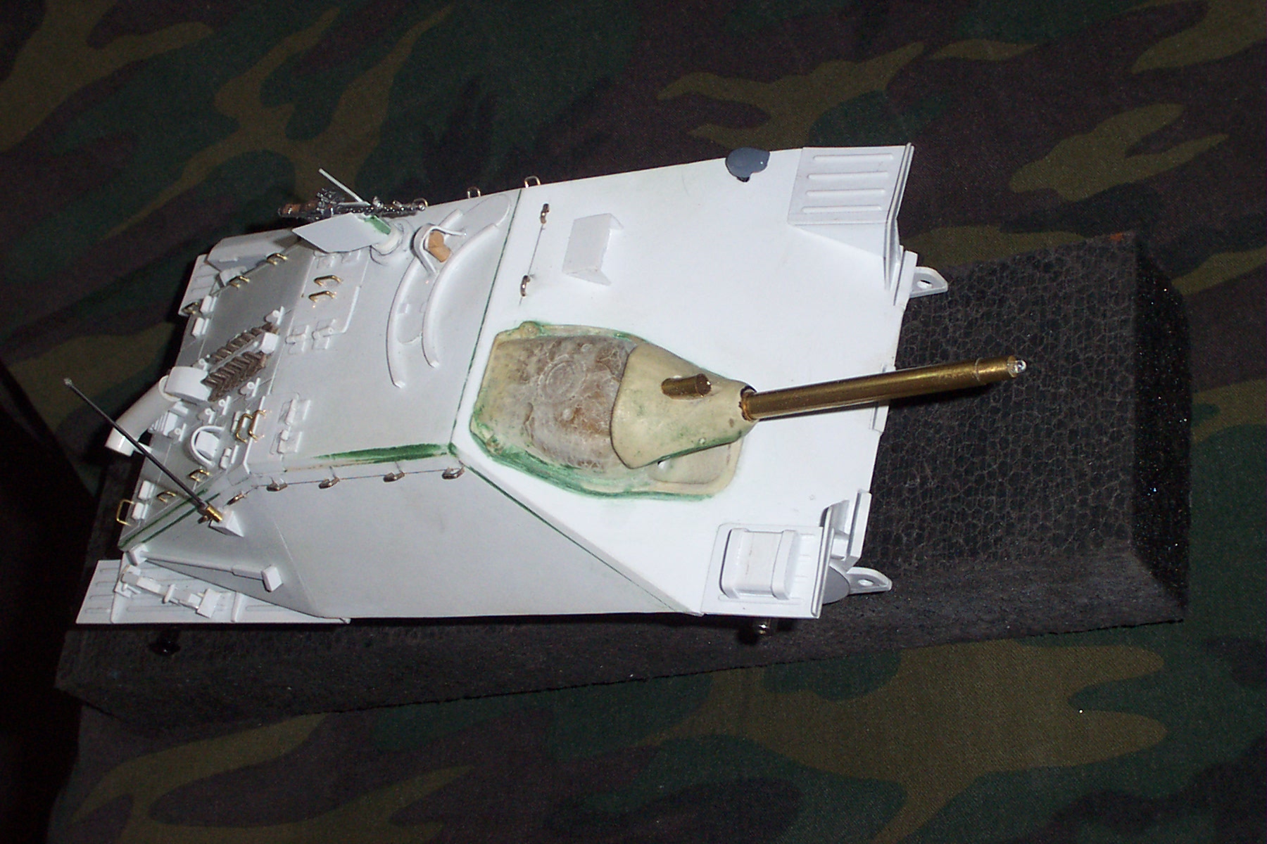

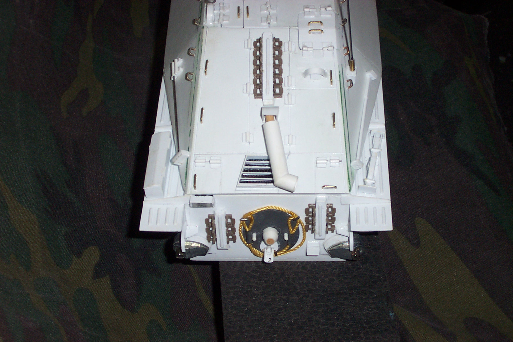

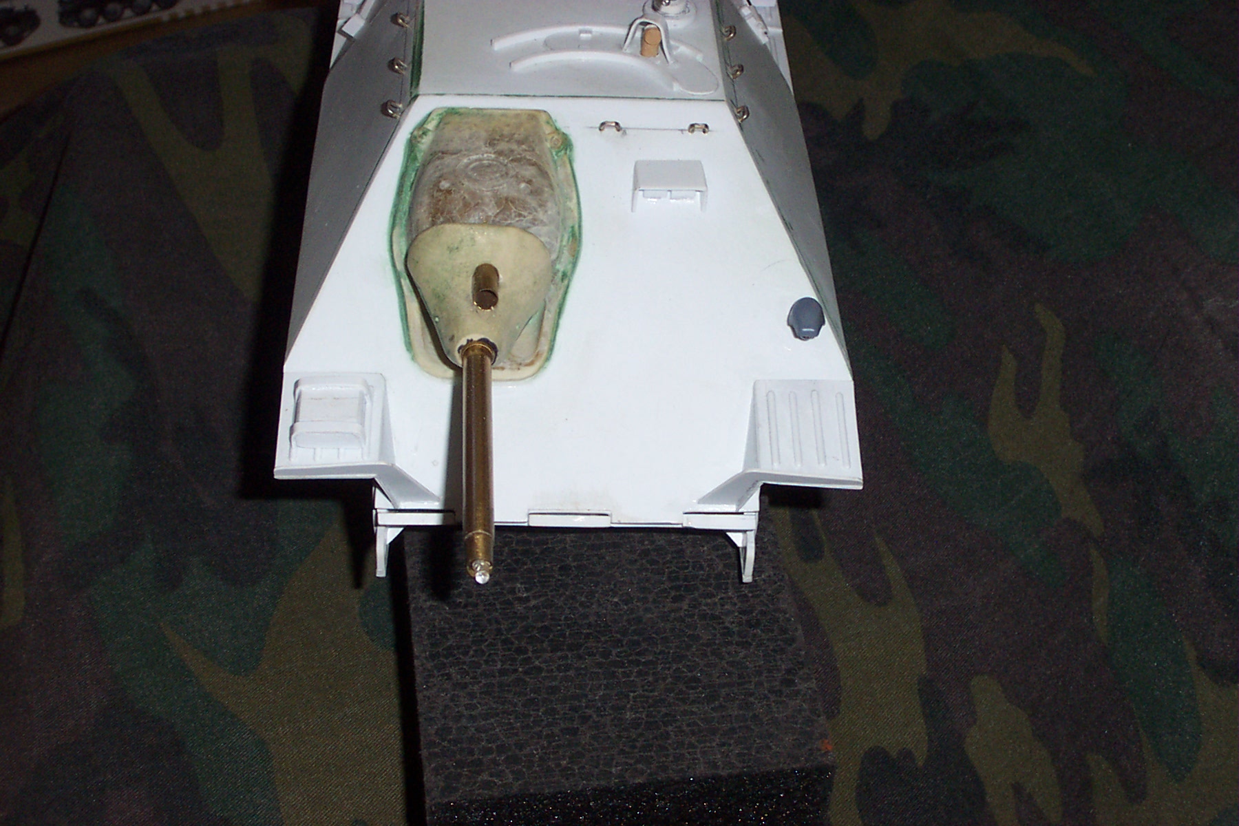

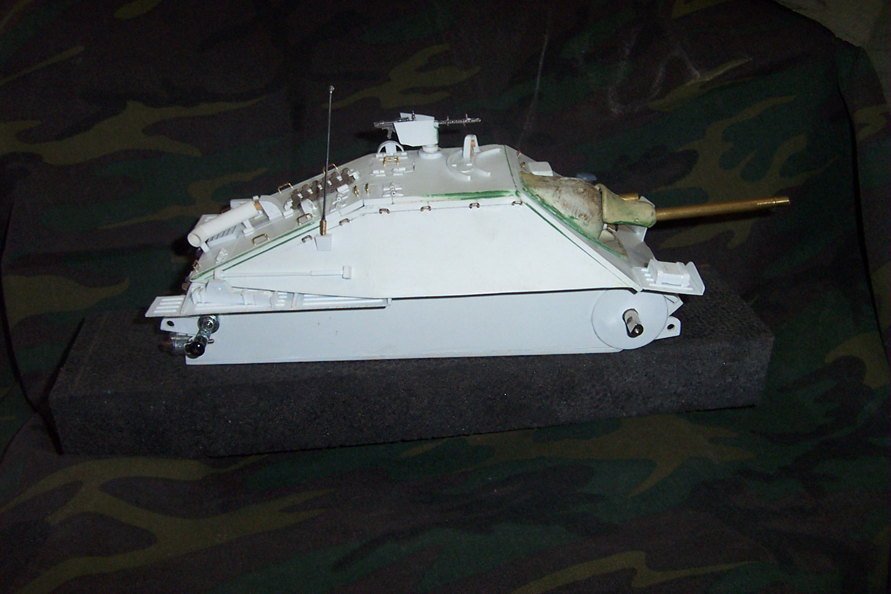

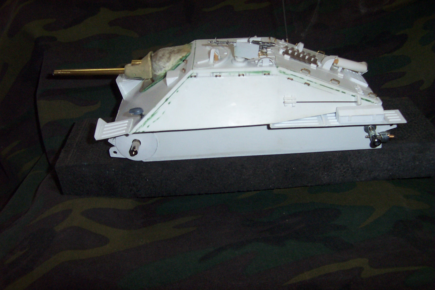

Here are some photo's of the current state of my Hetzer build. I am still waiting on out of country suppliers for some parts, but I am also in negotiations with a machine shop for sprockets and idlers for the metal track from Asiatam. I will post more as I get more parts in. Right now everything is working with the Clark TK22 board and Spectrum 9 radio. I have used HL steel low profile boxes with Promax 400 motors. Gun elevates & depresses with a servo, gun has 15% slew using a servo, and servo recoil. The Notek light works, as does the convoy light. It is set up for IR battling.http://www.rcuniverse.com/forum/atta...mentid=2007024http://www.rcuniverse.com/forum/atta...mentid=2007025http://www.rcuniverse.com/forum/atta...mentid=2007026http://www.rcuniverse.com/forum/atta...mentid=2007027http://www.rcuniverse.com/forum/atta...mentid=2007028http://www.rcuniverse.com/forum/atta...mentid=2007029http://www.rcuniverse.com/forum/atta...mentid=2007030

Strato50 06-20-2014 05:58 AM
Now that's one heck of a tight fit. You did a great job cramming that much AND a decent speaker in there. Did you have to break scale anywhere?
What type of roadwheel will it need?

Green Amphibian 06-20-2014 06:39 AM

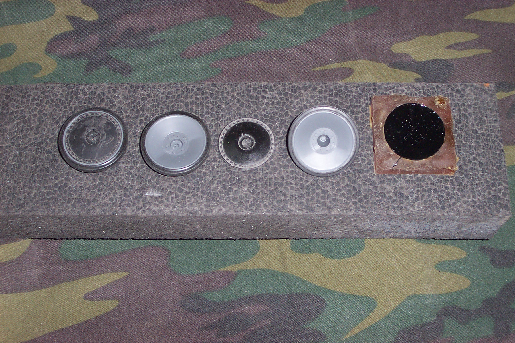

2 Attachment(s)

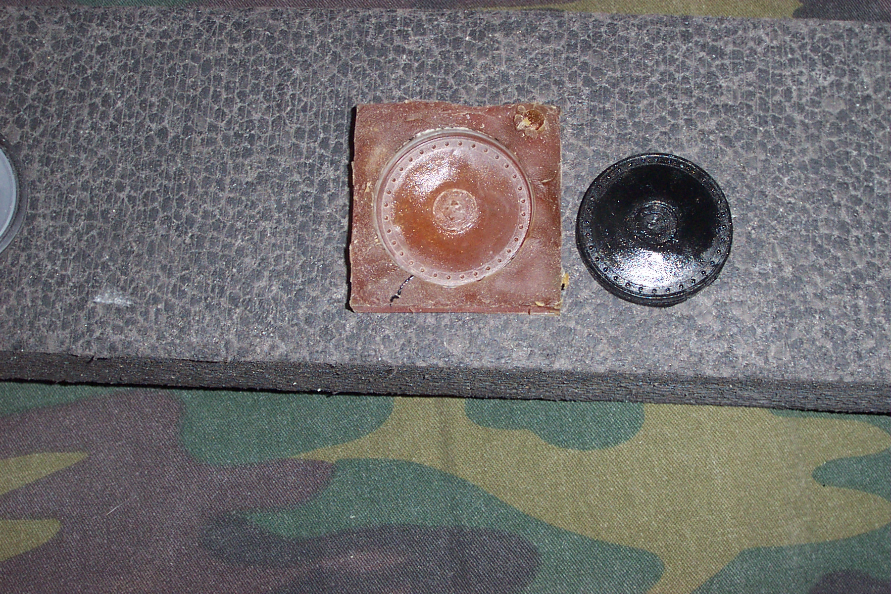

I did have to break scale in the shape of the lower hull and made the sides vertical instead of tapered. Nothing would fit if they were tapered. I will be using Tiger 1 road wheels with a cast "hubcap" to look like the 38t wheels. With the Tiger wheels I get rubber tires instead of plastic. Still working on the suspension system.
Hermanhttp://www.rcuniverse.com/forum/atta...mentid=2007062http://www.rcuniverse.com/forum/atta...mentid=2007063

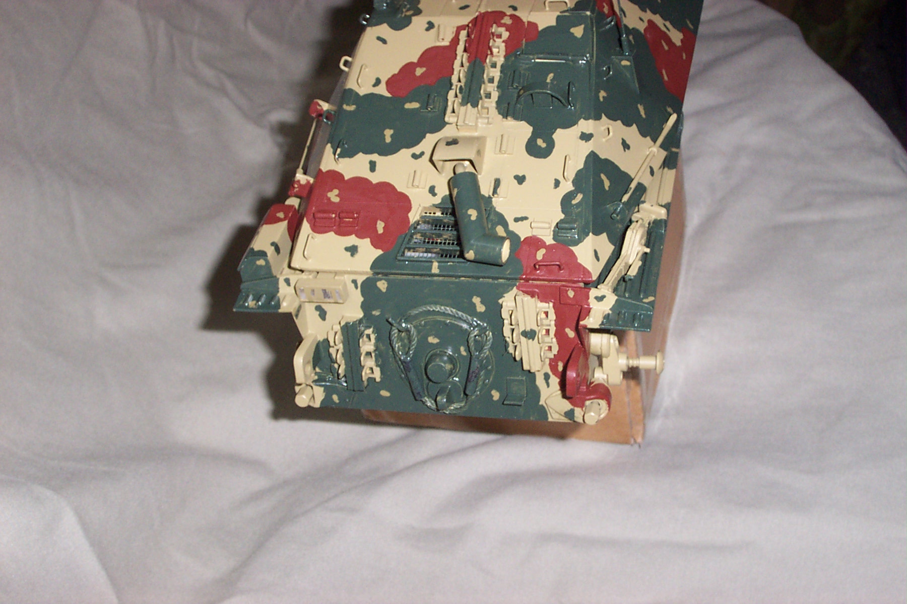

Green Amphibian 07-20-2014 04:16 PM

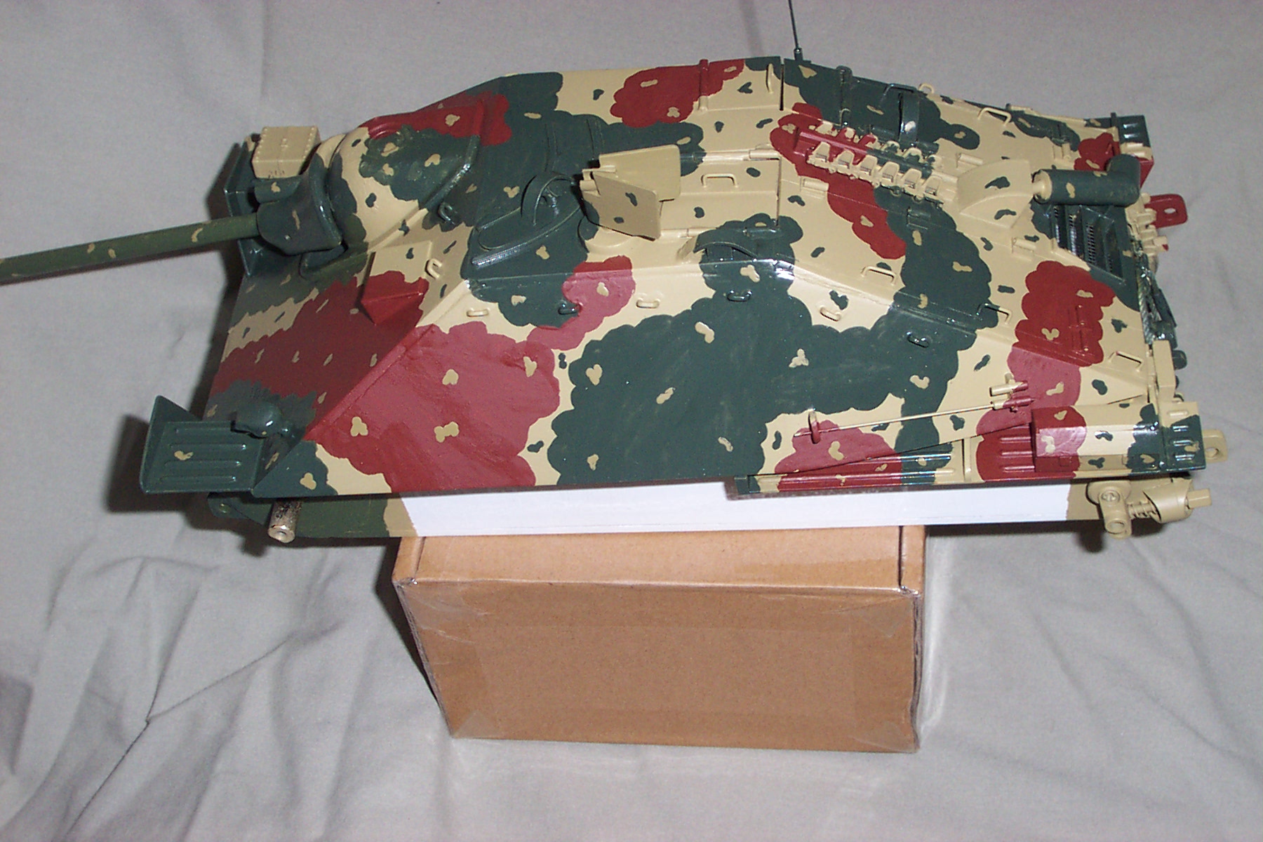

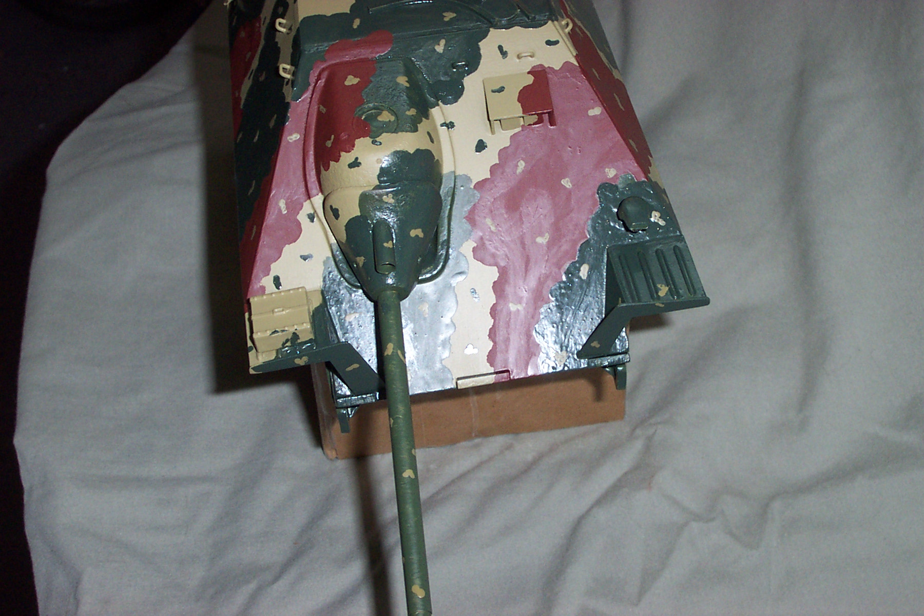

4 Attachment(s)
Well, I got frustrated on another project so I started painting. This one is for someone else, but mine will be quite similar to it. Still waiting on the sprockets to finish the suspension.
Hermanhttp://www.rcuniverse.com/forum/atta...mentid=2015861http://www.rcuniverse.com/forum/atta...mentid=2015862http://www.rcuniverse.com/forum/atta...mentid=2015863http://www.rcuniverse.com/forum/atta...mentid=2015864

Green Amphibian 07-22-2014 03:00 PM

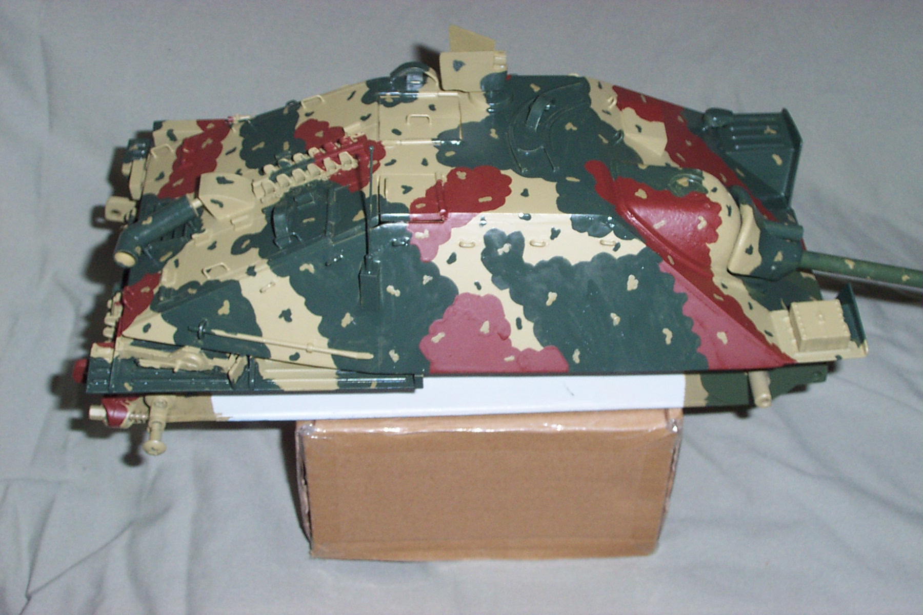

2 Attachment(s)
Here are the four amigo's together. Each is at a different stage in painting and construction, and none of it is finished yet.
Herman
panther commander 07-22-2014 03:04 PM
Looks nice Herman. Which one is the one you're building for us?
Green Amphibian 07-22-2014 03:34 PM
Yours is the one on the far right with most of the paint finished. Mine is next to it.
