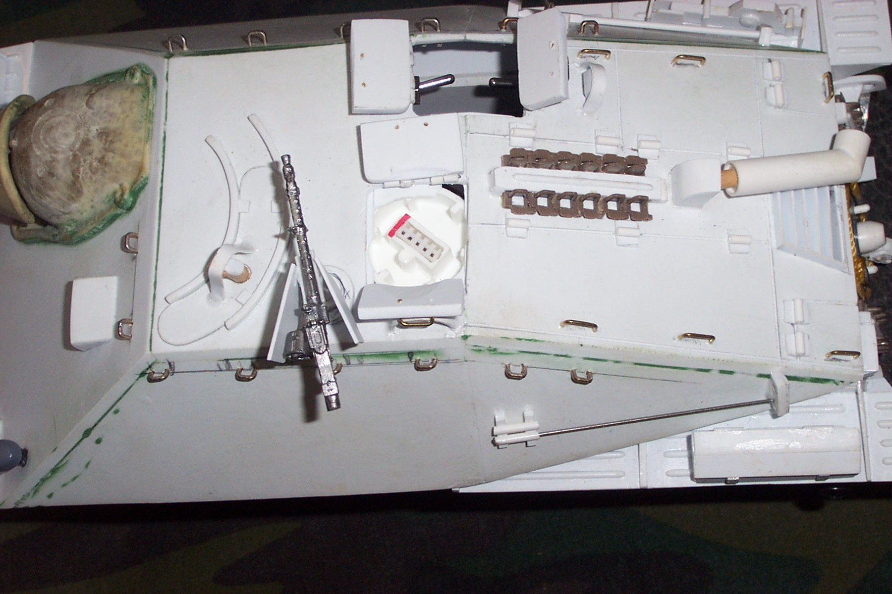

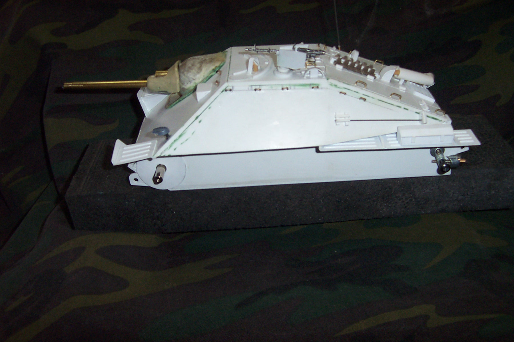

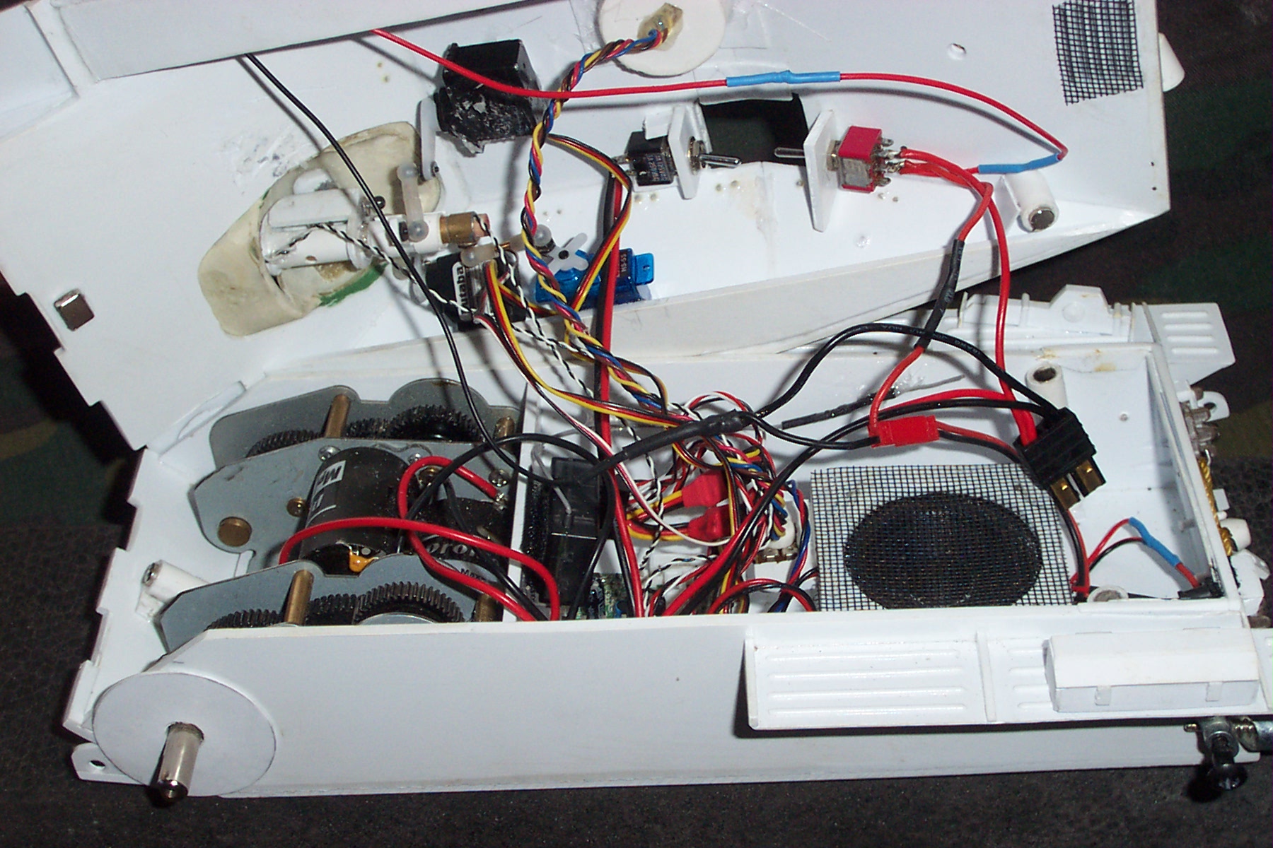

Here are some photo's of the current state of my Hetzer build. I am still waiting on out of country suppliers for some parts, but I am also in negotiations with a machine shop for sprockets and idlers for the metal track from Asiatam. I will post more as I get more parts in. Right now everything is working with the Clark TK22 board and Spectrum 9 radio. I have used HL steel low profile boxes with Promax 400 motors. Gun elevates & depresses with a servo, gun has 15% slew using a servo, and servo recoil. The Notek light works, as does the convoy light. It is set up for IR battling.
Herman

Now that's one heck of a tight fit. You did a great job cramming that much AND a decent speaker in there. Did you have to break scale anywhere?
What type of roadwheel will it need?

I did have to break scale in the shape of the lower hull and made the sides vertical instead of tapered. Nothing would fit if they were tapered. I will be using Tiger 1 road wheels with a cast "hubcap" to look like the 38t wheels. With the Tiger wheels I get rubber tires instead of plastic. Still working on the suspension system.
Herman

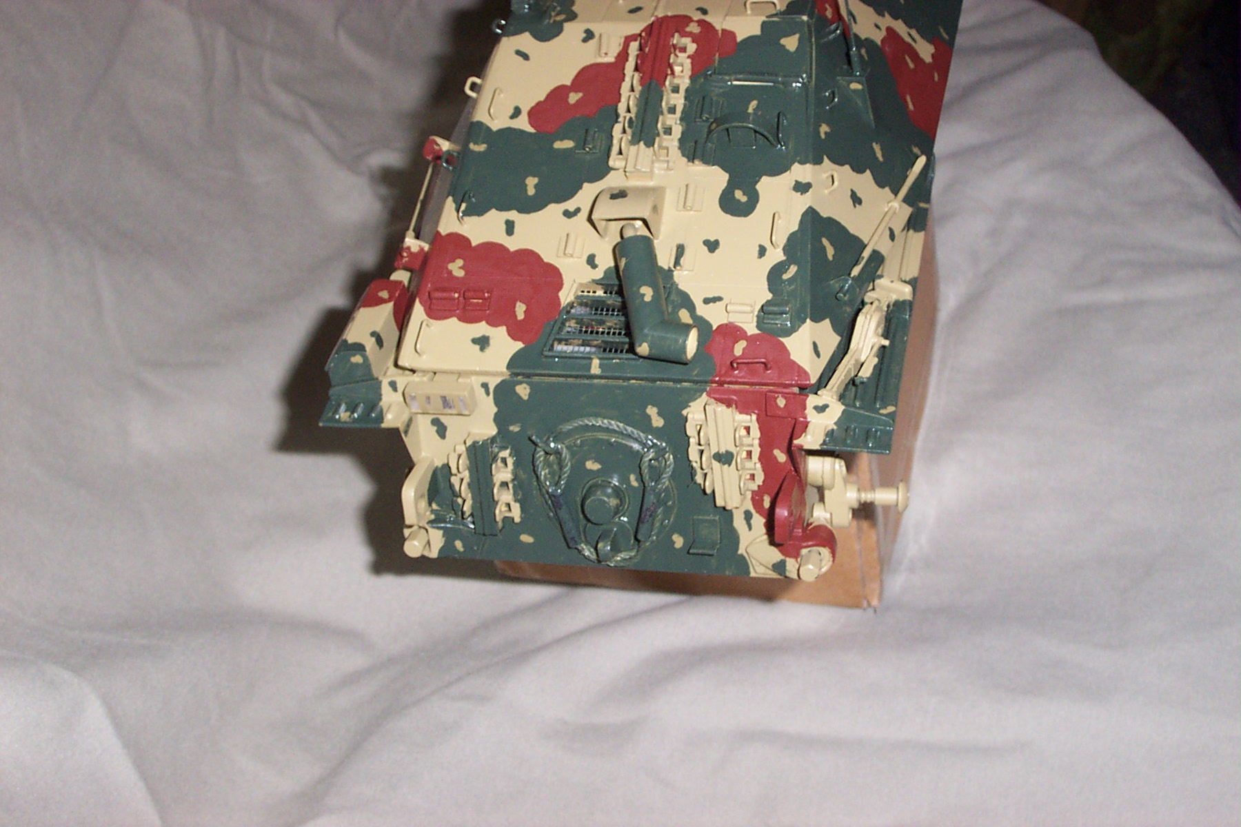

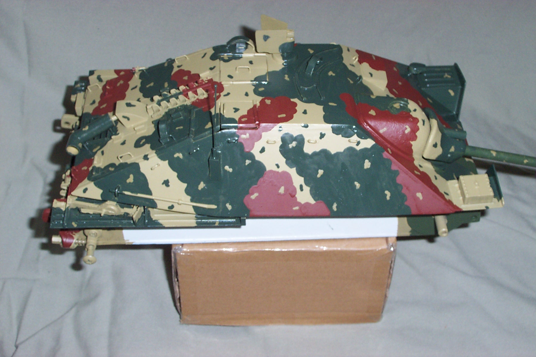

Green Amphibian's Avatar
Joined: Jan 2009
Posts: 1,567
From: King, NC

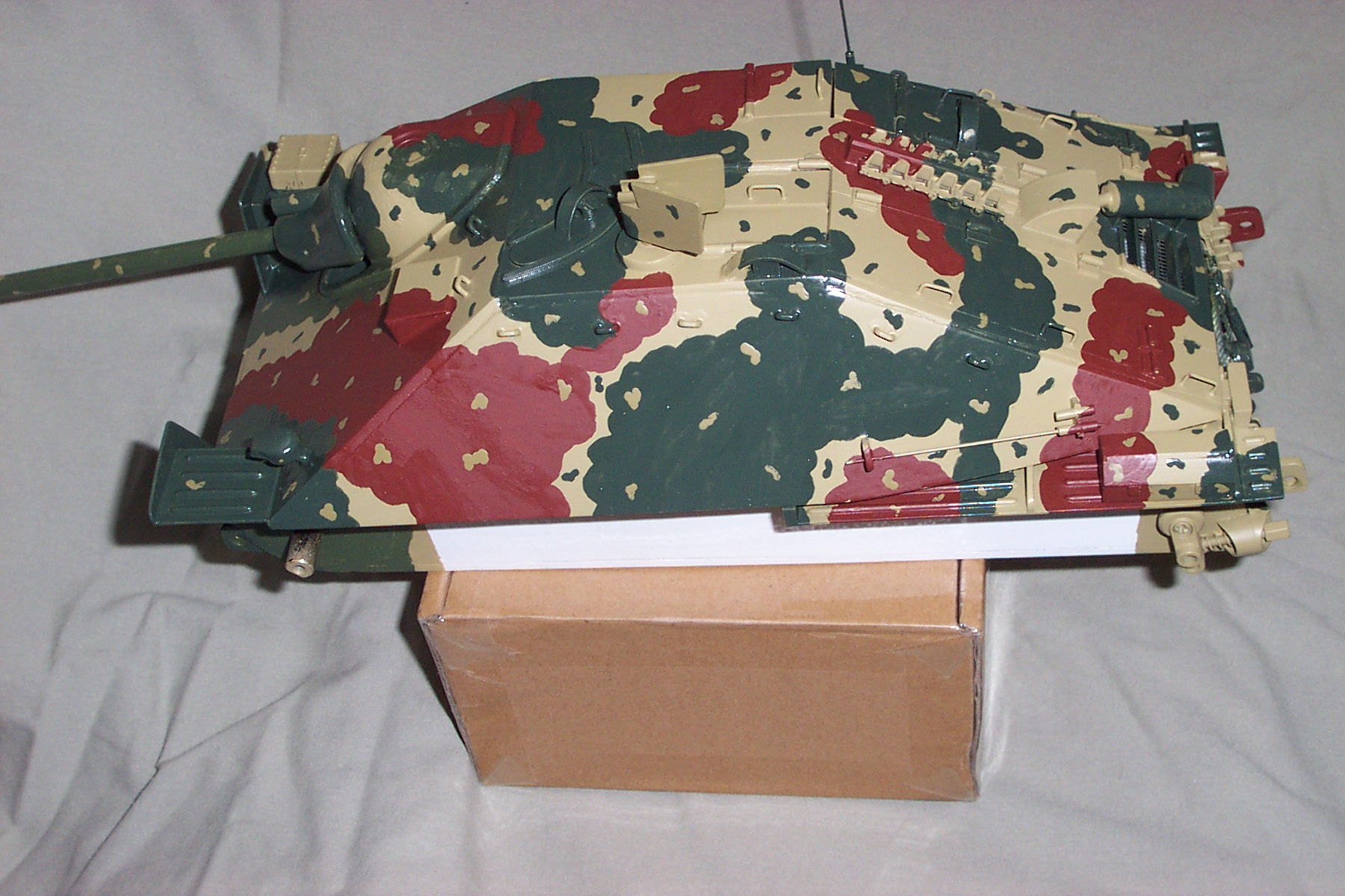

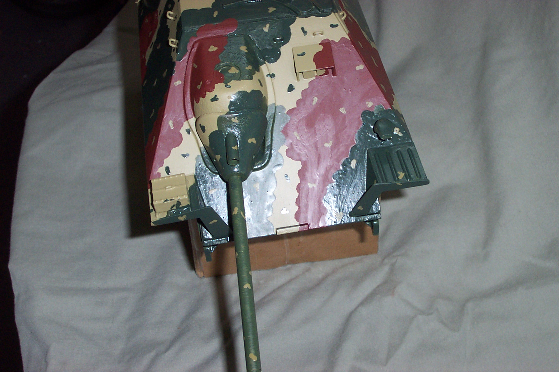

Well, I got frustrated on another project so I started painting. This one is for someone else, but mine will be quite similar to it. Still waiting on the sprockets to finish the suspension.
Herman

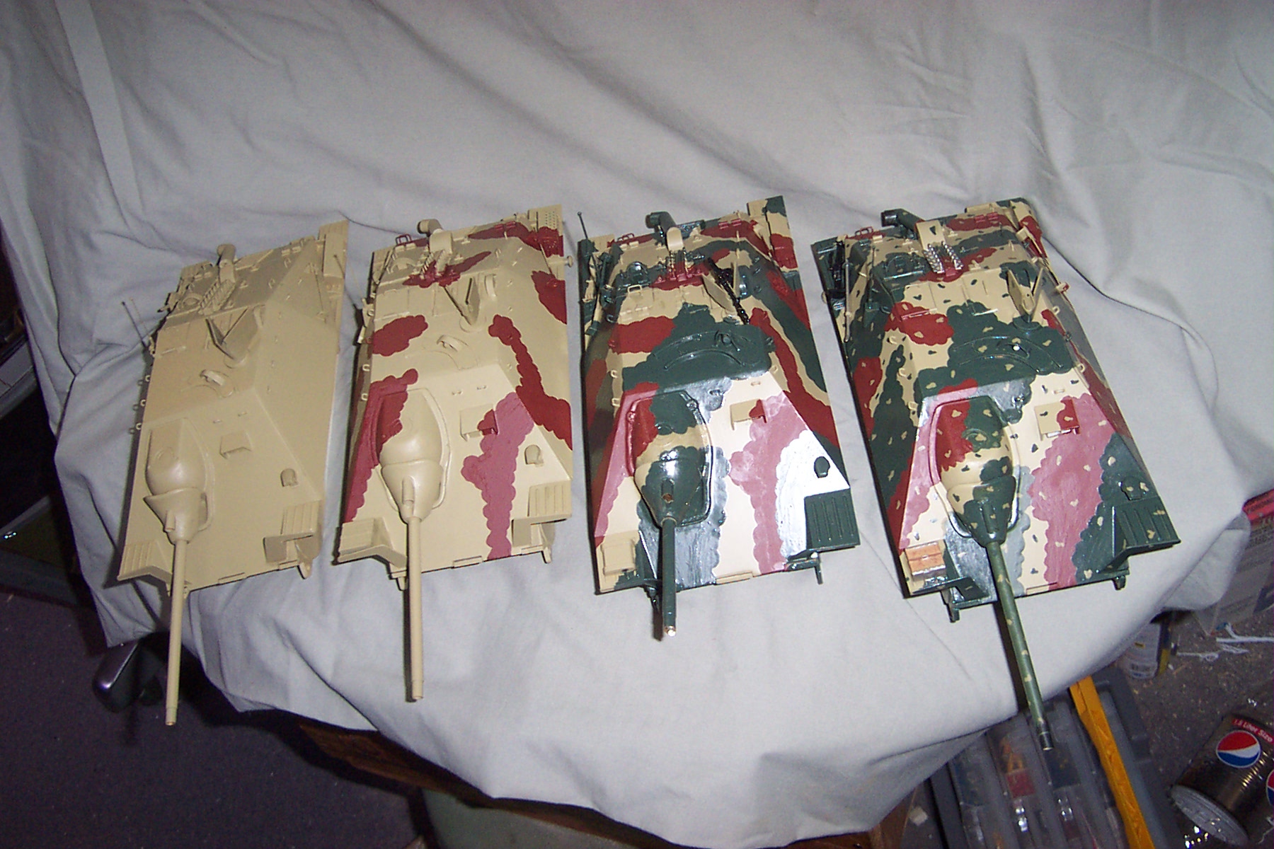

Joined: Jan 2009
Posts: 1,567
From: King, NC

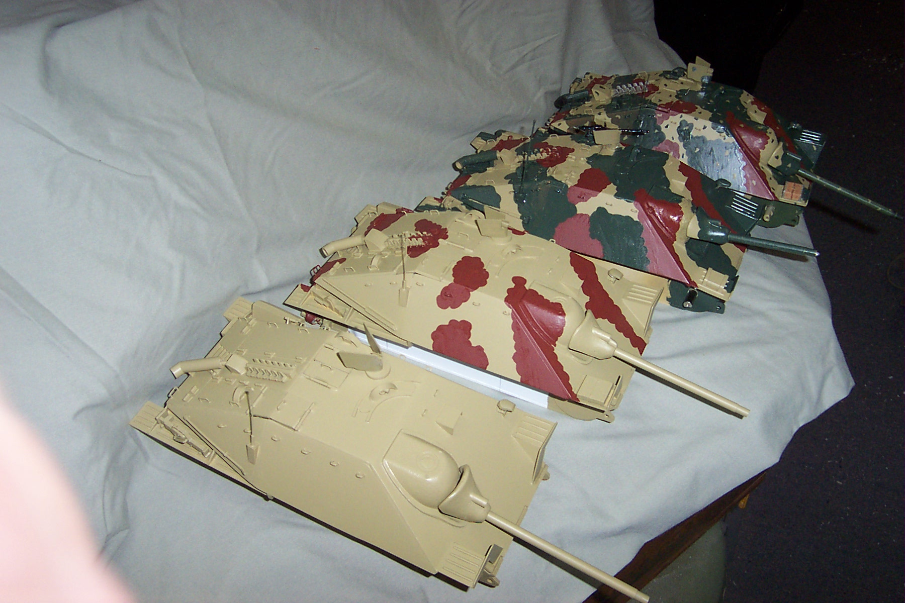

Here are the four amigo's together. Each is at a different stage in painting and construction, and none of it is finished yet.
Herman

Old 07-22-2014 | 03:04 PM
Joined: Nov 2011
Posts: 56
From: centreville, VA
Looks nice Herman. Which one is the one you're building for us?
Old 07-22-2014 | 03:34 PM
Joined: Jan 2009
Posts: 1,567
From: King, NC
Yours is the one on the far right with most of the paint finished. Mine is next to it.
