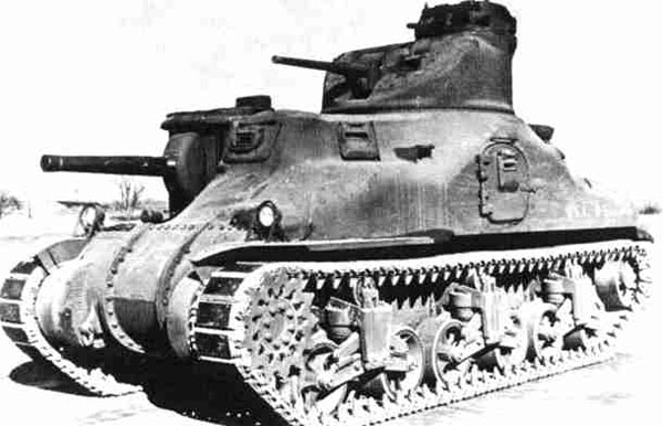

The hull is a Sherman with VVSS, right? I'd have to do the top hull from a kitbash or from scratch, right? Of course, Rex has probably already done two of them. :) I'm thinking they should come out with the lower hull for the Imex Sherman, just like the T-34, so I'm thinkin' it over. Never tried a scratchbuild before, maybe it's time. Any tips, ideas, suggestions, rude comments, propositions from pretty girls, etc, etc, etc. Thanks in advance, guys. I really want to do an E8, and that means the Tamiya kit but it would be cool to be able to do something with this new Sherman from Imex. Has anyone else seen that flick, Sahara, with Humphrey Bogart circa 1943? Tank was named Lullubelle? M3 Lee.

Panther F 10-04-2014 09:17 AM
Yes, yes, yes and yes. (I think that's too many yes's but oh well)
Actually you should use the earlier VVSS with the return roller only and no arms.
http://the.shadock.free.fr/sherman_m...3lee_bogie.jpg

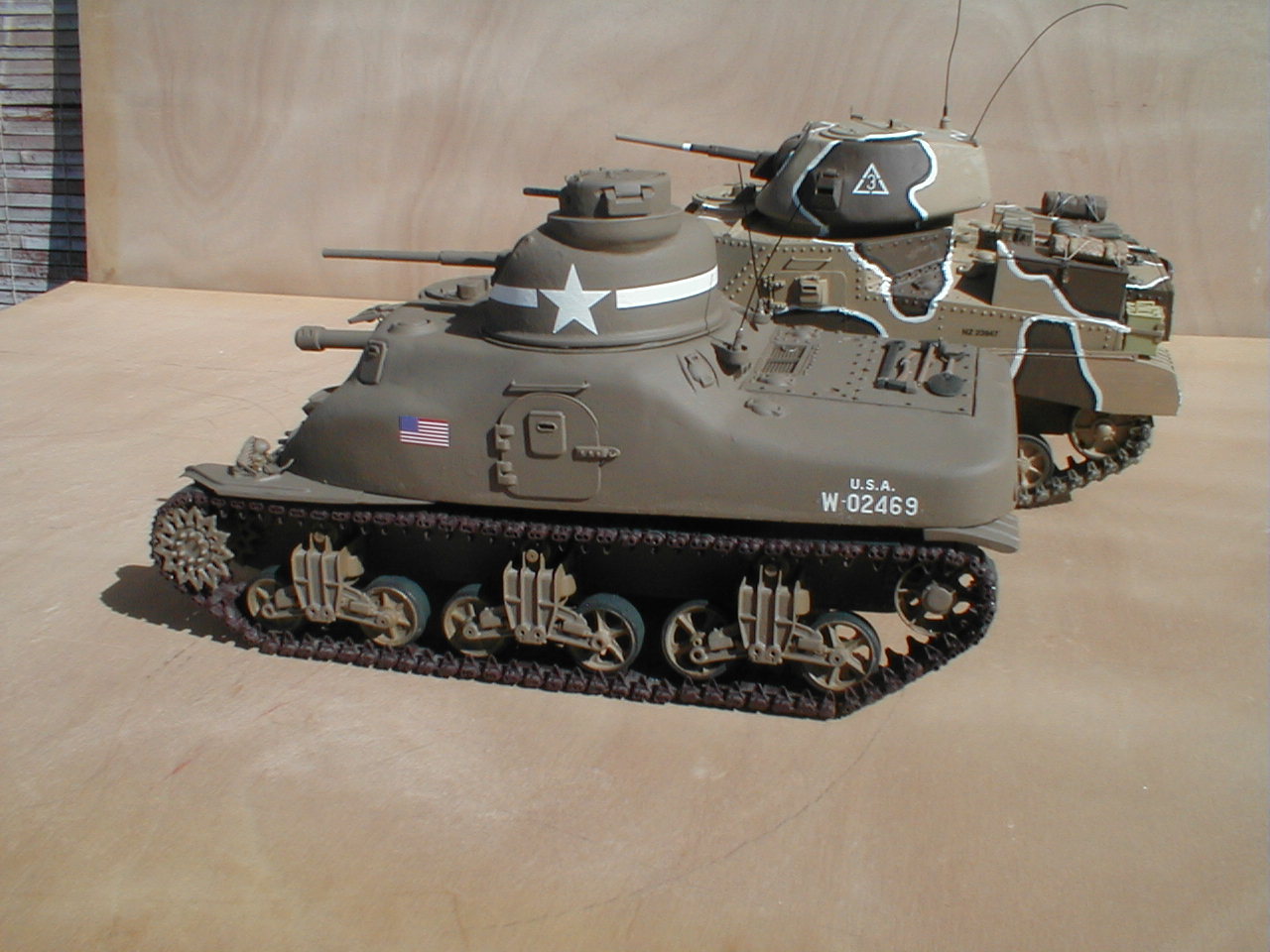

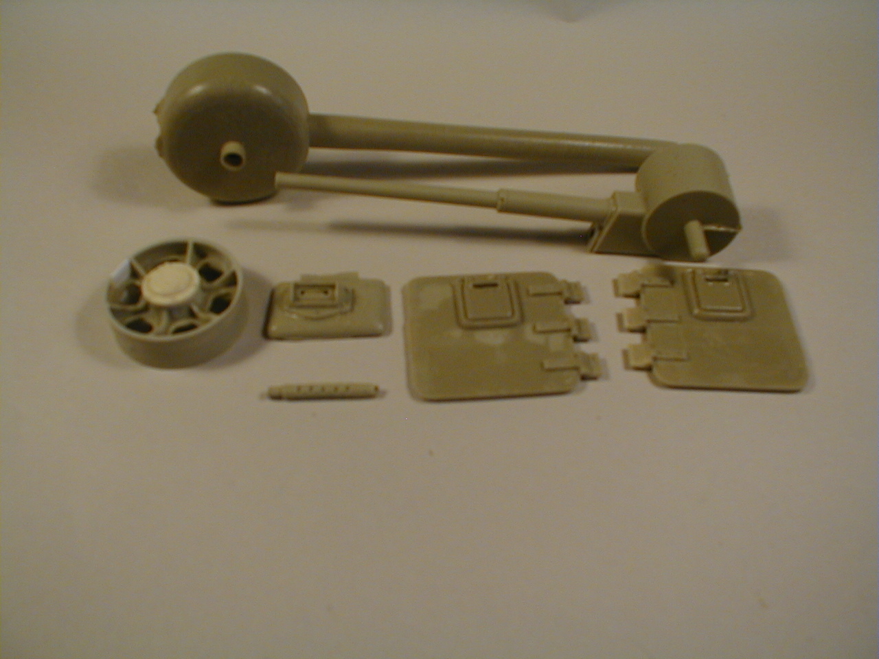

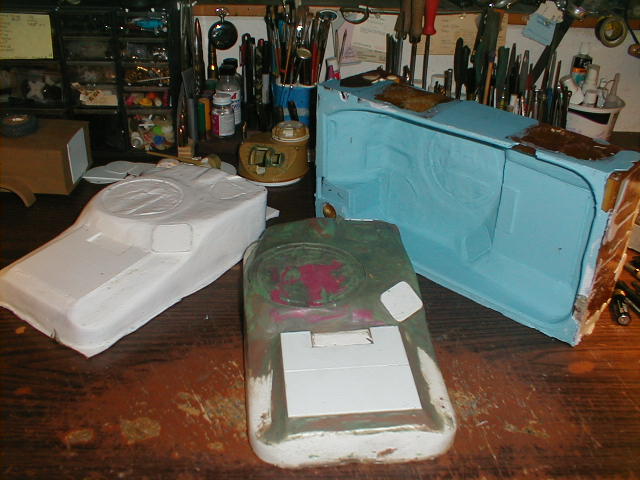

Rex Ross 10-05-2014 10:43 AM
5 Attachment(s)

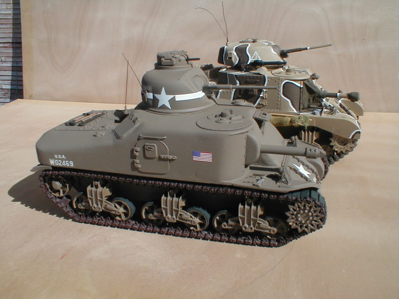

When I was a kid and I saw the movie Sahara - with Bogart, it had an incredible effect on me that lasted all of my life. I started to build Lulubelle with the thought of making a diorama of that desert oasis waterhole. When I realized how big it would be, and that I would be covering the tank with sand, I decided to just build an M3 Grant with a British desert camo paint job. That was in 2004. A short time later I got the urge to build a cast hull M3 Grant like the ones that showed up in the relief column at the end of the movie. Since then I have been able to watch that movie with both tanks on my lap ..........some guys never grow up, they just get older.
I don't know what could be used for a conversion into a Lee or Grant without a heck of a lot of scratch building.
Here's what I started with for the riveted hull and cast hull projects.
http://www.rcuniverse.com/forum/atta...mentid=2037402http://www.rcuniverse.com/forum/atta...mentid=2037403http://www.rcuniverse.com/forum/atta...mentid=2037404http://www.rcuniverse.com/forum/atta...mentid=2037405http://www.rcuniverse.com/forum/atta...mentid=2037406
Max-U52 10-05-2014 03:50 PM
Hey Rex, I'm really glad you chimed in, I was hoping you would. Those photos are great, and I've been studyin' them. I need to study them some more. Did you ever do the Lullubelle, and what's different between her and the two in these amazing photos you posted? I'm thinking she was the riveted version, but didn't she have the turret like the cast version? Wow, I haven't even started and I'm all confused all ready! That's why I need to study and think for a few days before I open my mouth. :)
I sure would like to see more photos of the build if you feel like posting them.
afv aficionado 10-05-2014 04:01 PM
Hi Max
The M3 in Rex's pics - the closest one is the US turret version with MG cupola, the further one is the British turret with radio facilities, but no MG cupola. I think the Grant was US, Lee the Brit, but may have that backwards.
Mal

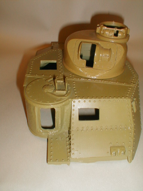

Max-U52 10-05-2014 05:18 PM
1 Attachment(s)
OK, Rex, this is why I was confused -
http://www.rcuniverse.com/forum/atta...mentid=2037547
This has the rivet upper hull like yours, but with the mini turret from the cast version, right? Is this Hollywood? Even if it is, this would be a very cool tank to build. I think I might be able to make the hull from sheet styrene, but I'm not so sure about that mini turret. Your is cast from resin? Have you taken a good look at the new hulls from mato and taigen? I think they might work for this, but I don't have your experience. I wonder how long it will take Imex to bring the lower hull to market. The T-34 was within a month of initial release, right? I'll also have to find out if mato is gonna sell the lower hull separately for their Sherman.
Rex Ross 10-05-2014 05:50 PM
The M3 Lee was the US version of that tank. It was produced as a riveted hull, a welded hull and a lengthened version. There were a few different models made .... just like the Shermans. The US tank had a small a cast turret with a 37mm cannon, and a small machine gun turret was on top as shown in the photo. The British version, which was named the Grant, also had a cast turret but It didn't have the small m.g. turret. The British turret was longer and wider to accommodate radio gear and stuff. The cast hull M3 Lee never saw combat. It was used in the US as a training tank, in the desert mostly. Only about 300 were made. A cast hull took days to cool down before machining and installing everything and that took a lot longer than the riveted and welded hulls. My turrets and hulls are resin. I wish the Mato hull, track and VVSS suspension had been available 20 years ago. That would have saved me a bunch of work (and $$$ )on all of my Tamiya conversions.
Rex

Rex, That resin riveted upper hull looks like just what I need. Can you cast another one of those, and if so, would you be willing to cast one and sell it to me? No hurry, I'm sure the imex lower hull won't be available till well after Christmas, and who knows how long it will take me to buy one and get started on the project, but it would be great to have that great resin piece waiting in the wings for when I get ready. I still want to pick up a tammy sherman to do the E8, too, but time is one thing I have. So what do you think, Rex? Can you get me started down the road?
Rex Ross 10-06-2014 09:33 AM
Maxu52 ...
I did not cast the riveted hull for the M3 Lee that I built. I bought it about 25 years ago from Mike McCauley, a guy who was known as Mad Max, and his trademark was Maxtrax. I don't think he is still doing resin castings. At any rate, I think I would have been better off totally building the upper hull from scratch. I wish I could help you, but I never build anything with the thought that someone else might benefit from something I make.
