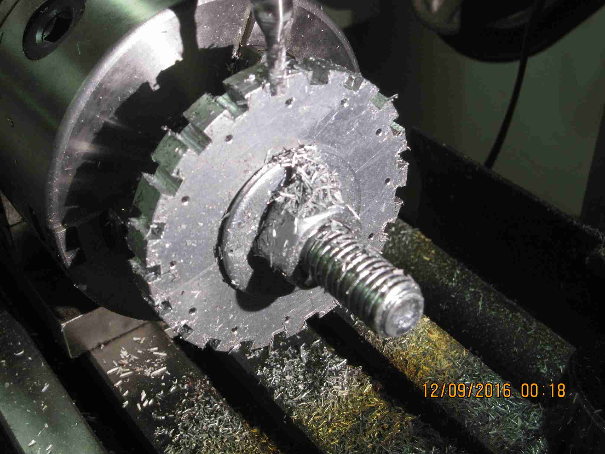

Made a trial of 4 sprocket rings, discs so far. Enough for two sprockets or one tank. I might be able to use two sets of the original castings I have.
Making the rings isn't terribly difficult but just a bit tedious.
See the results below, they still need a touch of hand work clean up and of course to be cut into actual rings...

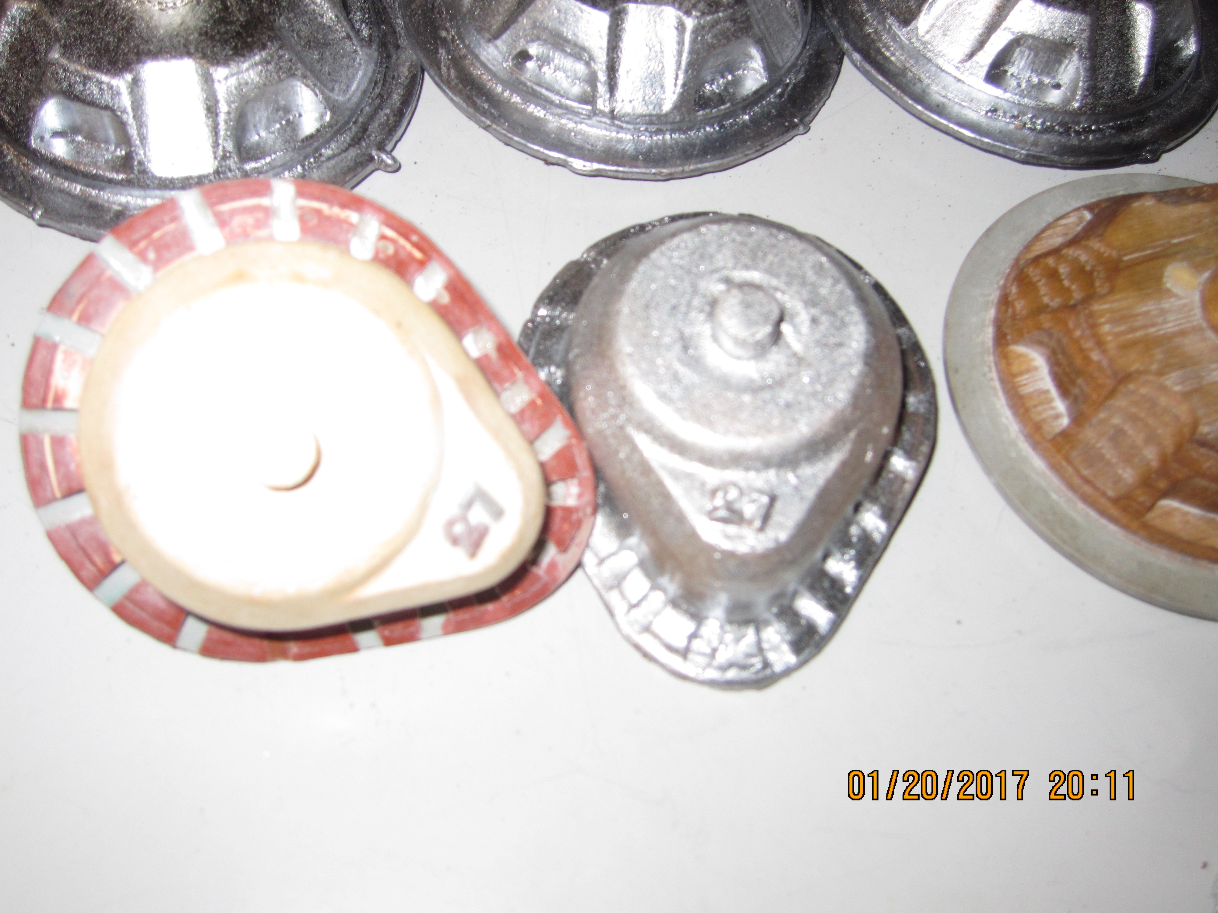

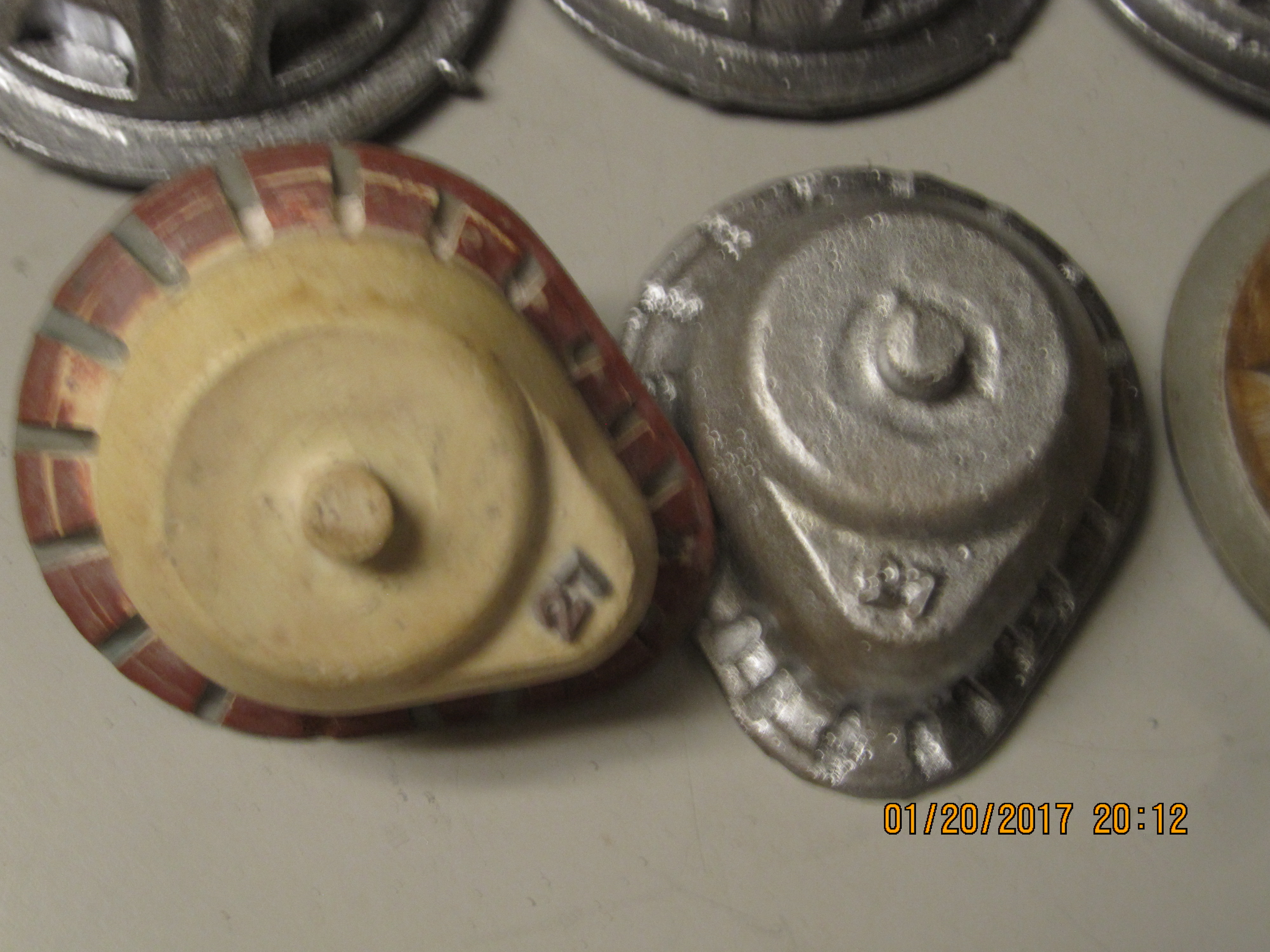

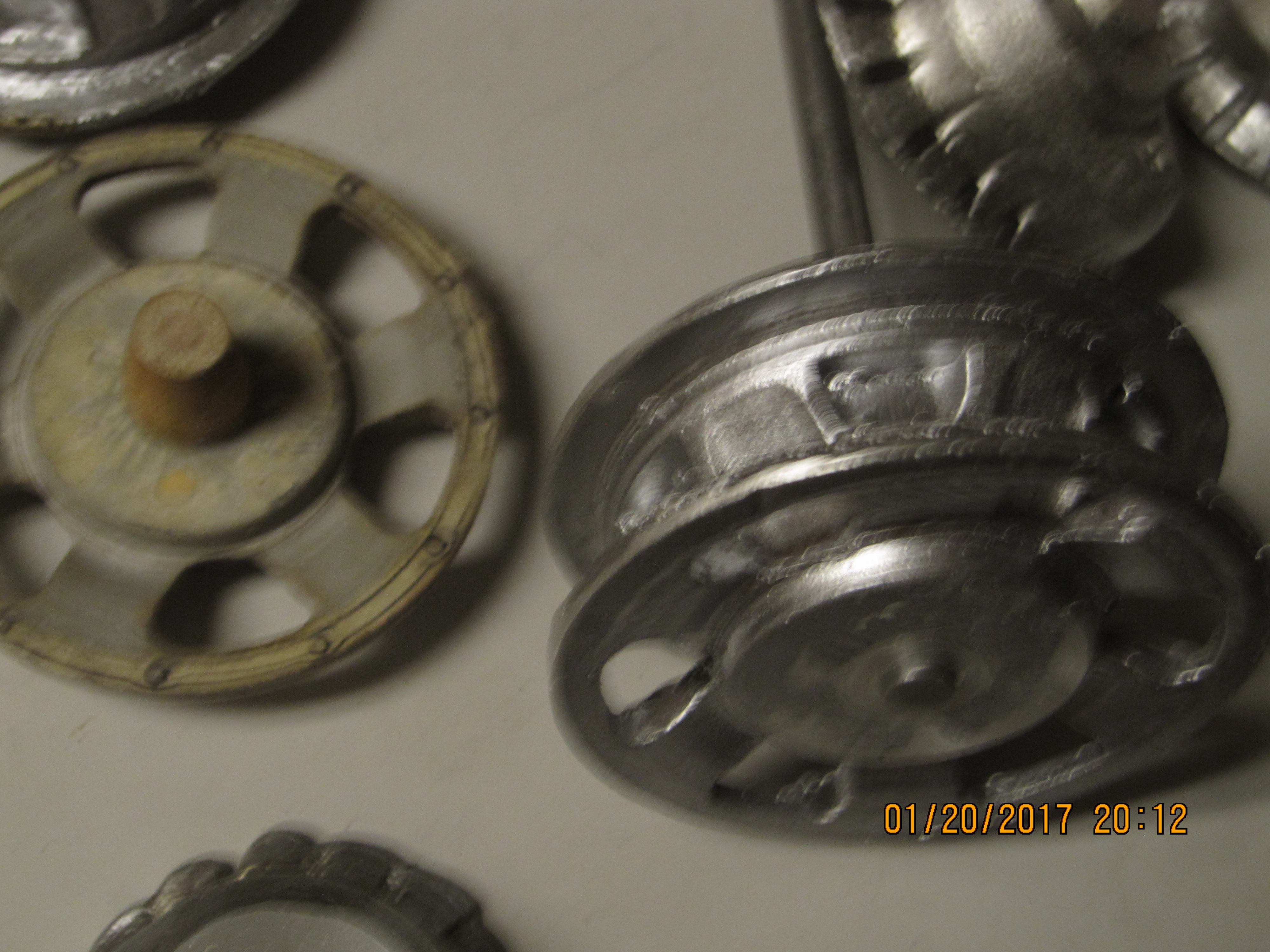

Tanque 01-19-2017 07:39 PM
8 Attachment(s)

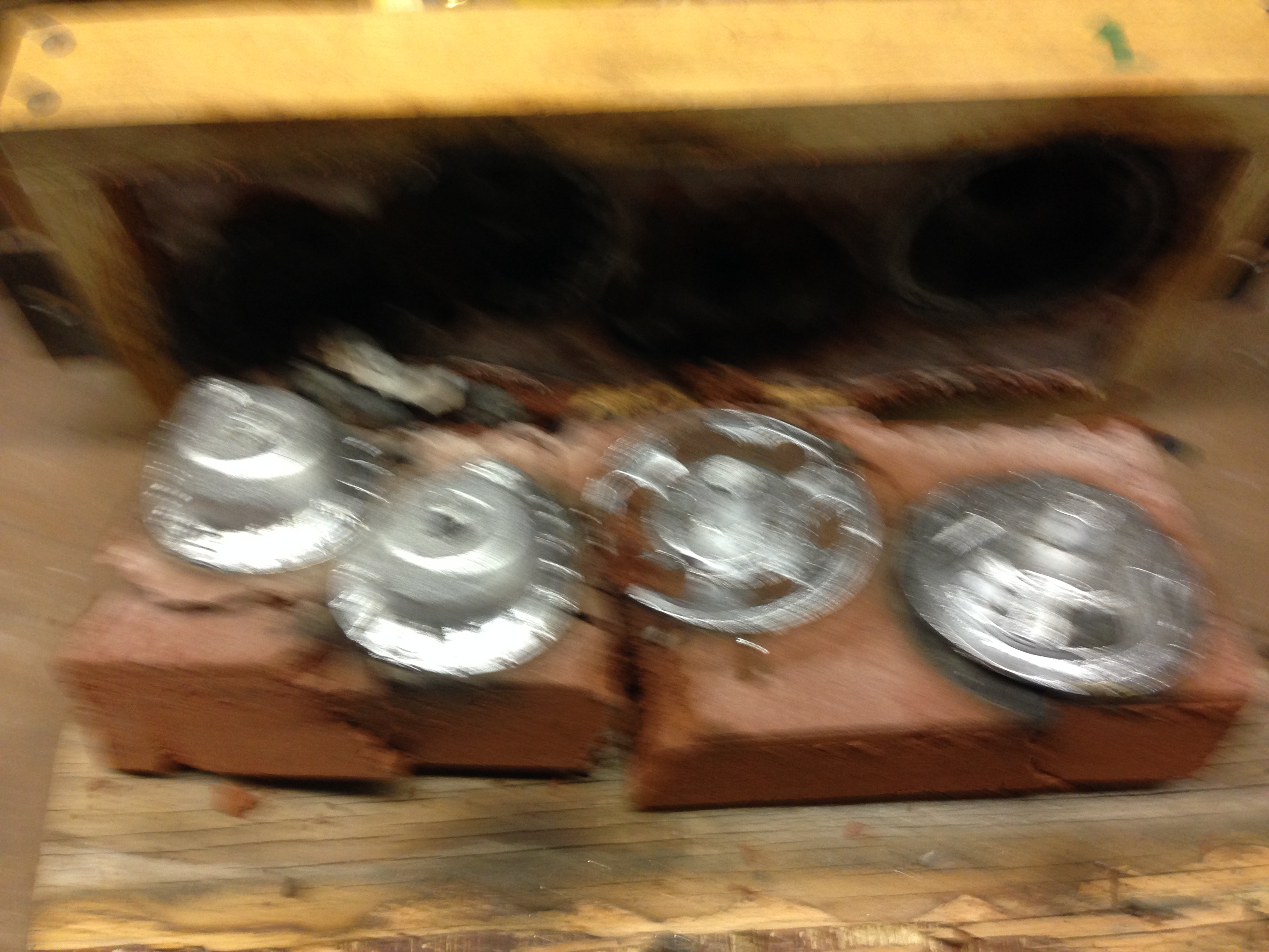

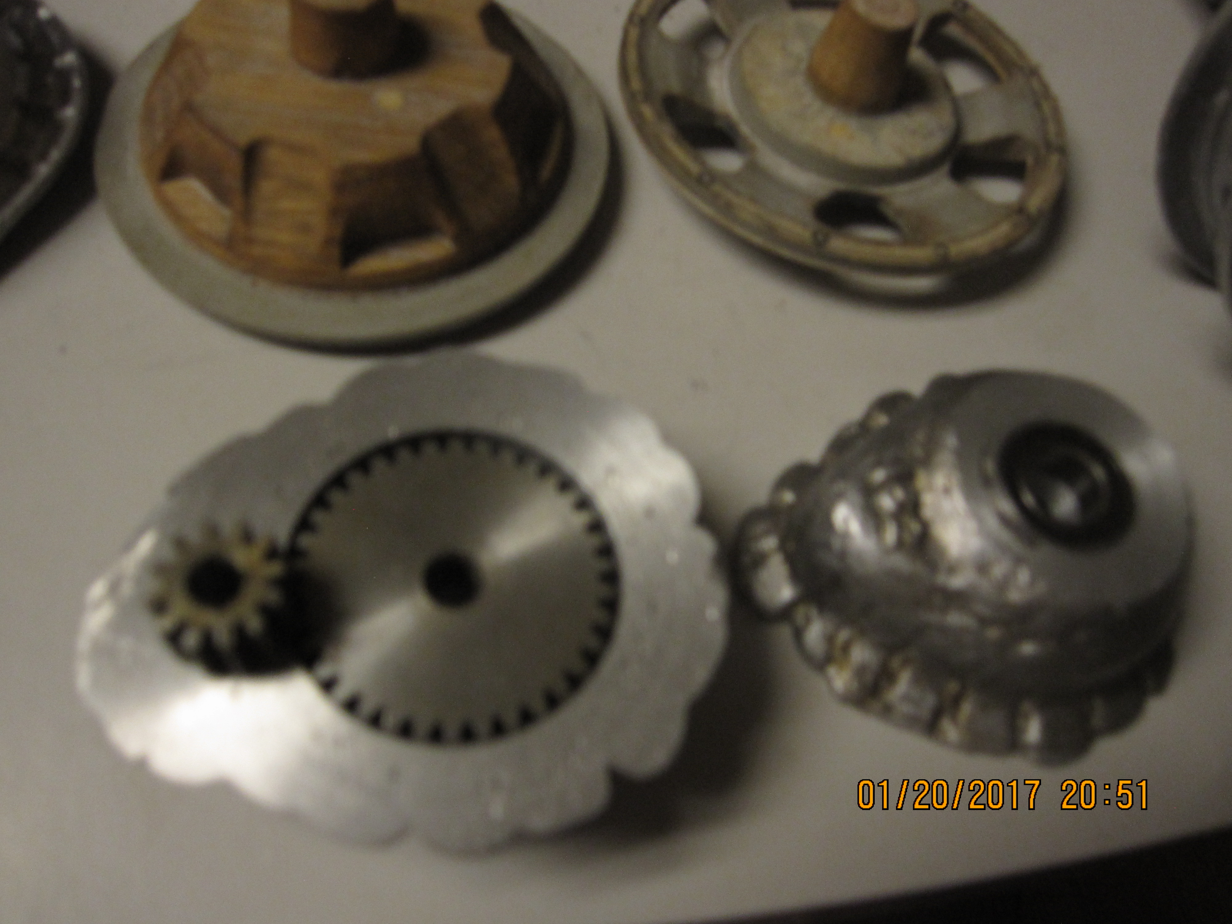

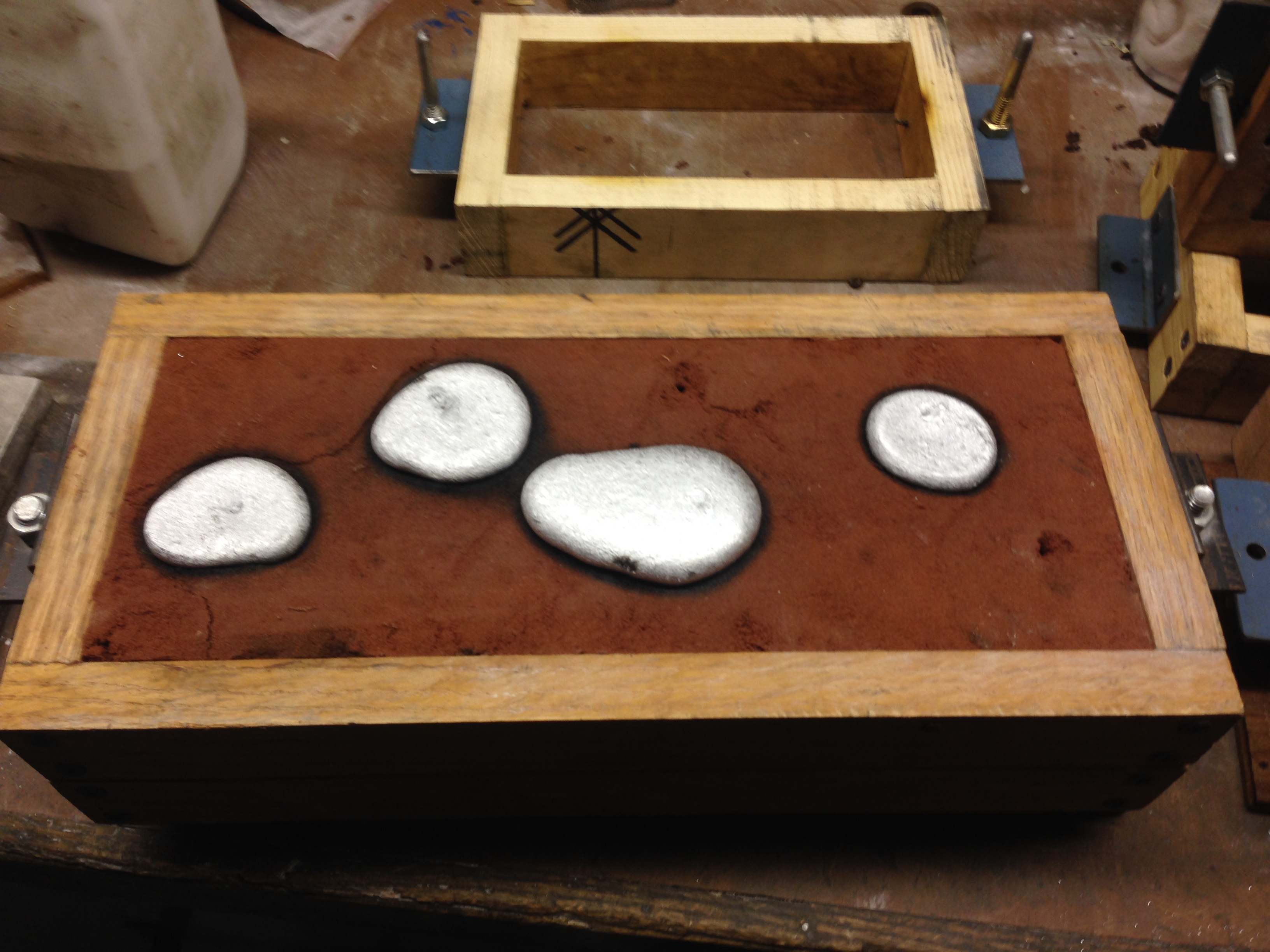

Between rain storms I was able to cast up a few parts for this project and make progress...
You can pick out the patterns in the attached photos. The back sprocket portion pattern is mostly
wood with a plastic flange ring. The front ( outer) portion of the sprocket body is plastic with attached wood pieces. The one final drive pattern is cast resin ( with lead numbers) and a polystyrene flange extension to aid
the pour. I've been making good use of my sand muller and it really makes a difference in the quality of the castings when you use properly prepared sand...
Jerry
http://www.rcuniverse.com/forum/atta...mentid=2197371http://www.rcuniverse.com/forum/atta...mentid=2197372http://www.rcuniverse.com/forum/atta...mentid=2197373http://www.rcuniverse.com/forum/atta...mentid=2197374http://www.rcuniverse.com/forum/atta...mentid=2197375http://www.rcuniverse.com/forum/atta...mentid=2197376http://www.rcuniverse.com/forum/atta...mentid=2197377http://www.rcuniverse.com/forum/atta...mentid=2197378

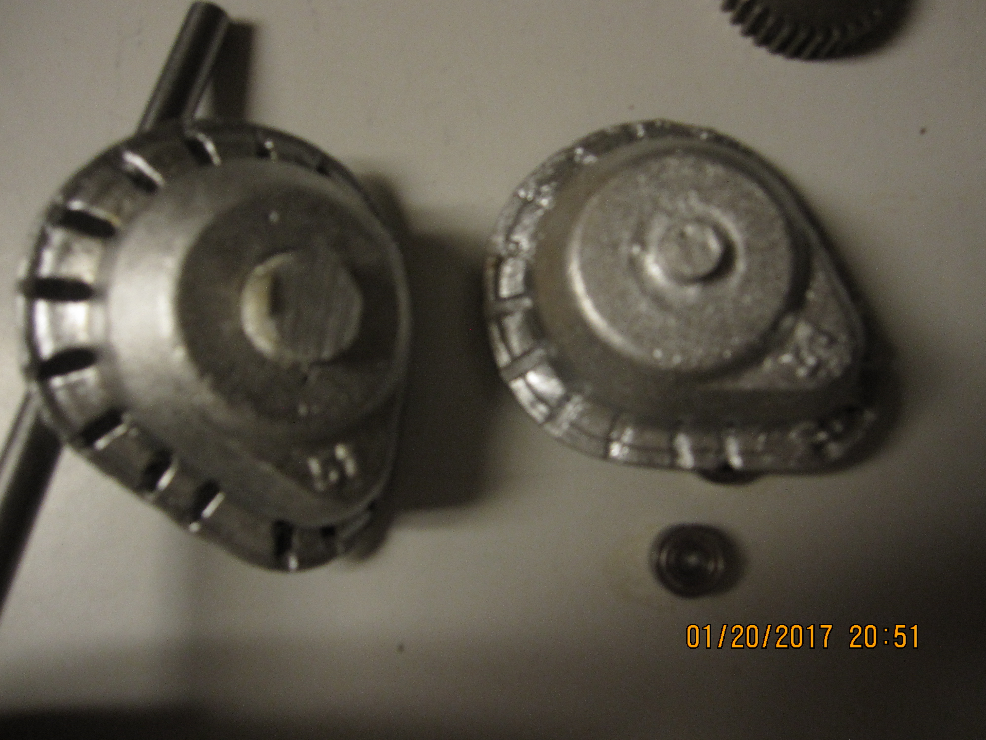

Tanque 01-19-2017 07:48 PM
5 Attachment(s)
....more....
http://www.rcuniverse.com/forum/atta...mentid=2197380http://www.rcuniverse.com/forum/atta...mentid=2197381http://www.rcuniverse.com/forum/atta...mentid=2197382

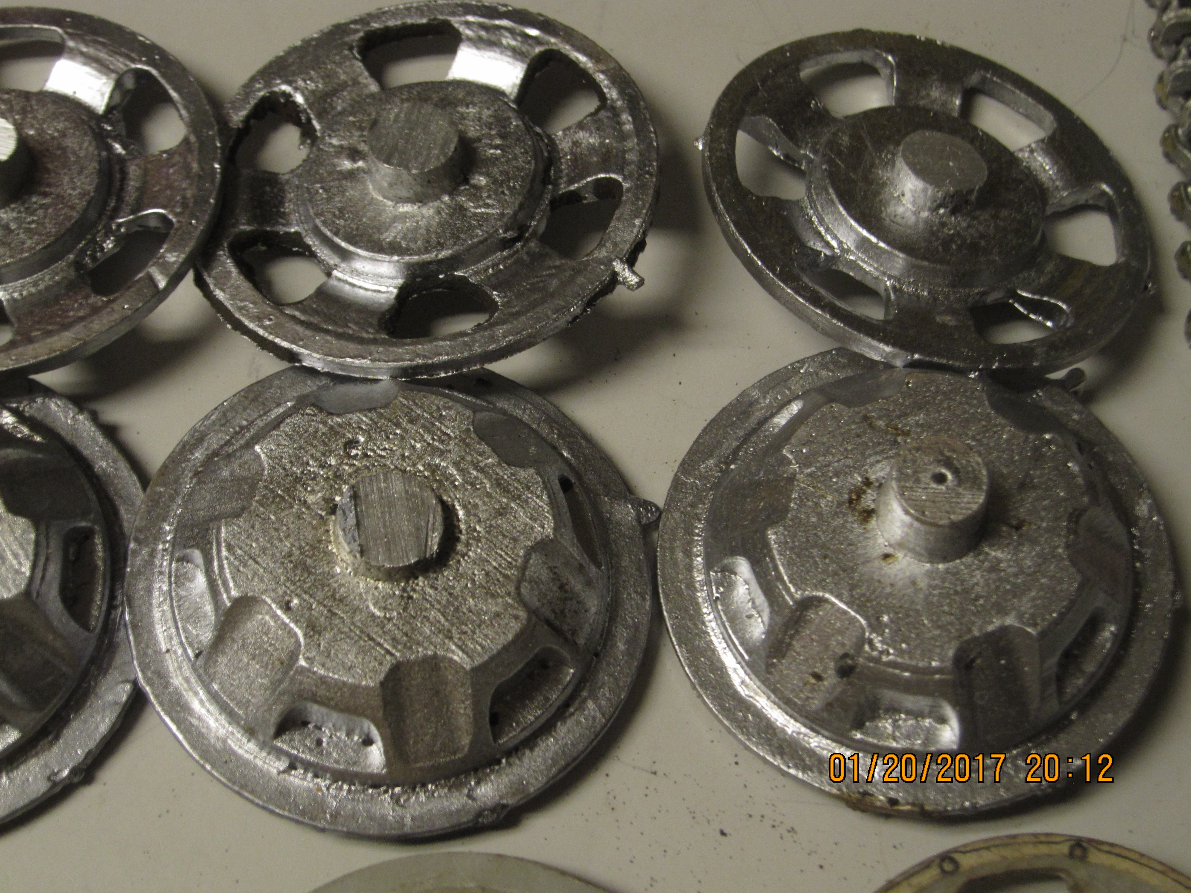

The first photo is of some pretty rough parts I used as experiments; rough but
sound parts. The flange as you see it on these is quite jagged. This is due to
me using this part before I had fixed on a larger sprue- metal just didn't flow into that thin area
before cooling. As you see from the later parts that was resolved. However... all I wanted
was a uniform pour- most of the flange will be removed as the original didn't have such a wide one
as you may see from the photos below.... jerry
http://www.rcuniverse.com/forum/atta...mentid=2197384
http://www.rcuniverse.com/forum/atta...mentid=2197383

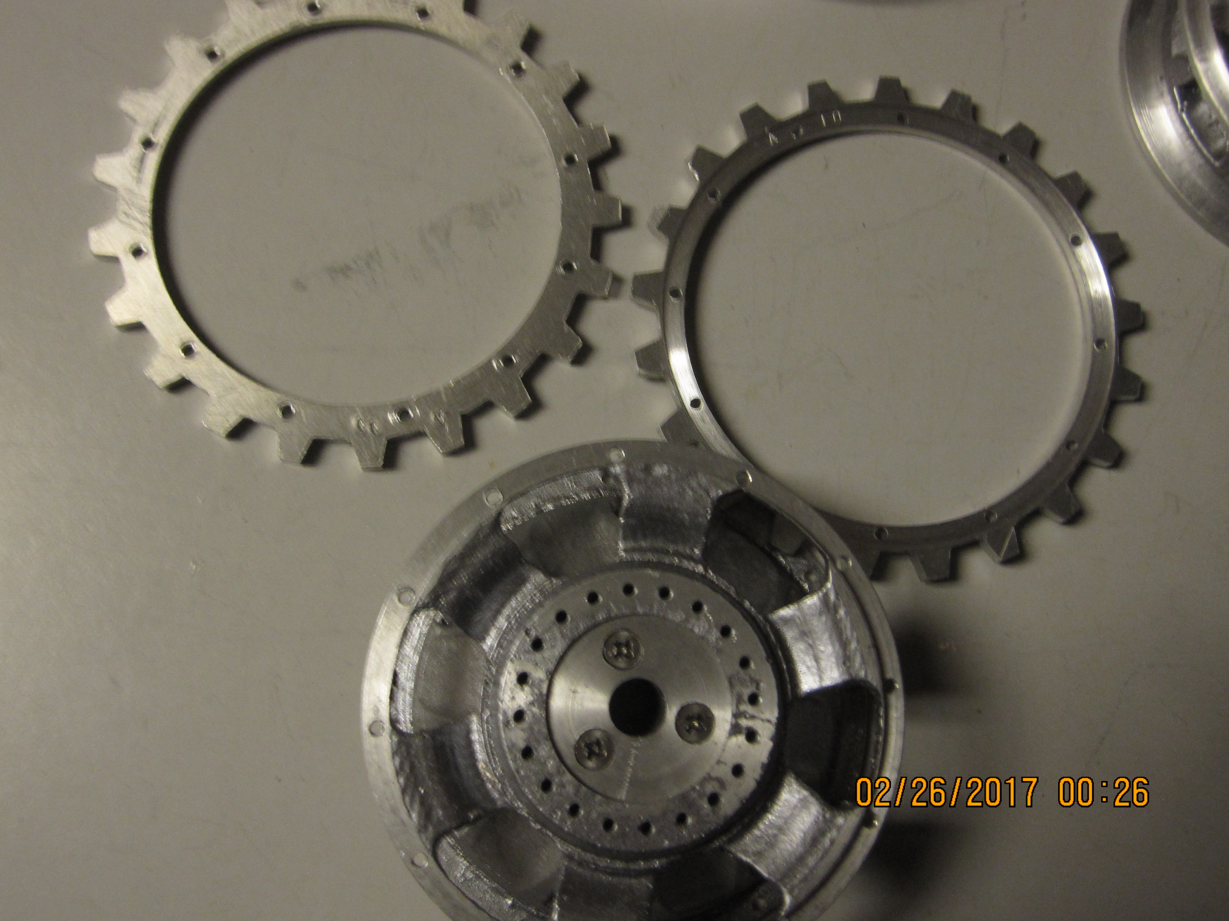

Tanque 02-26-2017 12:39 AM
3 Attachment(s)

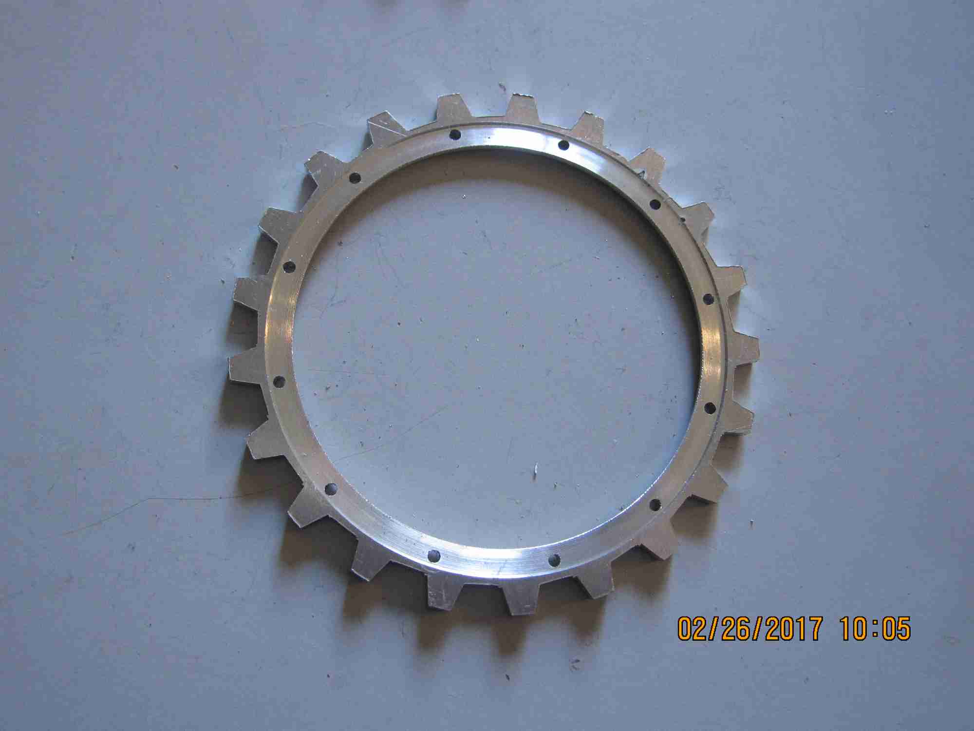

I've had a bit of time to apply to making my sprockets. In truth it is slow going. It's ticklish work and that's not restful. One twitch of a handle or too aggressive
on the cutting rate and much time is wasted. Unfortunately I found that when I cut the toothed disks, specifically the last group I was too aggressive when I
drilled the mounting holes around the circumference. In an attempt to trim some time and make the disks uniform in order to line up the teeth easier when mounting the resulting rings on the sprocket bodies I had drilled several disks at once.. Not the best idea. The small, #50 drill 'wandered' a bit and about half the disks have the holes too close to the outer edge. Can't really see it on casual inspection but it makes a number of disks quite useless from a functional standpoint so I'll likely use them as decorative items /spares on the models. I recall seeing a few photos of tanks that had spare sprocket rings in their stowage.
Also I purchased a number of steel sprocket disks from which to make rings from Martin at Geisswerk. I needed these to work with his tracks as they are
too tough on aluminium rings and happily they will engage properly with either the aluminium or bronze alloy track sets I'll be using. And they have the advatage of better wear and strength. Strength of my aluminium rings is a concern, they seem ok but they are quite thin by themselves.
BTW I was asked about what I'm going to do about the three non scale-like Phillips head screws in the middle of the sprockets. Either I will countersink them a bit further and seal / cover them with JB weld or similar or I will replace them with aluminium screw-rivets and make them disappear..
So the progress continues...
http://www.rcuniverse.com/forum/atta...mentid=2202870http://www.rcuniverse.com/forum/atta...mentid=2202871http://www.rcuniverse.com/forum/atta...mentid=2202872
Jerry
