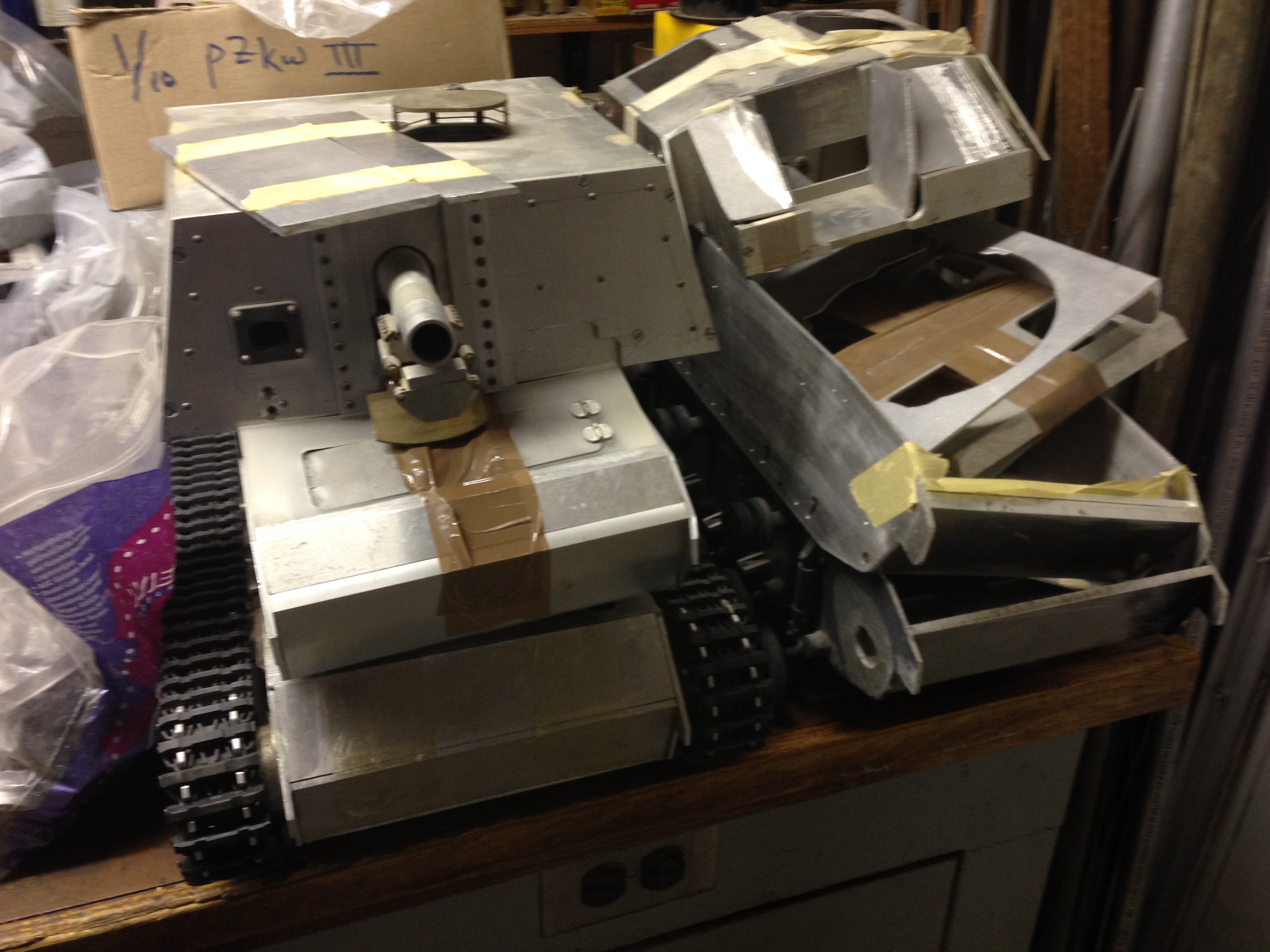

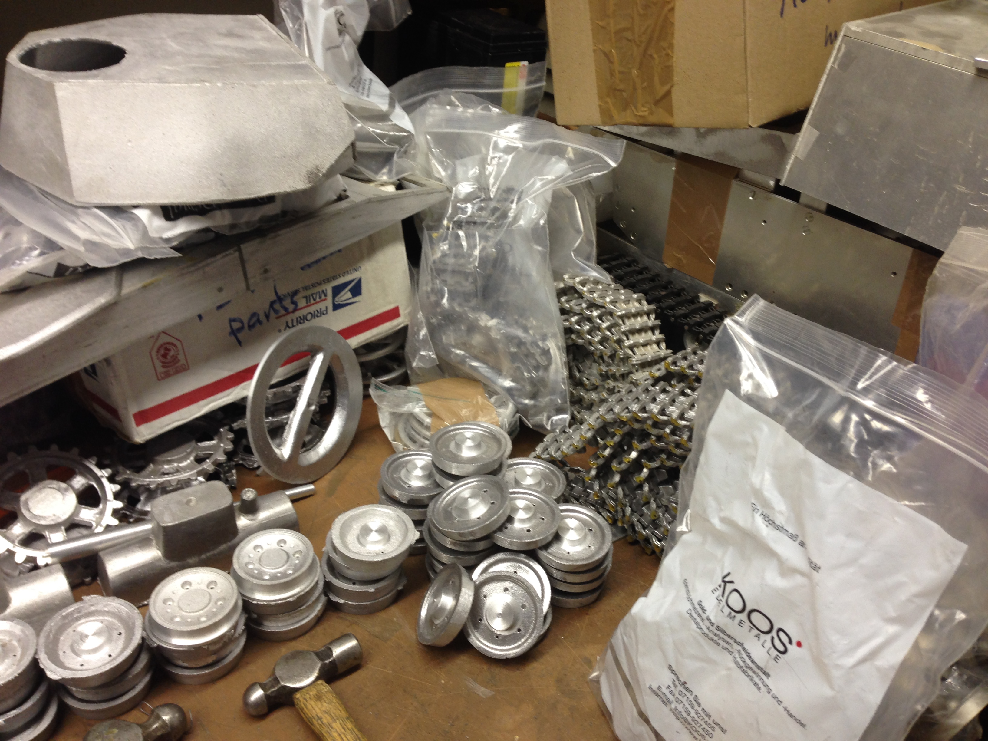

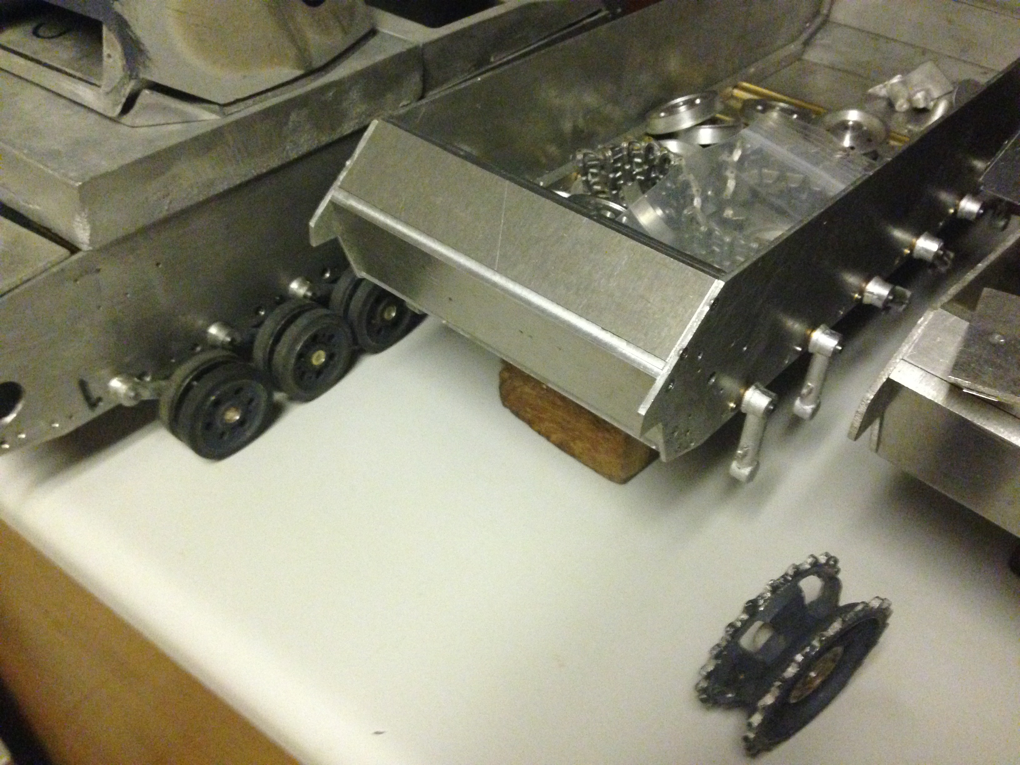

Definitely busy for a while.
There are 3 Pz Kw III variants in this pile.
There are many road wheel castings to turn, bearings to press in, tires to make, many, MANY track link castings to drill and pin, swing arms to machine, torsion bars to cut.
I've been collecting PzKw III parts for a while, that later StuG on the left was one I made probably 20 years ago, I even cast the tracks...The SIG 33 was started by a friend..
All of this stuff has been languishing far too long.... wish me luck.

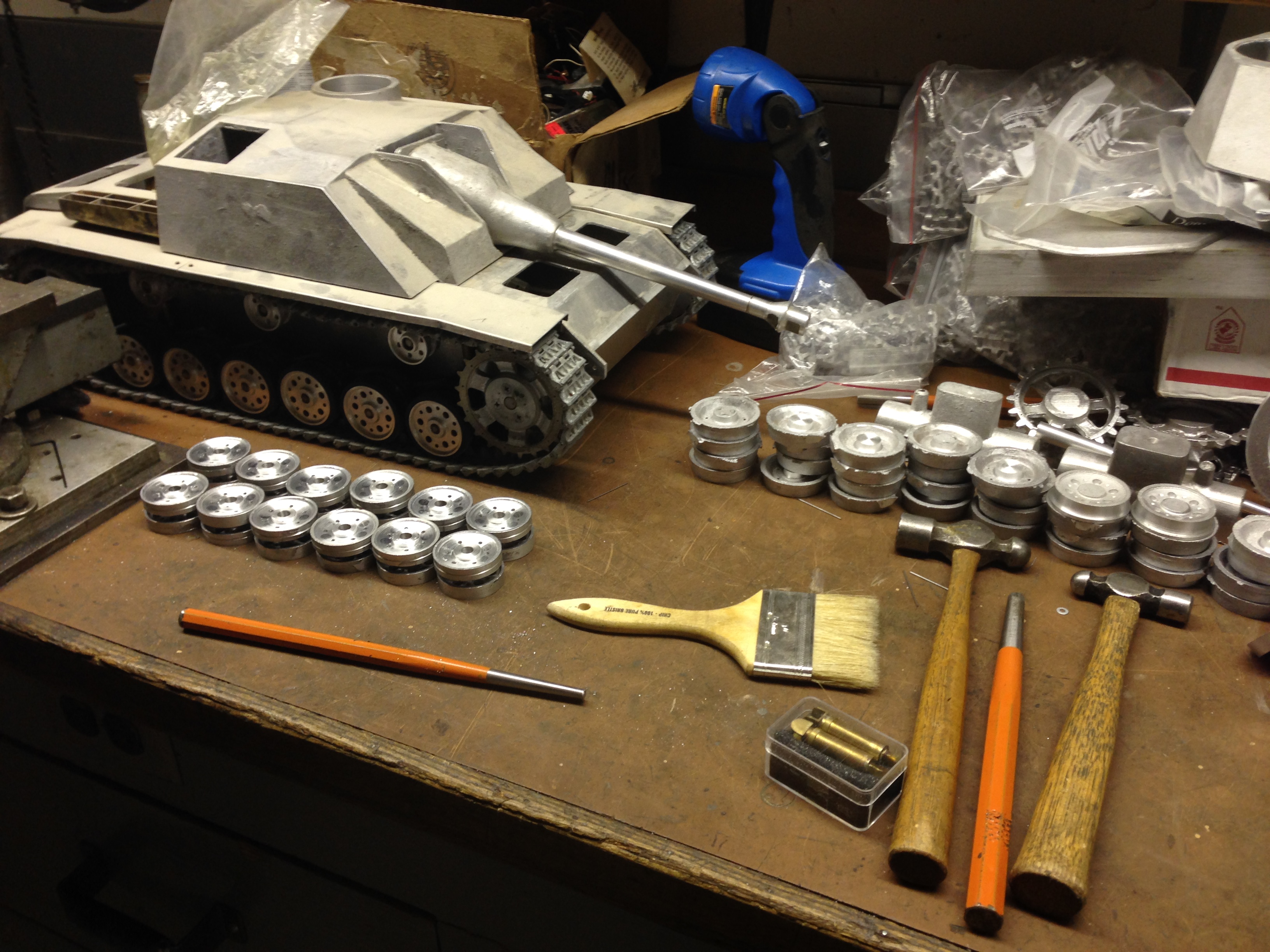

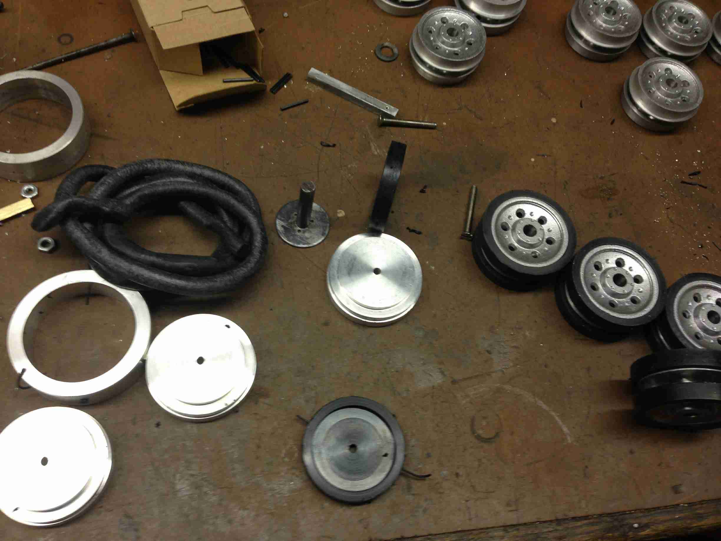

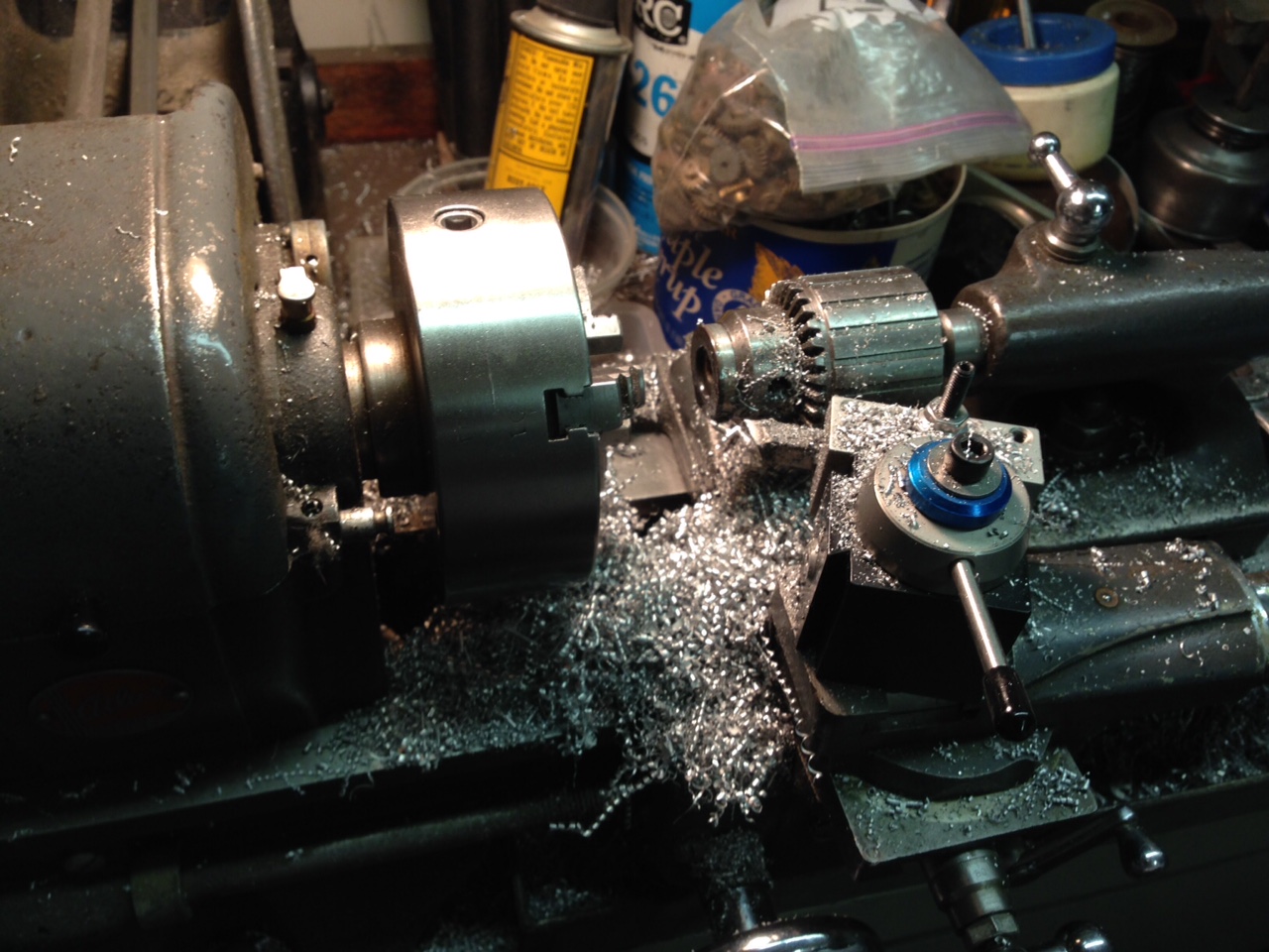

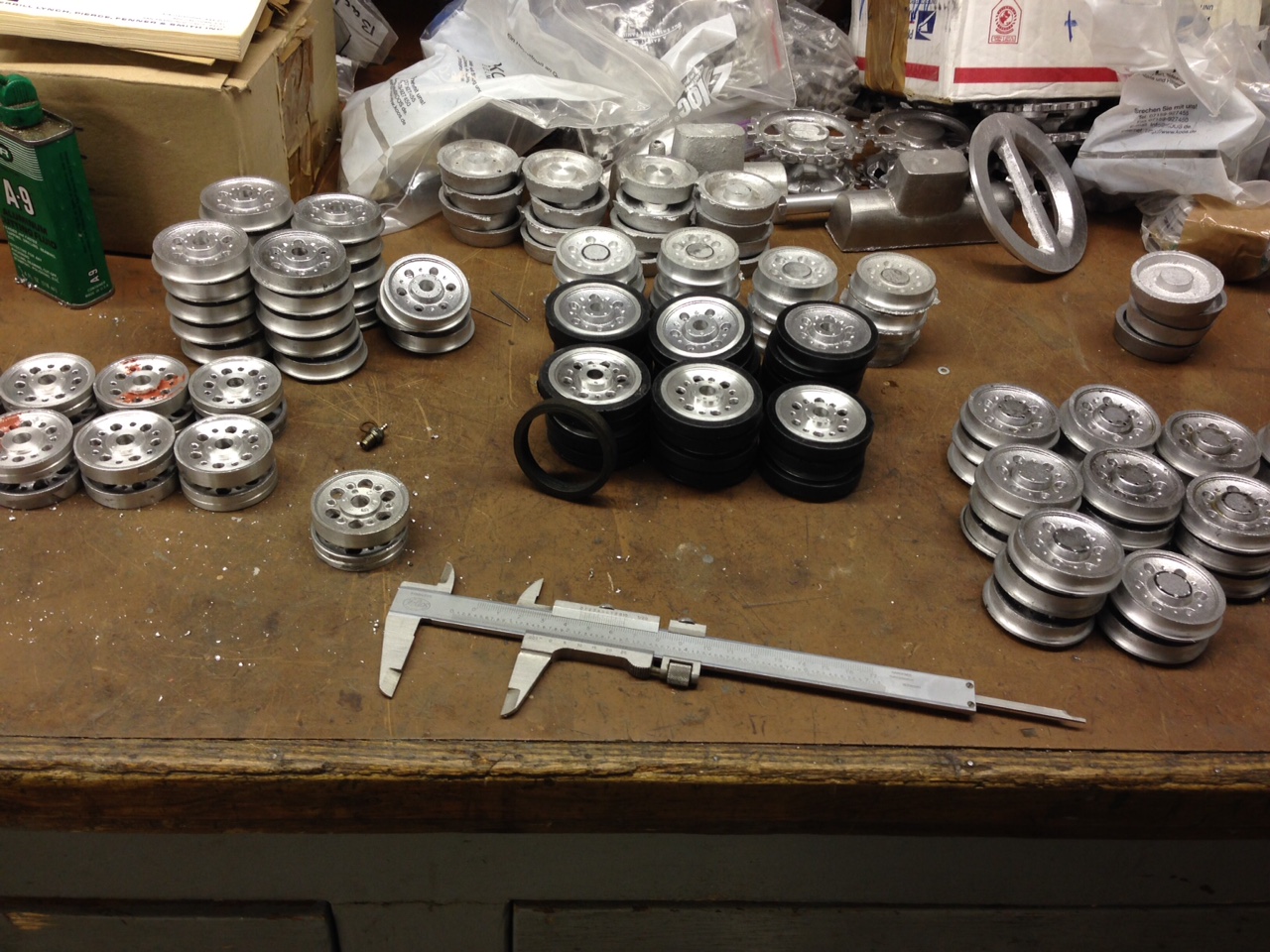

I've been busy off and on with machining wheels. I have about 112+ wheels to machine from several different sources including a set I cast
myself. I'm attempting to keep them as uniform as possible which isn't easy. I next plan to make the tire forms, I just ordered a new supply of
heat vulcanizing rubber as my last lot met an unfortunate fate last year.
My little Atlas 6" late and it's precise 3 jaw chuck are perfect for this sort of work..it was my late dad's and he bought it new right after WWII
when civilian sales of tools began again. I remember when I used to sneak into his shop when they were out as a kid to teach myself how to use it.
Much later when my dad purchased a larger machine he gave me the Atlas.
Jerry

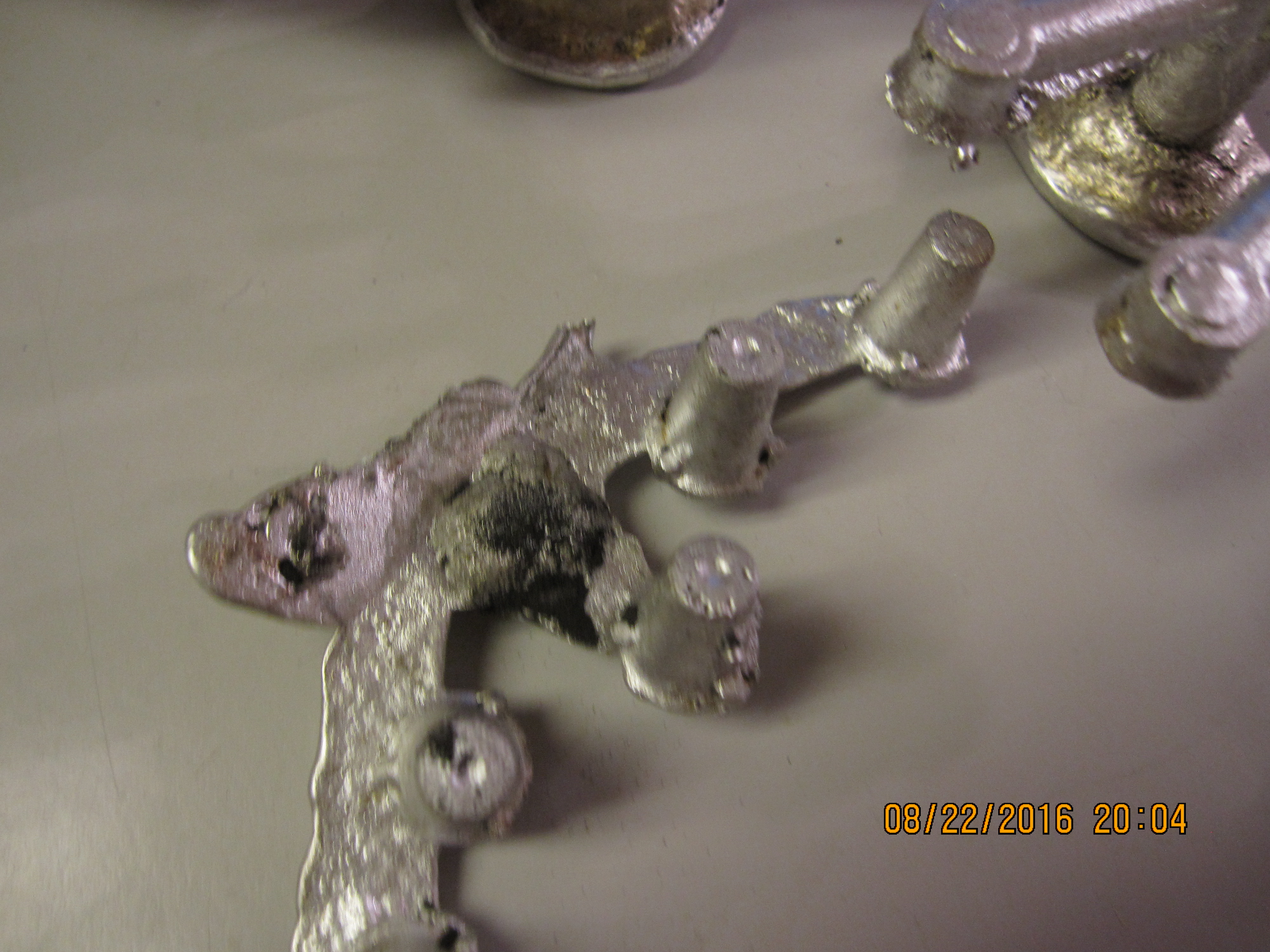

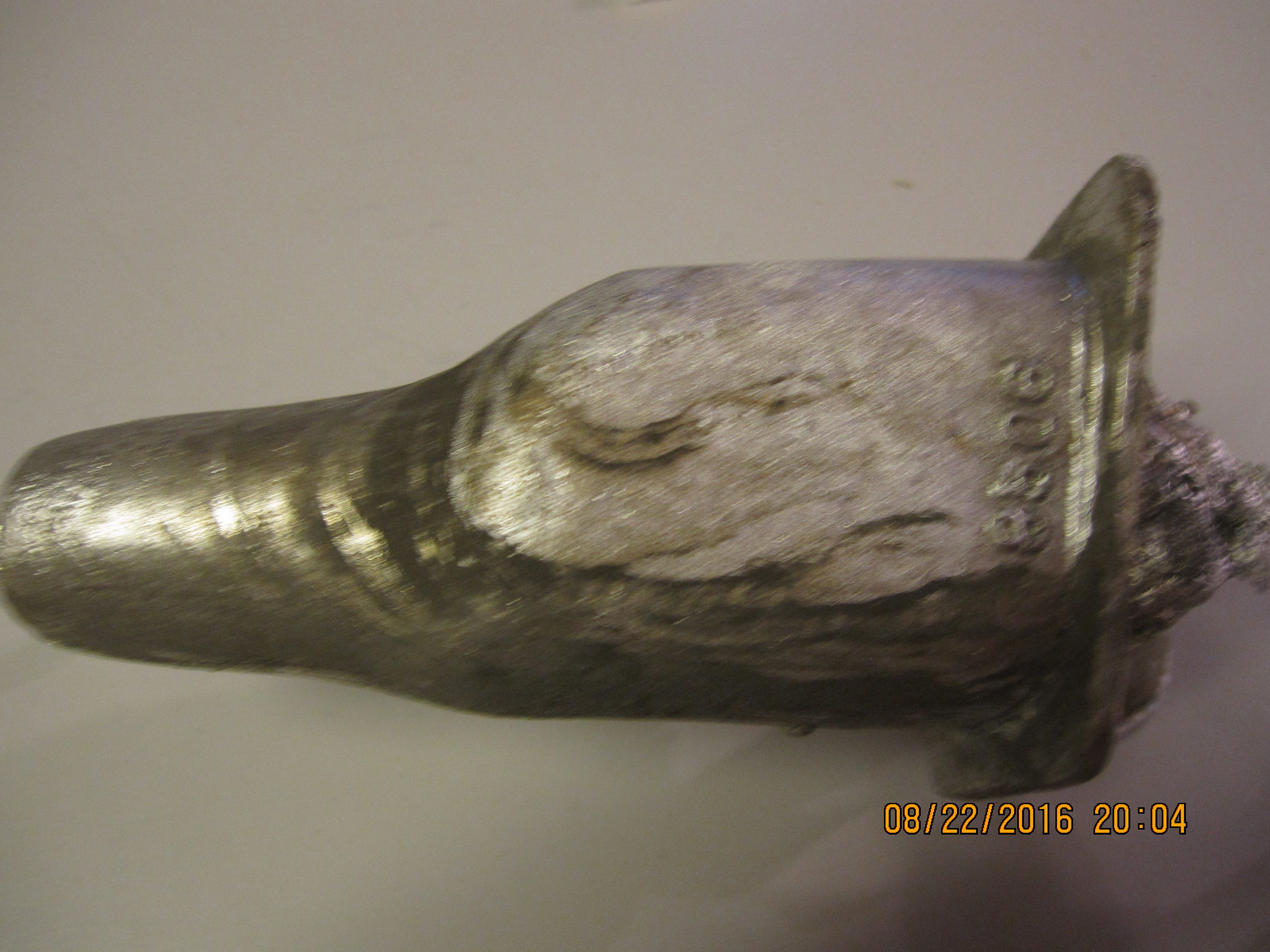

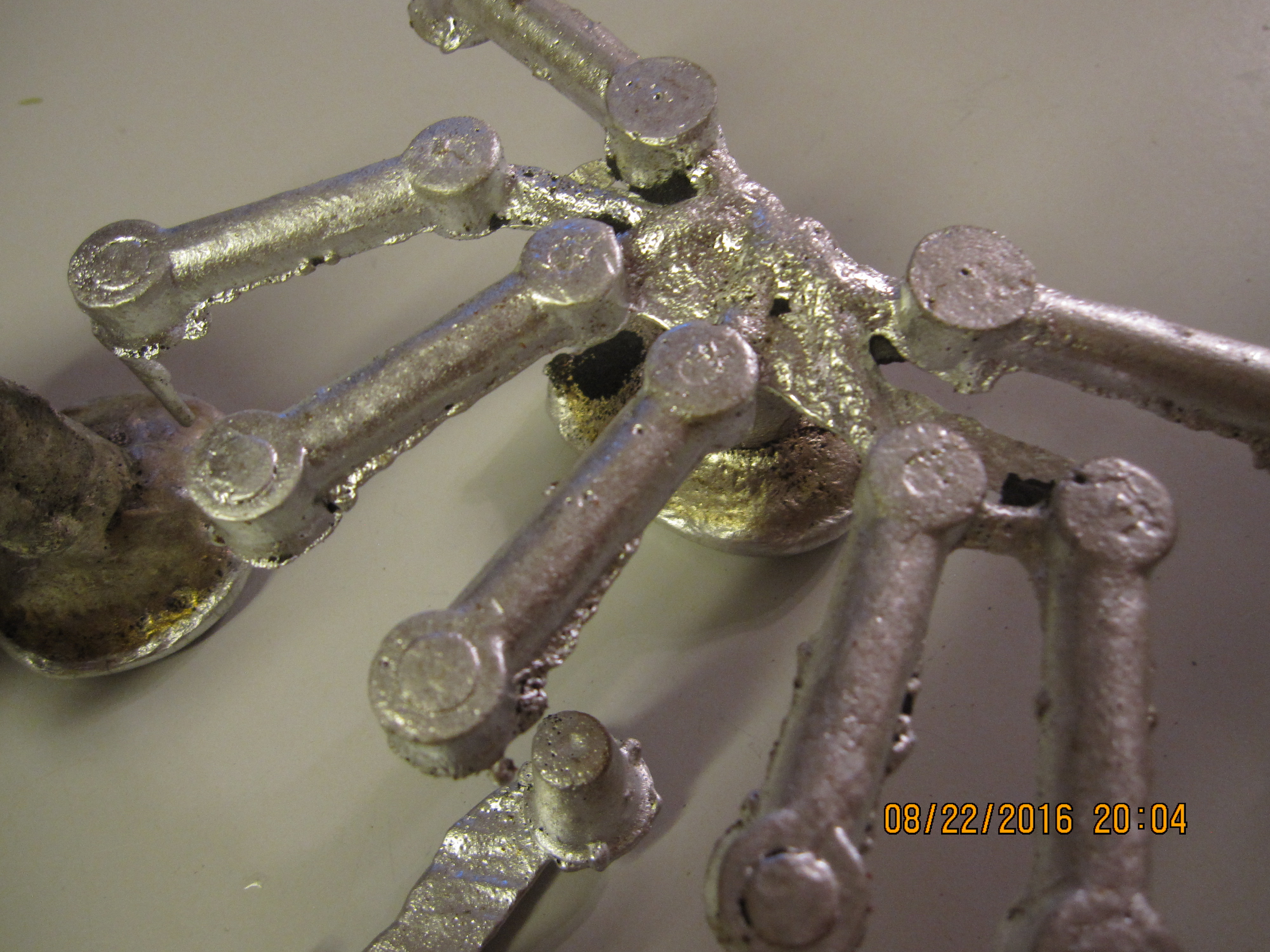

Had the chance to cast some parts I need for these project tanks.
  • Saukopf mantlet
  • a few swing arms
  • a few return roller standoffs
Excuse the dirtiness of the parts, I'd just pulled them from the sand. The
mantlet in the last photo was poured very hot hence the streaking and rougher than normal( but not objectionable)
surface; and I just realized the photo is way blurry which is not helping
Jerry

All the tank parts( or 95% of them) I cast are in aluminum. The aluminum track castings I have I did not cast; these were made for Thomas Wittgrebe in Germany. Casting tracks and drilling them is one of the most mind numbing, boring things one can do in building a tank. I cast a set in zamack for my StuG III many years ago, 25+ to be exact and I'll never do it again..
As it is I have probably 400 pz 3 castings to drill... I'd pay real money to have someone else do it...It is a winter function when I absolutely positively have nothing else better to do.

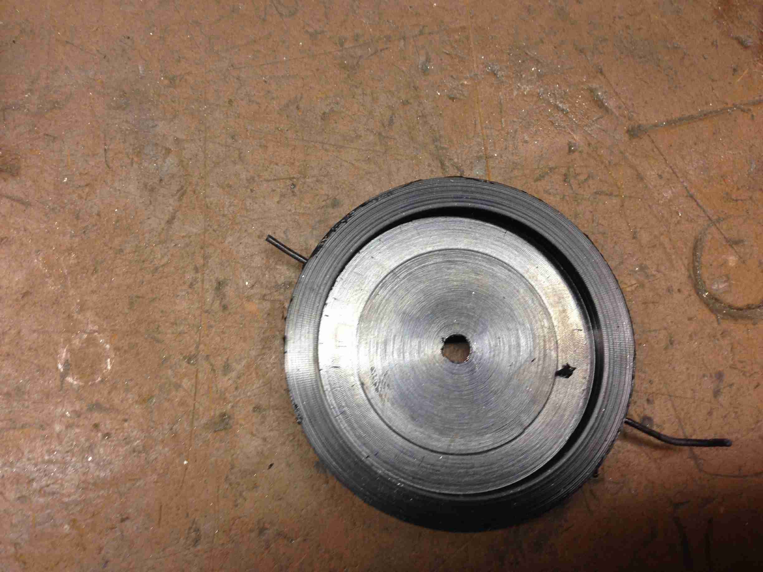

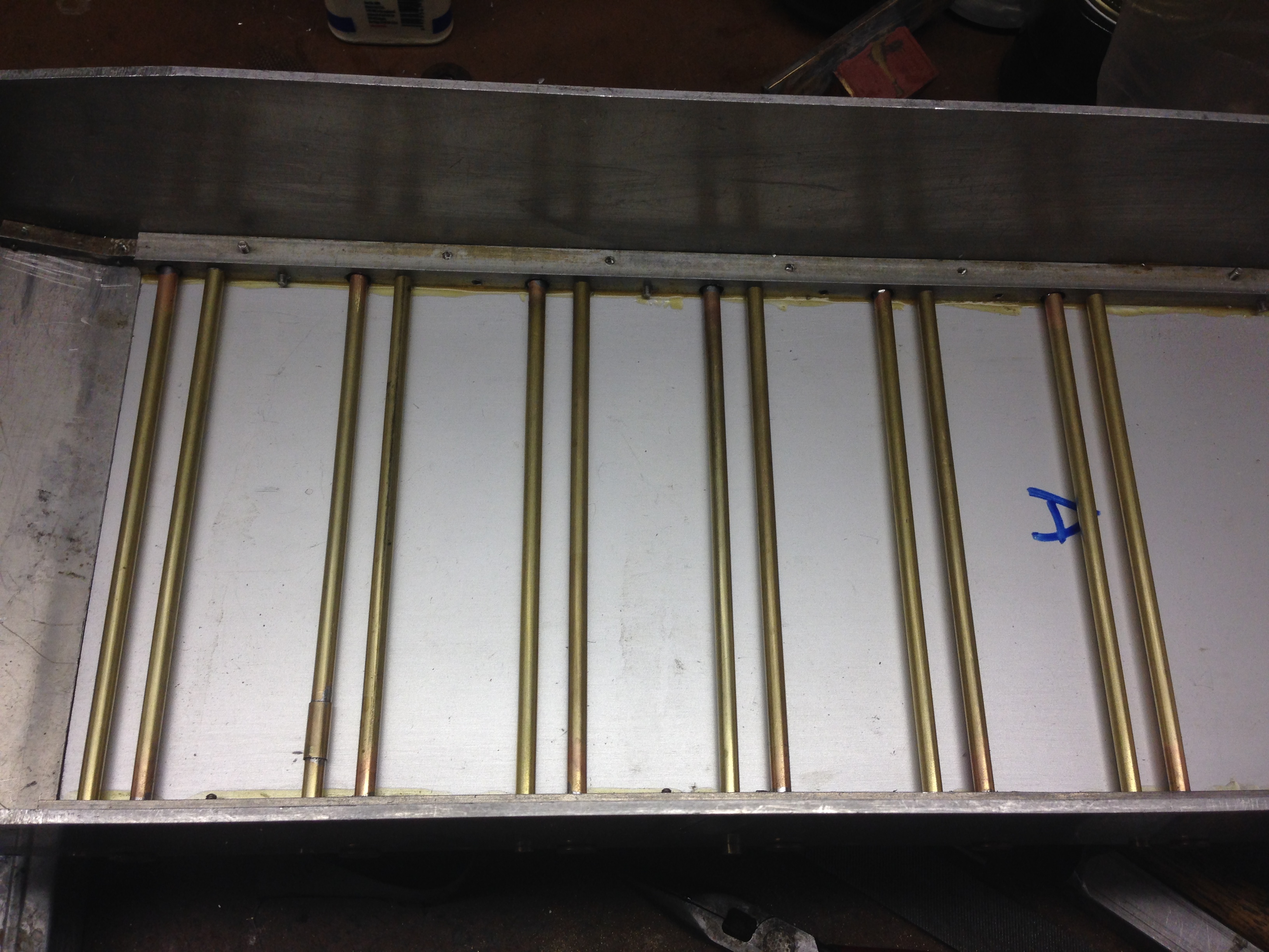

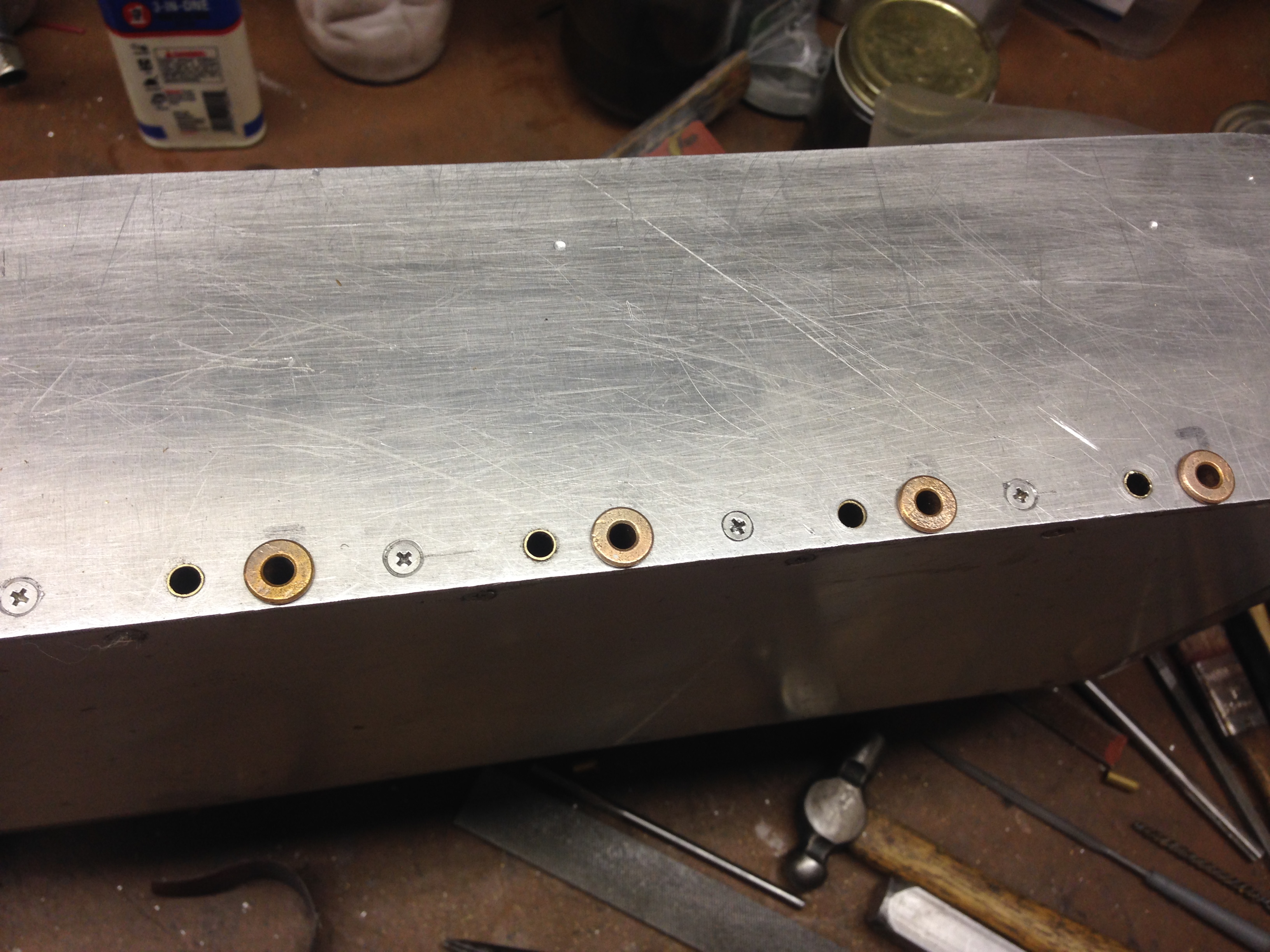

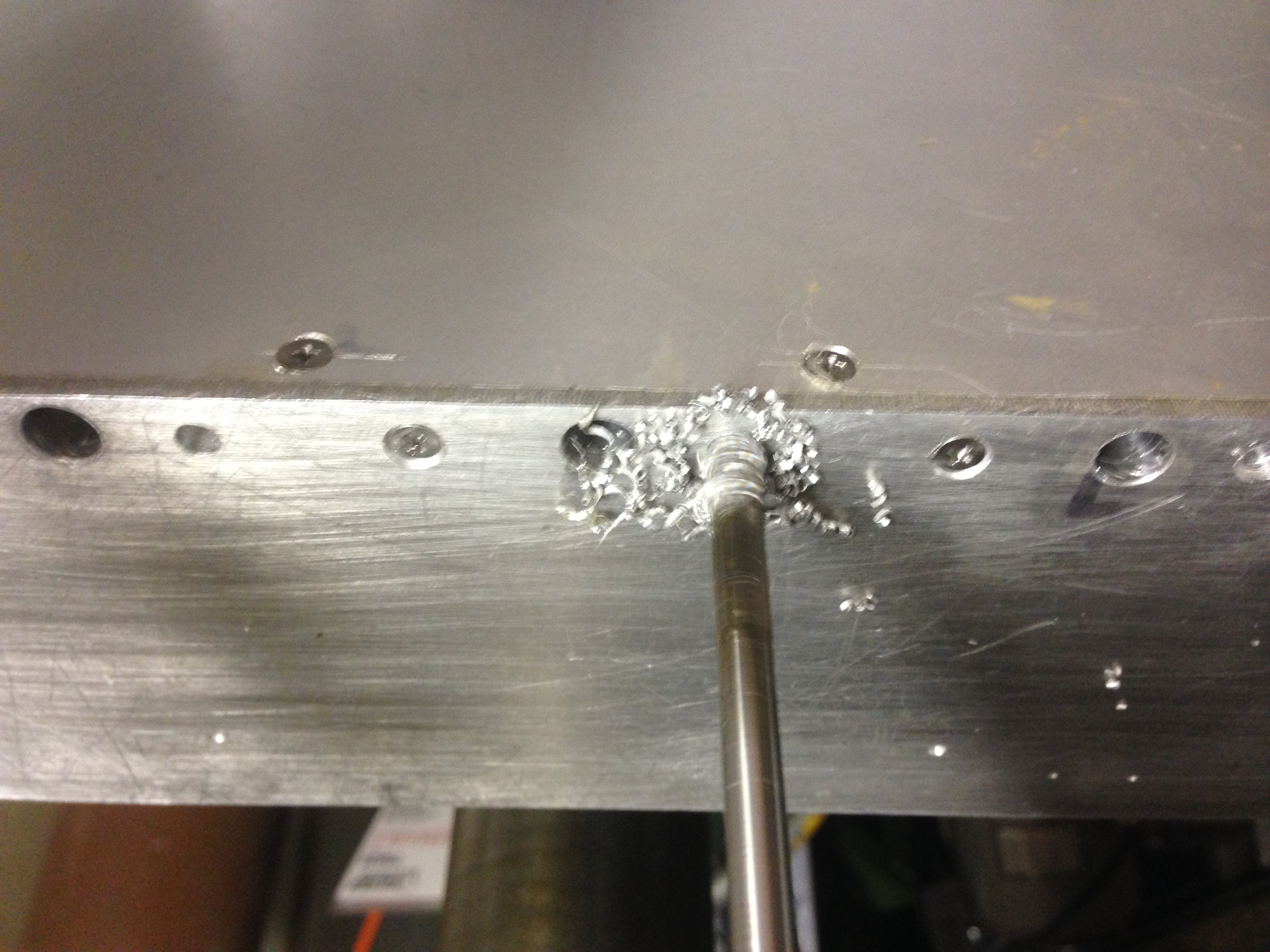

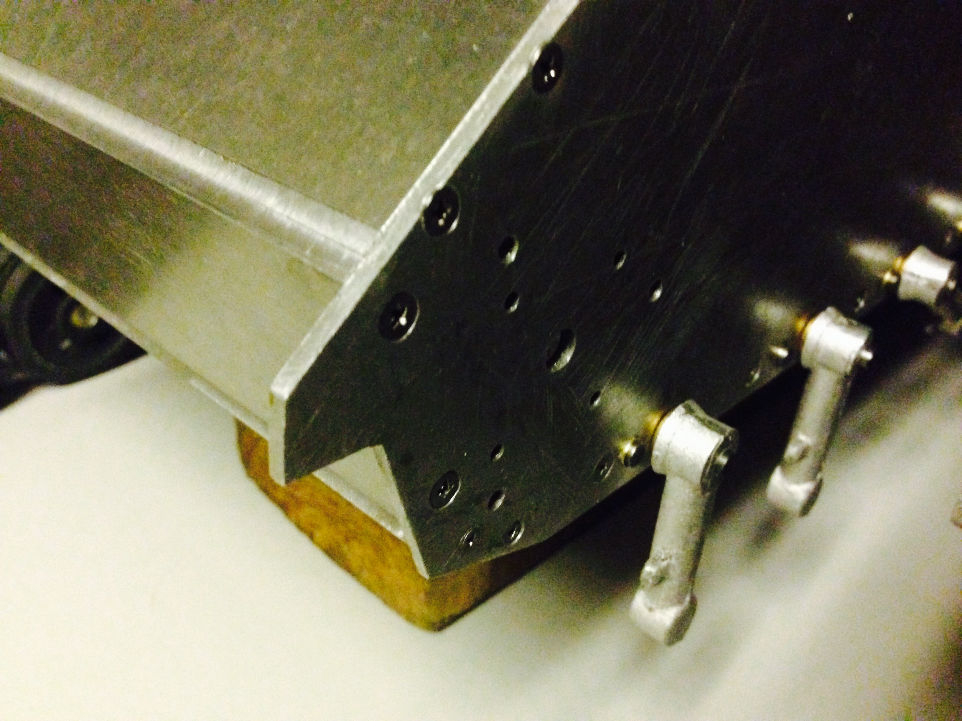

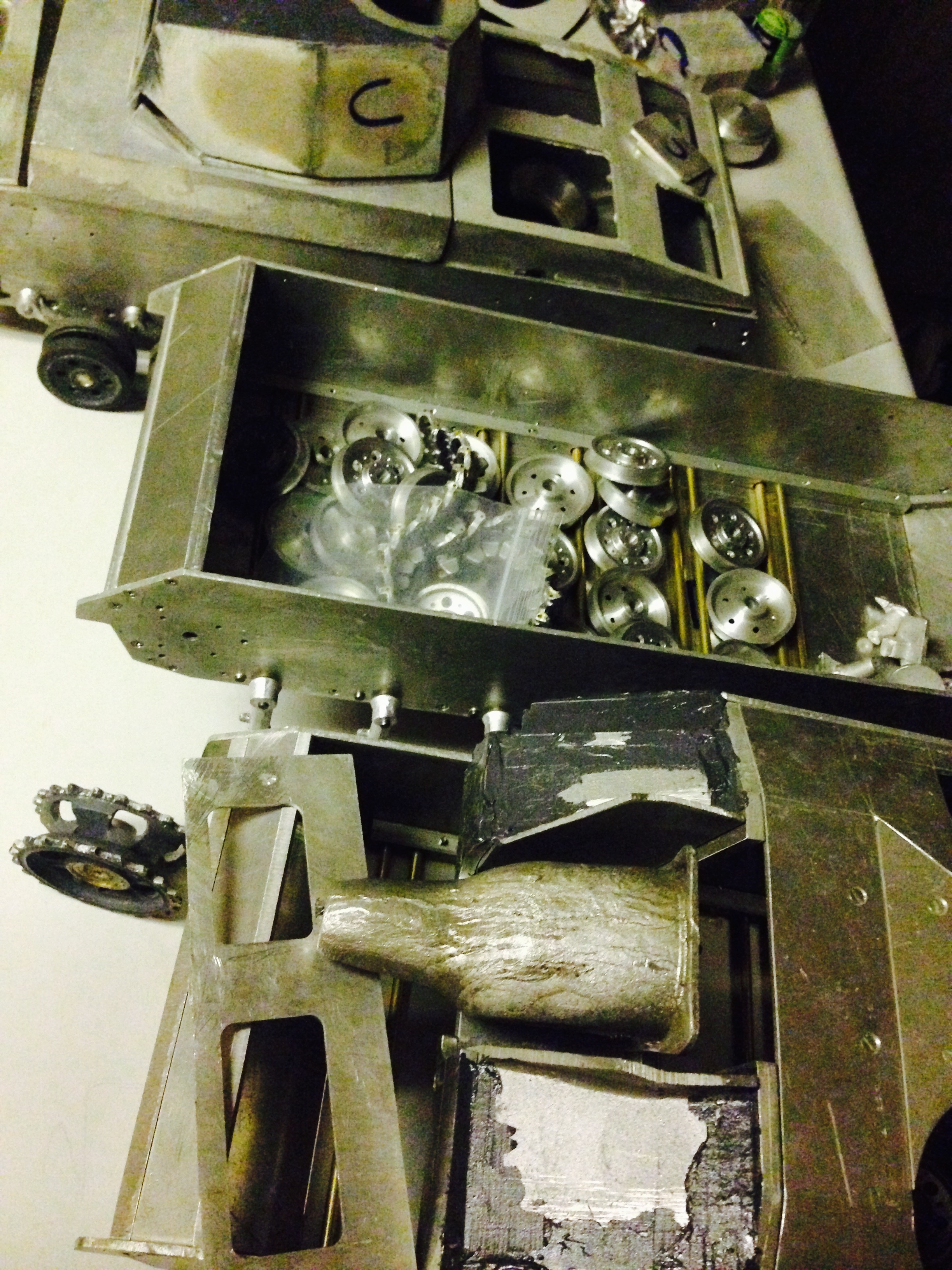

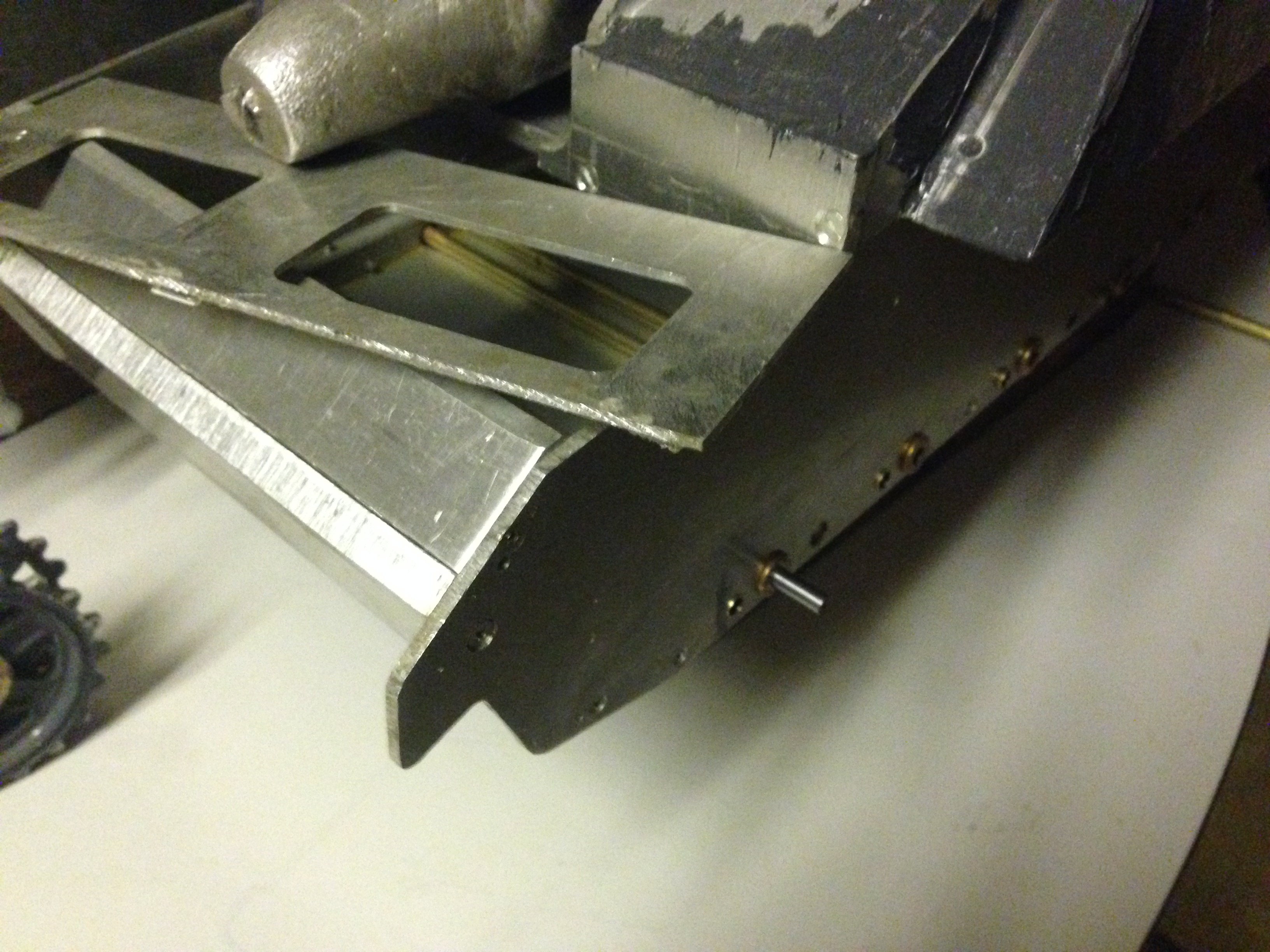

Having installed all 48 torsion bar tubes, torsion bars with their anchor points as well as most all the work on 48 swing arms I've begun assembling the rest of the wheels(96 halves to make 48 complete wheel pairs) and making tires. I had planned to make 4 tire molds but only made two. I'm rather glad I did as their performance is rather inconsistent; one produces great tires seemingly every time, the second not so much. I think I'll make a third using a different approach to see how it goes, I'd also found a company willing to engrave names/ tire size designations but again glad I didn't pursue that yet, however I still may.
Below you can see some of the progress.
Jerry
