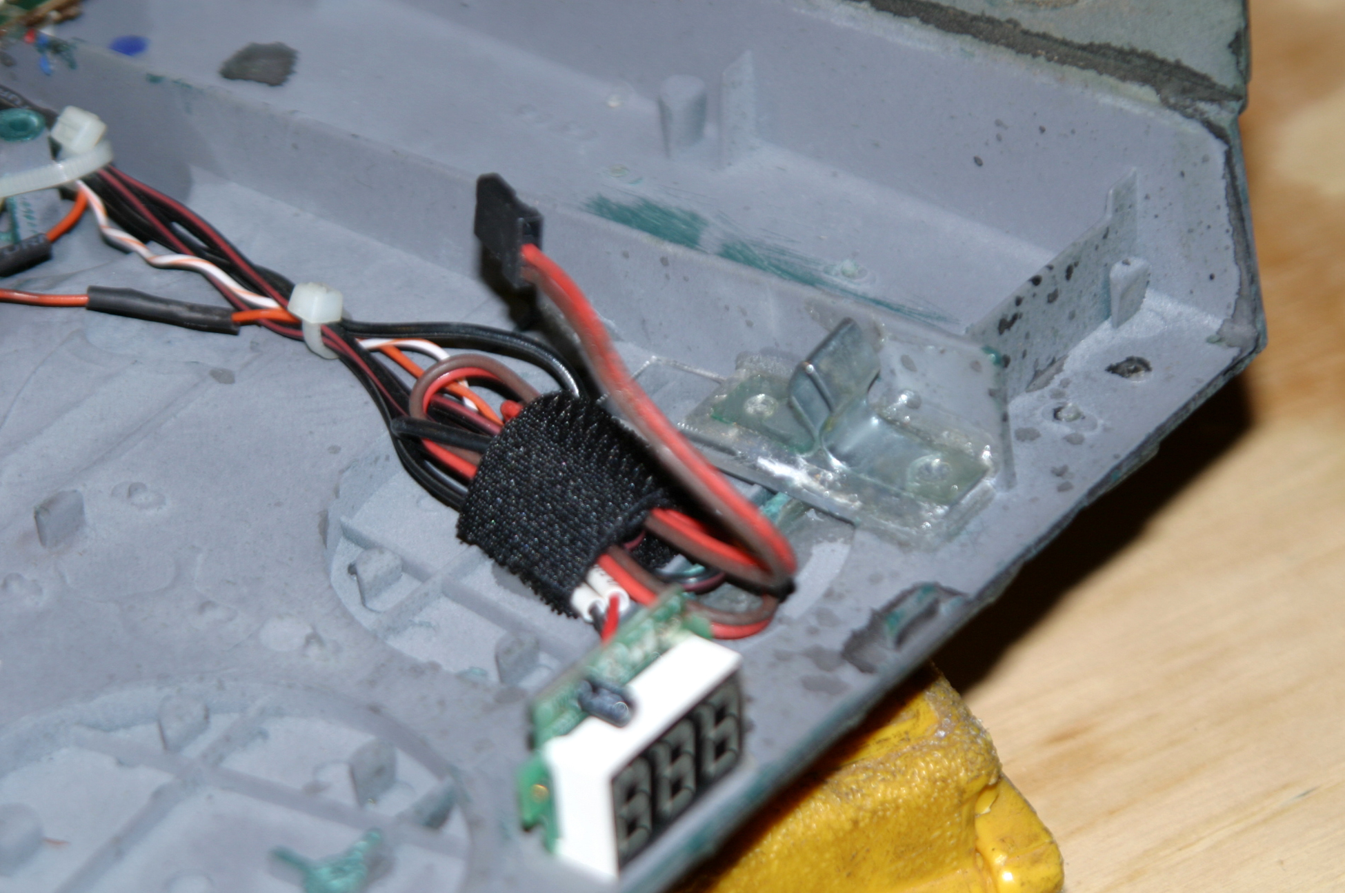

Hi Everyone,
I"m new to this site and to be honest, I'm fairly new to RC Tanks as well. I'm more interested in WW-II US Army Armor, but this Leo caught my eye on E-bay. I won it from TheGreatestMoo and as you will see, it's in need of a lot of work. First off I'll be repairing the gun mount and then I'll move on to the wiring. I'm going to get it running again and I may keep it or re-sell it. I'm not sure, so take a look and let me know what you think.

You bet he did!!! Ryan added the torsion bar suspension, metal tracks, metal GB's, 3DP gun mount with recoil, Clark Board and miles and miles of wires. Quite a bit of the wiring is lighting. I just have to sort out a few unattached wires and figure out where everything plugs in.
I've read about Clark Boards, but this is the first for me. What I don't like is there are no mounting holes. I'll have to figure out how to mount it so it doesn't get loose and short something out. Ryan's a great guy and all I have to do is ask him a few questions and it should go back together. I wish he drew up a wiring schematic to make things easier, but he didn't. Of course he knew where things had to go when he put it together.

mcm308 10-14-2015 03:52 AM
Familiar with styrene? Make a plate with blocks to screw the boards to like I did. That is Clarks GBS unit. If this is your first, I recommend getting the remote and an IR receiver to program it. Read Clarks instructions on his site very thoroughly and over again. And over again...lol It takes takes time and patience to get it set up and operating smooth. What TX are you using?

Rebel 1 10-15-2015 01:56 PM
A Question?
1 Attachment(s)
I did a bad job dumping it the first batch of photos here. Does anyone know what this little board is for? Its mounted in the turret, but all the wires go back through the slip-ring. I haven't traced the wires back yet, but they must hook up to the Clark Board. I just don't know what its for. Someday, I hope to buy a new un-built un-molested tank. For now, the fixer uppers are great to learn on!!!LOL
http://www.rcuniverse.com/forum/atta...mentid=2125505
Thank in advance for your help.
Roger
mcm308 10-15-2015 02:21 PM
Roger
That is the GBS unit that plugs into the main board.
http://i74.photobucket.com/albums/i2...psdj5fjsgi.jpg
Rebel 1 10-15-2015 02:25 PM
Great photo mcm308!!! That's another reason to set my turret up as you have done!!!
mcm308 10-15-2015 02:29 PM
If you compare to my previous photo, you will see the final postions slightly different. Refer to the prior photo. That is the volume pot for the Clark board at the back.
mcm308 10-15-2015 02:34 PM
So that being settled, the same amount of wires should be coming out the bottom of the slip ring with a small plastic female connector.
