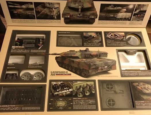

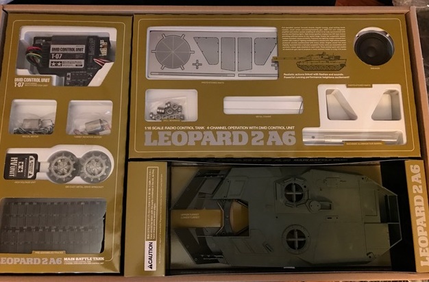

Hi Guys,
Last week I received my Tamiya Leopard and I almost ready to begin the build. Before this I have only owned 2 heng long tanks. I dont have experience with building Tamiya tanks so I figured a thread may be able to help. Ive been searching online for the last week trying to piece together what Im going to do.
At the moment I have the Futaba 4yF transmitter and receiver as well as the acrylics that Im going to use as described in the manual. Unfortunately my set was brand new and is missing the manual and paint design reference as well as the tow cables, decals and whatever else is in that plastic portfolio. I looked to the hobby shop and Tamiya to provide a replacement and hopefully I will get it soon.
Im still trying to decide on an air brush set. After all i've read I still cant decide. I dont want to spend a few hundred dollars on a set for this. I was thinking about getting an Iwata neo CN and Neo compressor or just a Master Airbrush set off amazon. I just want something that gets the job done and has a decent enough gravity dual action sprayer. Any thoughts on this before I buy would be appreciated.
Also I havent decided on a battery. Can someone recommend a great quality battery brand I have no idea. Ive had an rc copter go up in flames before. Im looking for one thats 3000-5000mAh.
Id like to use this thread for tips and questions I have thanks.

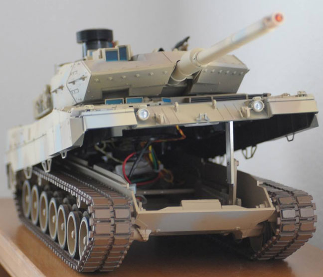

I bought one used ( well, built and shelfed ) last year. And I took it apart to have a look ,and to install a better track tensioner. I got one from Henntec for the tamiya Leo, so you can adjust it from the outside.
Trust me, once closed up , it takes a while to get down into the belly of it again .
http://imagizer.imageshack.us/v2/800...661/Djp0Eq.jpg
I also invested in a better AB gear to last year, after going the cheaper rute first. That compressor lasted 3 Month before it became so noisy , I could not take it anymore .
I went with a sparmax (TC 610H) Compressor and 2 AB's 0,3 and 0,4 mm . Superhappy with that brand . I spent a little more than calculated , but for laying down paint on 1/16 scale It's nice to have a compressor with a 2,5L tank . So it's not running all the time .
When coming to battery, it's really tight in the turret, even after you spent a weekend on the wire layout, hehe. with a heavy nimh ore nicd , the back of turret can sag a little, so I went to my LHS and got 2 lipos , the smalest in footprint in 2s , with the most mah in them ( sadly not more than 2250) and a small lipo alarm. so yes , not the longest drive time with those, but no problem fitting it in the turret , and no sagin.

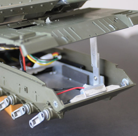

Pcomm1.v2 11-30-2016 05:09 PM
2 Attachment(s)
http://www.rcuniverse.com/forum/atta...mentid=2191841

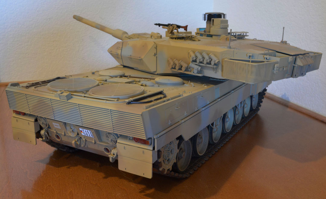

Sollie is correct:
Sorting the interior turret wiring is a task and a half and the heavy tank NiMH Battery once placed in the Leo turret will either warp the turret over time and or cause it to immediately sag to the rear, causing the turret to drag or get hung up on the rear deck.
I like the battery placed in the hull solution, that was the main take away tip from the various rc tank forums, a few years back that I received, before my Leo 2 build. Daryl Turner did this custom one off modification to my Leo 2, unique at the time and above my modeling design and fabrication skill level. It works great for easy battery swaps. You can look at your build instructions and figure out your own direct solution to achieve similar results, if that modification is important to you.
NiMH Battery Recommend:
The DuraTrax 7.2V Onyx 4200mAh NiMH Battery DTXC2061 works for me, "lipos" are not a very good or safe idea in my hands :p

TheBennyB 11-30-2016 08:54 PM
In my experience the only thing that really needs addressing is the weak plastic suspension arms. Not a must, but much easier to do in the initial build rather than go back, budget permitting.
http://mitosal.com/Leopard2A6.html

TheBennyB 12-01-2016 05:09 AM
I just used a smaller 2S Lipo, fits nicely and don't have to mess with anything in the turret. Still get 30-40 min of run time.
Pcomm1.v2 12-01-2016 06:39 AM
Good luck with that. Show us with photos Bennie and your Leo 2 solution remains a big risk in an expensive model..."had an rc copter go up in flames before", so your no help to the first poster, if that poster was using a lipo, probably was, just my hunch.
Plus, your solution adds weight to the weak turret floor, which will damage wrap it, a primary known Leo issue.
Anyway, do share with photos when your Leo eventually burns down...
