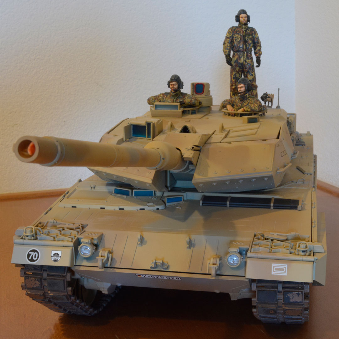

Sollie is correct:
Sorting the interior turret wiring is a task and a half and the heavy tank NiMH Battery once placed in the Leo turret will either warp the turret over time and or cause it to immediately sag to the rear, causing the turret to drag or get hung up on the rear deck.
I like the battery placed in the hull solution, that was the main take away tip from the various rc tank forums, a few years back that I received, before my Leo 2 build. Daryl Turner did this custom one off modification to my Leo 2, unique at the time and above my modeling design and fabrication skill level. It works great for easy battery swaps. You can look at your build instructions and figure out your own direct solution to achieve similar results, if that modification is important to you.
NiMH Battery Recommend:
The DuraTrax 7.2V Onyx 4200mAh NiMH Battery DTXC2061 works for me, "lipos" are not a very good or safe idea in my hands
http://www.ebay.com/itm/NEW-Duratrax-Onyx-NiMH-6-Cell-7-2V-4200mAh-Stick-Battery-Pack-Standard-Plug-DTXC-/322271694700?hash=item4b08e3cf6c:g:A54AAOSw8w1X5nk j
Important Tips; Tamiya Leopard 2A6 RC Radio Selection.
A. Futaba 4YF-2.4 Channel Radio System, not that great with the Leo 2.
If you are NOT installing a Tamiya Battle Unit, using the Tamiya Main Gun Stabilization Unit or accessing the complex stick controlled lighting features on the Leo, a Futaba 4YF-2.4 will still work for basic driving and shooting and work poorly for everything else. The Futaba 4YF 2.4 does need "one" self centering stick upgrade kit. Get the needed Futaba 2.4 stick parts here by calling and placing your order:
ID:	2191841   Click image for larger version
Name:	3 Crew_Desert-Leo.jpg

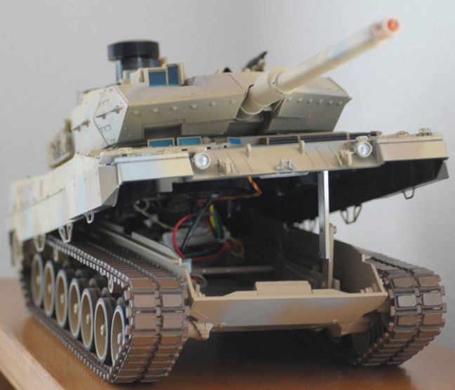

Hi,
Probably not a valid build solution, if you just upgrade the suspension arms and not the address the other more demanding turret issues. Why?
The Tamiya Leopard 2A6 1/16 rc model history is that it was first commissioned to Tamiya as a corporate presentation model project for Krauss-Maffei and others, then brought to market by Tamiya as a consumer kit. While a flagship Tamiya model, it was not initially purpose designed as an IR outdoor fighter, so in that regard the Leo 2 kit falls well short of the durability performance of the Tamiya WWII rc tank kits. If one actually builds and runs the Tamiya Leo 2 as an infrared fighting model or even as an occasionally used shelf queen runner, you will soon discover just how important it is to address the tank battery location; due to the structural damage that can be done to the plastic turret by the heavy tank battery resting inside. Next turret issue; just how easy it is to upset and damage the turret wiring doing battery swap outs and moving the battery to the hull means you to not need to open up the turret anymore, and that is a good thing.
Anyway, I did use the Impact – Mitosal metal suspension arms, because my build goal was to take the model to the next level past presentation model status and turn it into a very cool tough backyard IR runner, hence the various design improvements to help reach that objective.
The model is going on 6 years old now and has held up brilliantly thanks to the application of Daryl Turner's vision, engineering design and fabrication modeling skills.
ID:	2191861   Click image for larger version

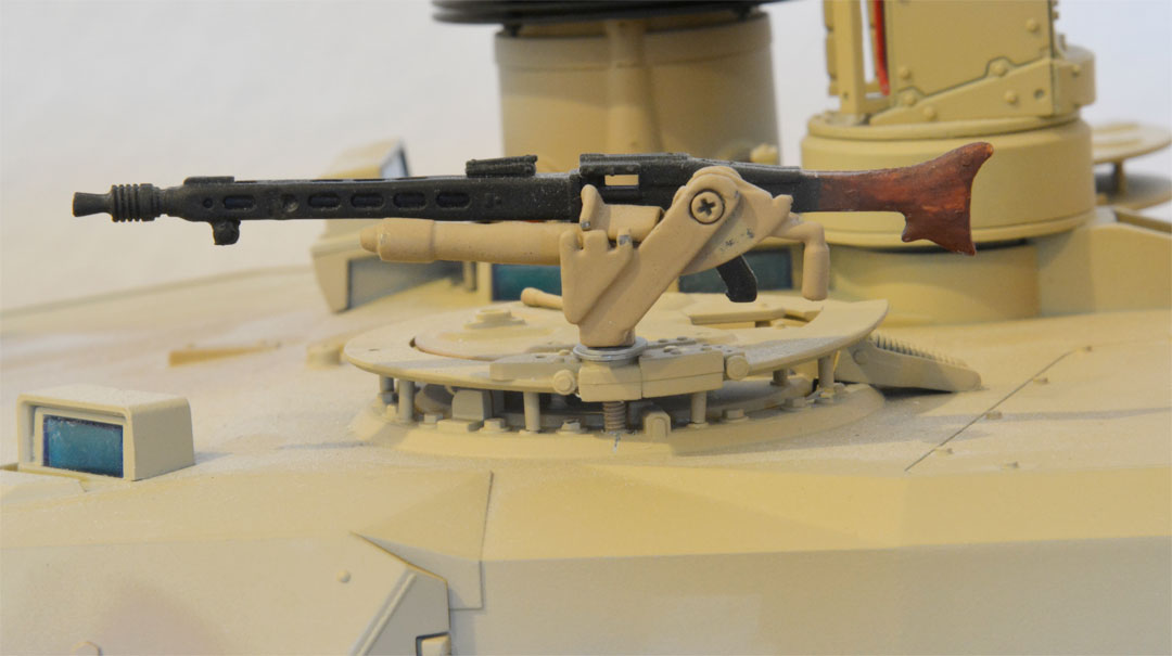

Hi,
As Bennie stated, AFV is a great parts source for your Leo 2 build. I got the MG turret carriage and metal turret storage baskets from AFV.
I used Mitosal's Leopard metal adjustable idler system, because Henntech wasn't around during my build and the Mitosal parts work good. I do use the Henntech idler system, sourced from ETO Armor, on a Leo 1A4 build currently on my work bench and that system is excellent.
Just email Mitosal and ask them if they are still selling parts and if whatever is in stock. I also sourced road wheel bearings from Mitosal, but that was several years ago.
"Thanks for the advice! I did hear about the centering stick upgrade, Ill definitely order the parts from hobby services. I would like to install the GBS unit as well, but I heard that it works slowly. Also thanks for the battery, is that standard connector compatible with tamiya connectors?"
Answers:
As to your radio selection, the Futaba 2.4 in my experience, will not operate the Tamiya Leo 2 Stabilization Unit. That fact drove both Daryl Turner and myself crazy for a bit. That is why I later switched out my Futata 2.4 and replaced it with the Futaba FM Ground Radio, per tech advise coming from Tamiya USA. The stabilization unit, TBU and stick light commands then worked perfectly and immediately
The stabilization works well in my model and is not slow, when using the Futaba FM ground radio. The Leo 2A6 DMD Unit is older tech, so that is probably why it is not very compatible with the later to market Futaba 2.4 radio system.
John
