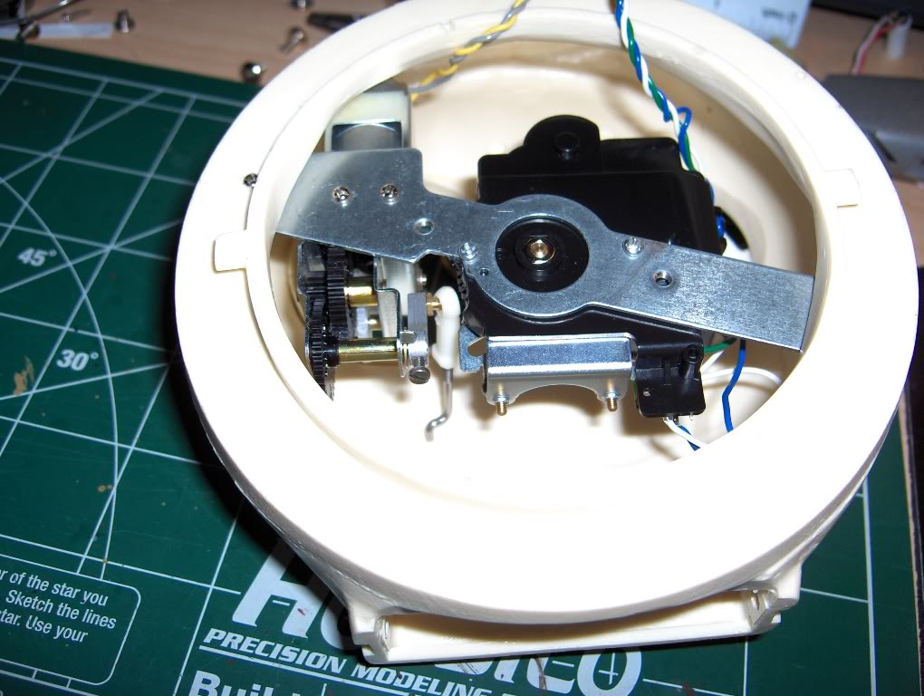

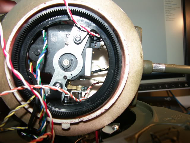

Hello All!
I am currently working on building an M4A3E8 Fury, and I need some help!
I have purchased a Nick Aguilar conversion kit for the Tamiya Sherman, but I am having an insane amount of difficulty installing the turret, as I cannot seem to get the cross bar with the Elevation mechanism into the conversion kit turret. Furthermore, I am having difficulty making sure the cross bar is low enough that the turret ring is not only centered, but in contact with the rotation gear. can anybody who has done this before help provide me with information on how this can be done? I am relatively new to this custom build situation.
Ex_Pat_Tanker 05-16-2017 09:06 AM
3 Attachment(s)
Put some washers between the cross bar and the ring gear to lower it into the hull a little more (you'll probably need some slightly longer M3 screws).
Cross bar into turret is fiddly, but not super hard. You need to have the mantlet removed tho - this gives you more wiggle room.
Attachment 2215410
Attachment 2215411
Attachment 2215412

Excellent images and advice. I agree with EPT... a little shimming and wiggling around is needed.
You almost need a watch makers touch as everything is a little tight. I believe I popped my elevation arm on with a pair of long-nosed needle pliers too.
WillWork4Treads 05-16-2017 01:52 PM
thanks for the pictures! I'll use them as reference.
