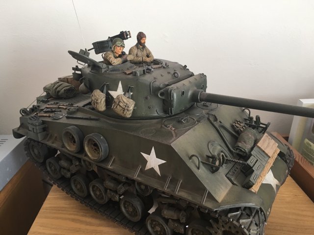

Old 05-21-2017 | 11:16 AM
Joined: Dec 2015
Posts: 130
Tamiya M51 used as a base for a schumo turret converted M4A3E8

I can tell you have the Israeli jerry can holders on the side. Where did you get this shumo t23 turret? Ive heard of it but never seen it for sale anywhere. It has all the late war details on it that the Nick Aguilar T23 does not. Nicks turret is great but is an early T23, pre Oct 1944 when it transitioned to the oval hatch.
Old 05-21-2017 | 09:29 PM
Joined: Dec 2015
Posts: 130
Got it from Germany, very nicely detailed.
I do believe they will be making some more this year.
