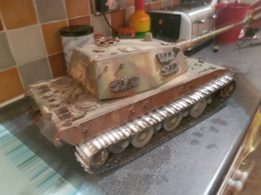

tomhugill 02-27-2018 03:10 PM
E90 super heavy
8 Attachment(s)

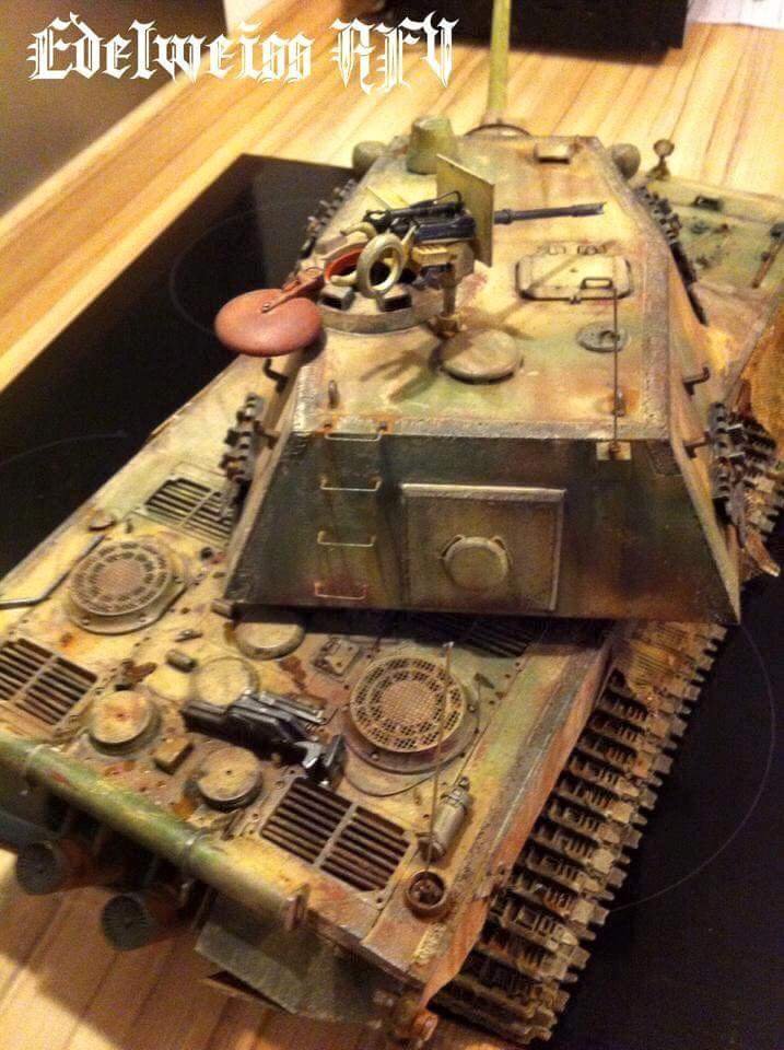

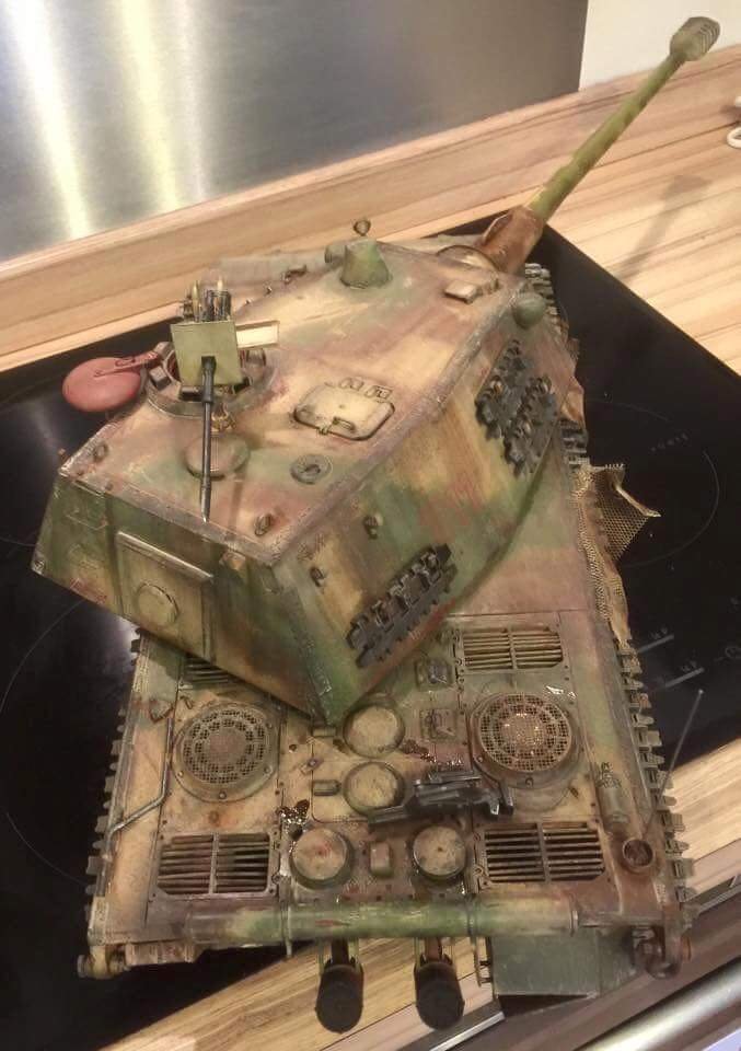

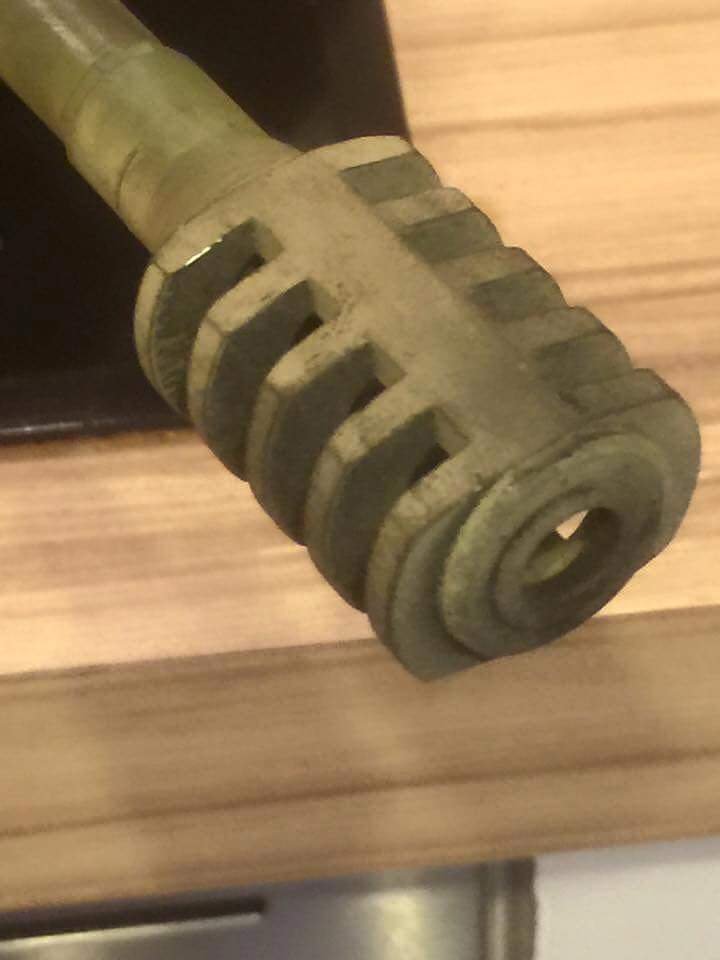

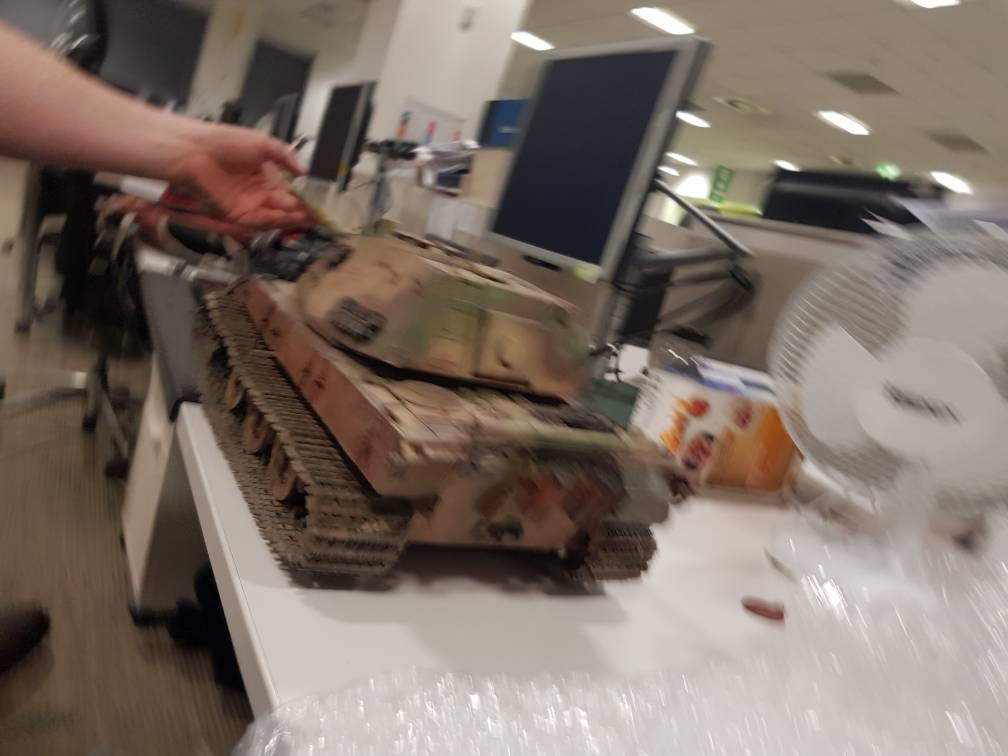

This is an exciting one for me, I've coveted this since Edelwiess first built is, finally I've managed to persuade him to let me obtain it! Got some big plans for her, servo recoil and elevation, hidden battle system, running gear upgrades, tcb with benedini sound system, maybe some Ludwig skirts. Watch this space! Attachment 2256385Attachment 2256386Attachment 2256387Attachment 2256388Attachment 2256389Attachment 2256390Attachment 2256391Attachment 2256392

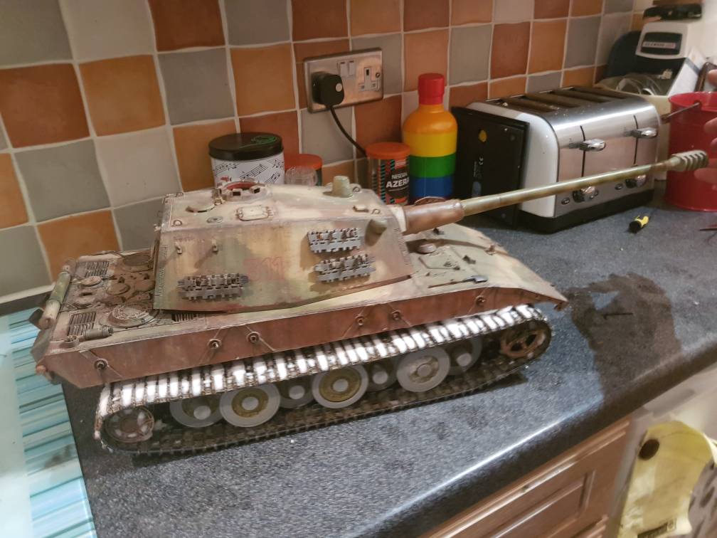

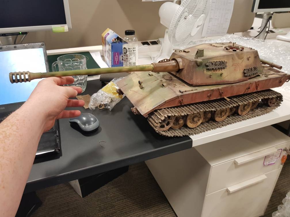

tomhugill 02-27-2018 03:11 PM

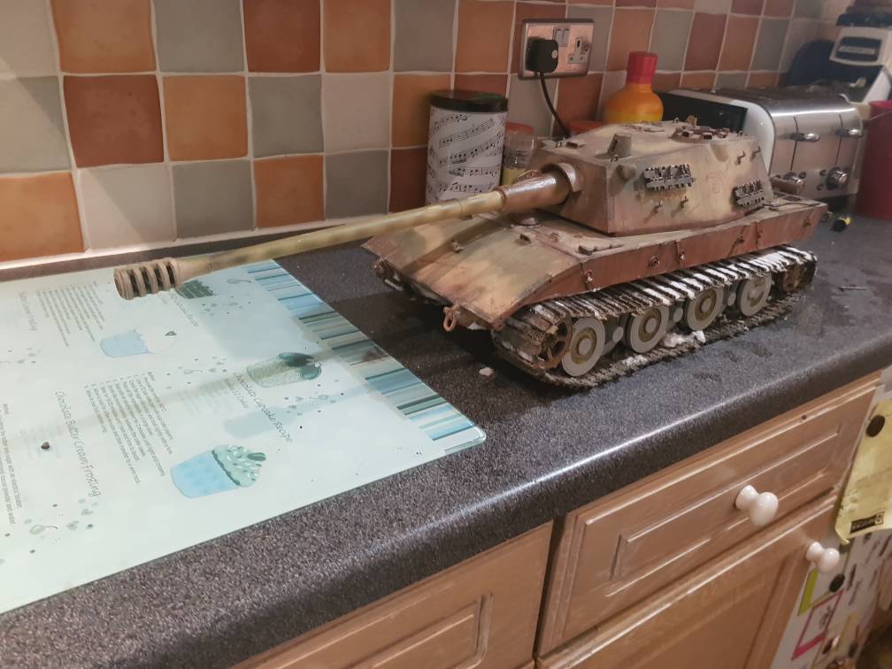

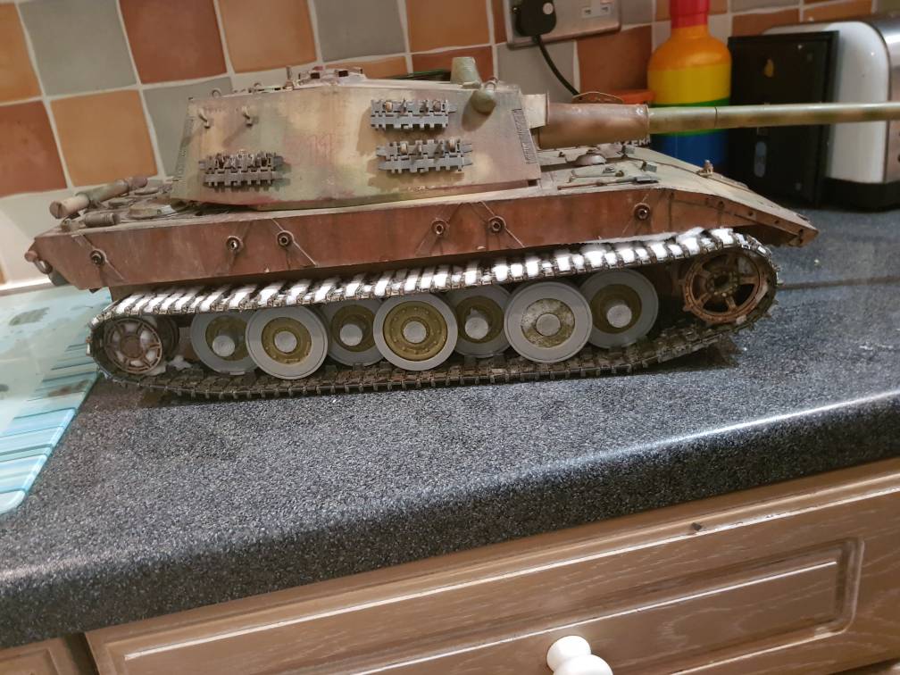

9 Attachment(s)

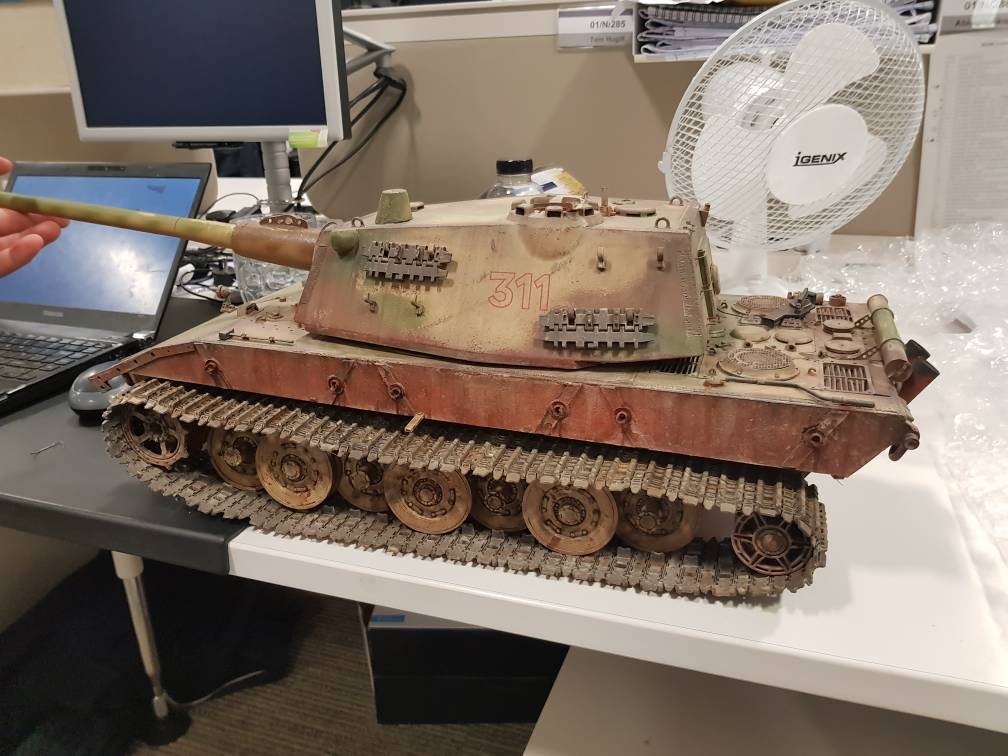

It's taken far to long but I've finally got all the metal swing arms, uprated springs and of course new wheel installed. Very pleased everything fits as it should and the alignment seems ok. I've been testing with a Clark tk60Attachment 2256393Attachment 2256394Attachment 2256395Attachment 2256396Attachment 2256397Attachment 2256398Attachment 2256399Attachment 2256400Attachment 2256401

Maccrage 02-27-2018 03:13 PM
Nice. Any way to fit some sort of counterweight to the breech end to help balance that barrel?
tomhugill 02-28-2018 01:03 AM
I don't think the Tamiya elevations going to be up to the job so I'll be using full size servos for the recoil and elevation on this. I'll add some lead to the recoil mech no try and balance things out too.

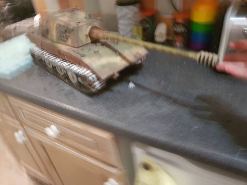

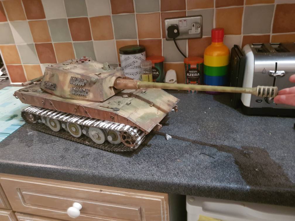

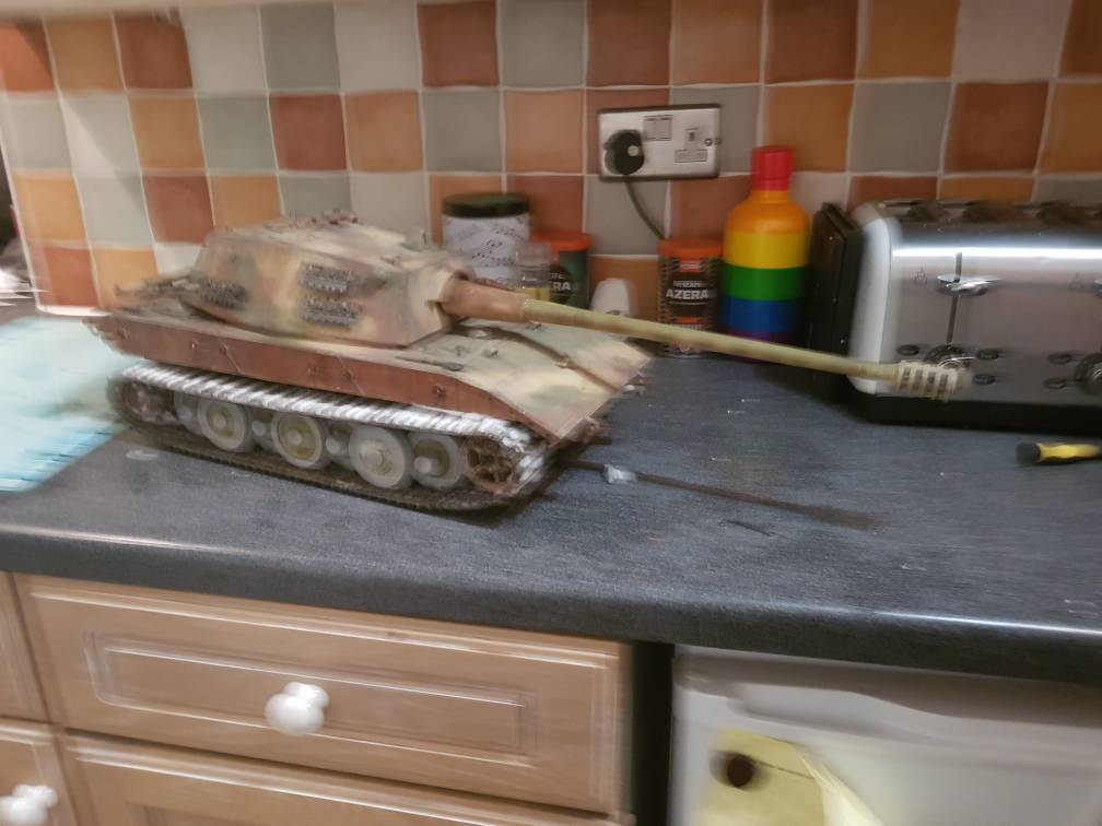

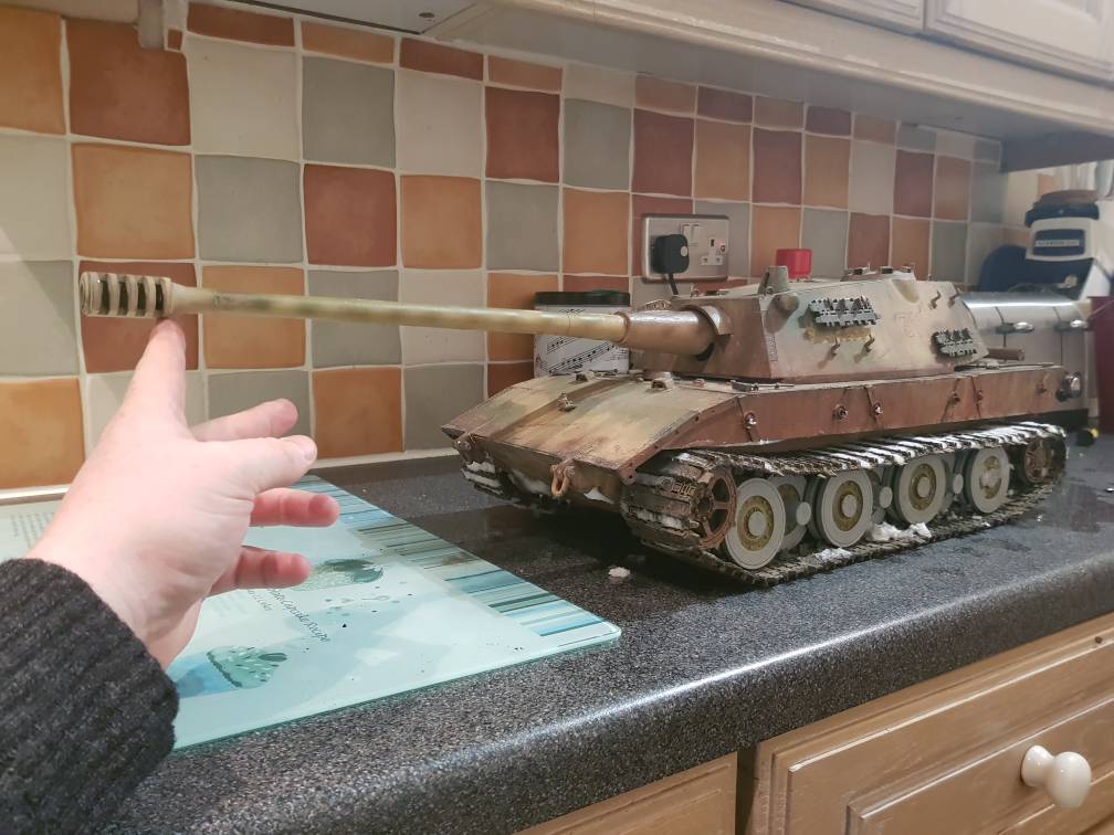

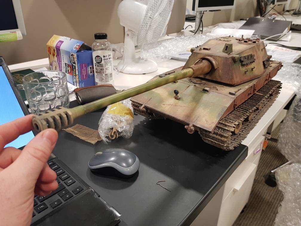

tomhugill 03-02-2018 11:26 AM
The E90 lives! (Well rotation needs work but nearly there). Some tweaking was required, added a metal gear recoil servo which has given me a better throw, the recoil unit its self had to be flipped as it was catching the turret ring, which also meant changing the elevation pivot points and elevation servo position. However I think it's coming together now!
https://youtu.be/zqPorG0L5b0

MAUS45 03-02-2018 02:13 PM
This is a really interesting "Paper Panzer". Is it using the Tamiya Hull less two road wheels? It looks to be mostly Tiger II components scratched into the scratch built upper hull and turret? Looks good enough to entice me to take a crack at scratching my own. I have some Tiger II stuff laying around that could be made use of. :cool:
tomhugill 03-02-2018 03:37 PM
Hey thanks! It's a Ludwig hull with originally Henglong running gear (Inc suspension positions) the tracks were altered with duckbills and wheels made bigger. It's now uprated with metal suspension arms, custom wheels and taigen 4:1 BB gears

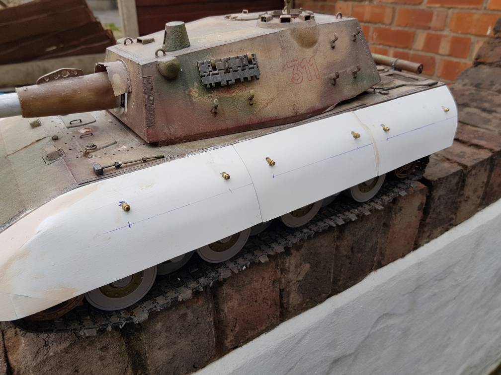

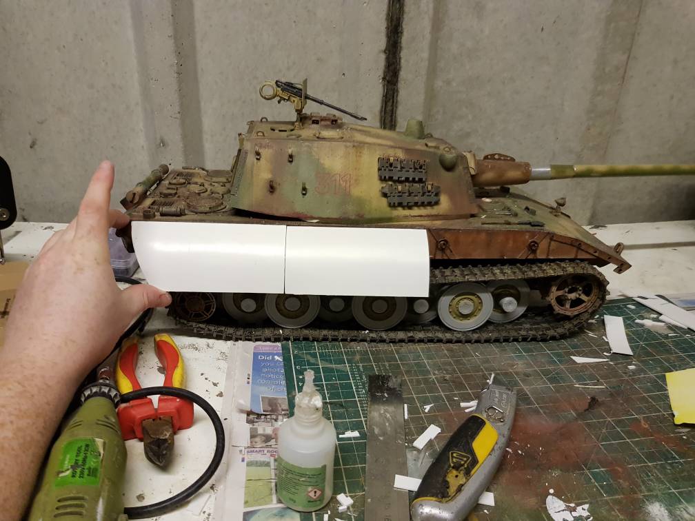

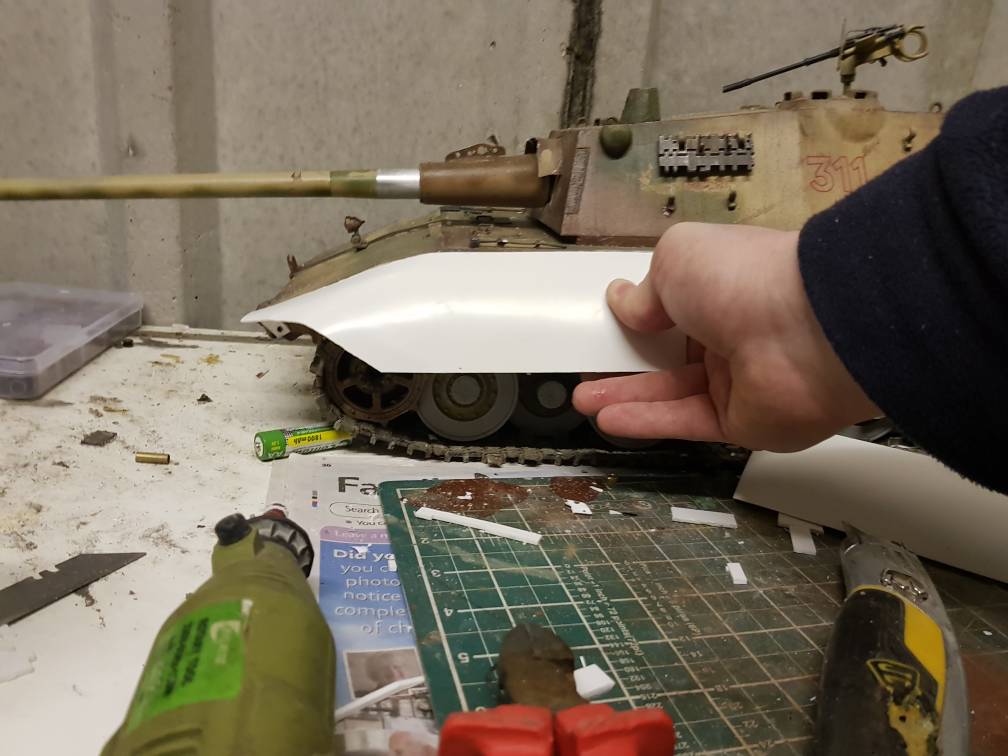

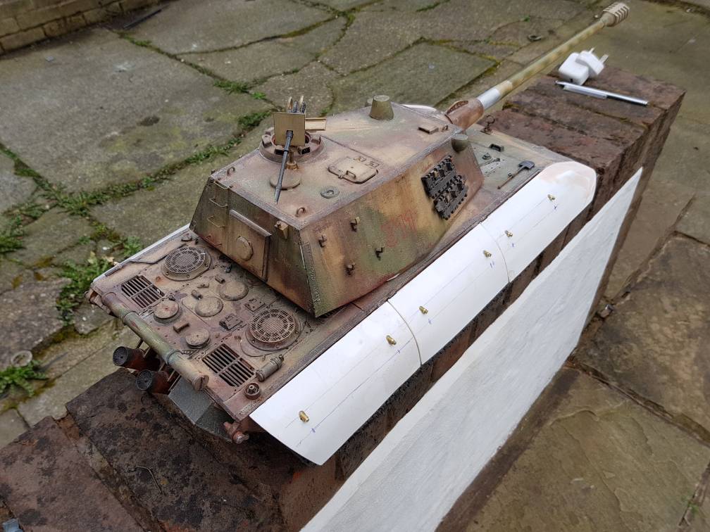

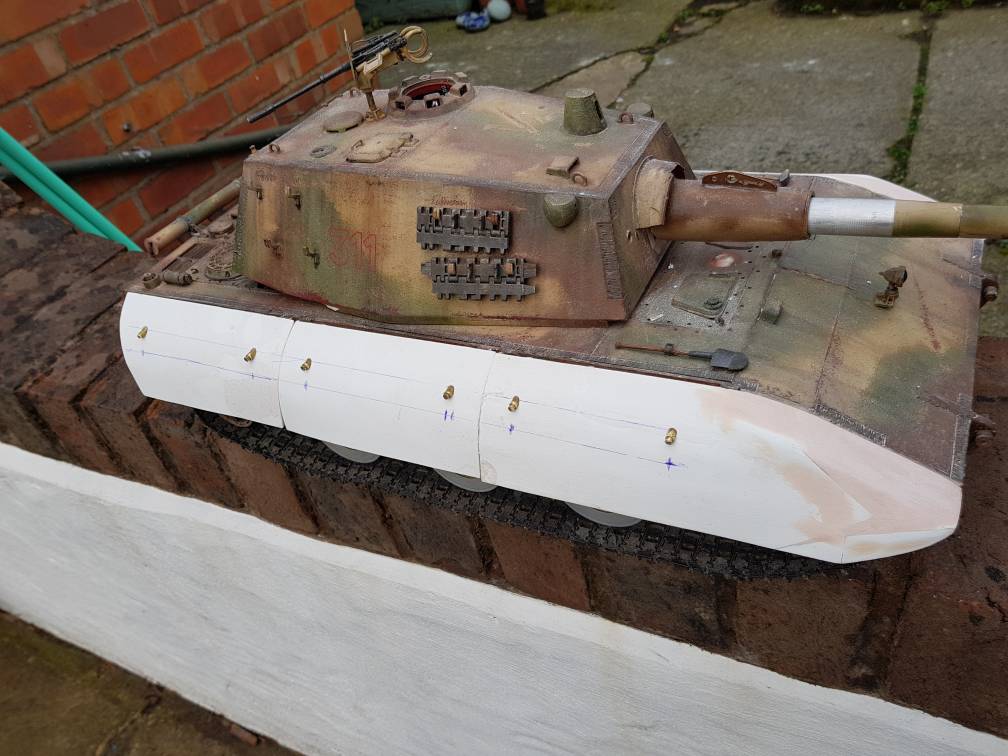

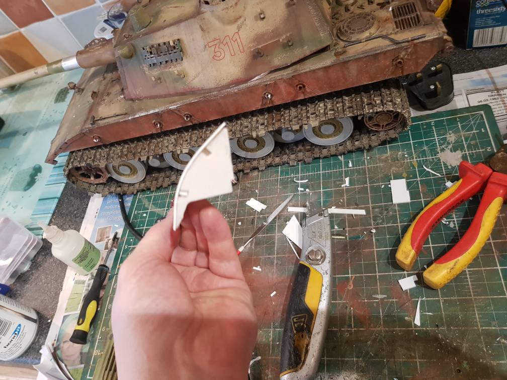

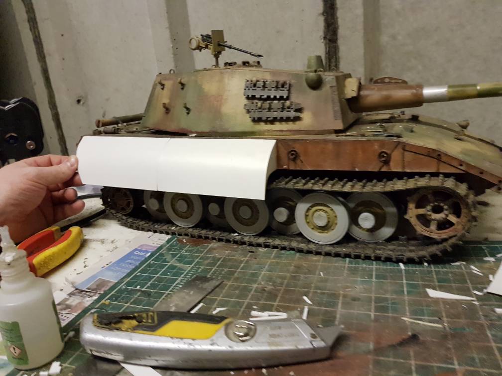

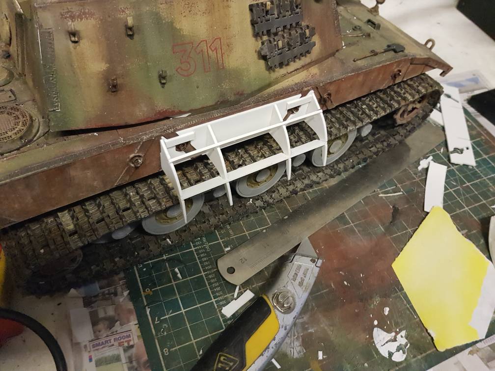

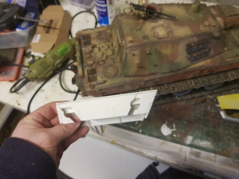

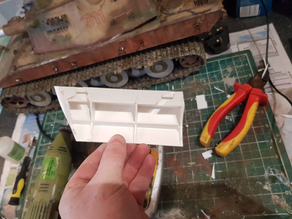

tomhugill 04-02-2018 11:17 PM
7 Attachment(s)

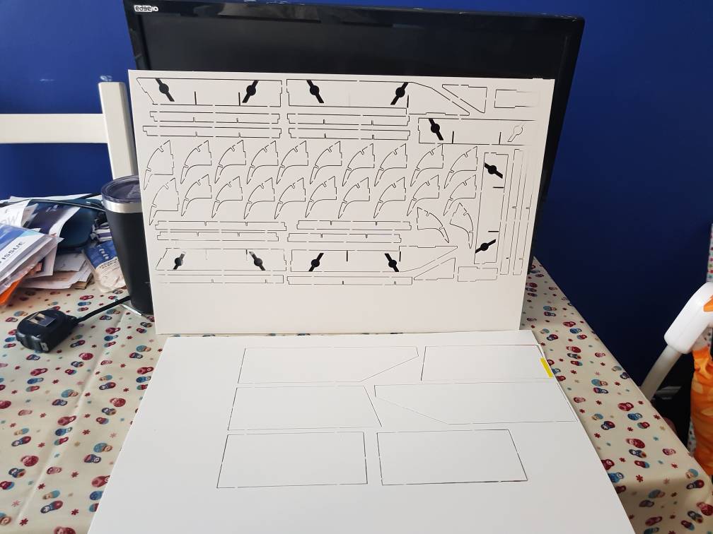

The penultimate piece of the E90 puzzle arrived last week, a set of skirts from Chris Ludwig. Whilst they say in development on the site, I asked Chris nicely and he sent me the set.
Because the E90 it's quite the same dimensions there's surgery on pretty much every horizontal piece to match where it's mounting points are. Took some cutting but one down 5 to go! They're not the neatest on the inside face but no one will see that. Attachment 2259769Attachment 2259770Attachment 2259771Attachment 2259772Attachment 2259773Attachment 2259774Attachment 2259775

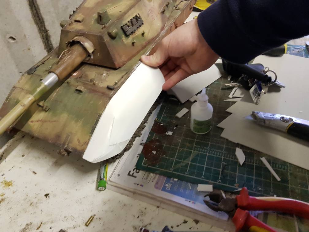

tomhugill 04-03-2018 12:42 PM
9 Attachment(s)
Slowly slowly catchy monkey, another two down tonight, starting to get a little easier! Need to get the magnets ordered next!Attachment 2259781Attachment 2259782Attachment 2259783Attachment 2259784Attachment 2259785Attachment 2259786Attachment 2259787Attachment 2259788Attachment 2259789
Sent from my SM-G950F using Tapatalk
tomhugill 04-03-2018 01:21 PM
Originally Posted by Jeff489 (Post 12418846)
Tom,
I'm looking for some tracks like that. They appear metal? Anyways, if you could share your source, I would be grateful.
Hey Jeff, current tracks are HL plastic ones with duckbills glued on. However I've comissioned some e100 style.tracks that will.fit the KT running gear. Pm me if you're interested

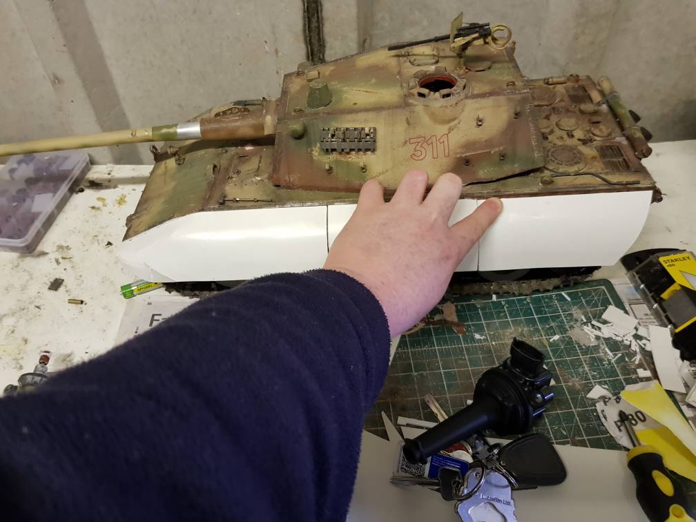

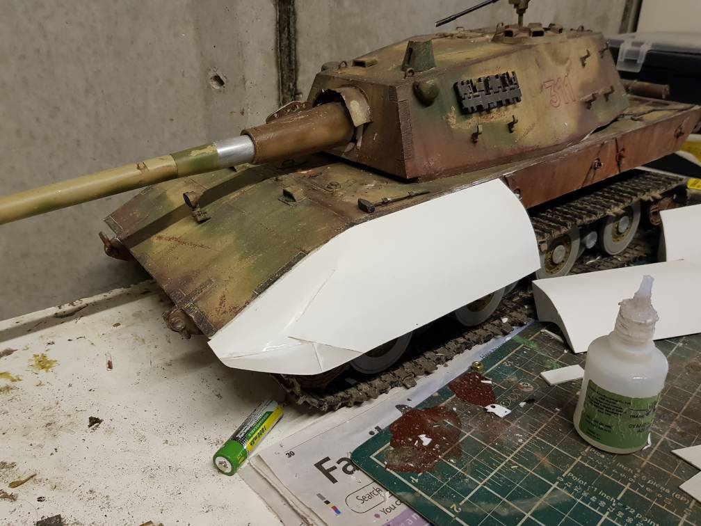

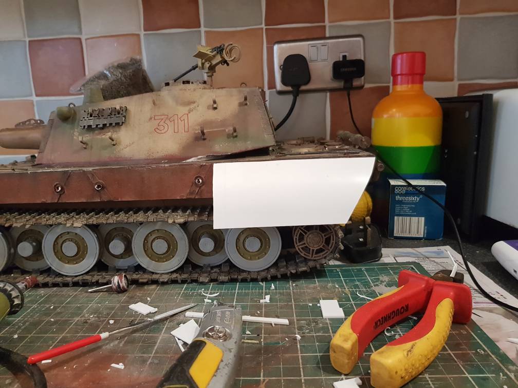

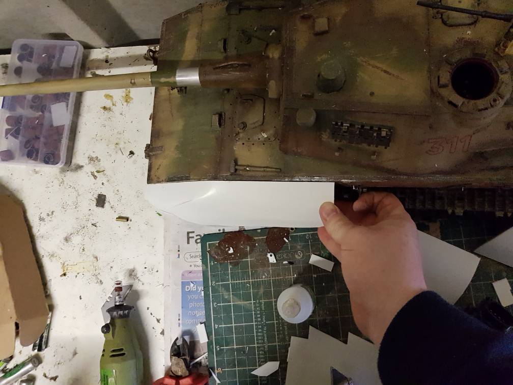

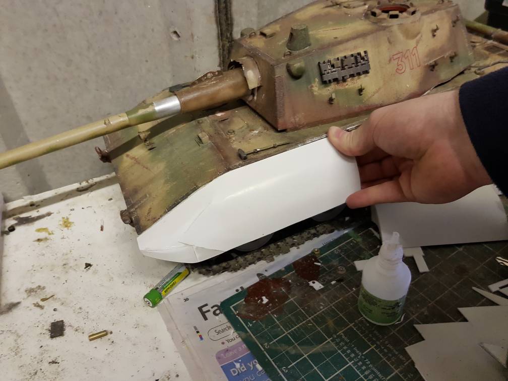

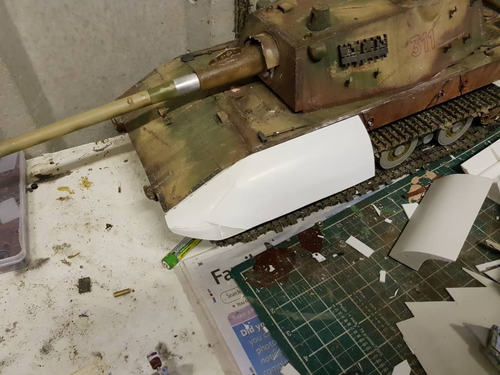

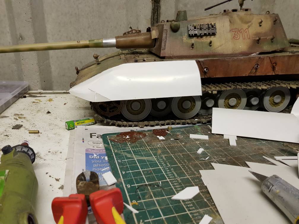

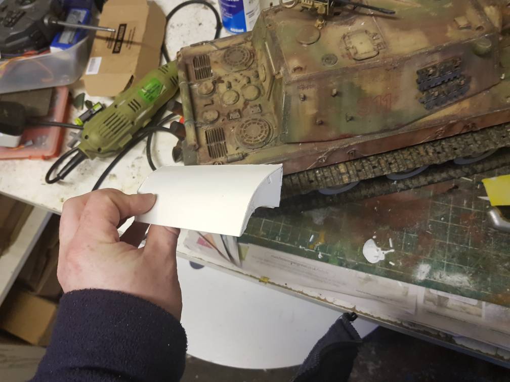

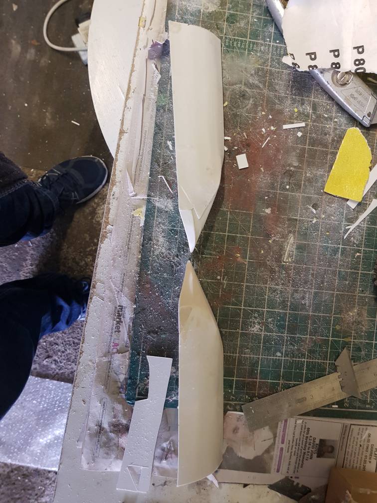

tomhugill 04-04-2018 11:35 PM
3 Attachment(s)
Thanks again for the kind words. I've not had a lot of hobby time since October but I'm putting a concerted effort into this one.

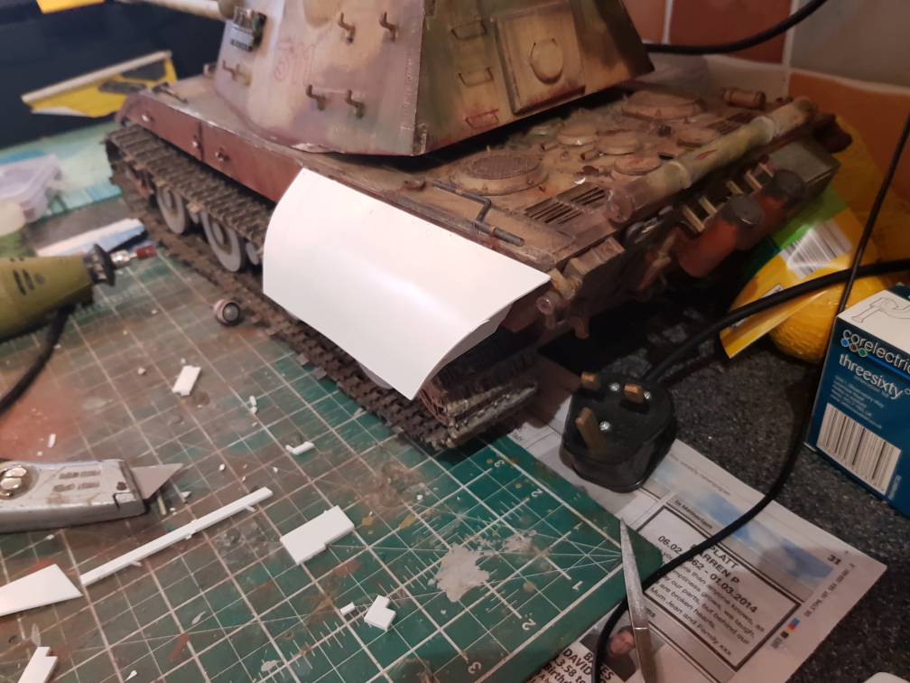

Christian was not joking when he said it would be difficult! Because the front profile of the tank differs from the e100 (the whole hull has a very slight taper) I had to do a lot of reprofiling to the piece which sits next to the hull. First stage of getting the frame done is finished, and the initial bonding of the skin is done two. As you can see I have some excess material around the front wing which is causing it to bow out, so rather than a flat curve around the bottom it's poking up. Options are to try reskinning in thinner styrene, add heat (although I fear this might ruin it) or try cutting a sliver out perpendicular to the base to remove a little excess material to try and remove the buldge. Any thoughts or tips welcome! Attachment 2259829Attachment 2259830Attachment 2259831
tomhugill 04-05-2018 11:26 AM
9 Attachment(s)
I went for the cut and shut. Added styrene at the bottom to get the shape I wanted and then I'll smooth off with car body filler.

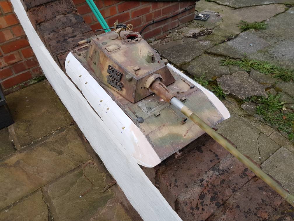

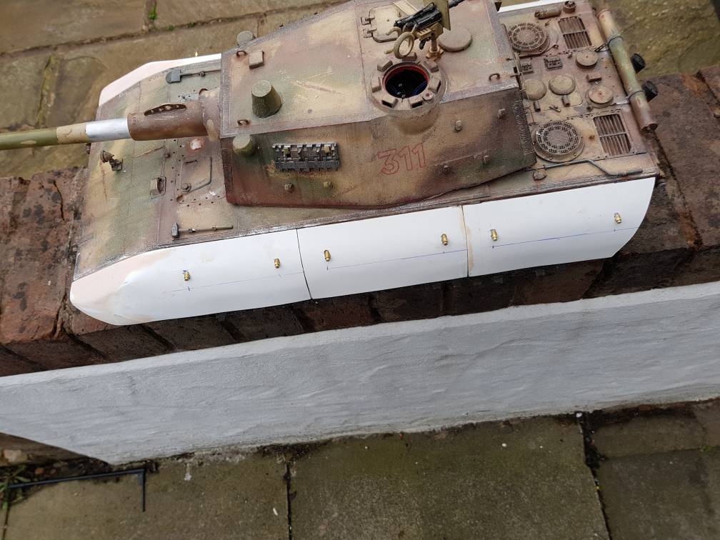

tomhugill 04-08-2018 08:31 AM
6 Attachment(s)
Both sides done, mount detail added.Attachment 2259900Attachment 2259901Attachment 2259902Attachment 2259903Attachment 2259904Attachment 2259905
