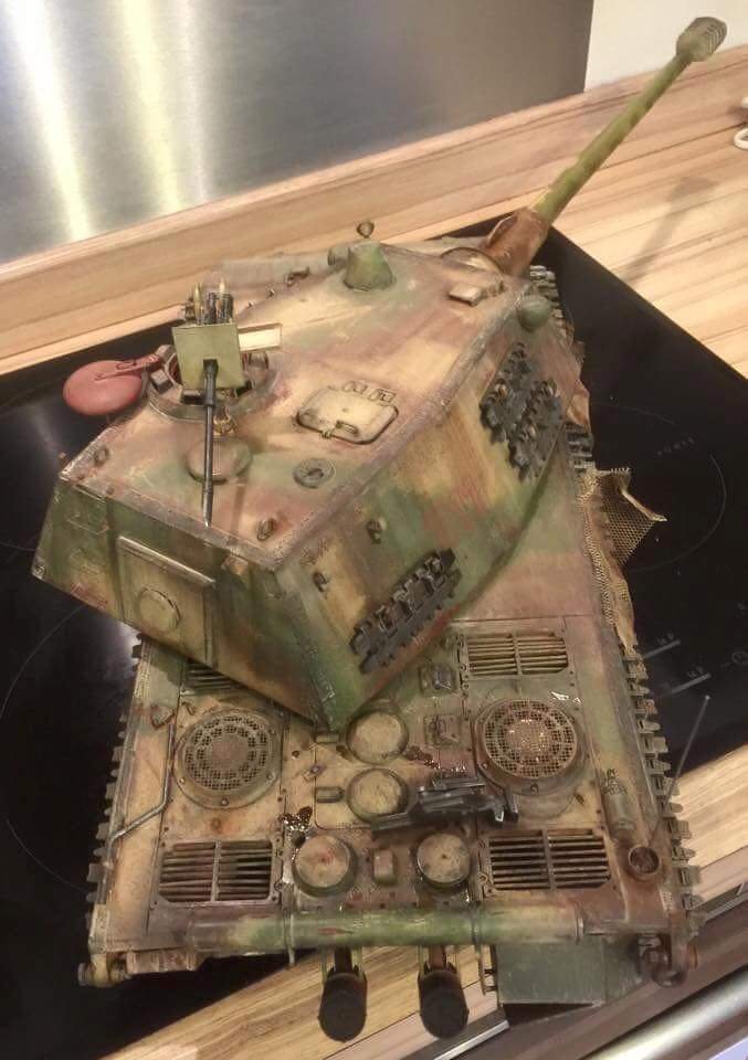

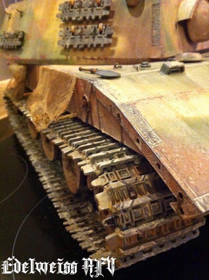

This is an exciting one for me, I've coveted this since Edelwiess first built is, finally I've managed to persuade him to let me obtain it! Got some big plans for her, servo recoil and elevation, hidden battle system, running gear upgrades, tcb with benedini sound system, maybe some Ludwig skirts. Watch this space! Click image for larger version

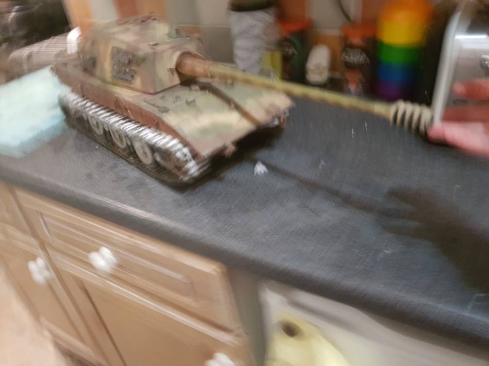

The E90 lives! (Well rotation needs work but nearly there). Some tweaking was required, added a metal gear recoil servo which has given me a better throw, the recoil unit its self had to be flipped as it was catching the turret ring, which also meant changing the elevation pivot points and elevation servo position. However I think it's coming together now!
https://youtu.be/zqPorG0L5b0

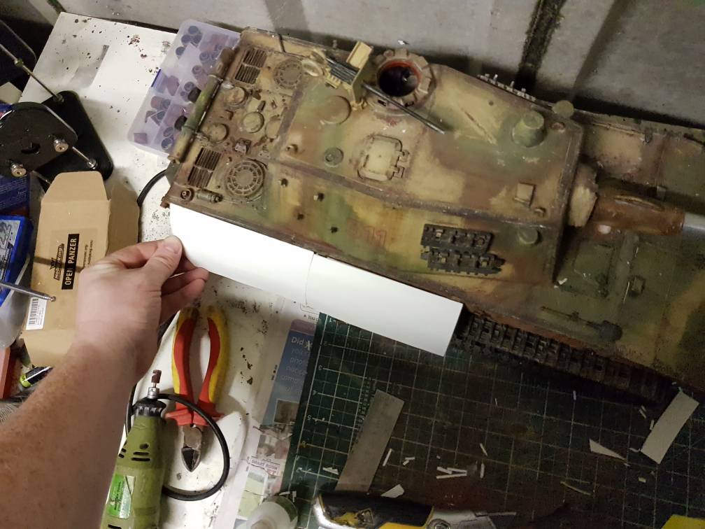

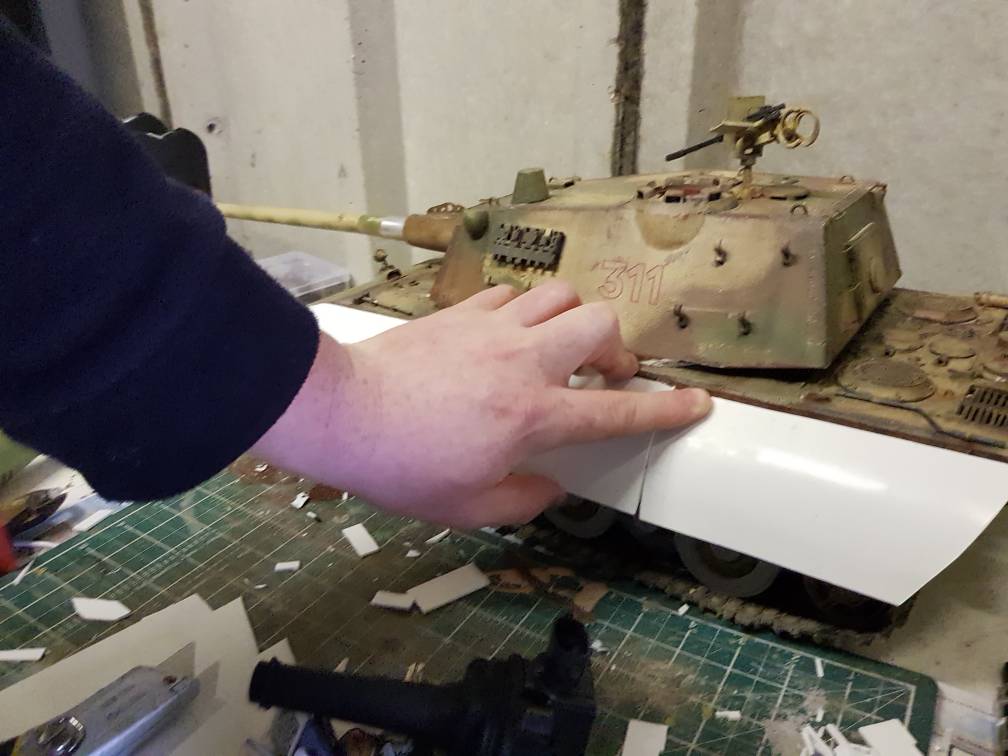

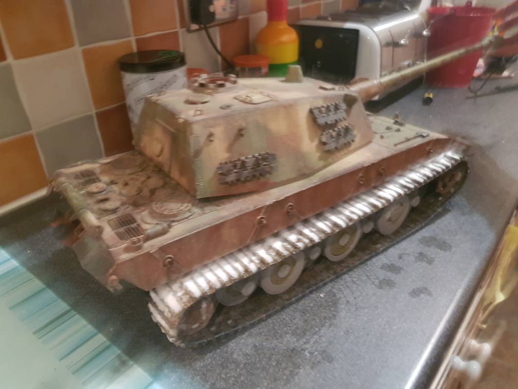

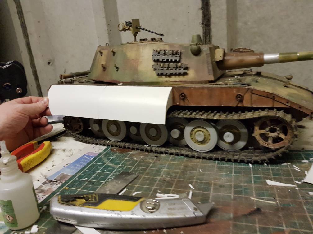

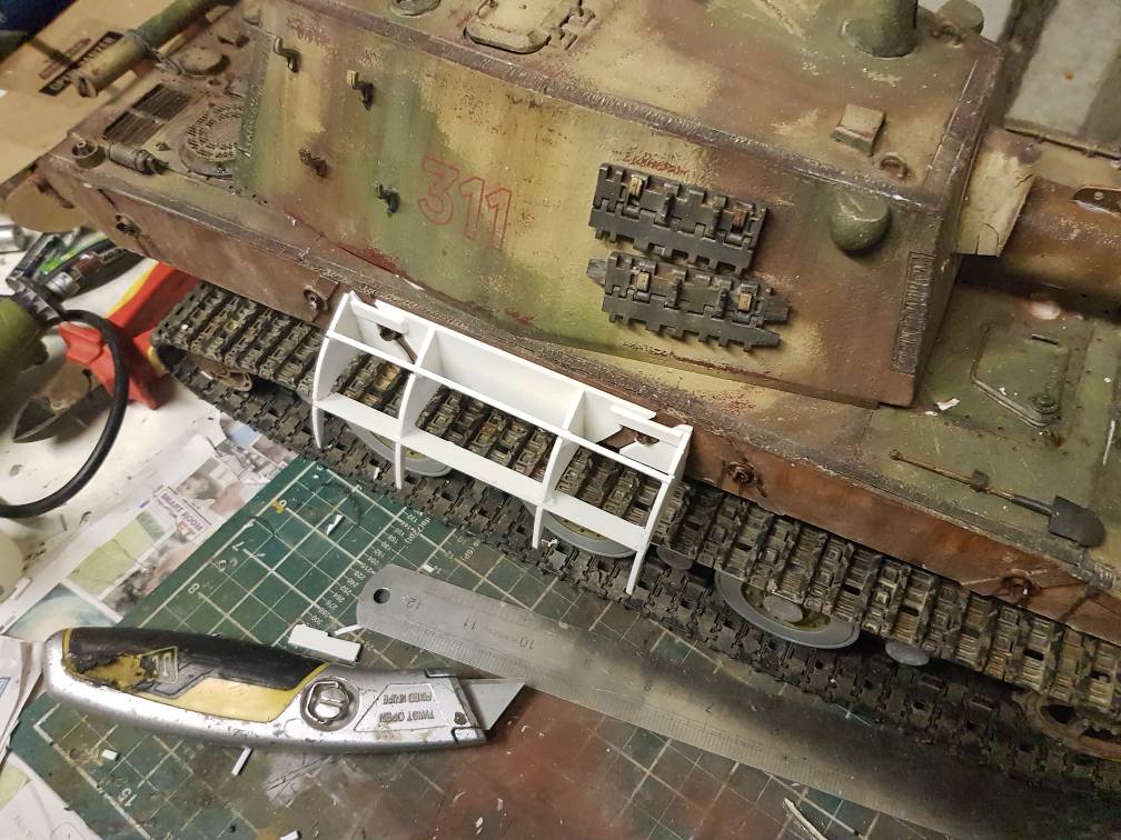

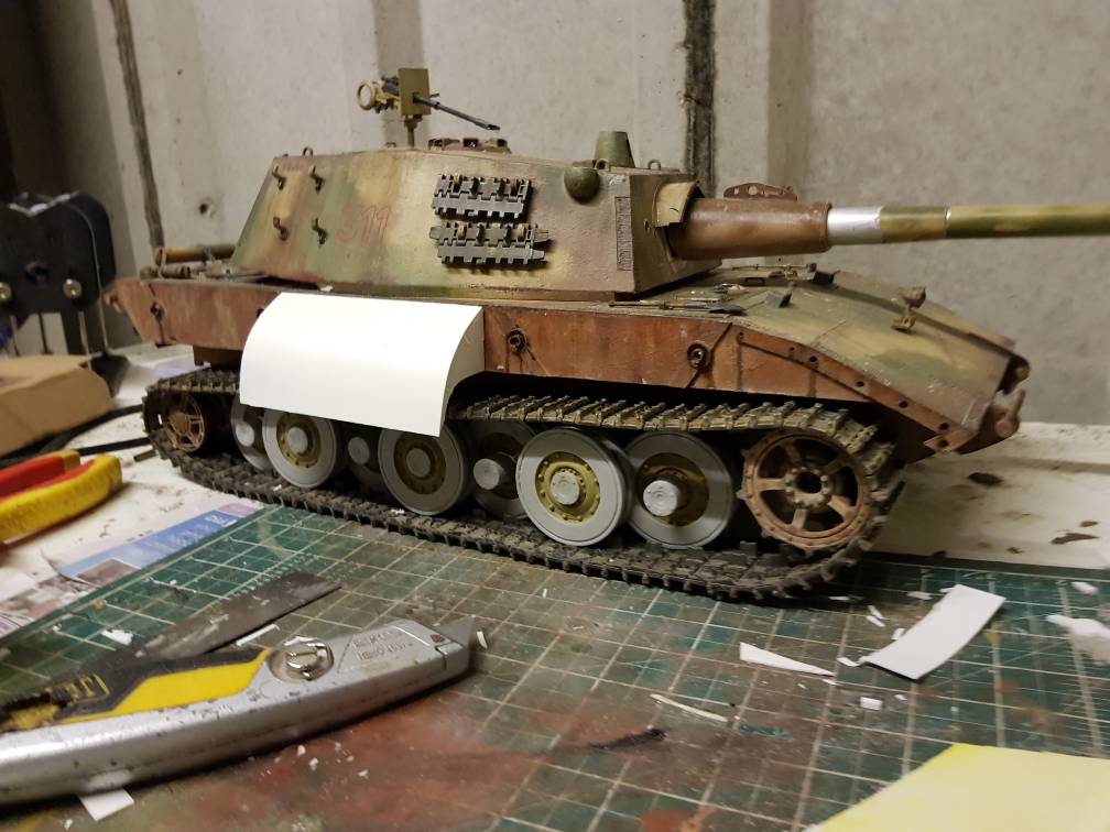

The penultimate piece of the E90 puzzle arrived last week, a set of skirts from Chris Ludwig. Whilst they say in development on the site, I asked Chris nicely and he sent me the set.
Because the E90 it's quite the same dimensions there's surgery on pretty much every horizontal piece to match where it's mounting points are. Took some cutting but one down 5 to go! They're not the neatest on the inside face but no one will see that. Click image for larger version

Slowly slowly catchy monkey, another two down tonight, starting to get a little easier! Need to get the magnets ordered next!Click image for larger version

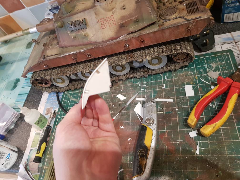

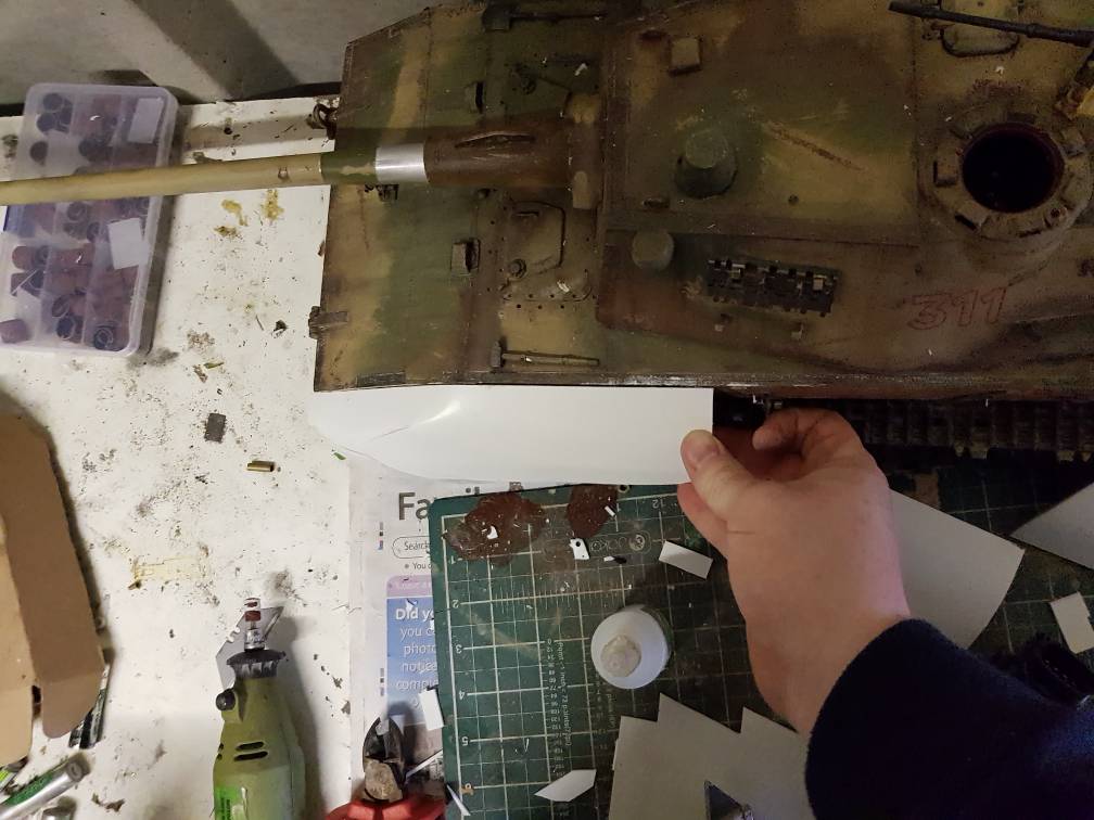

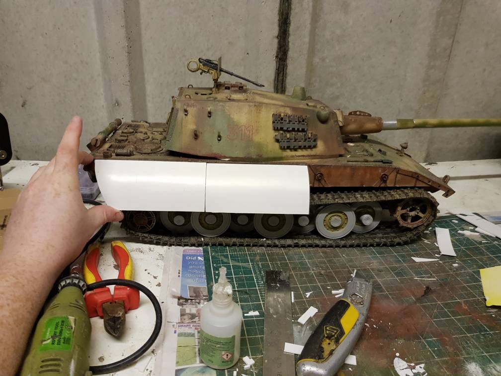

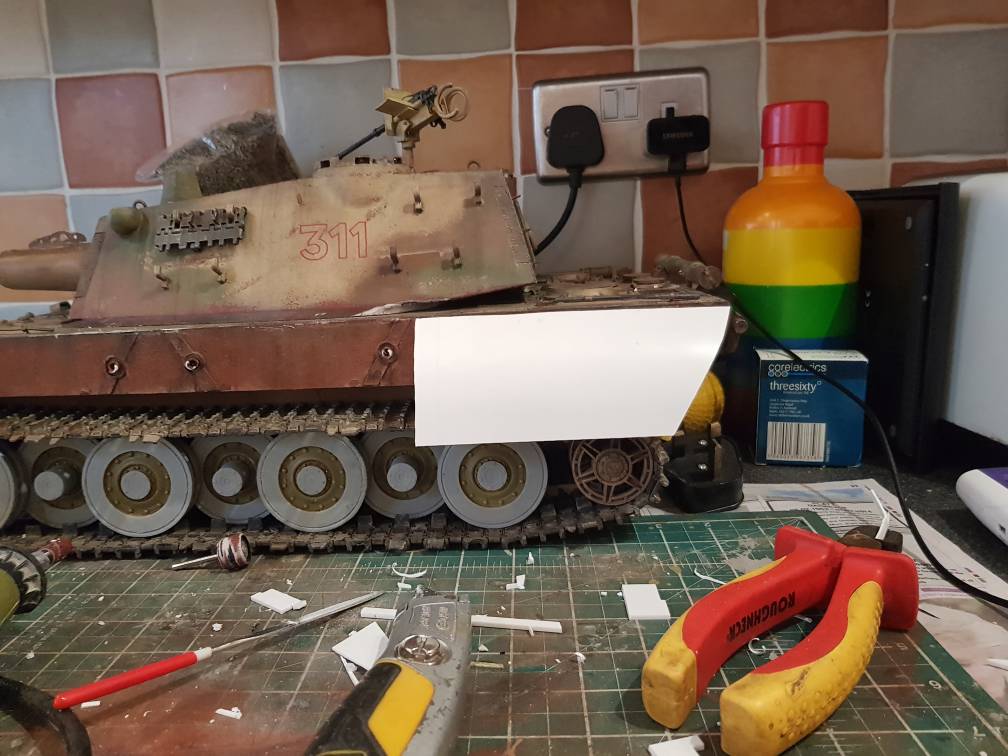

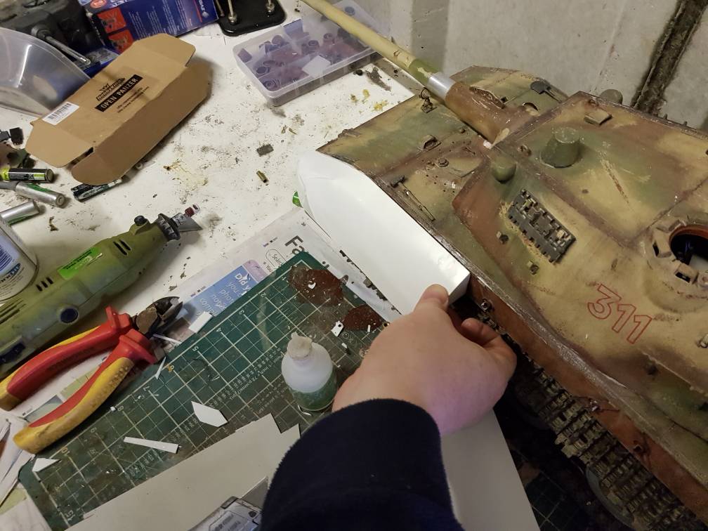

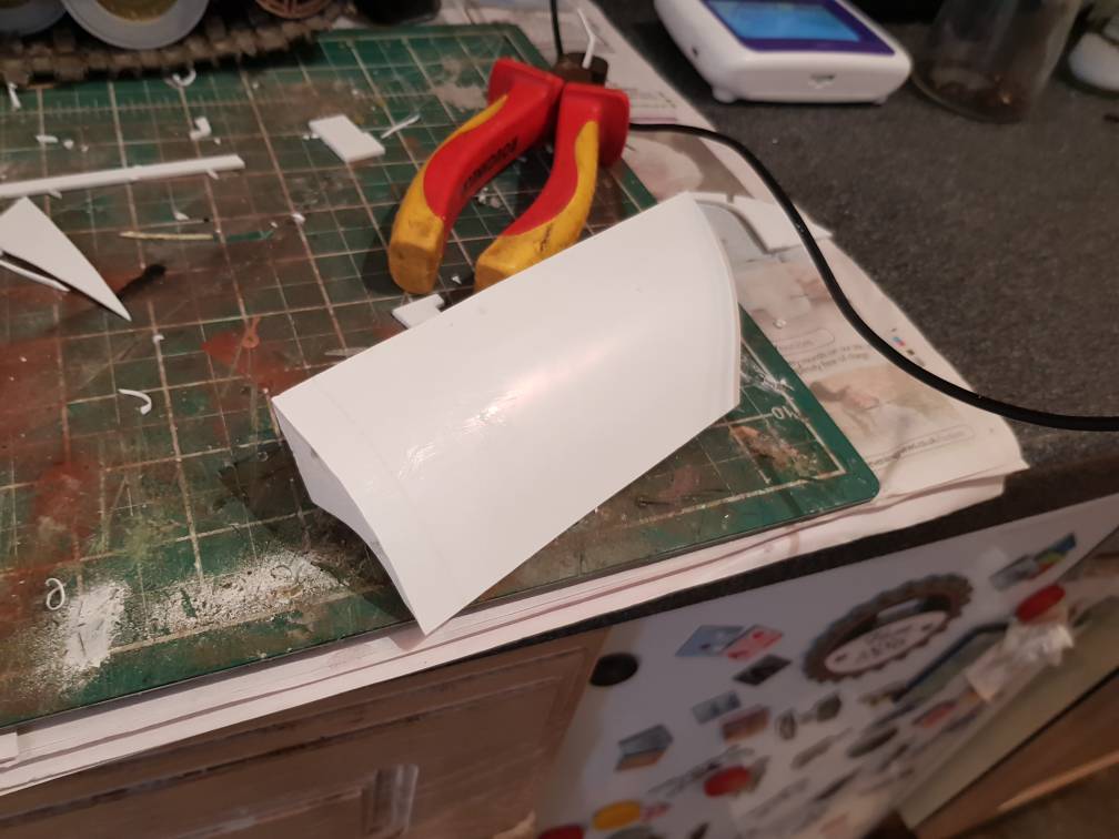

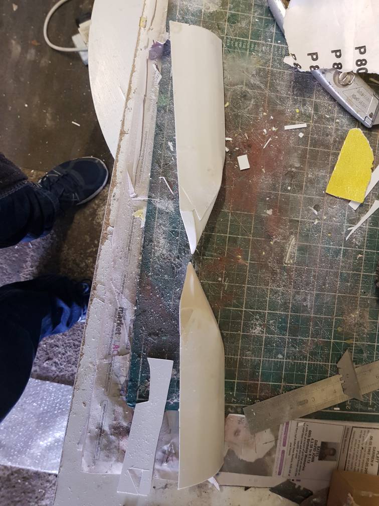

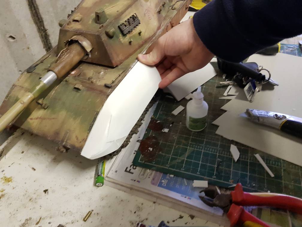

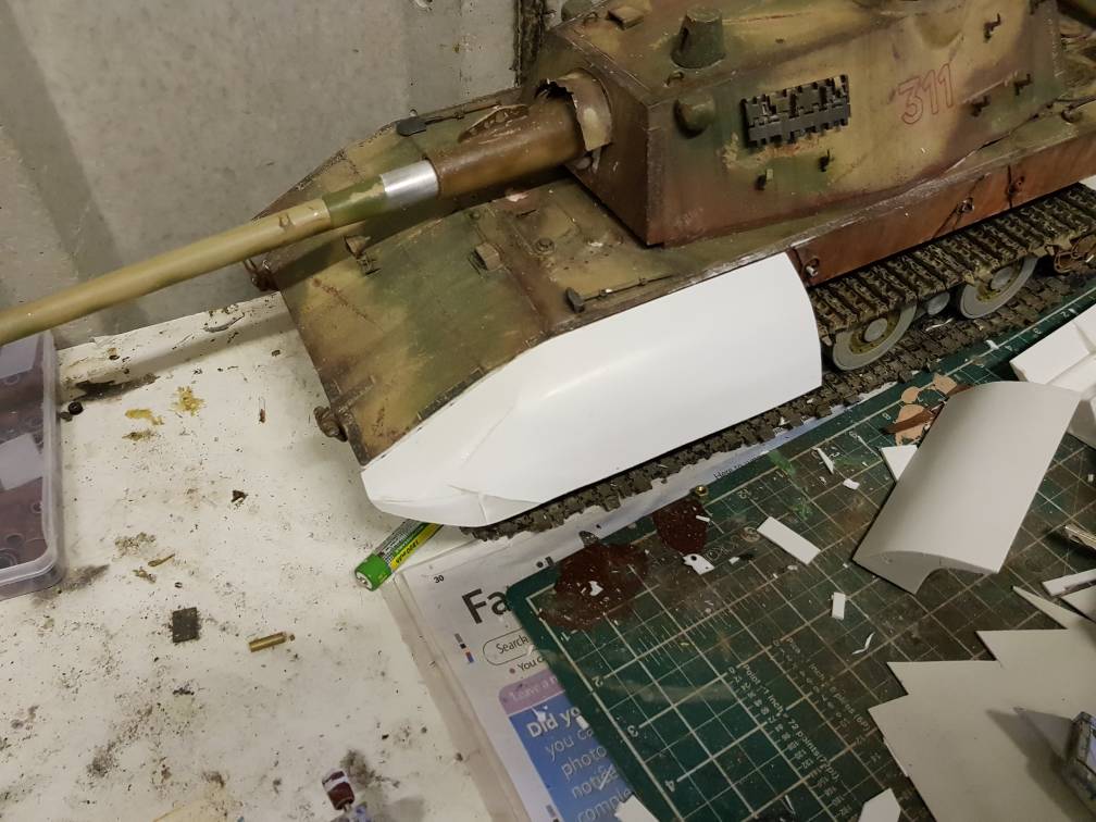

Thanks again for the kind words. I've not had a lot of hobby time since October but I'm putting a concerted effort into this one.
Christian was not joking when he said it would be difficult! Because the front profile of the tank differs from the e100 (the whole hull has a very slight taper) I had to do a lot of reprofiling to the piece which sits next to the hull. First stage of getting the frame done is finished, and the initial bonding of the skin is done two. As you can see I have some excess material around the front wing which is causing it to bow out, so rather than a flat curve around the bottom it's poking up. Options are to try reskinning in thinner styrene, add heat (although I fear this might ruin it) or try cutting a sliver out perpendicular to the base to remove a little excess material to try and remove the buldge. Any thoughts or tips welcome! Click image for larger version

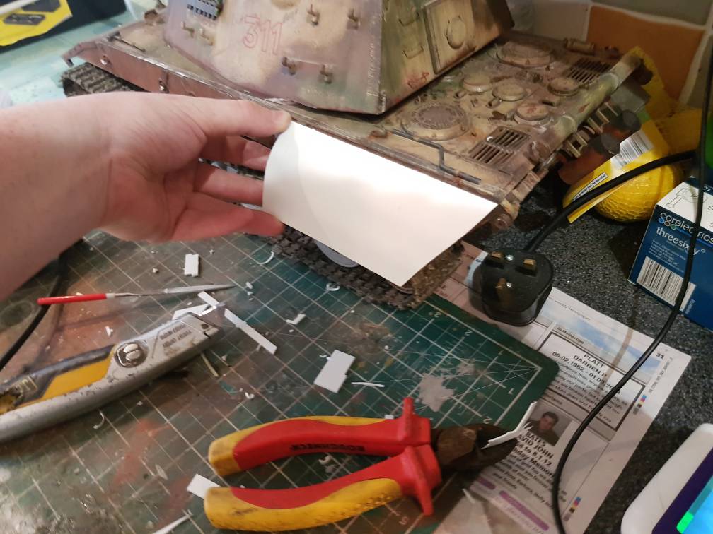

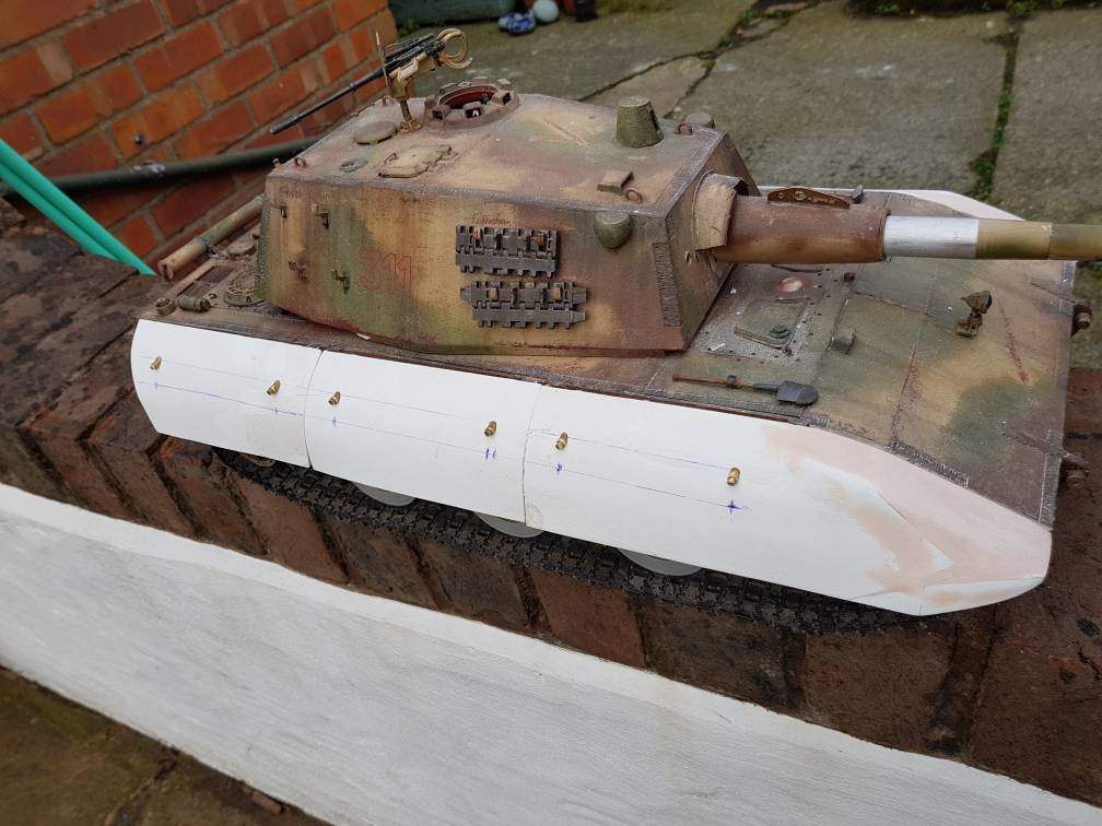

I went for the cut and shut. Added styrene at the bottom to get the shape I wanted and then I'll smooth off with car body filler.

Both sides done, mount detail added.Click image for larger version

Impressive. And nice how it's just the right size to fit on that wall.

You plan on matching Martin's paint job on the fenders?
Old 04-10-2018 | 10:17 AM
Joined: Mar 2010
Posts: 2,384
Received 23 Likes on 14 Posts
From: , UNITED KINGDOM
I'm going to try, he's given me some pointers on the paints/oils etc he used. One might end up redox with a couple wheels as hastily repairers mine damage
