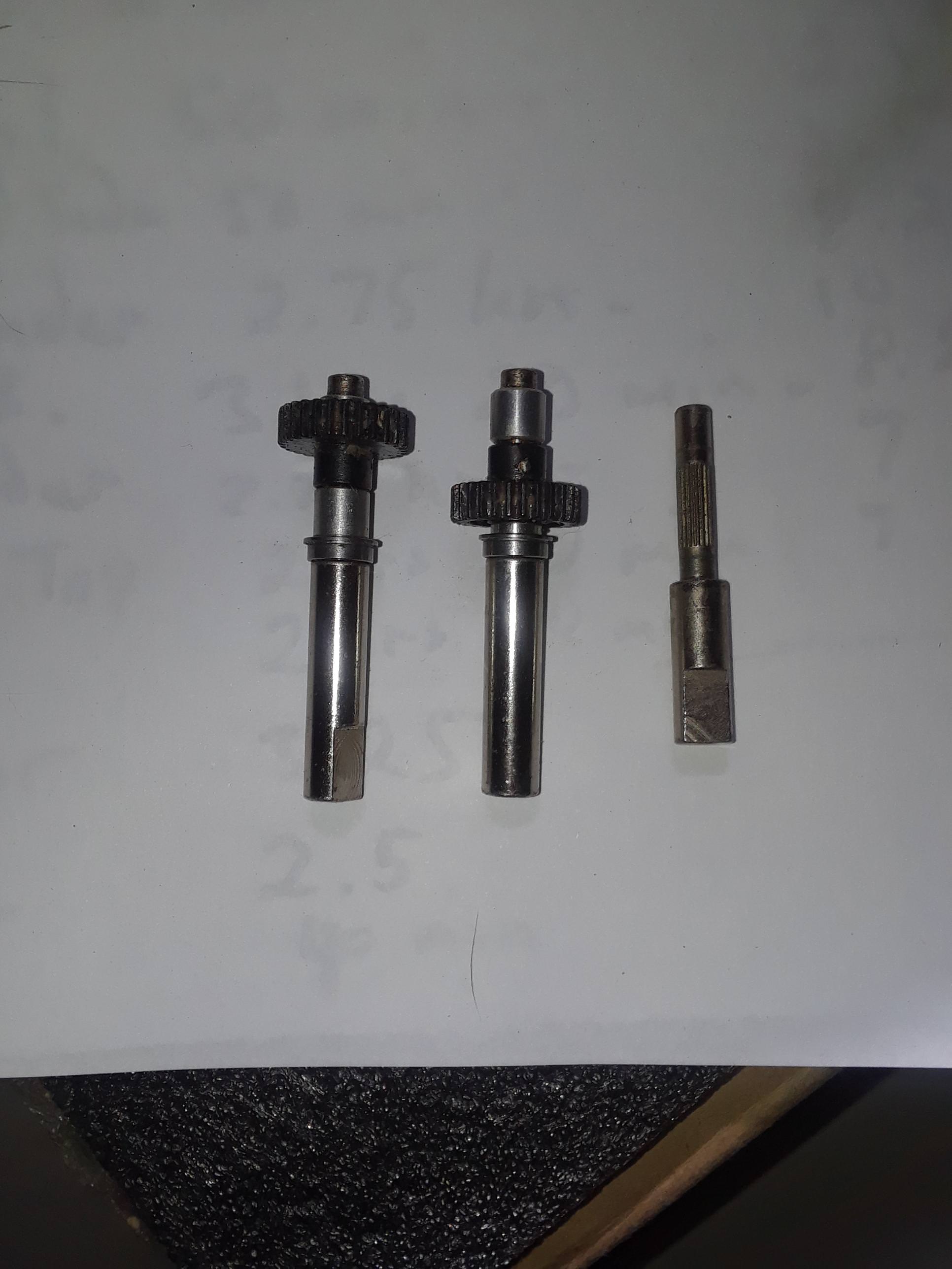

Crius 06-02-2018 12:44 PM
1 Attachment(s)
I think this is the set you need, perhaps Erik can confirm that? The short shaft is only in the photo to demonstrate that the shafts with gears are the longer, 58mm shafts, and of course the gears are black steel.
Attachment 2260782
Kear-Skof 06-02-2018 01:40 PM
Those look exactly like what I need.
Crius 06-02-2018 02:09 PM
Send your address by Private Message.
Kear-Skof 06-02-2018 02:30 PM
PM sent.
