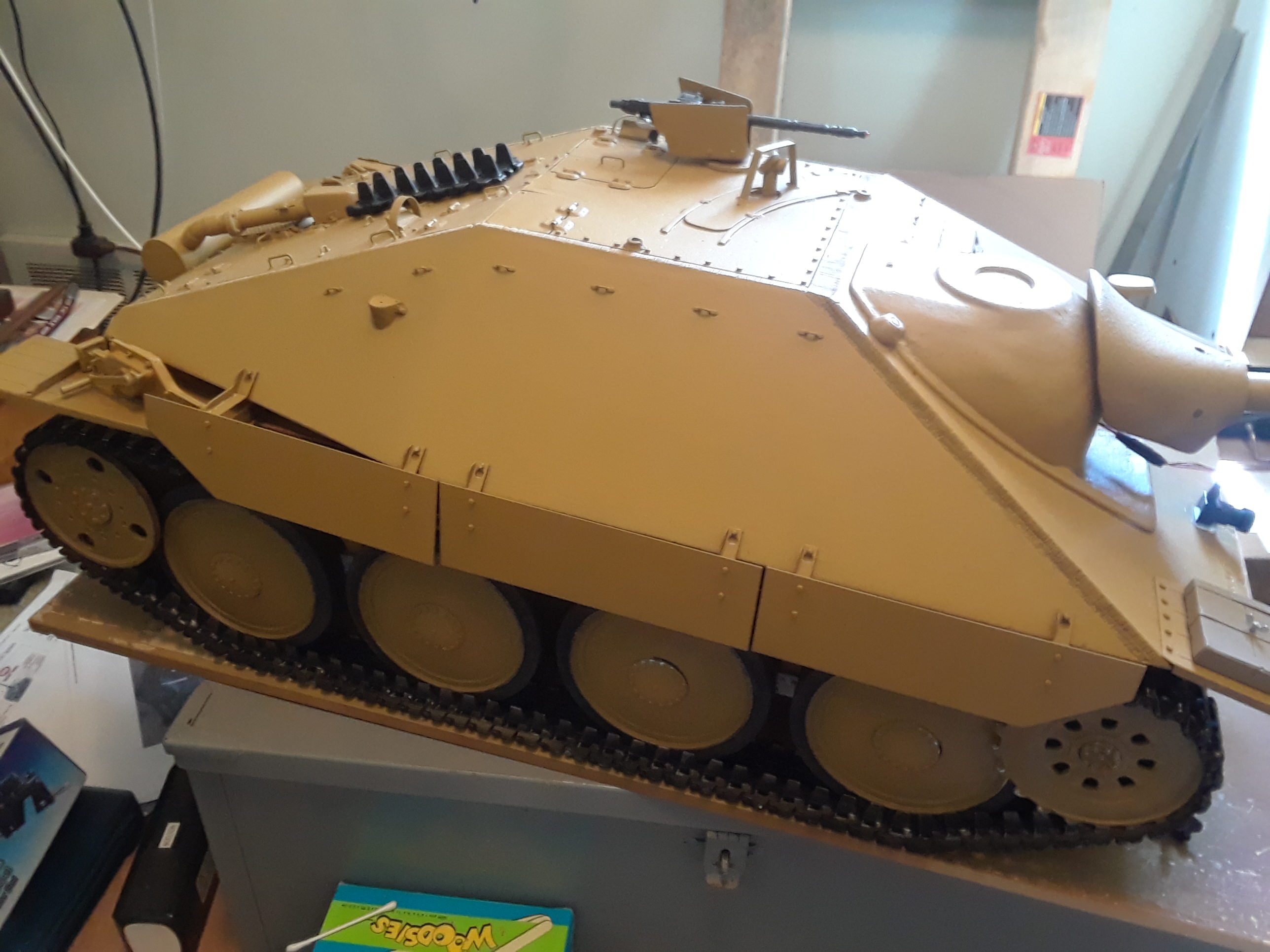

Where is the Hetzer?
She's alive and well. I just got the skirts on her so she's almost ready for paint.
Old 06-01-2018 | 12:03 PM
Imex-Erik's Avatar
Joined: Mar 2013
Posts: 3,216
Received 37 Likes on 33 Posts
From: Brooksville , FL
I always like them with the skirts off, but to each his own
Old 06-01-2018 | 12:14 PM
Joined: Sep 2015
Posts: 4,678
Received 319 Likes on 263 Posts
From: Detroit Rock City
The skirts aren't permanently attached and pop right off if you want to run without them. I think I like it better without skirts, too, so it's nice to have the option.
Attachment 2260780
I wasn't talking about the tanks but yea the Hetzer is looking good!

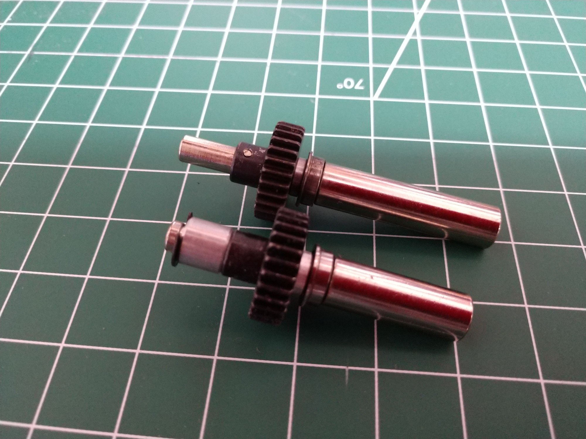

A hetzer! But anyways, I managed to "fix" the pin problem, but it's very haphazard, as I've just used a cut down track pin for my HL KT, and some tape. To which my question is now, Crius, or Erik, or anyone really, could you supply me with the shaft, or shafts?
Old 06-02-2018 | 12:44 PM
Joined: Sep 2015
Posts: 4,678
I think this is the set you need, perhaps Erik can confirm that? The short shaft is only in the photo to demonstrate that the shafts with gears are the longer, 58mm shafts, and of course the gears are black steel.

Old 06-02-2018 | 01:40 PM
Kear-Skof's Avatar
Joined: May 2018
Posts: 62
Received 7 Likes on 6 Posts
From: Montana
Those look exactly like what I need.
