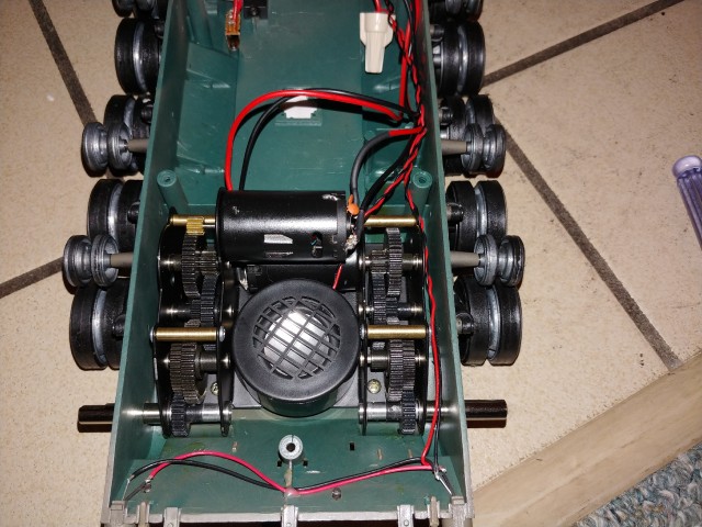

All back together, mostly. Plugged everything in and it works. Had to put longer wires on the motors and speaker.
at first it looked like the larger motors used the same gauge wire, whatever that is 20-22. but when I went to solder on the motor and actually look the longer wires were aluminum looking not copper. While the shorter wires that came on larger motors were copper.
So .. I just.. pretend I didn't see that and keep going. the wire nut is for one of the speaker wires. don't @me. Also this was during testing and I put some cable tie and tuck wires in along right side hull now so it won't interfere with turret or fitment.

Surprise the larger output from the taigen gearbox has a larger bolt which doesn't fit through the metal HL sprocket. Where's my drill?.

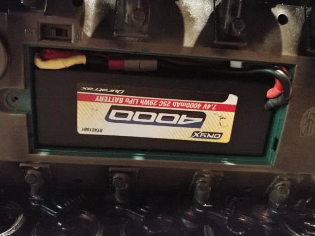

I had a 2s lipo with a deans plug on it. my other batteries are 3s with traxxas, and I just use a traxxas to deans adaptor when I charge them using a traxxas charger. I ended up using the deans end off one of my adaptors and splicing and soldering it onto what used to be the Tamiya plug on the tank. So now I have over twice the running time and quicker charging. I ran it for 30minutes starting at 8.4 volts and it only dropped to 8.2v. That means even though I don't have a low voltage alarm at the moment, i'll have plenty of time to check it using my meter and it won't be so easy to run into low voltage because I estimate it will be over an hour!. Yes its a tight fit but there it is.
