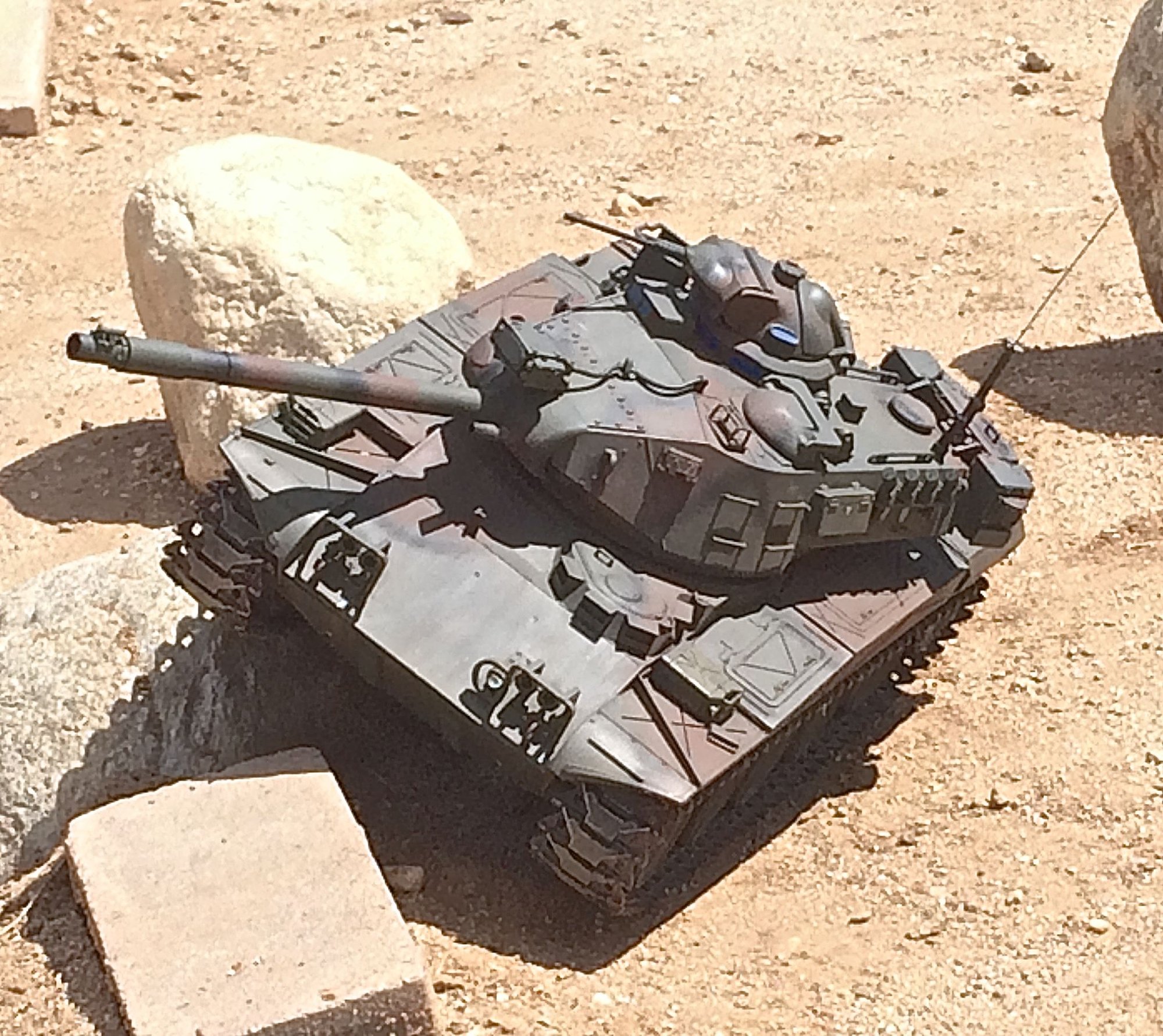

Hey peoples I'm new, not just to the forum but to rc tanks! But not to RCs. but man the closest thing I've ever seen to my tank (Henglong M41) is maybe the "BLizzard" snow cat looking RC that my friend has. I understand the basics of what controlling two motors at once is all about but have no experience with those specialty escs or any kind of mixing with traditional escs, and on top of that the tank has a board which is alittle different and has a lot more pins and wires than I'm used to.
So on the Henglong I've driven it around and I really.. well I was really disappointed it the performance, I'm into scale crawling and my tank does the opposite of what I'd like it to do.
On flat smooth ground trying to start up slowly the motors are already stalled out lol. If I slowly move the stick forward it will eventually lurch forward and then its mostly fine. The controller wins worst quality of any of my RCs.
It does have metal tracks and wheels so maybe that's why the small stock motors are having trouble. they are not too tight.
Ive ordered a V2 taigen gearbox which will come with 390 size motors but beyond that, is there anything else than can help make it move more realisticly? The shorter gear ratio and stronger motors will help but I was just wondering how big is the next step to a better controller and throttle resolution?
Oh and the tank is very rear weight biased.. Do any of you add weight to the front to make it drive better?

You are on the right path with the new gearbox and motors. But the M41 stock track type, metal or plastic are horrible for grip and slide/break traction to easily. You will need to change over to either M26 Pershing tracks and sprockets or for the best performance DKLM Abrams metal/rubber padded tracks and metal Abrams sprockets. Fortunately the M41 is super easy to do this with as changing just the sprockets and adjusting the new tracks lengths are all that is really needed in your case.
Also consider running an 8.4v or 9.6v battery. These will make the motors perform better both for crawling and sprinting. I have done a few write ups on the M41 so check them out. Especially the one where I did the track conversion to run Abrams metal/rubber padded track.
Lastly adding wieght helps the suspension flex and conform better to terrain features. This helps with climbing grip but does not really help with throttle control. I add a fair amount of wieght to all my tanks to give them a 50/50 front to back balance. With the M41 though I find that a 60/40 front to back is best as the wheel base is so short and needs just a bit more forward to keep from flipping over while climbing steep inclines or step type obstacles.
With the new gearbox, motors, track with more grip and higher volt batteries you should be able to achieve decent control from the newer generation of HL controllers. I have no problems with them and I actually “rock crawl” my M41s (as shown in my gallery and past thread photos).

First, the stock taigen V3 control unit will give you much better control than the Heng long unit and it's a cheap option. However, your best bet is to go with a hobby grade board like a Clark or an IBU. The difference in control is just amazing. The Walker Bulldog is, in my opinion, a really nice little tank that gets overlooked by quite a few. When I get home from work I'll post a couple videos of mine because I've done something unique with it. My m41 has two different Hull tops. One is stock and has a regular tank turret, and the other is one that I converted over to a quad 50 anti-aircraft tank. The tank runs with TG ball bearing gearboxes, 380 Motors, with metal tracks and sprockets and with the Clark tk20 it really, really runs great. If you want to maintain accuracy, you don't want to change your tracks. I know the other tracks can grip better but they are historically inaccurate and that's why I stuck with the stock m41 tracks in metal.

Ok cool. So I didn't expect to be able to use a higher voltage battery, that should totally help. Add some weight to balance it out.. that will be (hopefully) an easy task.
I'd love to get my M41 to the point that I can make an Tank vs. Rock crawler video.. of course at the end the tank shoots the truck and blows it up haha.
I wish you said the stock tracks work better because I paid the extra money for metal tracks and then painted them and everything, but I probably need the driving experience first anyway before I can take advantage of a grippy abrams track.

Ok so I've opened up the M41 for the first time and started making some changes.
First I removed the non-functioning heng long smoker unit. I just never got it to work, although it was moving air no smoke.
I want to move the speaker to in between the new taigen gearboxes, but they are still in the mail so I can't tell if it will fit. But it does appear to fit with the stock gearbox. Also now the wires are too short to reach from the speaker in the rear back to the board.
The layout and compact size of the RX18 is pretty sweet, and the wire management was surprisingly adequate (although I'm not a fan of twisted wires) I even saw a few mini cable ties in there. The overall build quality and connector fitment etc.on the board is really bad. Mine was not even closed all the way and I just barely got the plastic to snap together. It's a few steps back from the waterproof, and sealed escs that are available in other RCs.
So the reason why I want to move the speaker between the gearbox is to add some weight to the front, which I did in the source of a large square aluminum block I was using as a paper weight. I think its just the right weight, if it was steel it would probably be too heavy! After checking to make sure the upper hull would still fit and snapping off some plastic bits on the bottom to make it fit better I used gorilla glue to secure it. I didn't want to use double sided tape because it would have made it taller and possible interfere with fitment.
The motors are really small, if they didn't have that gear reduction they would be toast!

If you run with the speaker between the GBs you won't be able to use a smoker, and I believe you liked the effect on mine so do you really want to give that up? I just use a stock Taigen smoker from Imex in Florida and they're only ten bucks a pop. For a long time I would automatically have Erik add two smoke units and two airsoft units (also ten bucks) to every order I placed. I found out early that smokers and airsoft units are prone to failure (even though they've gotten more dependable as time goes by) but they're cheap and easy to swap out so I guess I've just gotten used to it.
I understand about the weight in the front but I don't think aluminum is the best material for that, being light weight to start with. I just use simple lead sinkers from the fishing tackle box. I hold them in with Zap Goo and they come in all different shapes and sizes. Usually the split shot, about a quarter inch in diameter, work very well. You can tuck them into nooks and crannies so you don't waste space, and I just weigh out a handful on my postal scale to get a starting point.
You might want to look into a better control system. The hobby grade boards, like the IBU and the TK22 like the one in mine are a popular choice, and there's also the Asp and the Elmod. The TK22 is by far the most economical at about $100 including shipping from RC Tanks of OKC. That's Nathan's outfit and he's a good guy and an avid RC tanker himself. It does have it's drawbacks, though, as you need a special TV remote and an IR programming device to set it up, but once you have those things they work for any subsequent Clark products you buy. When I first started out I was buying HL tanks with the old 27 MHz set-ups and the control was horrible, so I found a cheap way to get better control was to install a Taigen MFU. Now they're up to the V3 control board (also called an MFU, for Multi-Function Unit) and I think it's a very good, low cost option for airsoft tanks. It's around $60 and works with any hobby grade transmitter, like my favorite tank TX, the FlySky i6. I have some videos of this set-up if you'd like to see them. The new V3 MFUs have proportional turret rotation speeds, very good sounds (although they haven't come out with a Bulldog sound module yet) and a feature to disable that horribly fake track recoil when you fire the main gun.

Consider also removing (cutting out) the battery box. This adds a lot of space for larger batteries, adding weight and moving around/changing electronics as your build evolves. The M41 is a short tank and even with the battery box removed it is still quite structurally sturdy.

You might have a problem fitting the henglong sprocket on the taigen gear boxes, their shaft size is a bit larger. Dont know why they did that.
also, if you go after market control board beware right now the IBU2U has an inirtia delay built in. You cant turn it off. Eventually they will likely create an option to turn it off but its not available right now. Makes the tank horrible to drive in my opinion amd impossible to use in an IR battle.

Rich brought up an often overlooked point about the Taigen gearbox drive output axles. They have to be fitted to HL M41 sprockets (and other HL sprockets). A easy way to do this is to install them, then run them while holding a “sanding implement” to the first ~2/3rds of the axle checking routinely the fit of the sprockets onto the axle shafts. It does not take long, is easy enough and will save a lot of grumbling.
I do it this EASY way now, after it was point out to me by Rich.
I almost got depressed when I saw the position of the lower motor screws but they did leave some access holes on the opposite side of the gearbox.
I'll try and install it first and when I run into the problem you mentioned I'll see if I understand what you meant loll

Ok I see the problem, I need to make the sprocket side a bit bigger without messing up the shape of the key hole.
Also as luck would have it the leads on the larger motors are too short.. But the leads on the smaller motors ARE long enough. So, I bet if I just tap it with a soldering iron it will come off and I can switch them. The larger motors have what I think are little resistors that combine the +/- in series with the can itself. or maybe its some other way i'm pretty tired atm. they say 104, 10.4kohm? i'm studying this stuff for work/school so I only just know what I'm looking at but not much experience
And the reversing system of slowly lowering the stick to get it to back up is so terrible I cannot get my tank to back up without several tries.
I love the inertia. I like how the tank slowly comes to a stop when you take your foot off the gas but don't press the brakes.
Steve
Do not try to open up the holes on the slrockets, just run the motors in the tank and lay a file on the end of the drive shaft amd file it while it spins and keep checking to see if the sproket fits yet.
